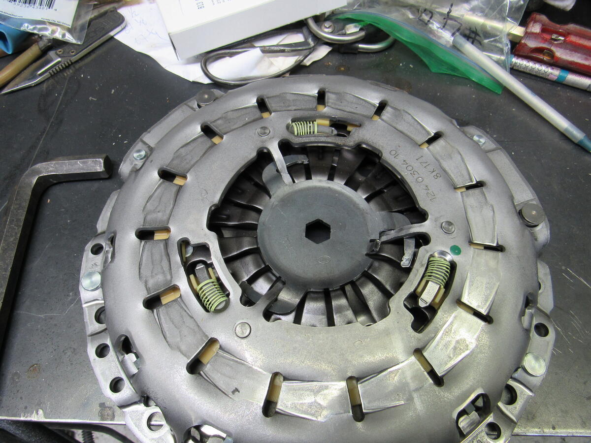

    I have never dealt with a self adjusting clutch plate before so I thought I would check in with you guys to make sure I'm on the right track.
    As I understand it after the clutch plate is torqued into place I just use the Allen key to remove the center locking device?
    Is there a certain depth that the pilot bearing should be placed to in the crank or should I just set it at the front hub and let the input shaft push it back to where it needs to be?
    Thanks
    Pilot bearing - there is a groove in the crank that it will butt up against, so drive it in carefully using proper size socket or bushing tool attachment so you push it in against the outside casing, tap lightly with hammer to make sure it is going in straight. If you let the input shaft drive it in, you will have a hell of a time and it might not go in straight or sit flush.
    SAC release - yes, torque the pp down, (hopefully you have the clutch alignment tool with long allen on the end, because this is where it comes in) and then release the mechanism with allen key or ratchet extension and remove the clutch alignment tool.
      Just to make sure I understood correctly. Bearing should be tapped in until it won't go in anymore (should mean it's flush up against the groove in the crank) right?
        Yes, it should bottom out in the crank. You'll hear the change in sound when tapping it in.
