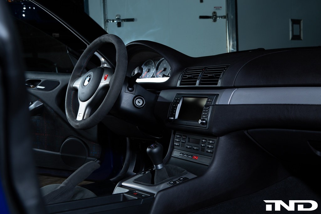

    With the release of our new Red Sport and M-Track Mode Button Set for the E46 M3, we put together a brief install guide.

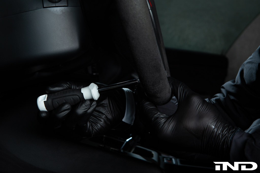

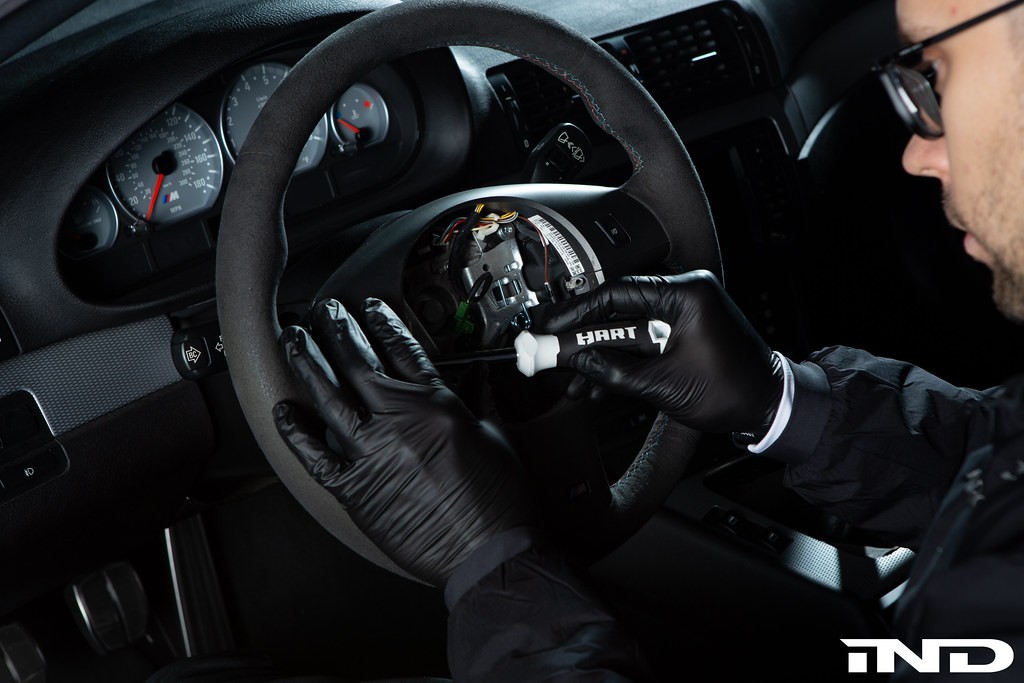

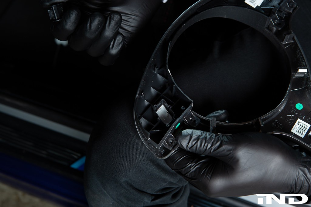

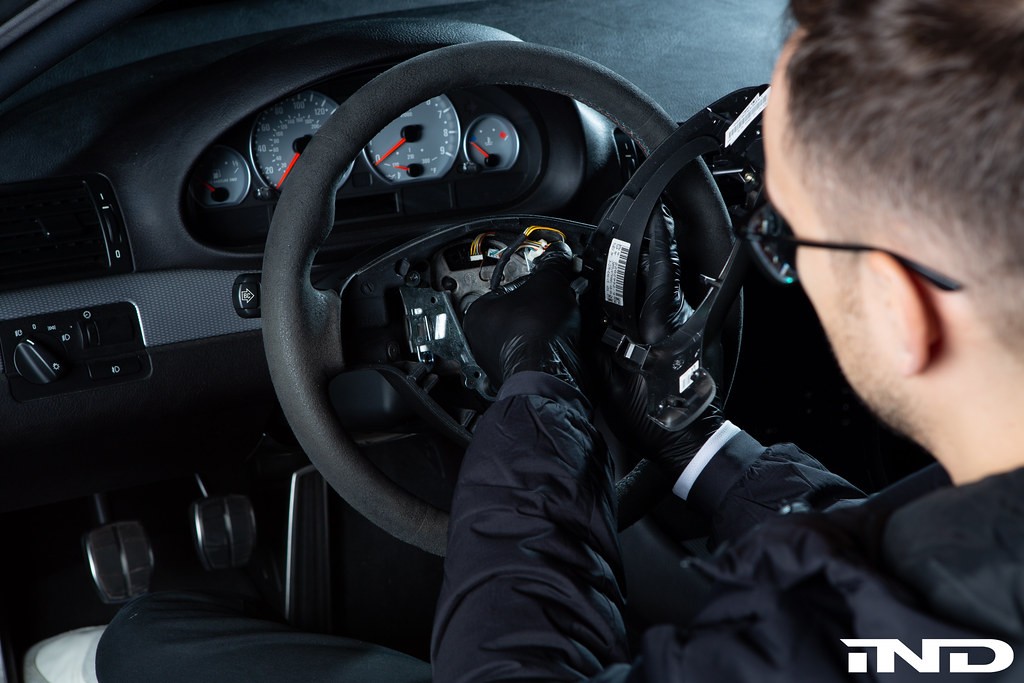

    STEP 1: Disconnect battery and remove airbag by inserting flat-head screwdriver or small torx head into the receptacles on the rear of the steering wheel and pressing on the retention spring that secures each side. Disconnect airbag plug.

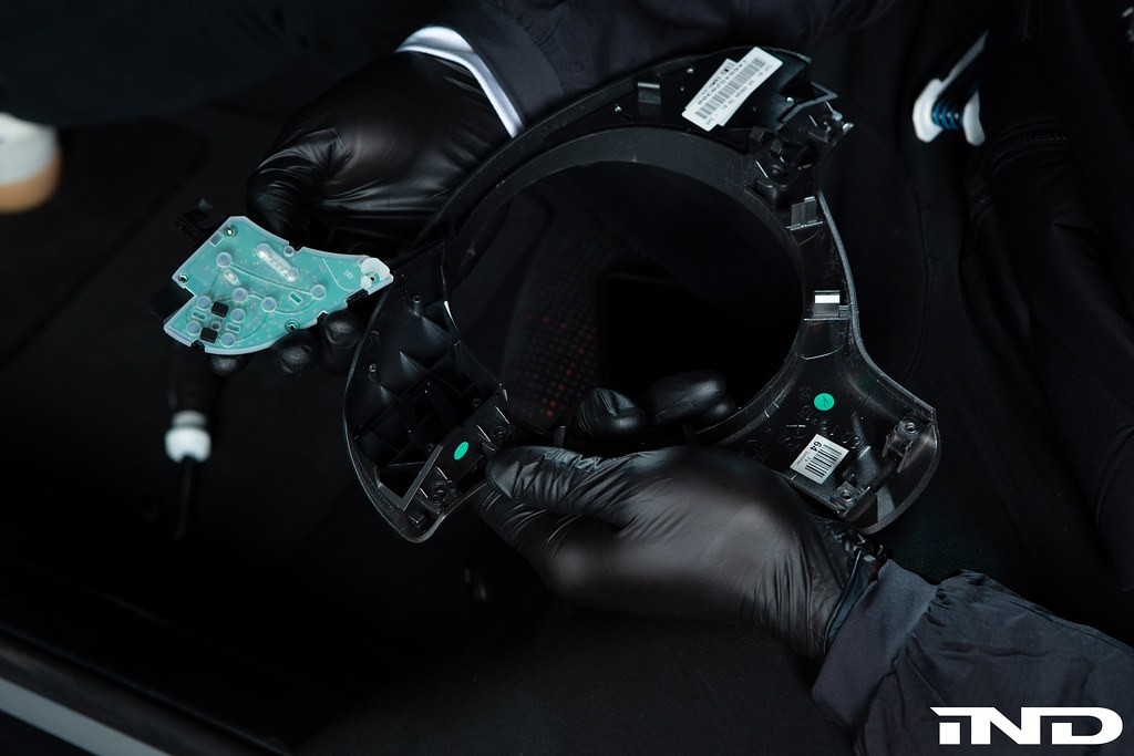

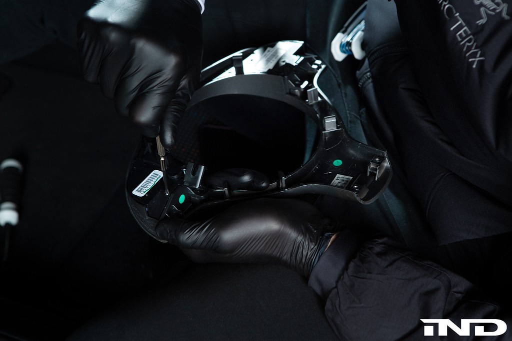

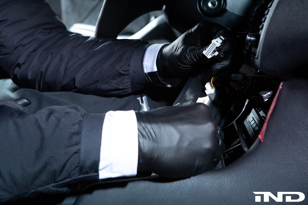

    STEP 2: Remove x2 T20 screws that secure the rear of the lower steering wheel trim and the front x2 T20 screws from the inner steering trim. Remove the trim by pulling from the top section first and detach the M-Track Mode button harness prior to completely pulling the steering trim away.

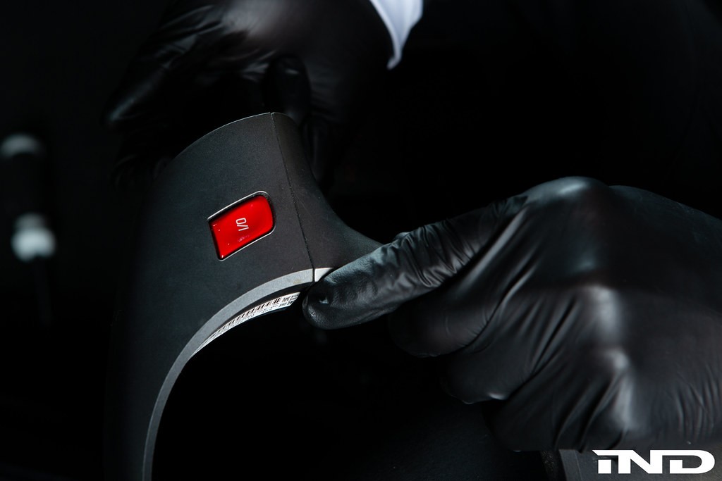

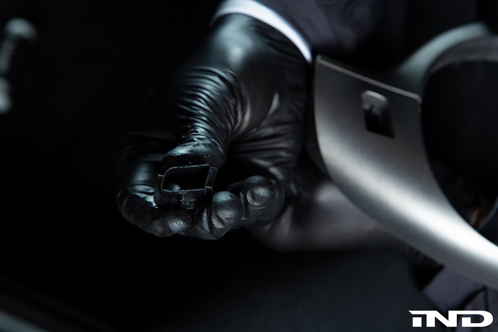

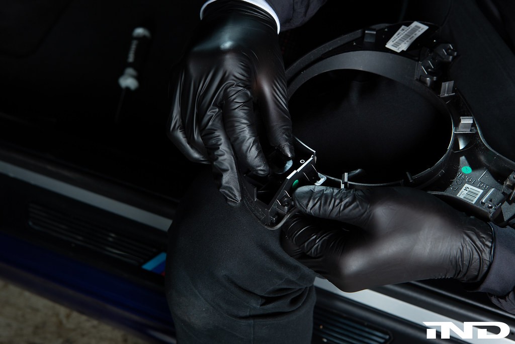

    STEP 3: Remove x4 precision phillips screws from the M-Track Mode controller panel and remove plastic spacer securing button; replace original button with new red version. Installation is the reverse of removal.

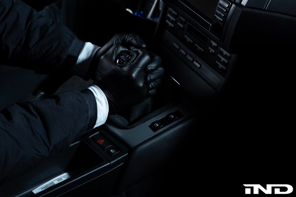

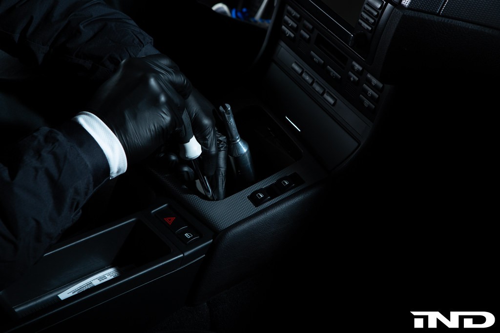

    STEP 4: Remove shift knob by forcefully pulling straight up; being careful not to hit yourself upon release. Pull up on the shift boot to unclip its frame.

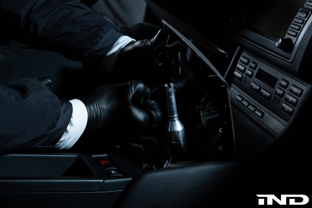

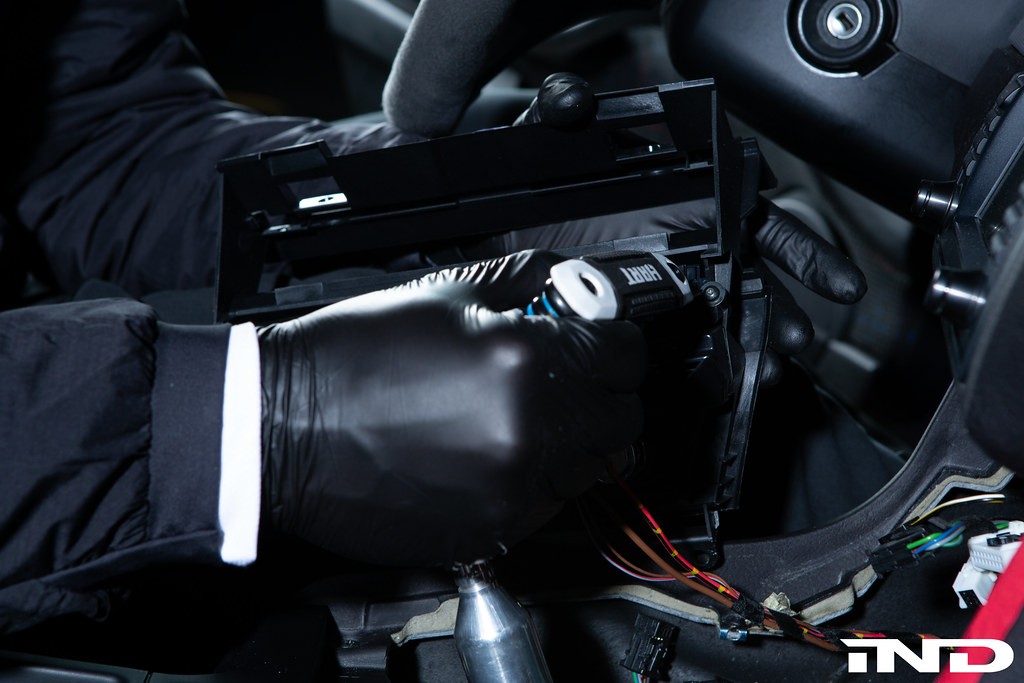

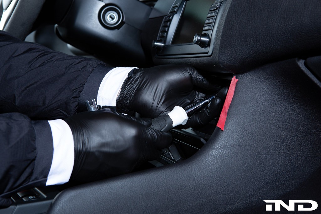

    STEP 5: Remove phillips screws securing center console trim and detach window switch harnesses.
    Click image for larger version  Name:	51749073823_98d4996ae3_b.jpg Views:	3 Size:	73.2 KB ID:	152781
    Click image for larger version  Name:	51748001637_a46af678cf_b.jpg Views:	3 Size:	90.8 KB ID:	152782

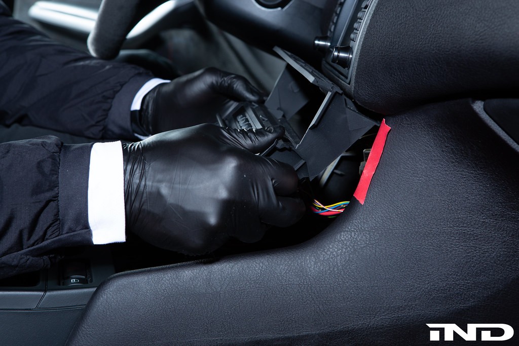

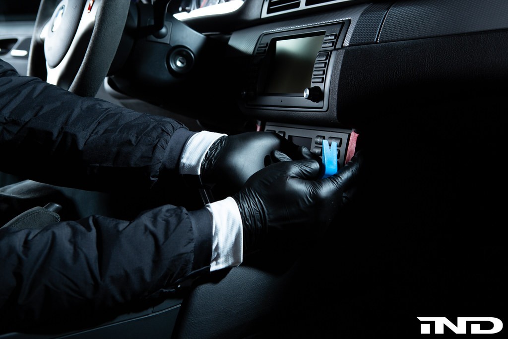

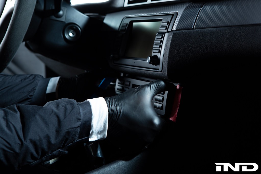

    STEP 6: Remove storage compartment by pulling straight out. For cars with lower climate control unit, place tape on console sides and begin by slightly prying to release climate module. Once able, remove by hand and detach harness.

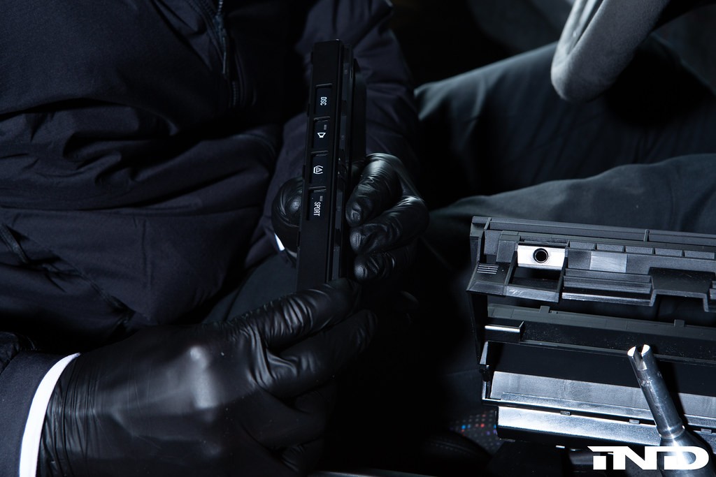

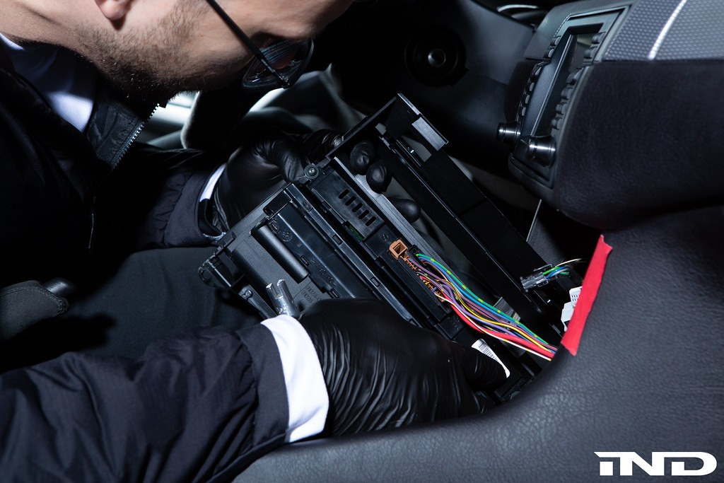

    STEP 7: Remove screws securing center button console and ashtray frame; detach controller harness to easily expose the rear; ashtray lighter can remain connected.

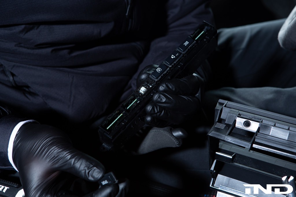

    STEP 8: Remove x2 T10 rear screws securing button console and remove.
    Click image for larger version  Name:	51749696190_7c424ff7b1_b.jpg Views:	3 Size:	111.0 KB ID:	152789

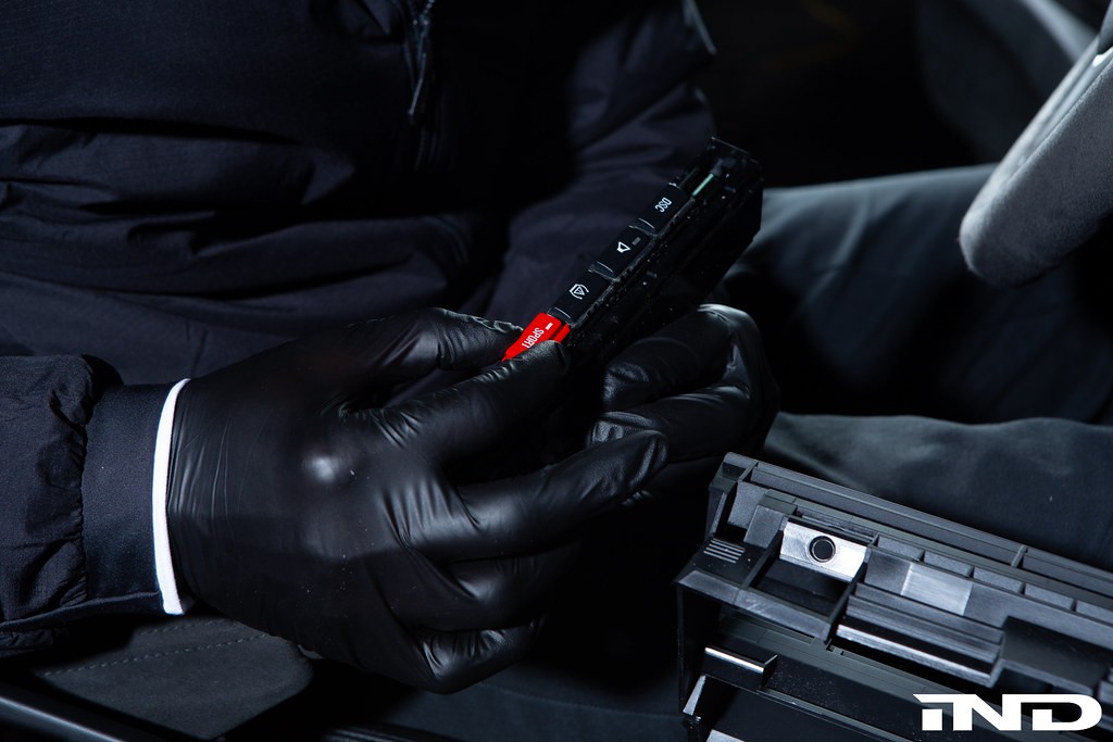

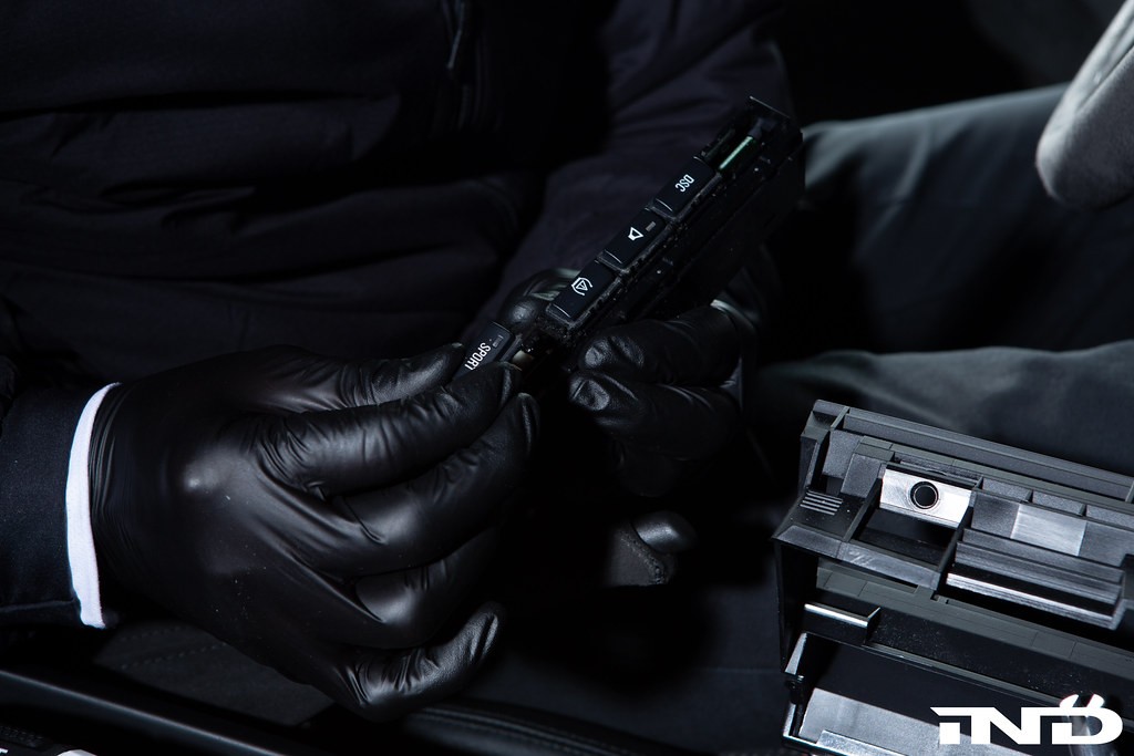

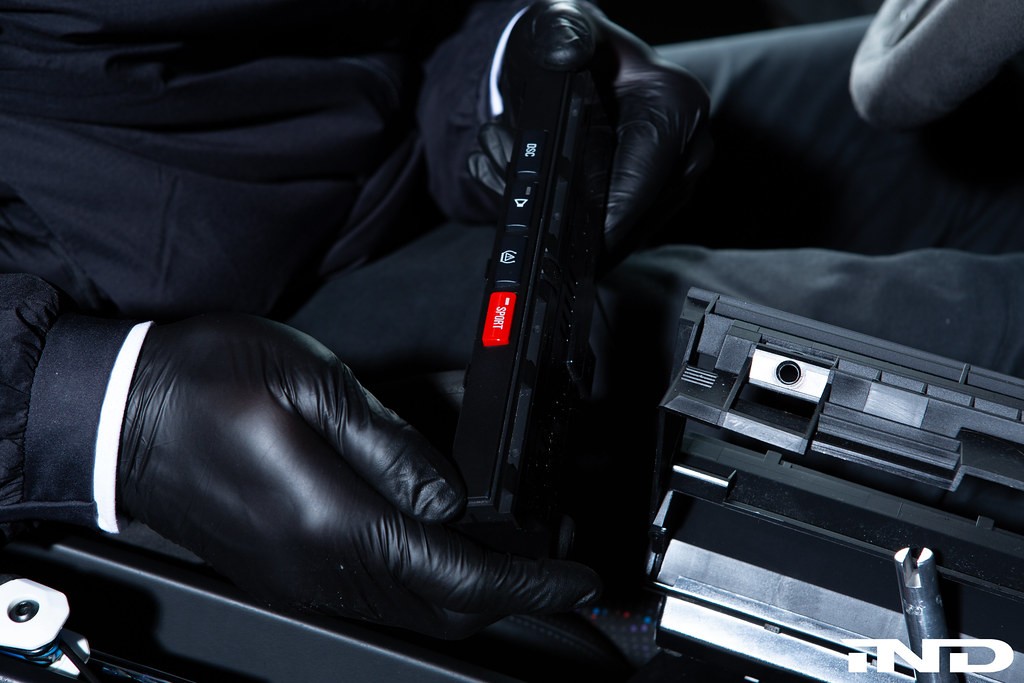

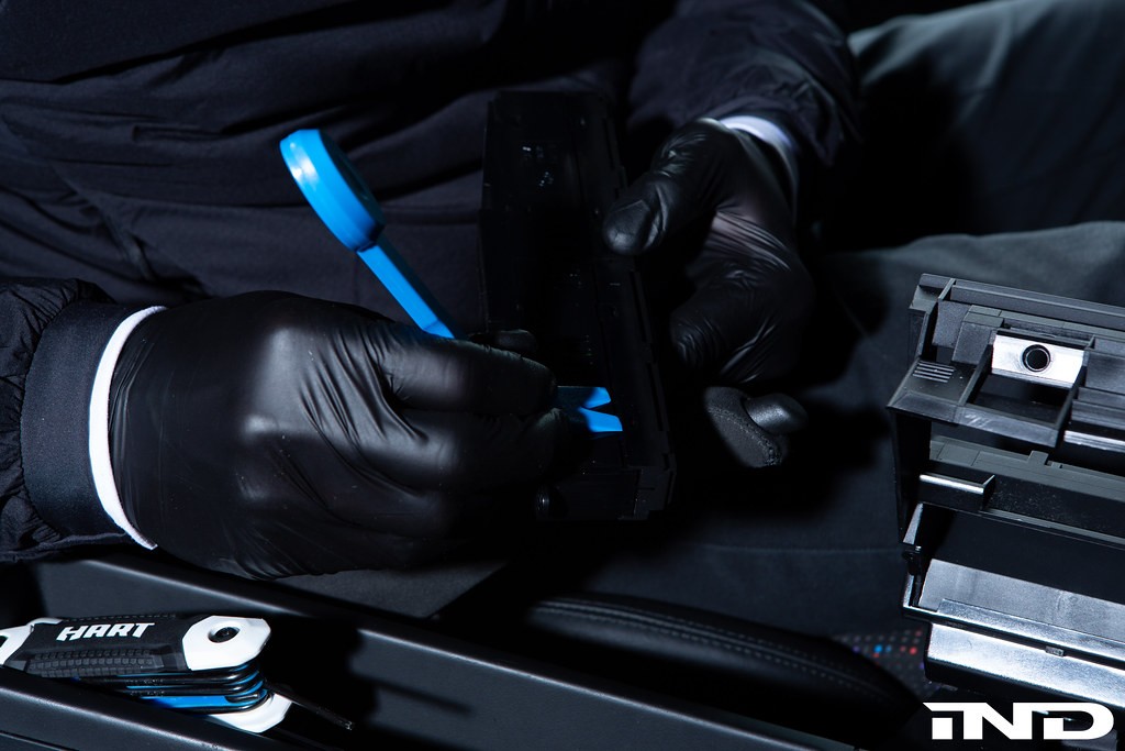

    STEP 9: Using a pry tool, detach the tabs holding the button console together. Pull the original Sport button off and replace with new red version.
