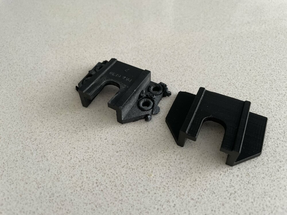

    Following on from the discussion below I drew up an STL file for this part and have test printed it to confirm the dimensions match exactly, the speed-nut fits, etc.
    This STL is provided as is with no warranty express or implied on my part. You're welcome to use, print, modify, share as needed.
    Please note that the original part is stamped as PA6 GF30 which means it is a Polyamide 6 plastic with 30% glass fibre. There is a 3D printer filament available which is a Nylon 6 (Nylon is a type of Polyamide, so Nylon 6 is pretty similar to PA6) with 25% Carbon Fibre which is what I'm planning to use when I get round to actually doing this.
    Please also note that the STL I have created does not have the holes in it, as I plan to bond/epoxy the brackets in place. You're welcome to modify the STL to add the holes if you wish.

    Hi all,
    Apologies if this is already addressed somewhere, if it is I couldn’t find it.
    I was doing some brief investigation tonight into why my car’s rear bumper/diffuser fitment is so awful.
    It turns out that all the plastic mounts affixed to the underside of the kevlar bumper carrier have detached themselves, so the rear bumper isn’t held up/supported from the bottom.
    I am fortunate that one of the plastic mounts was still attached to the rear bumper (although it had detached from the Kevlar carrier) so I was able to remove it.
    It appears as though these plastic brackets come as part of the Kevlar carrier itself (BMW part number 51127894853) so I’m fairly sure there’s not any good replacement options beyond buying a new one or getting a second hand one to scavenge.
    My plan at this point is to recreate the part in CAD and 3D print in nylon or similar. I can then rivet these to the Kevlar carrier in the correct locations.
    Thought first though that I would check here to see if anyone has any suggestions / has been through this themselves?
    Thanks in advance.
    Matt
