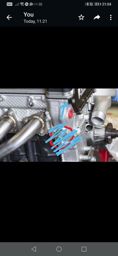

    So even though I religiously use a torque wrench and check my calibration (crudely) every week, somehow I've still managed to strip out the hole in the head for the vanos mounting. It brought out the entire threading with the bolt so now I need to fix it Click image for larger version  Name:	Screenshot_20220222_210443_com.whatsapp.jpg Views:	0 Size:	31.6 KB ID:	155285
    could I use a helicoil kit but leave the vanos in place.
    The vanos hole is definitely bigger than 6mm and probably the 6.3mm drill bit which is supplied for the helicoil. So therefore using the hole as a guide to keep the drill straight as I drill. Then tap the hole that's in the block and fit the helicoil into the block?
    If smaller obviously ill need to strip down but in the case that it's bigger, I can't see any issue using the hole as a guide right?
    Secondly could I fit a stud and then use a nut to fix the vanos on rather than a bolt, it will reduce issues I assume as when tightening there is just a pull on the threads rather than a twist and pull with a bolt?

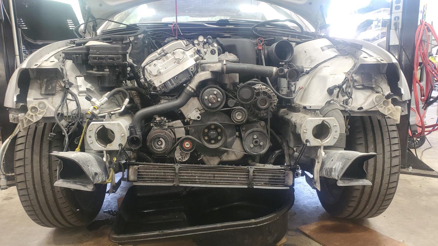

        When i did this I used timesert with the vanos off. Even with the vanos off it was a pita with the rad in place. Need a low profile right angle drill to do it right.
          Couple years ago i snapped half the bolt in the same spot. George Hill managed to remove the remainder of the bolt and rethread this for me but the vanos was already off and the front end had to come off

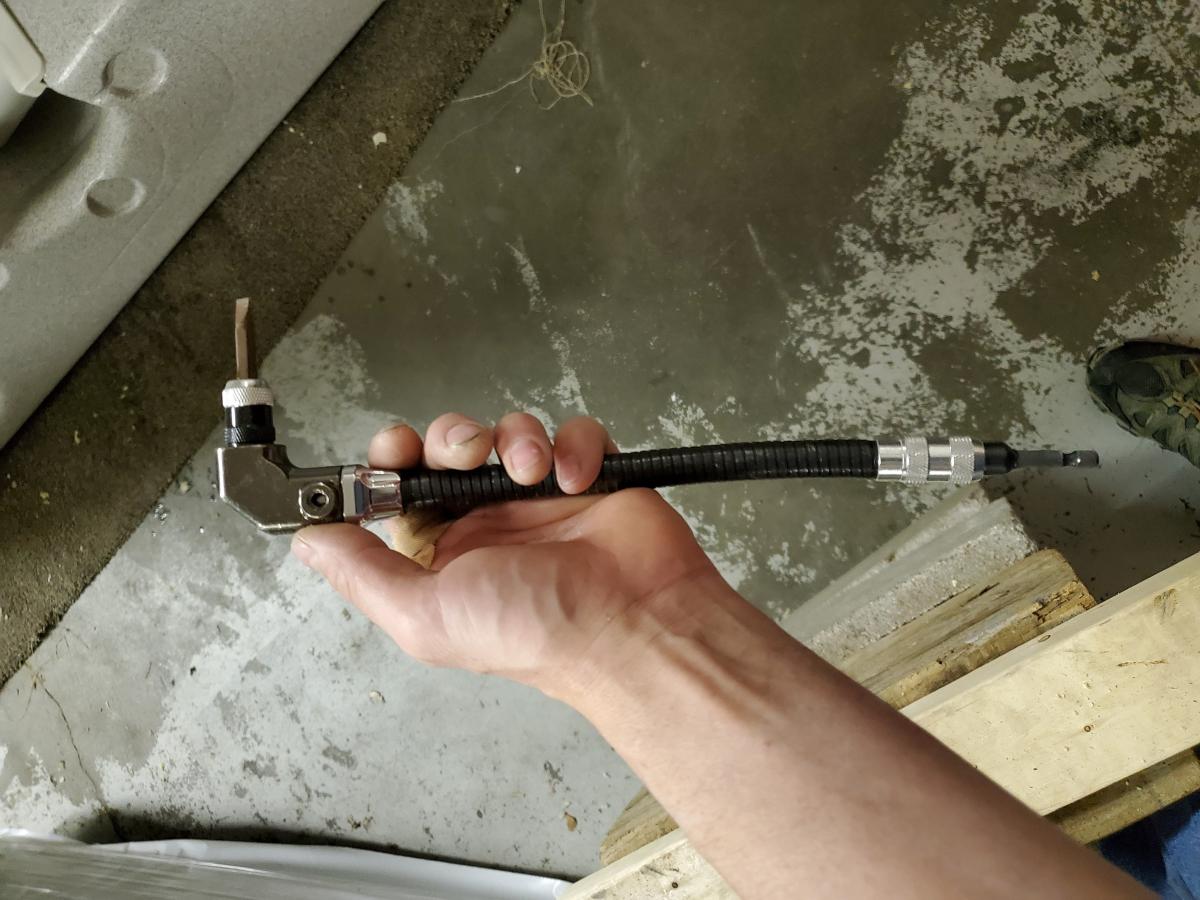

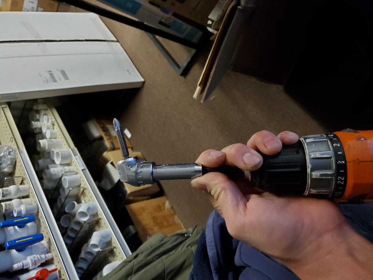

                        I have 2 of the 90° deals at work, the lower photo shows a Dewalt branded product, right by my thumb it's threaded so you can put a small hand hold in, handy as hell.

                            Timesert kit came with a drill bit that fits in a tap wrench.
                            I also have 90 deg drill bit attachment but I didn’t like the lack of control you get when using it. Last thing you want is to let the drill bit catch the aluminum while drilling and marr it. Slow and steady with the drill bit by hand and you can’t mess it up.
