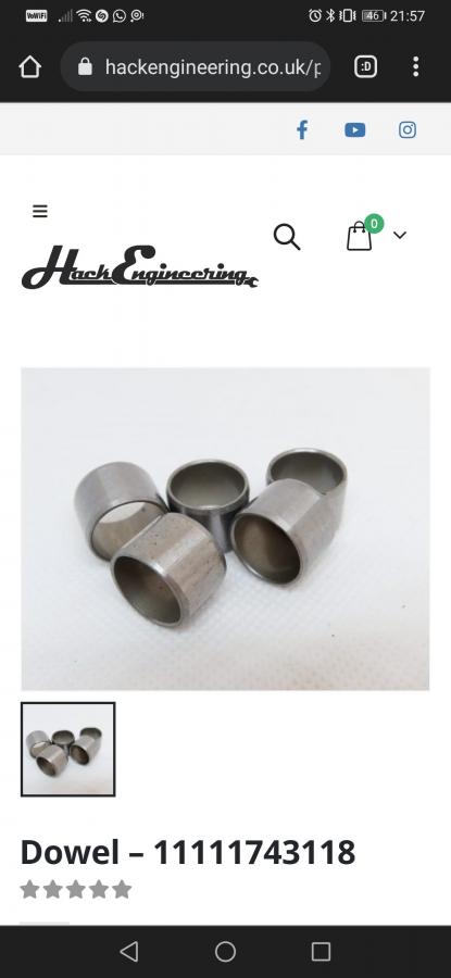

    Not sure what you mean by dowel but I assume you mean the vanos mounting holes themselves are the dowels?
    Are you saying helicoils are inferior? Surely for such a small torque they won't be bad? I'm not sure they are as readily available here in the UK

      There is a dowel on the outer mounting holes for the Vanos.
      Yes, IMO heli coils are inferior.
        YMMV and all that jazz.
        Thanks!
        Out of interest what makes the helicoils inferior in your eyes?
        You mean this dowel, makes sense. Totally forgot about those being in there
