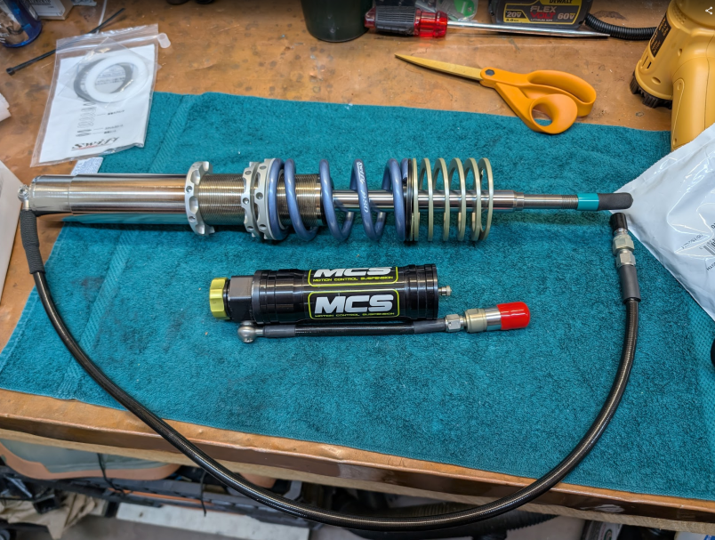

      I haven't installed them yet, but I have a set of 2-way remotes for my Cayman. I picked them up used, cleaned them up, had them rebuilt by MCS this past winter. The fit and finish of these shocks are simply amazing.
      Their customer service is also spectacular. They found the original schematics based on the serial numbers of the shocks, sent them to me to have, which also helped me calculate spring lengths.

        FWIW...

        wish I had those quick connects on mine, what a PITA to install without
          They are a pretty slick setup. I can pass the hoses through relatively small holes that already exist in the chassis. No need to enlarge anything.
          I also picked up a Nitrogen tank to play around with air pressures. They come set to 175psi and you can pretty easily go up/down a good amount. It might be too much witchcraft for me, but we'll see.
            I've got a small 5lb tank as well, definitely a need to have if you're running remote cans
