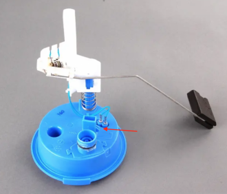

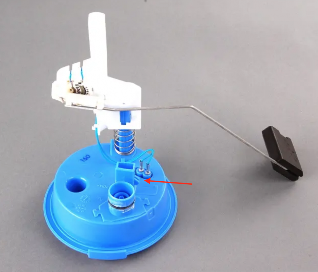

                    The driver's side sending unit has a small clip that secures the sucking jet pump which extends from the driver's side of the tank to the passenger side. After that tab fatigues, the jet pump can fall off the driver's side sending unit and fuel will get stuck on that side. It is easy enough to check if you want to troubleshoot before buying the sending unit.

                      Try a new sending unit. If you’re on a budget then get a VDO brand. If it still acts up then try the sucking jet pump. Even though the jet pump is supposed to suck fuel from the left side of the tank it could still be slowly failing.
                      Try the sending unit first since it’s a cheaper option vs the sucking jet pump.

                            This is exactly what happened to me. That clip broke and the fuel hose was resting (because of the way it's constructed) at the same height as the fuel when at 1/4 tank. Once fuel went below the 1/4 mark there was nothing left for the hose to suck and the car would act as you would expect.
                            I wasn't sure what the exact cause of my issue was. So I ordered both the pump and sending unit and planned to install both figuring one of the two were the culprit. Once I pulled the sending unit I realized immediately what the issue was.
