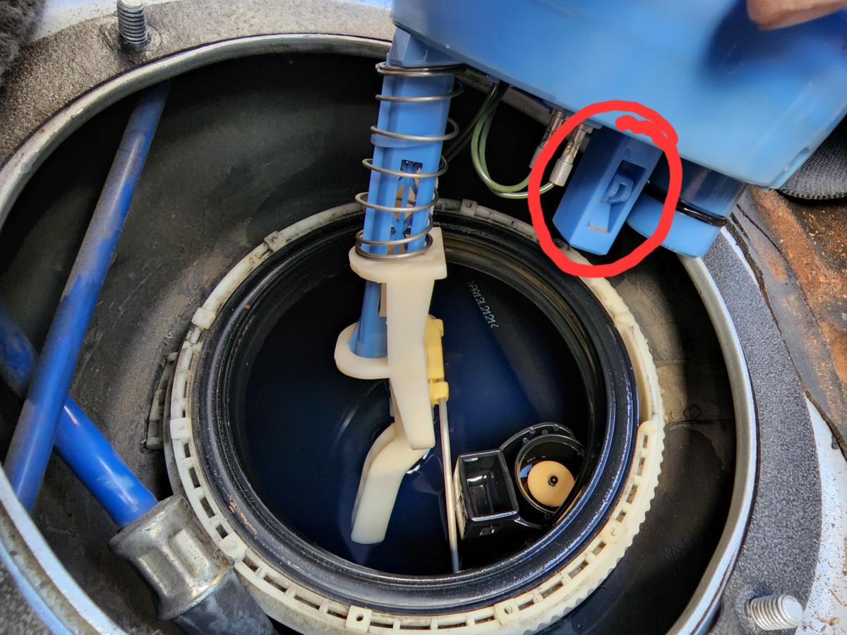

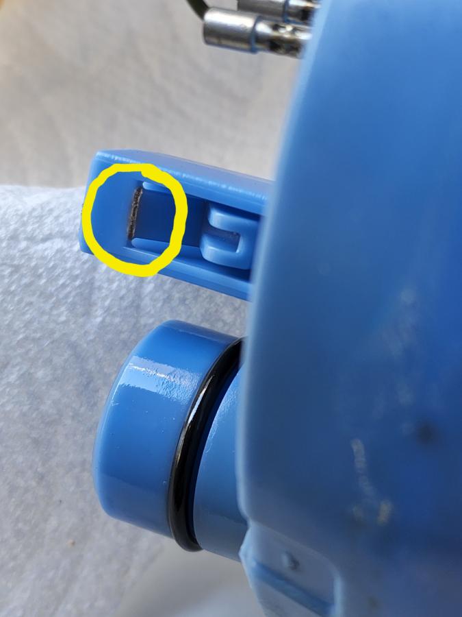

      The driver's side sending unit has a small clip that secures the sucking jet pump which extends from the driver's side of the tank to the passenger side. After that tab fatigues, the jet pump can fall off the driver's side sending unit and fuel will get stuck on that side. It is easy enough to check if you want to troubleshoot before buying the sending unit.
      Click image for larger version Name:	pic.png Views:	0 Size:	792.5 KB ID:	157280
      Well, you were right on the money.
      I took out the sending unit and the tab holding the sucking jet pump was fatigued to the point where I could touch it and it finally gave out. Check out the photos.

          Yeah, almost always that lever sender unit tab and not the jet pump itself.
