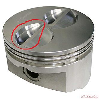

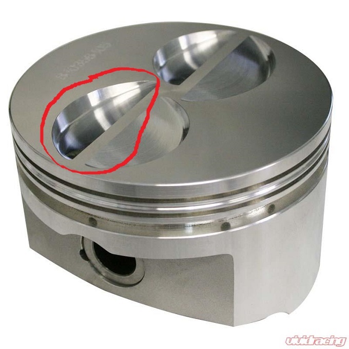

            Good stuff. Wouldn't pistons with reliefs be a simpler approach than tuning a tune modified VANOS?
            I don’t know what pistons with reliefs are
              Anthony, they dish out the pistons where the valves would hit the pistons. See the area circled in red on the attached photo. Click image for larger version
