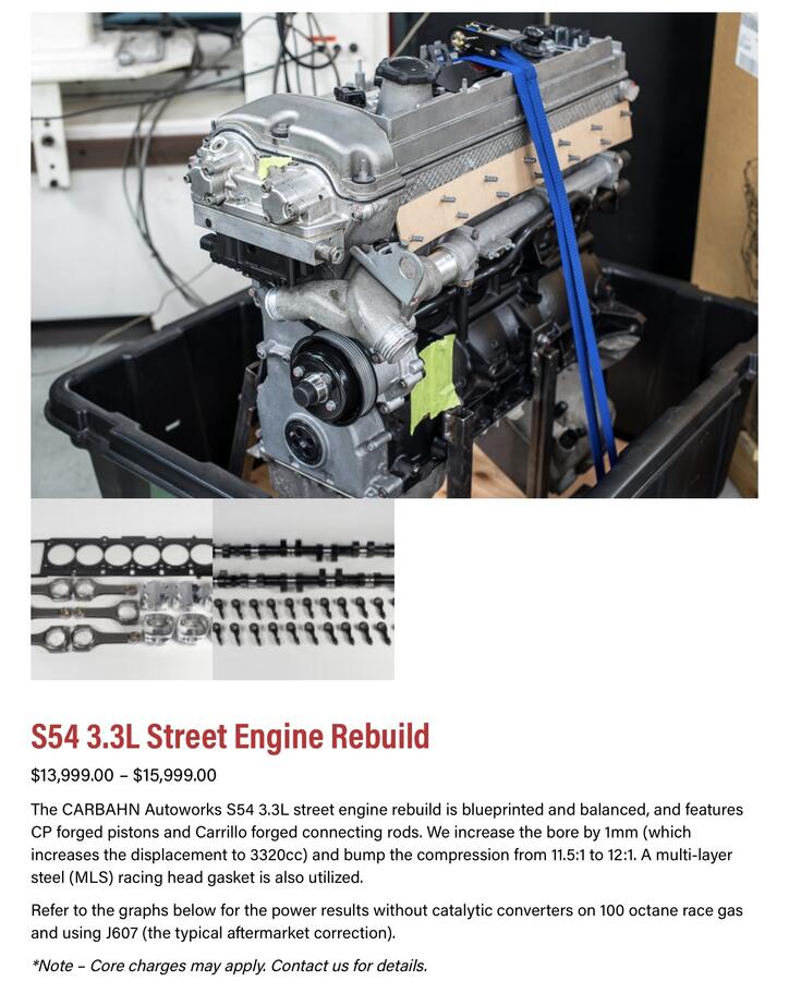

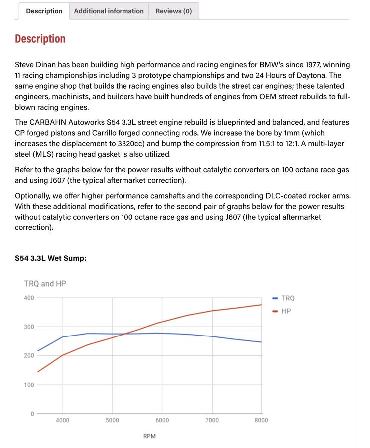

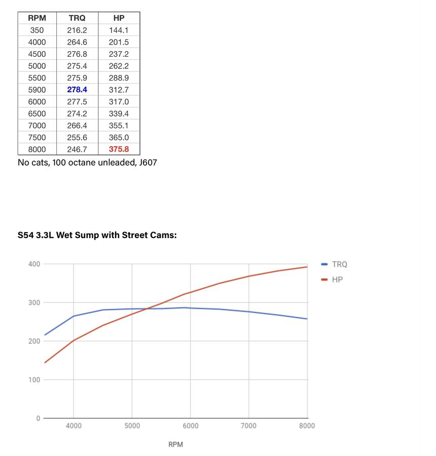

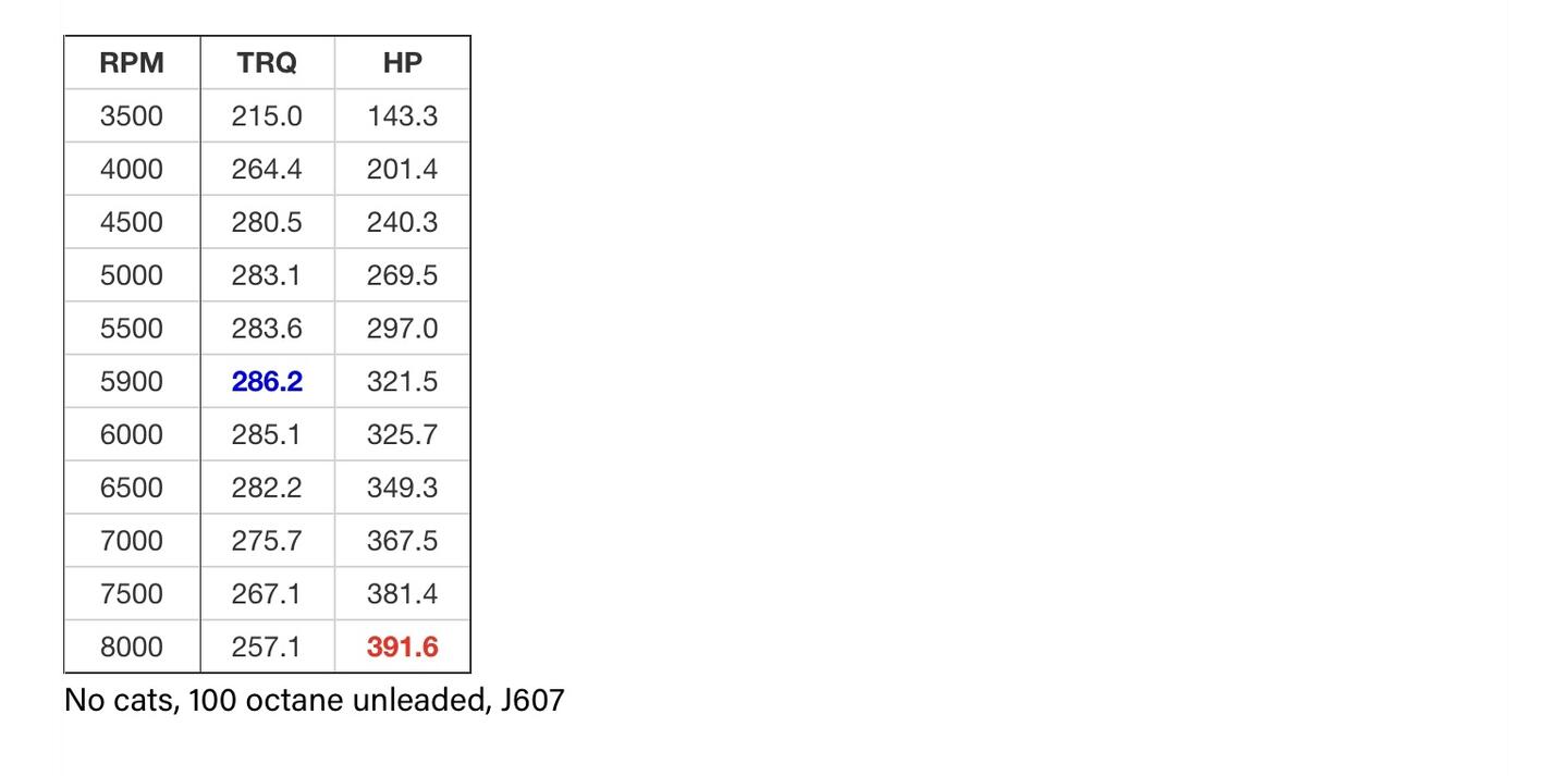

          Steve Dinan has a new gig it appears, and he is offering up this - a 3.3 liter S54.
          https://carbahnautoworks.com/product...ngine-rebuild/

              That's a lot of money for tens of horsepower at the wheels. Keep in mind those dyno graphs are done on 100 octane gas. A 4.10 rear end and smaller diameter tires are way cheaper!
