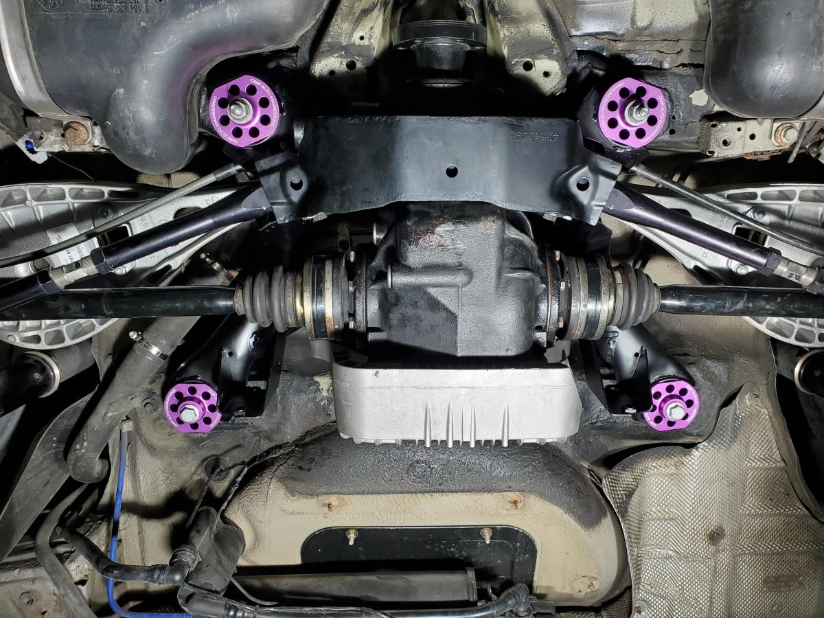

          I scribed a line around each RTAB bracket and tried my best to line them up where they were previously, granted I will have had a change in geometry from the CMP bushes but I'll double check those brackets.
          Another little thing I *think* is different as I don’t trust my memory 100% is that before the shock was "in line" with the hub, so I would simply have to moved the hub up/down to mate the shock with the hub in order to insert the bolt.
          I now must pull the shock foward (towards front of vehicle) about 1/4"+ for the holes for the shock/hub to meet to insert the bolt.
          Quite likely as you say about a bunch of small things adding up but still puzzling..
          Edit: I also wonder about my new Turner monoball RTABs, I torqued the bracket around the RTABs to 81 ft. Lb. and then installed the brackets. I could still move the brackets by hand after torquing the RTABs but wonder about preload.
          However I see no possible way to torque the RTABs once the brackets are bolted to the chassis..

                Does the monoball design need to be preloaded? I thought I read they did not. Maybe that would explain why you can move the bracket. On stock rubber the bracket does not move unless forced.
                  #53
                  Correct. A ball bearing is not a bushing plain and simple. Both bushings and balljoints are susp joints, but they are not the same thing.

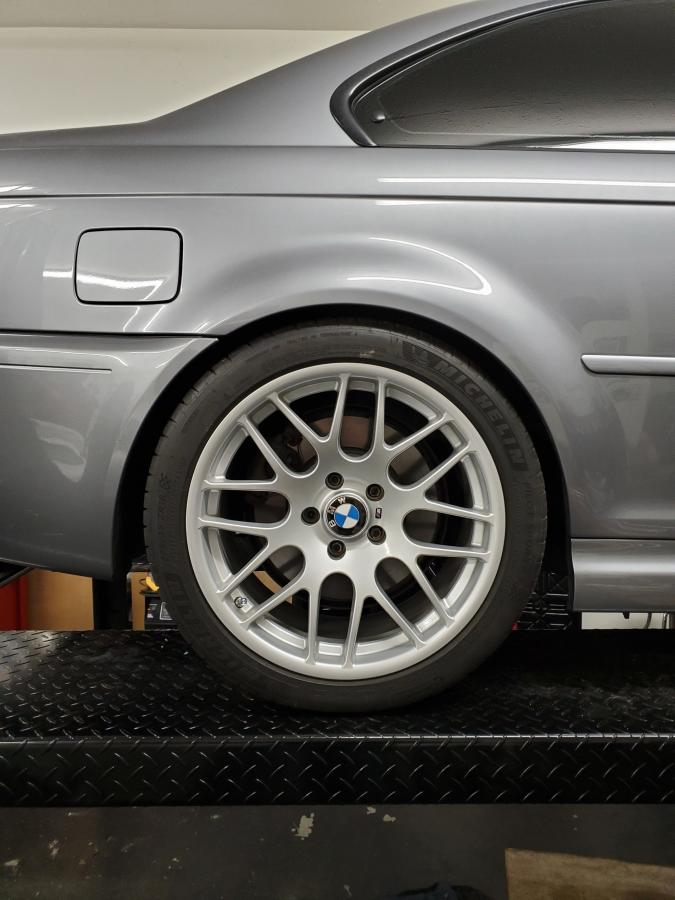

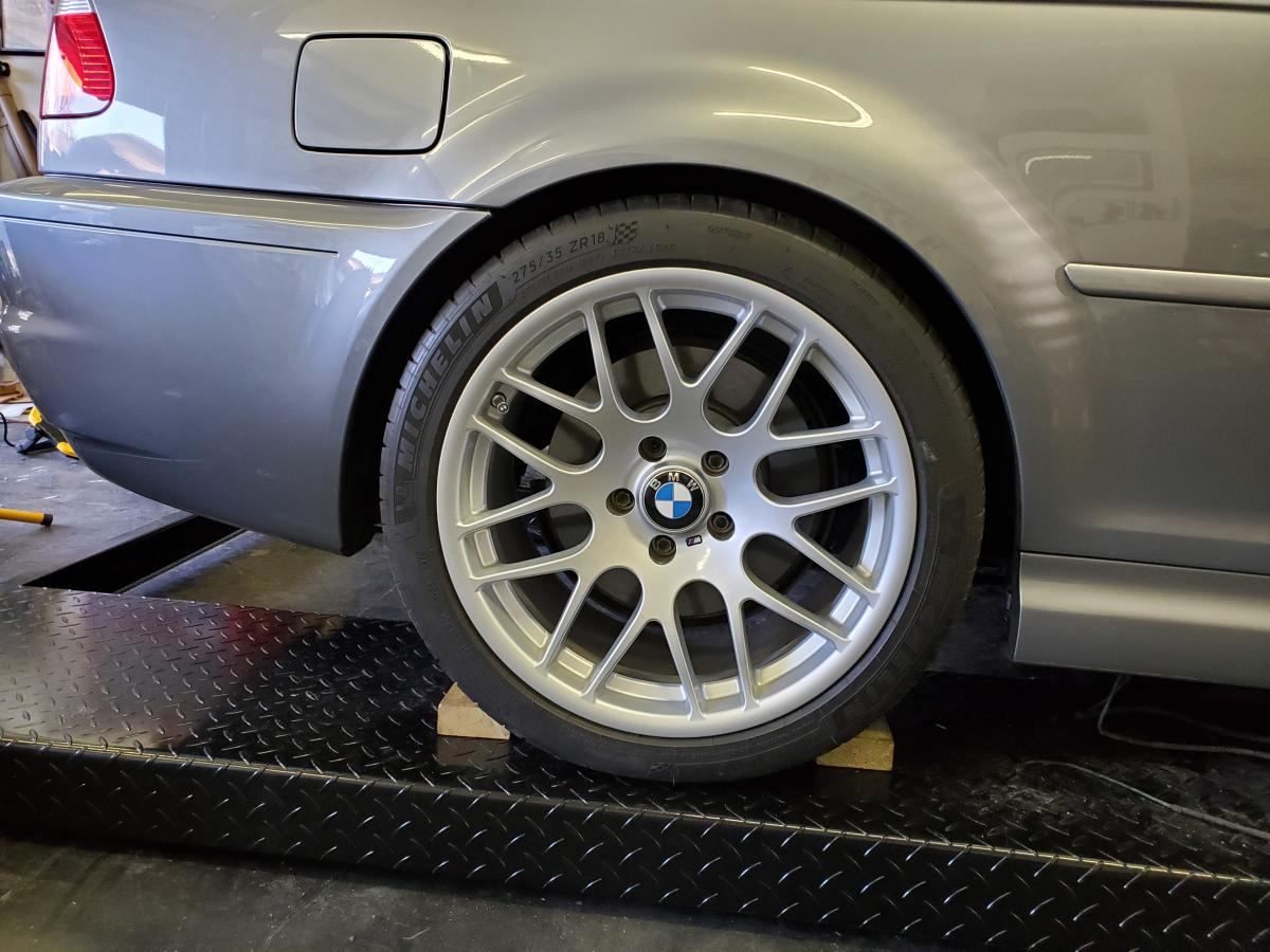

                          Update: Ride height most definitely went down after a short drive around town, still a bit higher than it was before but maybe it has a bit more to go, didn't push the vehicle very hard.
                          Now I am dealing with a new sound (granted the whole back seat/under seat sound deading material/door cards/trunk floor/carpeting are still not installed) that I have not heard before.
                          Keep in mind CMP/Vincebar/Monoball RTAB's/All new OEM everything else bushing wise, some were worn.
                          Sounds like either
                          - Diff. whine, that would be annoying as it's quite loud (fluid topped).
                          - Parking brake not adjusted properly and rubbing in rotor
                          - Dust shield rubbing inner part of rotor(s), these did get bent slightly when I set them down a few times with the shield taking some of the weight of the entire hub.
                          Here are some before/after driving photos, the different angle doesn't show it quite so well, but I'd say I lost almost 50% of the additional fender gap.
                          Click image for larger version  Name:	20220314_181711.jpg Views:	0 Size:	129.1 KB ID:	160066 Click image for larger version  Name:	20220320_215928.jpg Views:	0 Size:	68.9 KB ID:	160067
