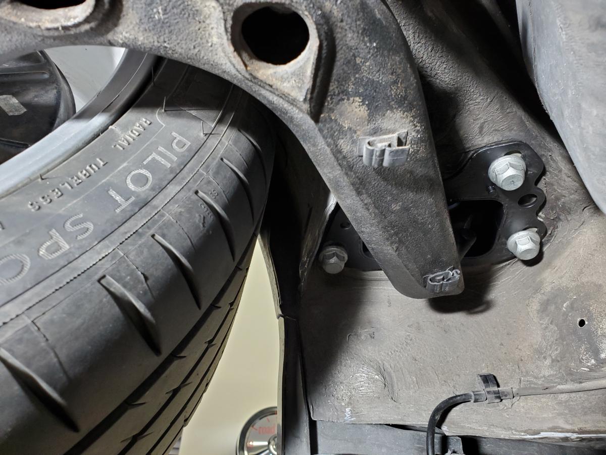

        Can someone put my mind at ease and tell me that this upper control arm listed as "right" is for the passenger side (US car).
        I appreciate everyone's help and Cayn's very detailed information. Just trying to figure out what could have changed the ride height as the bushings should not have raised them this significantly.

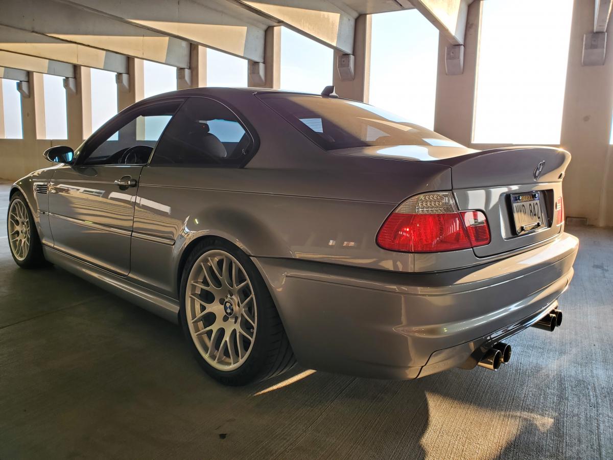

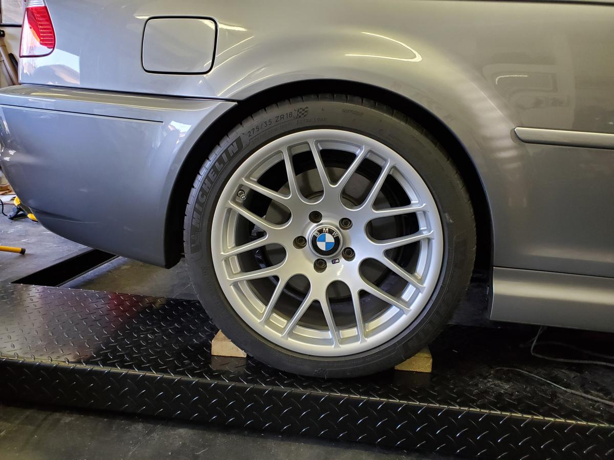

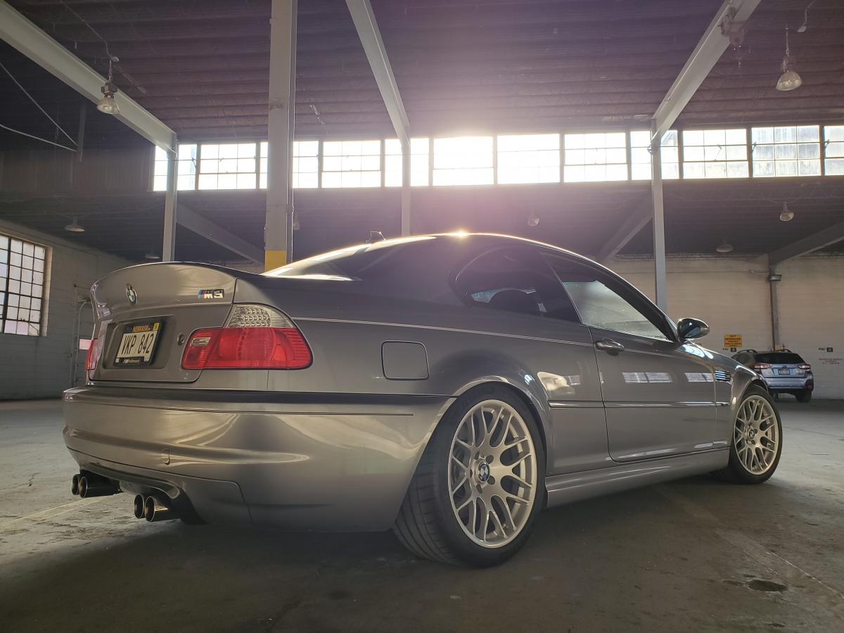

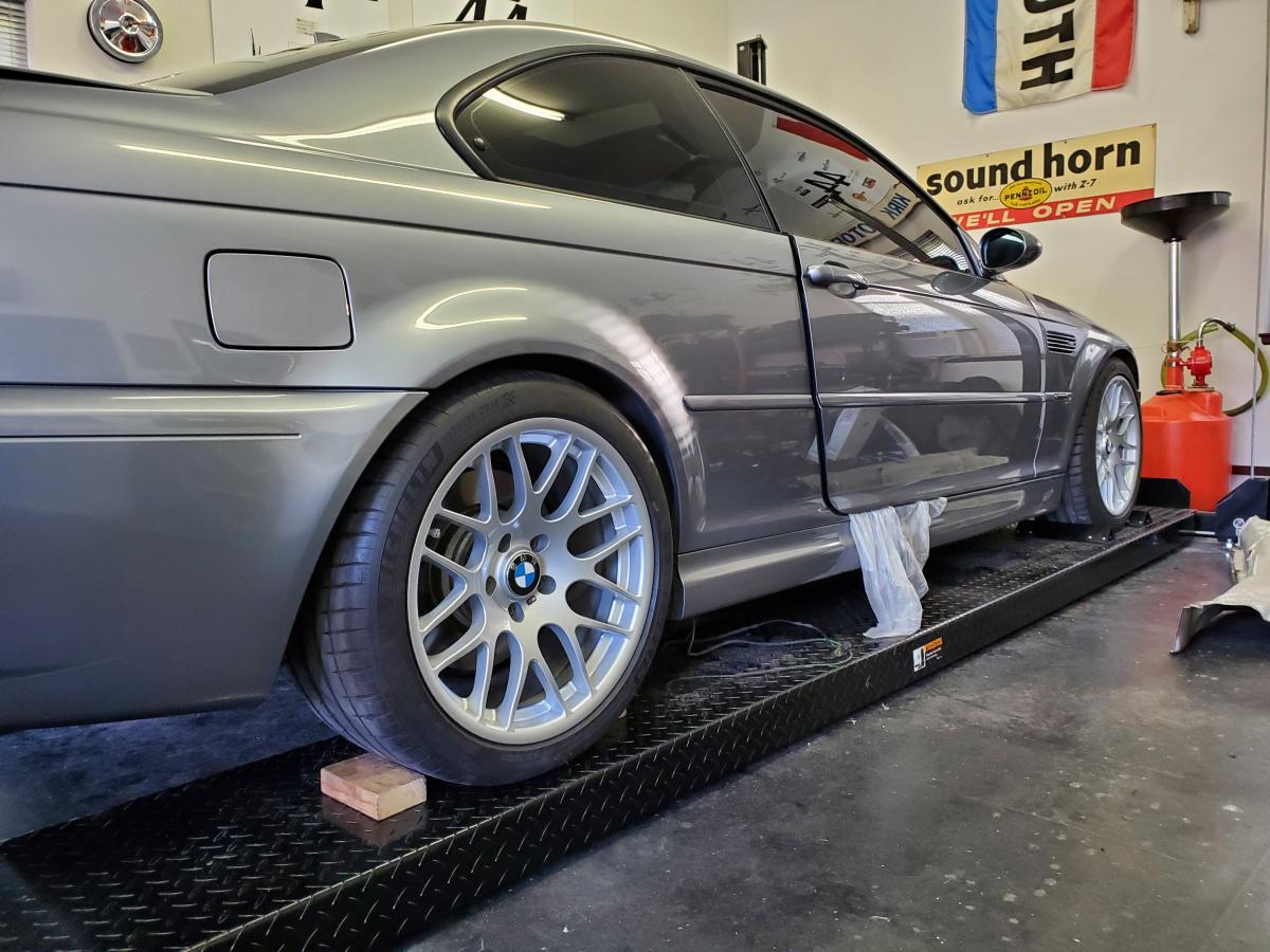

        Here are some before/after shots, also I rocked the car back/forth to no avail.
ID:	159128 Click image for larger version
ID:	159130 Click image for larger version

          Part looks correct.
          Part ending 626 is right side
          Part ending 625 is left side
          Doesnt matter if its rhd or lhd.
          The part of the bushing that sticks out points towards the rear of the car.

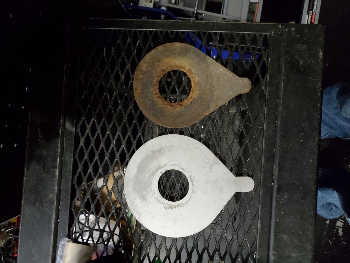

            Also changed were these reinforcement plates for the spring perch, they are the same thickness and I already tried swapping them out with the same result.
            I also installed Turner RTABS vs. some random poly stuff the PO had in there.

                                Originally posted by enjoy_m3 View Post
                                ^ He's right. Put all together and then drive the car around and re-inspect. (sidenote: I have figured out a way to mis-install the rtab brackets, but caught it, lol)
                                Can the RTAB brackets really be reversed and still bolted up flush??
                                I didn't label mine as they were powder coated. Both are torqued and flush w/ body.
                                Here is a shot of the driver's side RTAB bracket installed fwiw. Hope to have car ready to drive by tomorrow.
