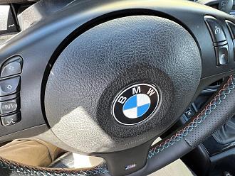

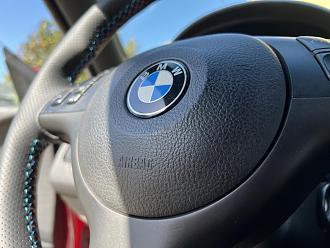

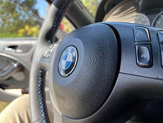

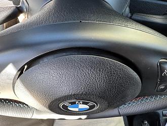

    It's the airbag bracket that got bent when you removed the airbag from the last wheel. Common problem from a horrendous design. Try bending the bracket back or get a spare from a junkyard car.

  • Nate047
    replied
    Thanks, yea I will have another go at it. I thought I was making sure it was away from the wires but maybe that's it.

  • sbay
    replied
    Hey guys, having a weird issue after swapping in a re-wrapped steering wheel. The airbag is sitting a little low and leaning out on the top, is there some trick to lining this all up? I attached everything as it was on my stock wheel coming out, and clipped it back into the plate that holds the airbag as best as I could tell was correct. I cannot for figure out what is preventing it from sitting up at the proper placement. It does not feel like there is more room to click in further. I can jiggle the whole setup around a little. Am I missing something obvious here?

    Oh yea also the horn kind of has a mind of its own now Because the whole setup is not sitting properly I guess? It will go off randomly as I'm turning sometimes. Like the weight of the airbag moves and causes the horn contacts to touch I'm guessing. If I jiggle the airbag around it might stop. Or not. Super cool feature to have in a car while driving around west LA.
    I think it has to do with the wiring. I had the same issue and took off the airbag, re-routed the wires away from any mounting points, and it’s been flush ever since. I hope this helps!
