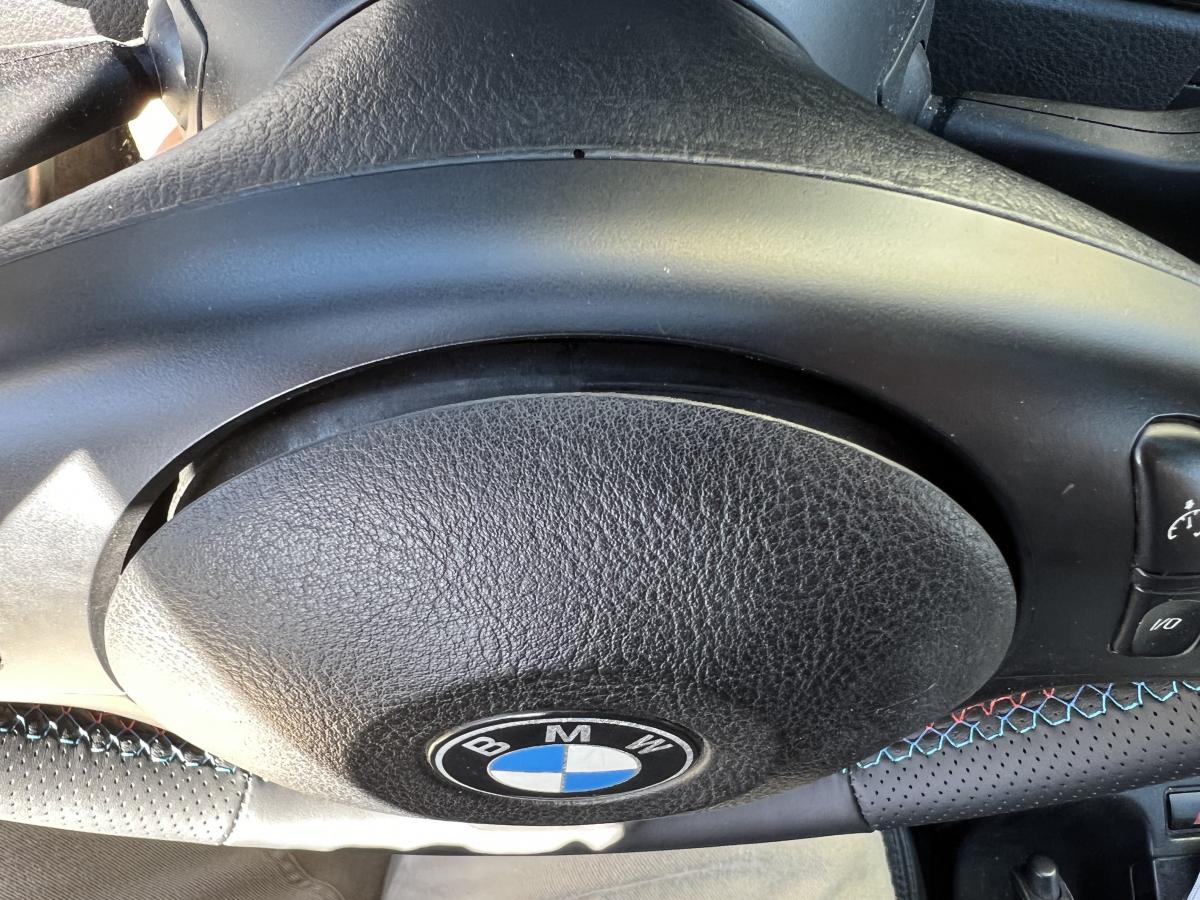

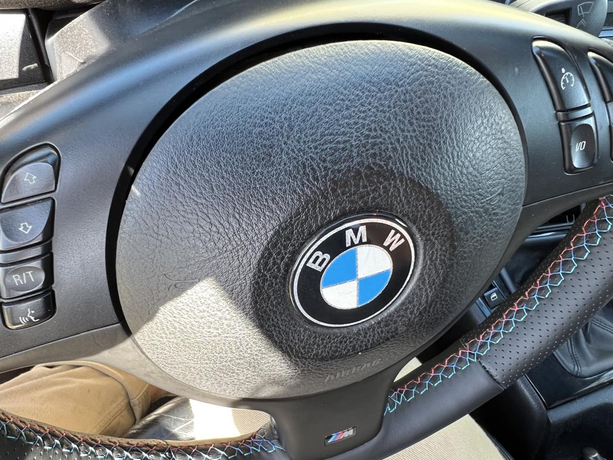

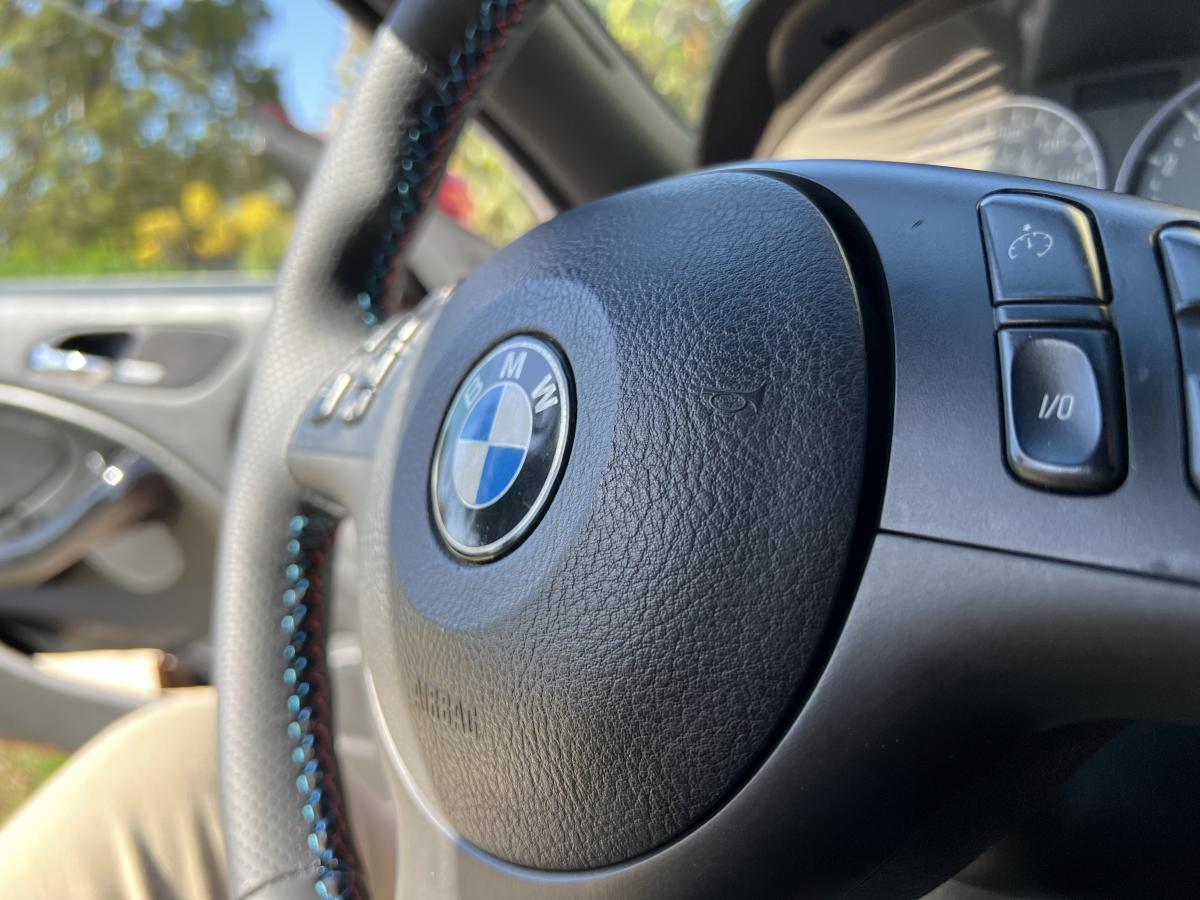

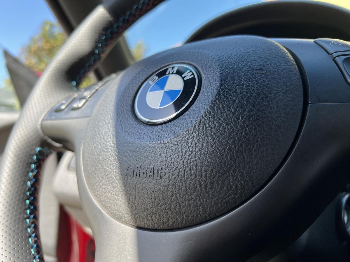

    Hey guys, having a weird issue after swapping in a re-wrapped steering wheel. The airbag is sitting a little low and leaning out on the top, is there some trick to lining this all up? I attached everything as it was on my stock wheel coming out, and clipped it back into the plate that holds the airbag as best as I could tell was correct. I cannot for figure out what is preventing it from sitting up at the proper placement. It does not feel like there is more room to click in further. I can jiggle the whole setup around a little. Am I missing something obvious here?

    Oh yea also the horn kind of has a mind of its own now Because the whole setup is not sitting properly I guess? It will go off randomly as I'm turning sometimes. Like the weight of the airbag moves and causes the horn contacts to touch I'm guessing. If I jiggle the airbag around it might stop. Or not. Super cool feature to have in a car while driving around west LA.

    I think it has to do with the wiring. I had the same issue and took off the airbag, re-routed the wires away from any mounting points, and it’s been flush ever since. I hope this helps!

          It's the airbag bracket that got bent when you removed the airbag from the last wheel. Common problem from a horrendous design. Try bending the bracket back or get a spare from a junkyard car.

                          This has to the most common, likely issue... I recently replaced my steering wheel and found the airbag assembly not seating uniform with the 'new' (rewrapped old) wheel, and initially thought maybe some of the wiring was in the way. I've rechecked the installation 3X - but still sat wonky - never thought that the bracket could be bent (only the right side didn't seat right, and that could easily be a bend of that bracket ~.25-.5"). I assume it would be easy to bend that bracket up (towards you), in previous removal attempts - as when that latching mechanism sticks, I found myself yanking at the wheel with some force.
                            I had the same issue on my ZHP. Some fiddling with the wires fixed it.
