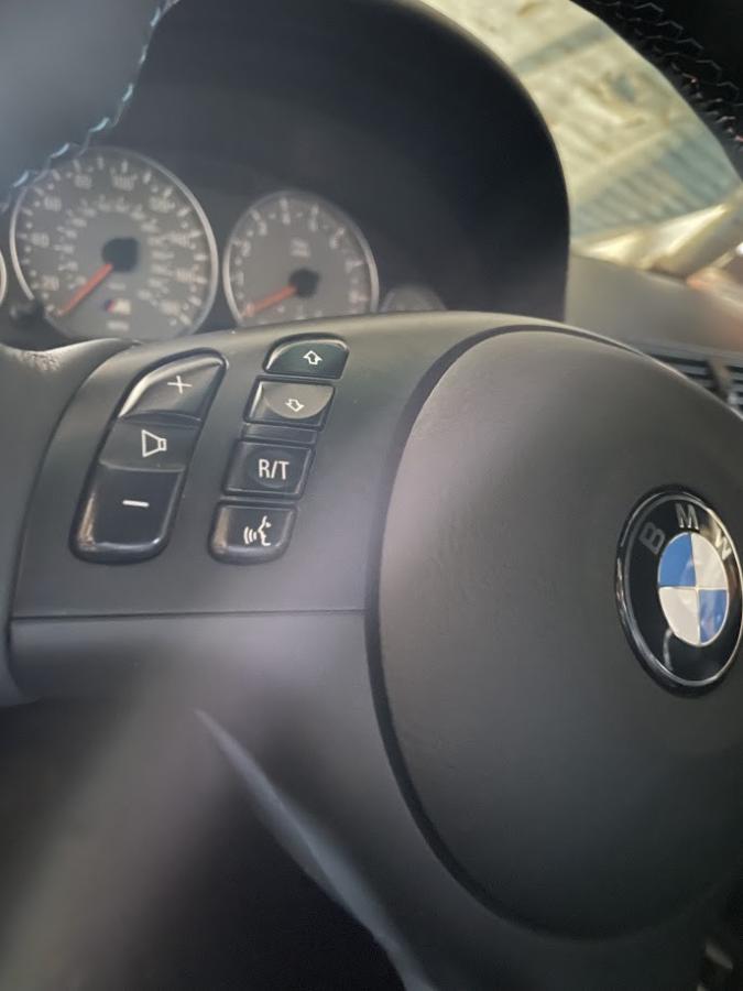

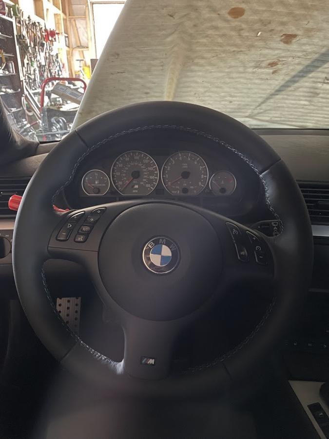

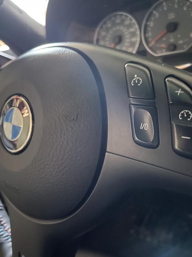

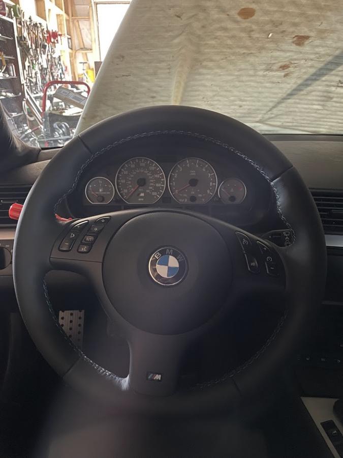

                I just installed my Tanik steering wheel. I am assuming this is a wiring issue with the gap on the right side of the airbag? Can anyone confirm or deny?

                  My Tanik did the same, slightly more gap on right than left, although I noticed it took much more force to remove the RH side airbag plastic tang than the LH side. I may have bent the RH bracket a bit, who knows, I am leaving it.
                  Its all about the bracket/airbag "tang" interface, not blaming the wheel fwiw.
