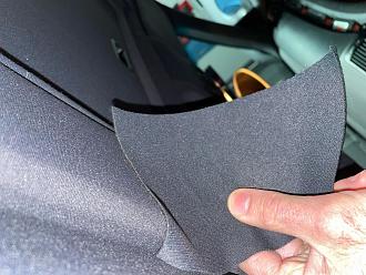

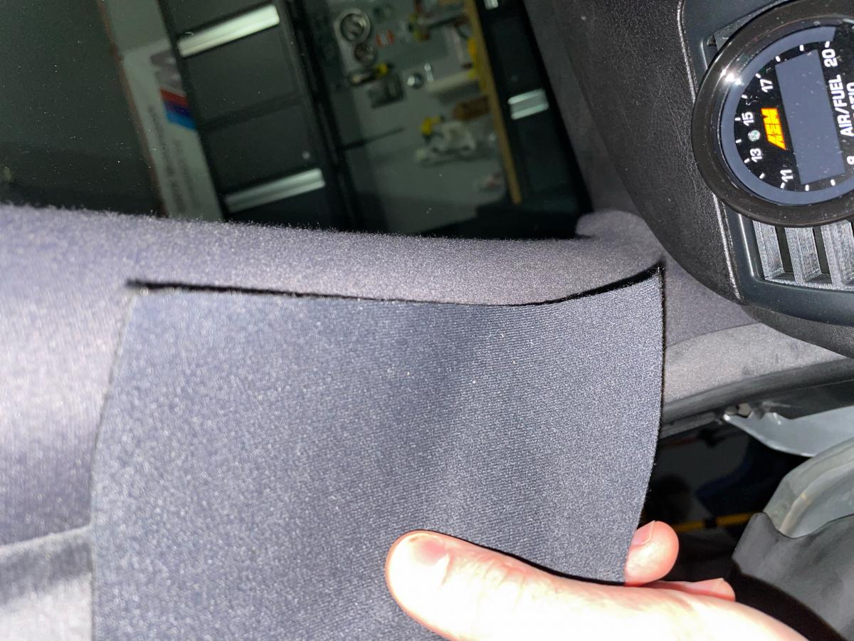

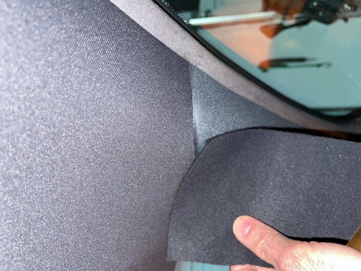

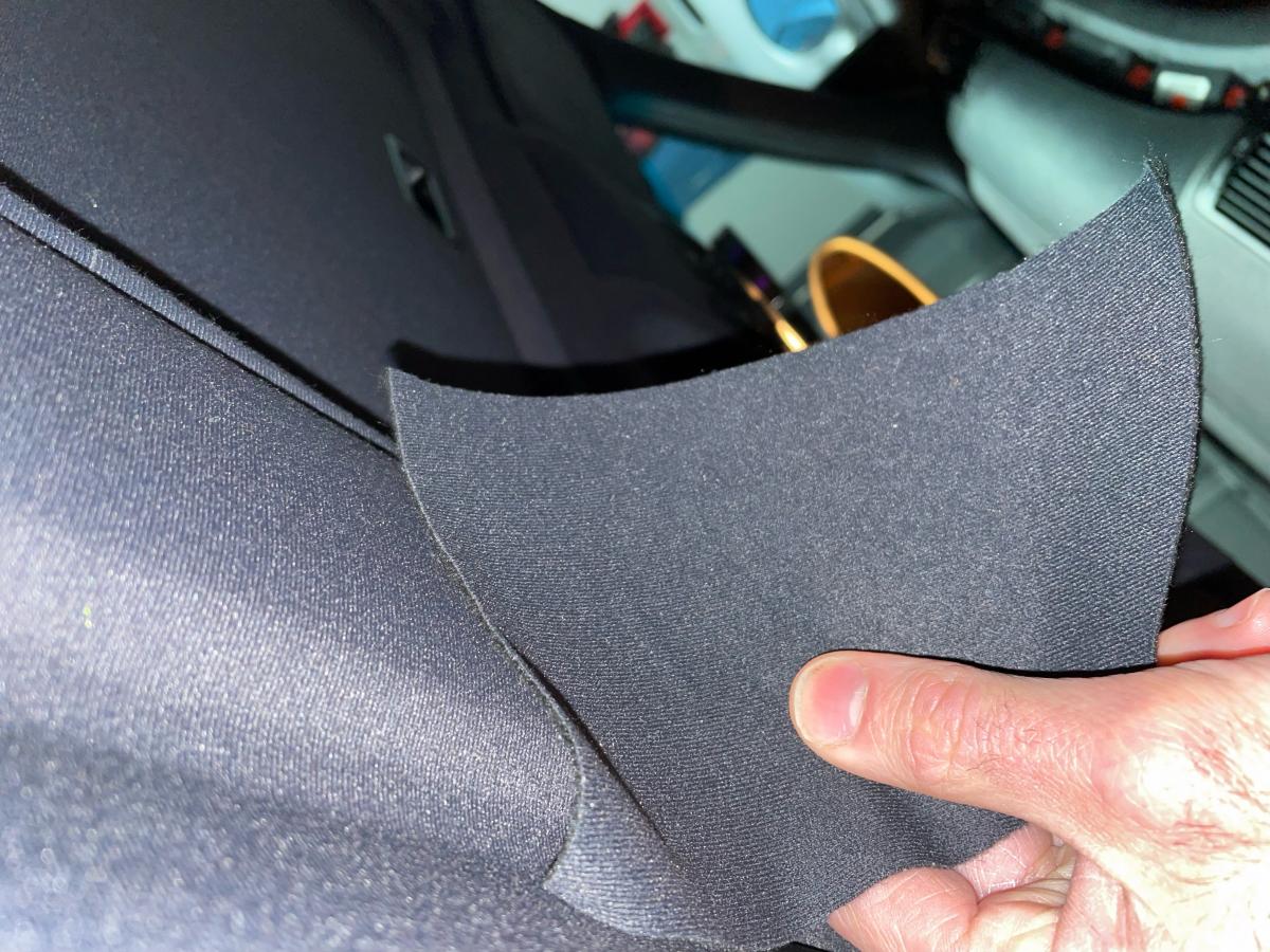

                It is CLOSE to the OEM color, BUT if you are doing all the pillars (A,B, and C) at the same time it is worthwhile because BMW quality control is garbage with the pillars as of the last few years. I went through absolute hell on both my E46s to get matching pairs of As and Cs each time I replaced them because the driver and passenger would consistently be 10 shades off. Multiple exchanges gave me sets that you would not be able to notice but the A, B, and Cs will never be the same color from BMW these days unless you have access to the warehouse sorting center.
                If I hadn't replaced A and C in both cars BM-3109 would be a very good option if you have a pro install. If you're just trying to replace one set (Bs in my case) you will be disappointed as it is much darker.
