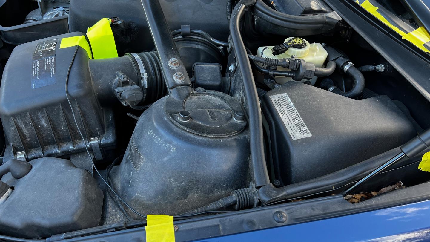

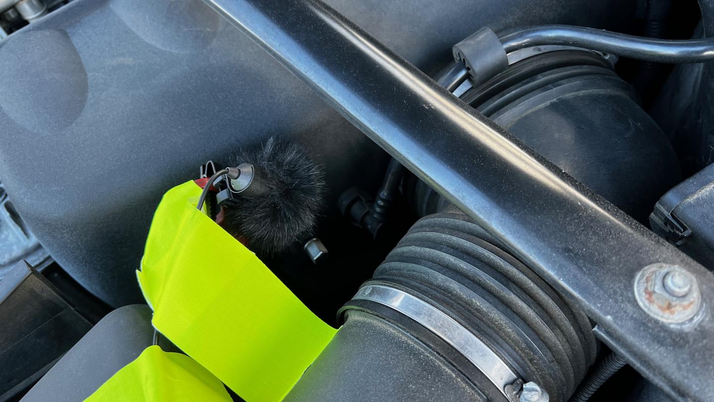

    One of the Shure SM11s is mounted on the oil dipstick and secured to the surrounding area with gaffer's tape. It points to the air box.
    Click image for larger version  Name:	IMG_0513.jpg Views:	0 Size:	152.6 KB ID:	161429
    Click image for larger version  Name:	IMG_0514.jpg Views:	0 Size:	177.1 KB ID:	161430

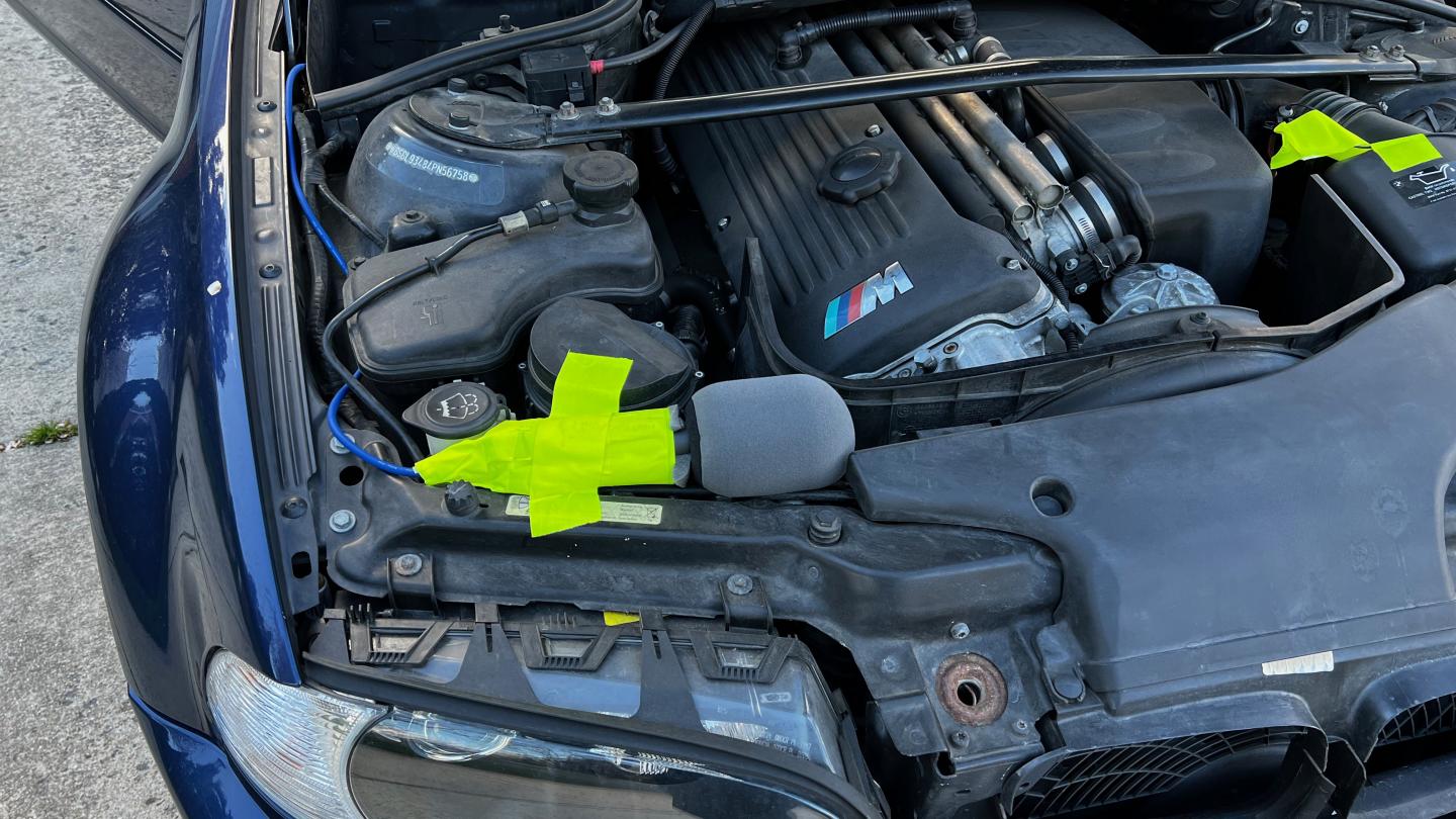

    The SM57 points to the engine itself.
    Click image for larger version  Name:	IMG_0512.jpg Views:	0 Size:	193.0 KB ID:	161431

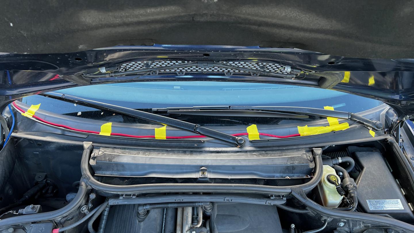

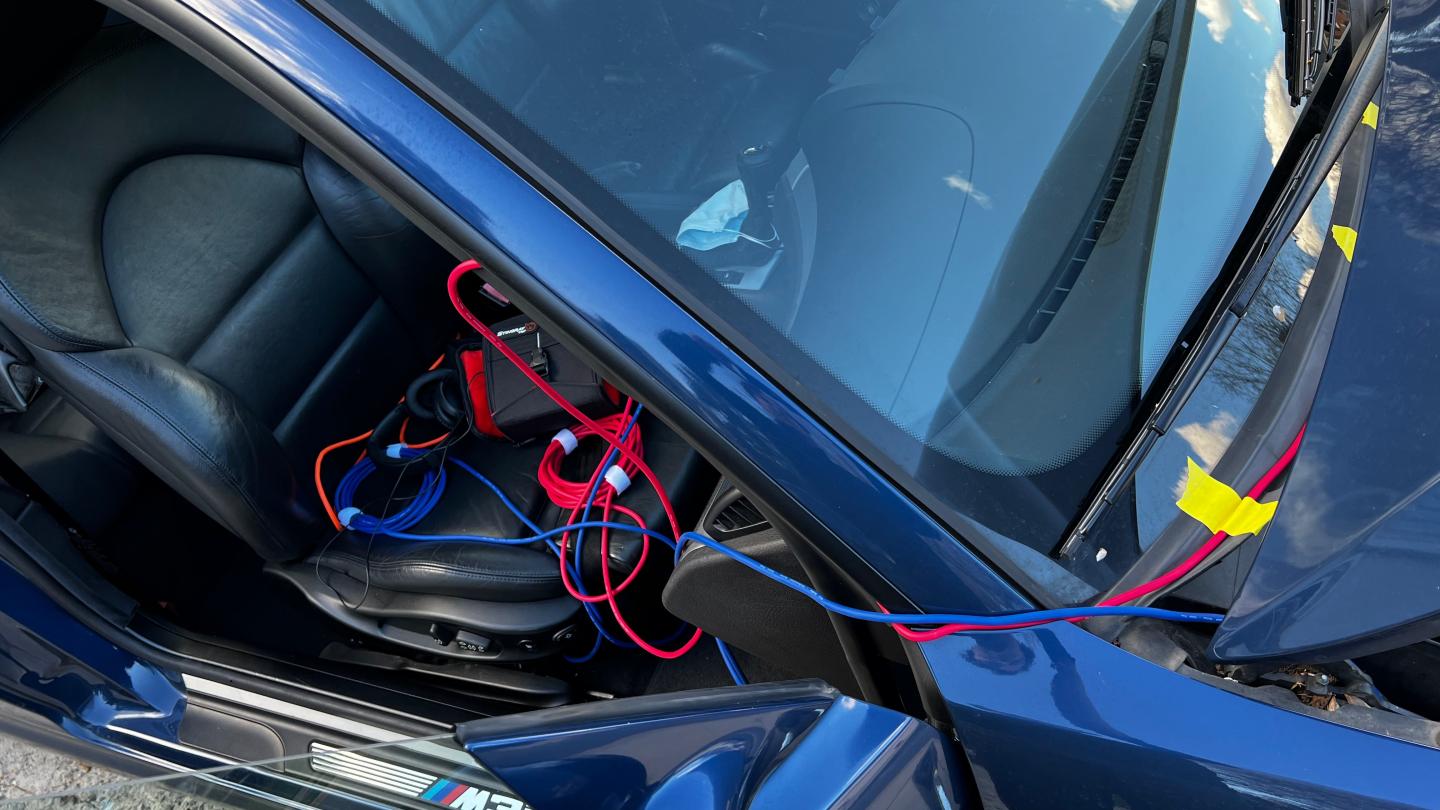

    Cables go around the perimeter of the engine bay area and under the wipers. They are all secured in place using 3M masking tape and/or gaffer's tape, depending on the surface.
    Click image for larger version  Name:	IMG_0516.jpg Views:	0 Size:	176.7 KB ID:	161432

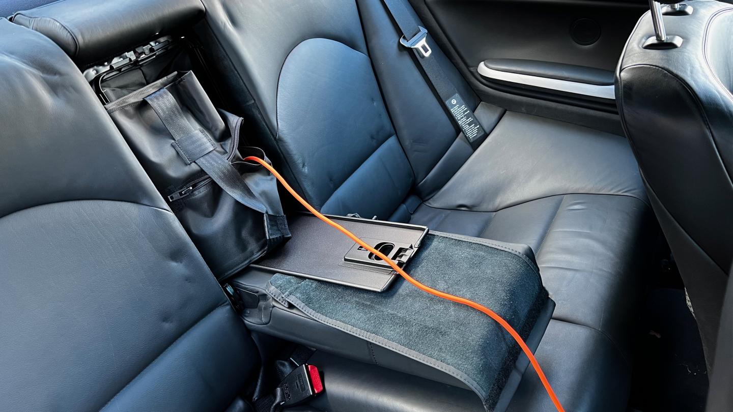

    Cables go into the cabin by the passenger window sill.
    Click image for larger version  Name:	IMG_0517.jpg Views:	0 Size:	142.5 KB ID:	161433

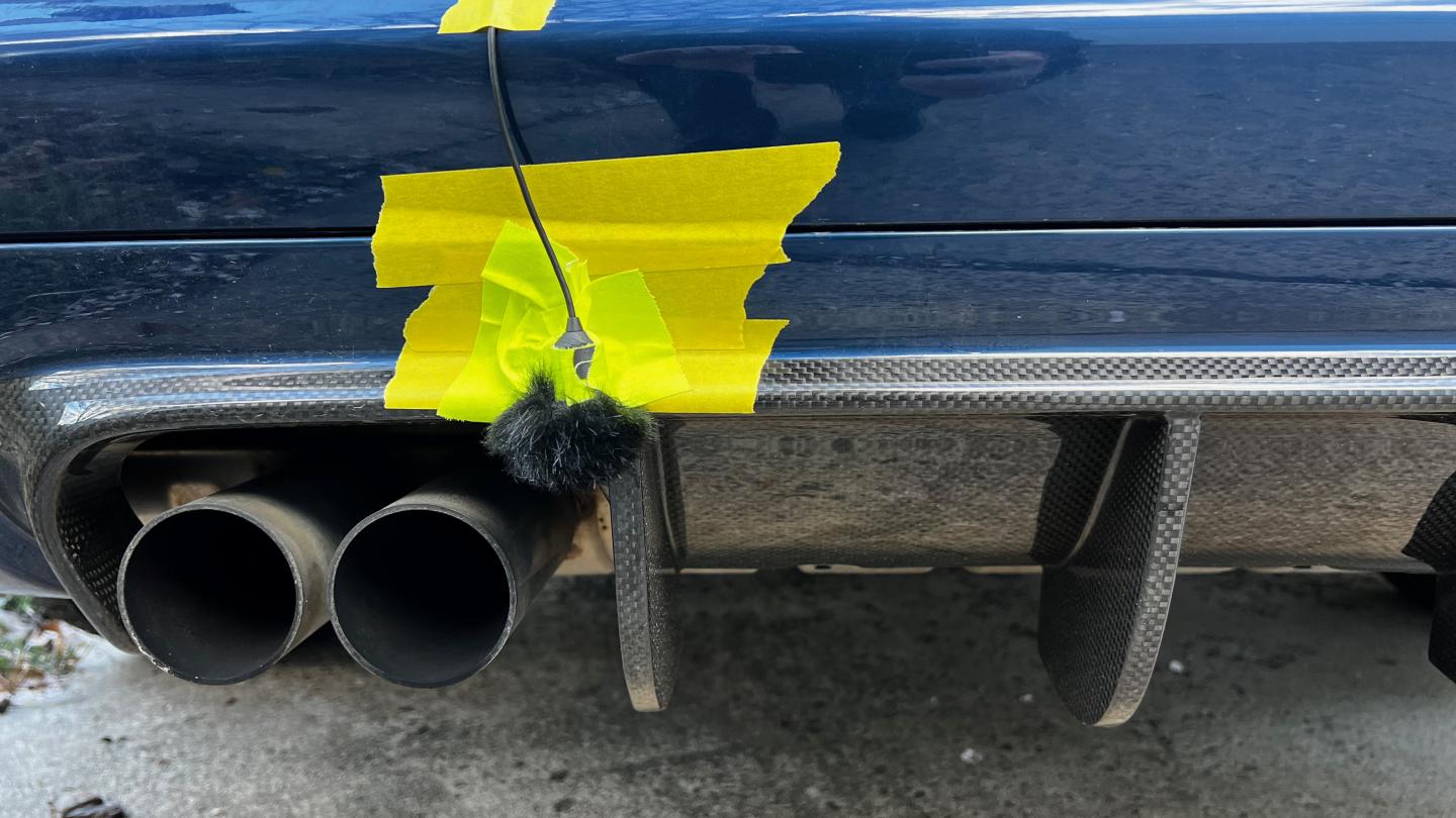

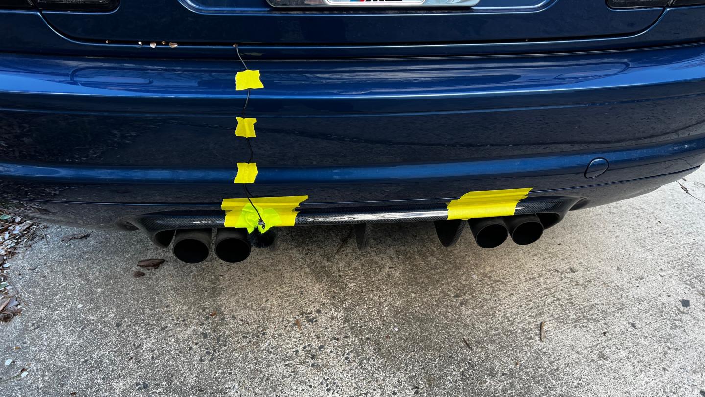

    The exhaust sound is recorded using another SM11 mic.
    Click image for larger version  Name:	IMG_0519.jpg Views:	0 Size:	148.1 KB ID:	161434
    Click image for larger version  Name:	IMG_0520.jpg Views:	0 Size:	248.4 KB ID:	161435

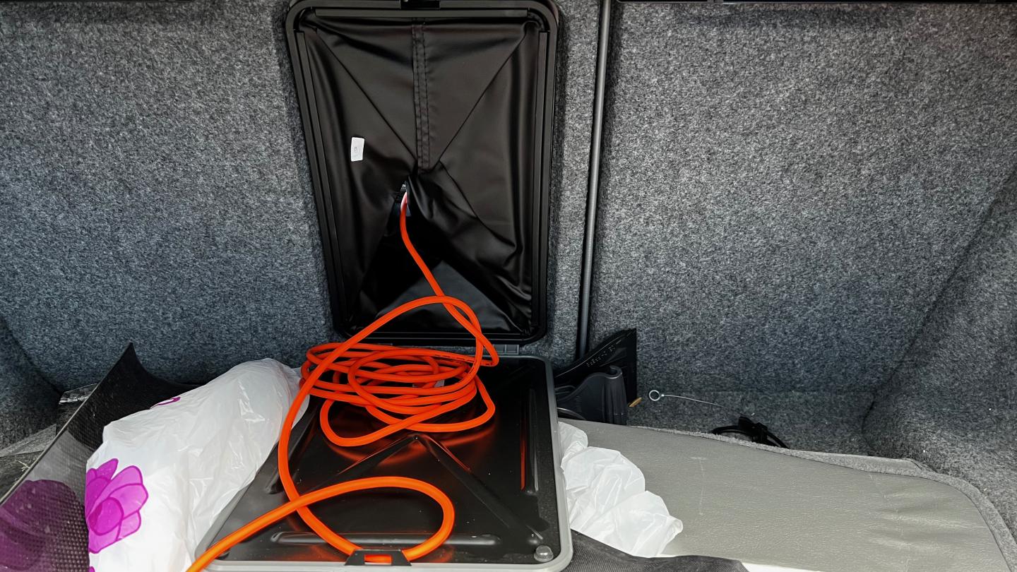

    Exhaust mic cable goes through the ski pass through and into the cabin.
    Click image for larger version  Name:	IMG_0521.jpg Views:	0 Size:	243.3 KB ID:	161436
    Click image for larger version  Name:	IMG_0522.jpg Views:	0 Size:	151.6 KB ID:	161437

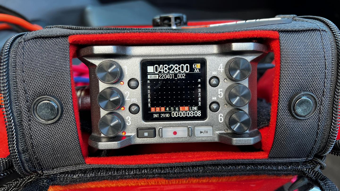

    And finally, all the mics feed into the Zoom F6 recorder.
    Click image for larger version  Name:	IMG_0518.jpg Views:	0 Size:	253.4 KB ID:	161438

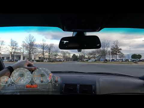

                            After many additional attempts, I was able to get an audio + video recording here:
                            In addition to the 3 mic's, now I have 2 GoPro's: one looking ahead, and the other looking at the dash. Compositing them for the YouTube recording later. I am not very happy with the stabilization that GoPro does, so planning on learning a bit more about what DaVinci Resolve can do with its Tracking feature.
