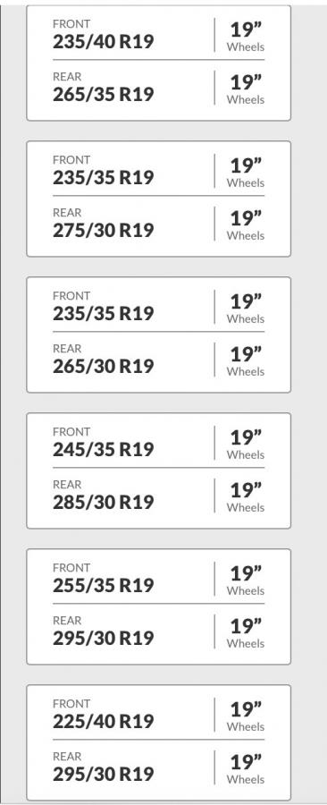

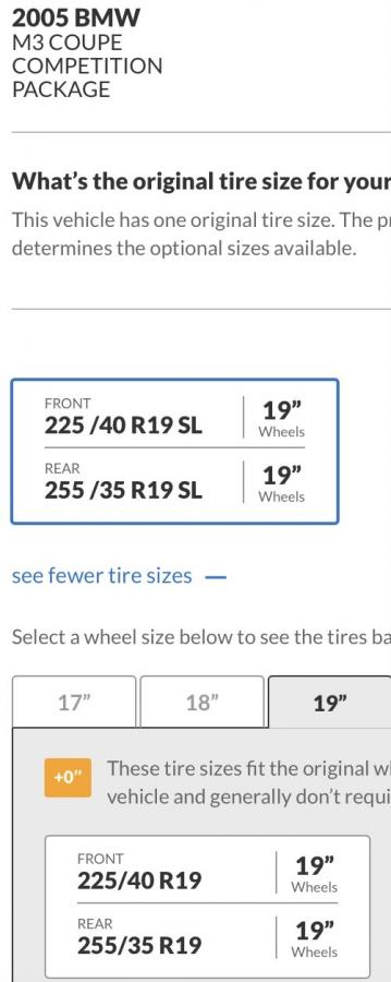

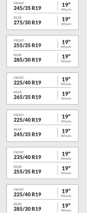

      As for post questioning the M3 ZCP article suggesting 235/275 and not being “size” 30mm tread width difference. TireRack/America’s Tires has a spec sheet for the M3 ZCP. When you enter Michelin tires suggested on that exact model wheels it lists (after the original spec’d fitment) 2nd one listed in fitments is thee 235/35/19 Front and 275/30/19 Rear.
      I’m not posting this to push that one set-up. Only that it is commonly used and suggested by professionals and can not to be discredited.
      https://www.americastire.com/tires/b...tinue-to/close
      If link doesn’t load these are screen shots of other fitments that are Tire Rack/AT expert accepted. Click to enlarge.
      Click image for larger version  Name:	7FB5EDF4-3890-48C1-BBAB-F404DFB740A7.jpg Views:	0 Size:	39.9 KB ID:	166220
      Click image for larger version  Name:	50EFD749-5F11-4C02-8495-35C902DE34E5.jpg Views:	0 Size:	42.3 KB ID:	166221
      Click image for larger version  Name:	825BA2B3-6E16-4FE2-B8E1-D0D17FC9F591.jpg Views:	0 Size:	39.8 KB ID:	166222

        235/275 should be discarded. What a joke. We need Biden's minister of misinformation to task a special unit to nam3forum.
          #79
          That list from Discount Tire seems like a joke. Virtually any combination is listed. On TR, only one optional size is given for 19" comp wheels - 245/35 and 275/30. I don't want that much of a plus.
          I'm looking to go 235/35 265/30 on my next set of tires. That keeps the circumference difference under 1 inch. Rear tire size limits the choices.

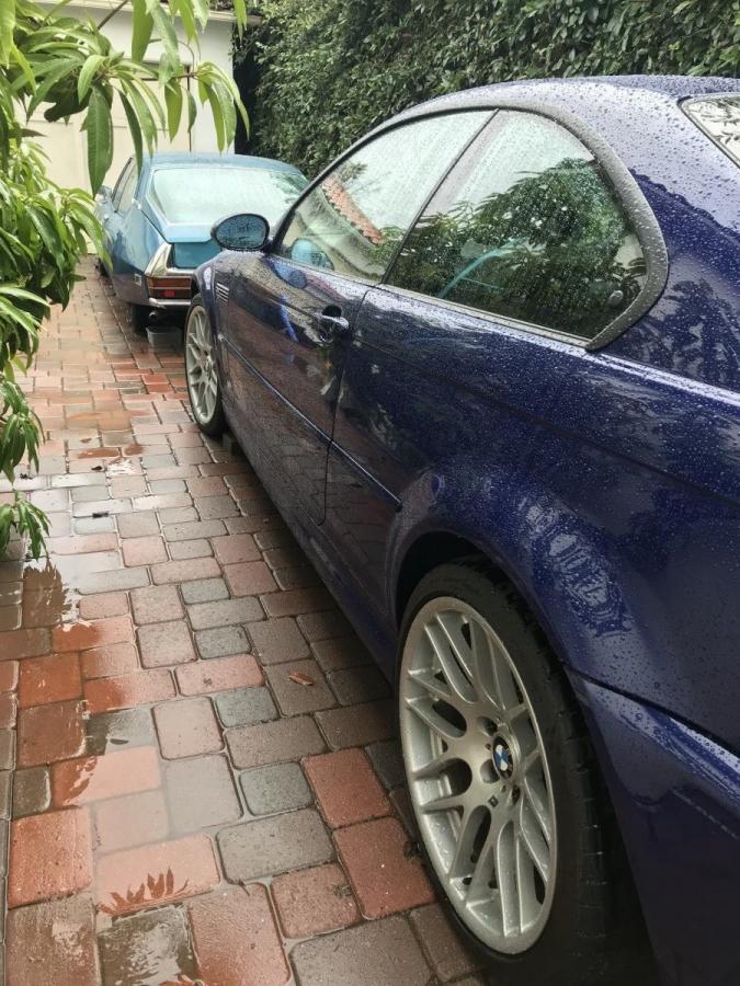

ID:	170907 Back on the original topic of sourcing ZCP wheels, I highly recommend giving your local classifieds a look. Managed to snag a nearly mint set of wheels for ~$1300. Some people don’t know what they have!
