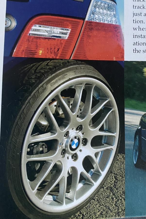

                Keep in mind Michelins run wide. 235/265 ps4s is perfecto on CSL/ZCP.
                Unless you don't want your car to look like this:
                Well true the Michelin 265s don’t look nearly as bad as their 255s. Still not what majority of BMW car writers have said about the CSL rears. They suggest 275s. From Bimmer Mag, European Car, Roundel, BMW Car and Performance BMW.
                I’m very familiar with Michelins, as that’s what I run for decades. I have even run Michelin Sport 285s happily on my CSL rears. I’m running 275 now for the grip and look over the 265. And not a chance will go further and run ridiculously 255s.
