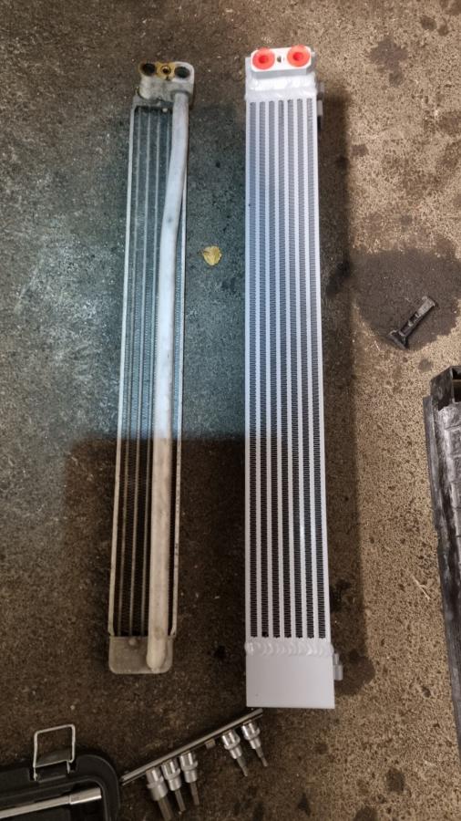

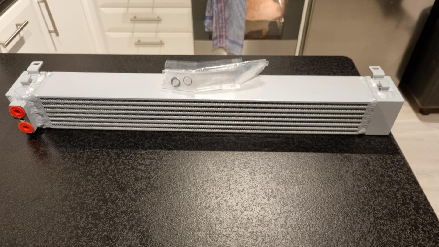

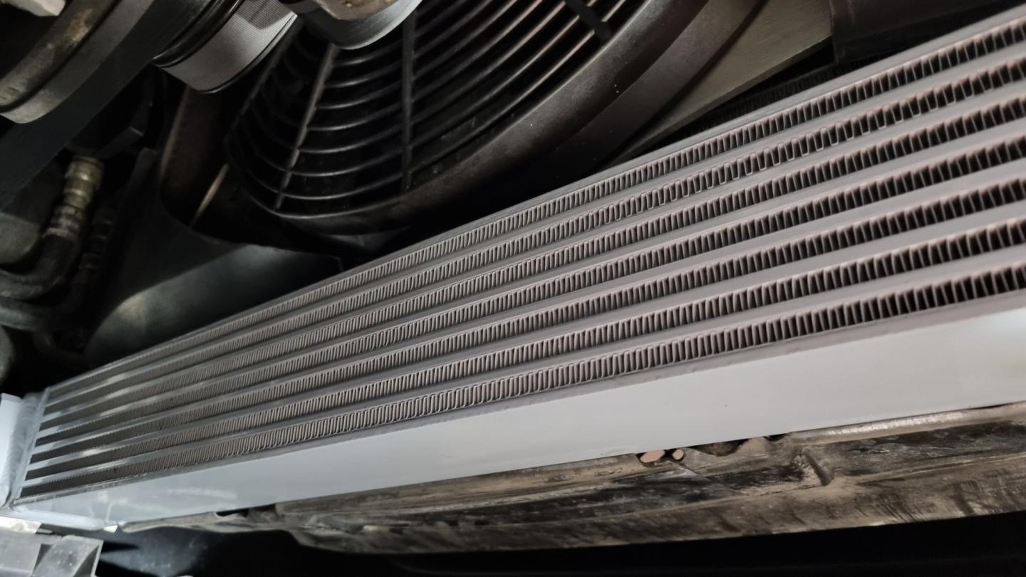

            Fitted a CSF oil cooler last autumn. Although not many miles, the normal oil temps did drop noticeably during normal driving.

            The stock one is puny compared to the CSF, however it's not apples to apples as my OEM was old and tired, but as I said, oil temps did drop noticeably with normal driving with the new CSF. So I'm calling it good.
            That being said, you don't have to search far and wide to find a certain cooling thread where the new CSF radiator was the culprit.
