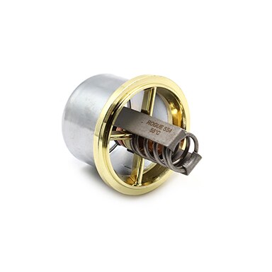

                      I swapped my OE radiator and oil cooler for CSF units. I also installed a BMW Motorsports thermostat.
                      My oil temps on 90 degree (35% humidity) track days never go above 250 degrees and water temps stay around 178 to 188 degrees (per my ScanGuage). Typically run 20 minute sessions.

                              I have a DO88 Oil cooler and radiator, 70C thermostat. Tracked at Sebring in 80 ish F temps with high humidity and I never got worried about temps, stock fan clutch and mechanical fan. 100% water (bcuz FL) the 70C helps keep car cooler at the start but once it gets to temps its useless and helps get the car even cooler afterwards since its cooling below 80.
                              All the E92 guys rave about DO88 so I jumped on it and I've been happy since. I think OEM was fine as well, probably would be awesome with the 70C as long as its cleaned up (the fins) from debris.
