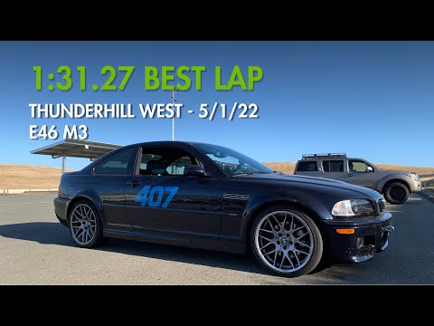

          So i had my first event with the E46 out at thunderhill west today. Was about 80* and the car did great! Oil never even made it to the 3 dot and coolant was also a non worry. Guess i was just overthinking it
          As everyone stated OEM works and mine hasnt even been refreshed yet.
          Usually run a 1:25 in my F80 (ap racing bbk, tc klines,CS tune,apex ec7, nitto nt01). Ended up doing a 1:31 on a pretty much stock E46 with continental extreme sports (came with car). Not to mention this is my first manual car so ive only had 2 months of experience.
