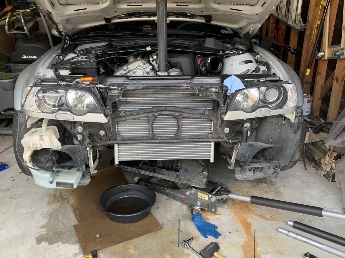

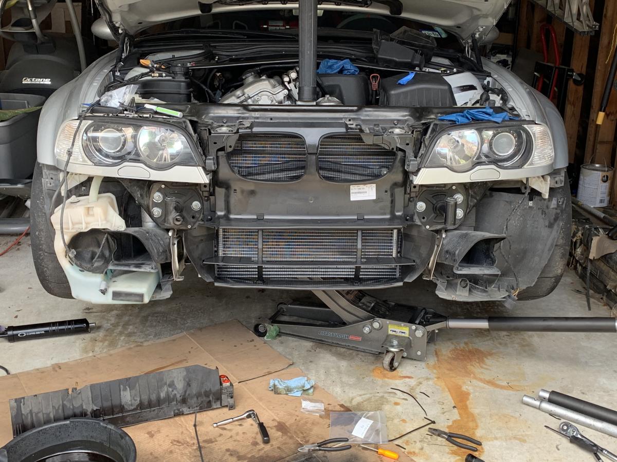

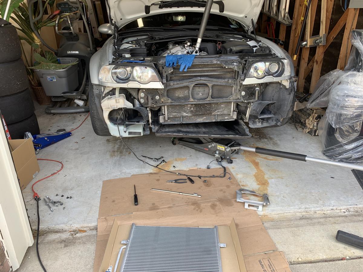

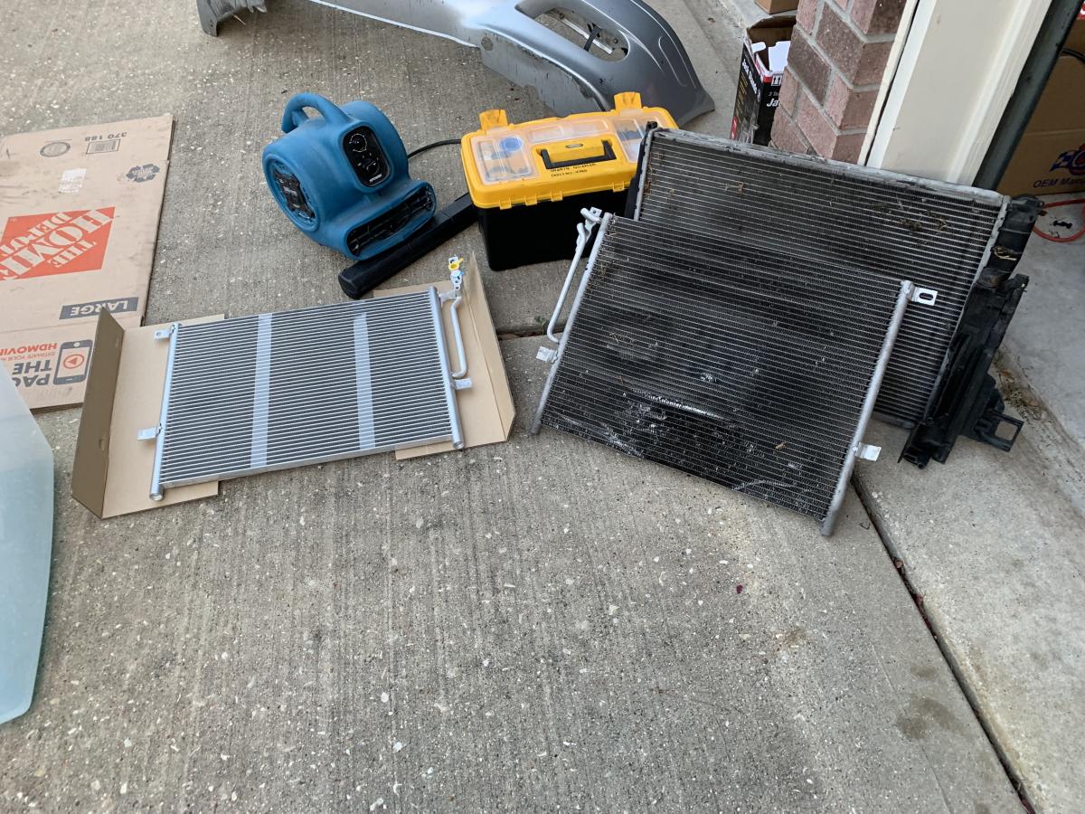

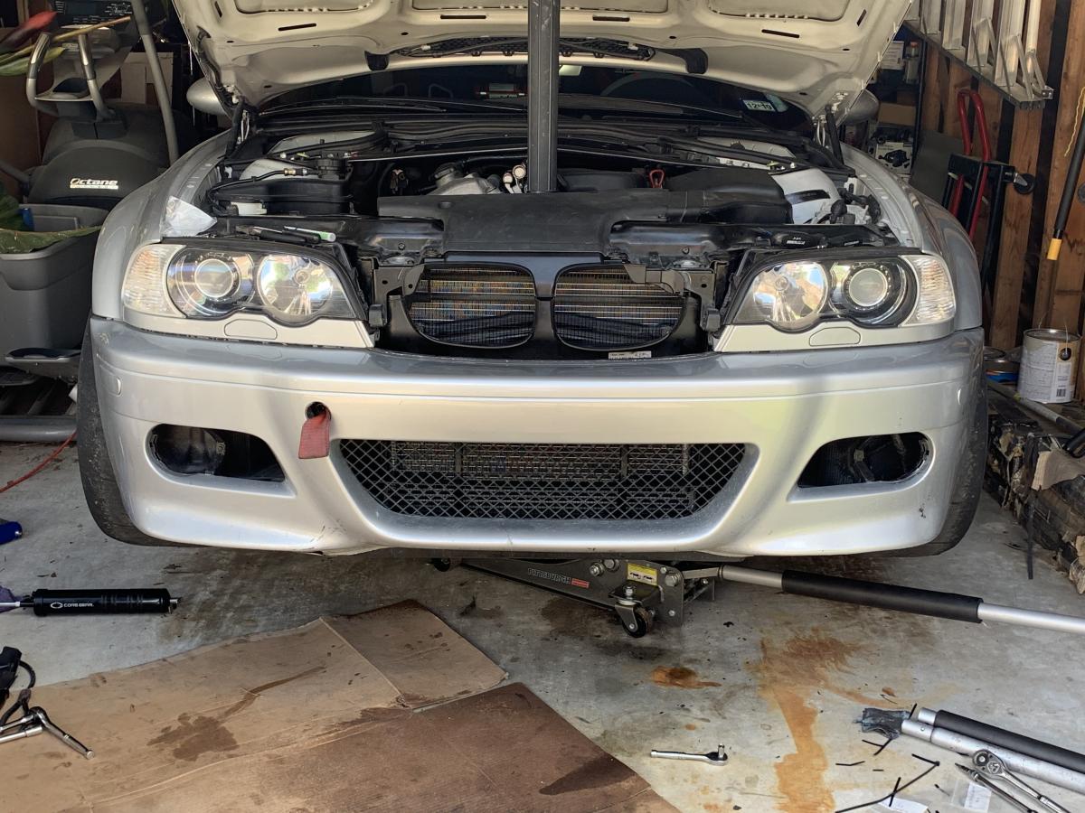

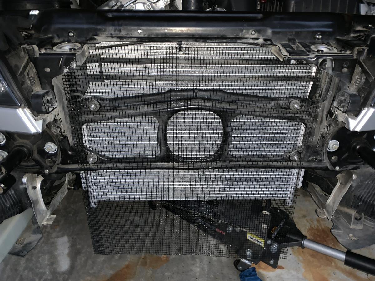

                          I don’t think it’s been specifically mentioned, but if you plan to keep your AC, replace the AC condenser. If the fins are bent and blocked by debris, you’ll get less airflow to the radiator. My track temps have been cooler after I deleted both stock fans and installed SPAL fan, OE radiator, and OEM AC condenser. Also have a CSF oil cooler, but I think I’ll be going back to OE soon.
                          I also added 1/4” wire mesh in front of the condenser and oil cooler to protect the fins from larger debris. It works—catches large bugs and track rubber.
                          Pics in case they’re helpful. Hit a coyote so front end was fucked.

                              Good stuff, I'm going to change my AC condenser and swap from a CSF oil/rad to new OEM ones.
