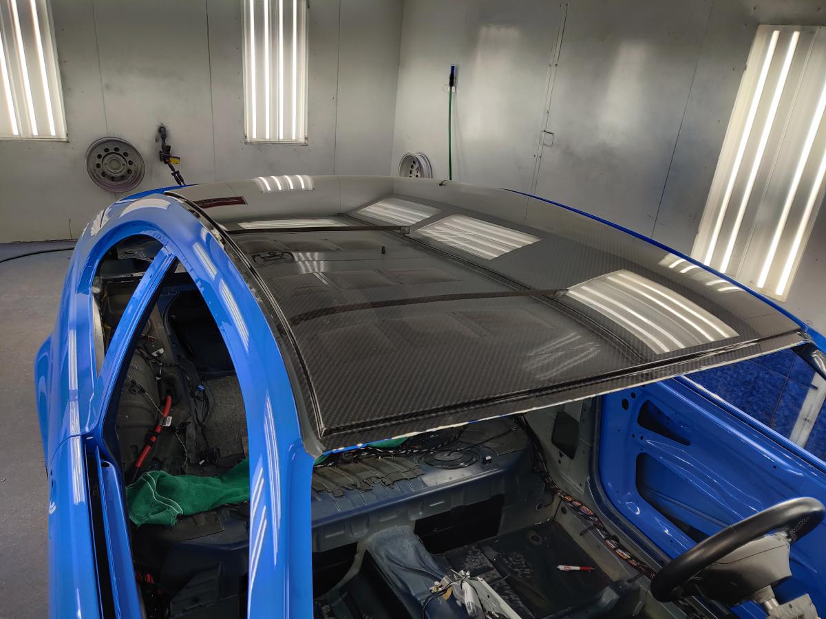

    I’m in the middle of a sunroof delete project myself and the only interior piece I supplied to the body shop was the headliner — euro part # 51442699065. No cutout for the alarm on this one or need for the extra cover. Unfortunately I can’t remember if there’s a provision in the backing material for the microphone accessible by cutting the fabric. Here is a pic of the result. Not sure about what you’d need for the US spec unfortunately.

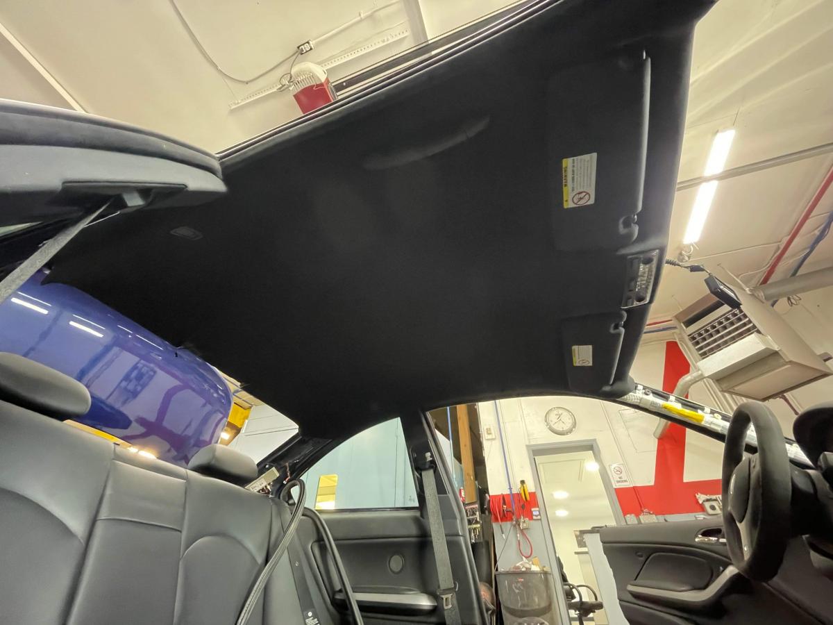

            I'm about to get my car back this week. I too have the Euro headliner. My plan is to make mine look like repoman89 setup.
