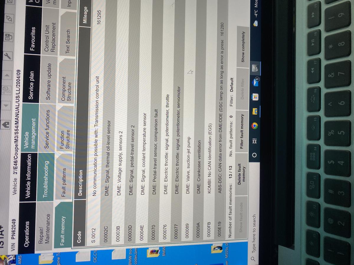

Smg cranks but no start

          Ok from the codes I don’t think it is dme, shows that in my inpa codes. Would a pedal code affect my start?
          it currently cranks because I coded out the clutch safety, I will try deleting ews
