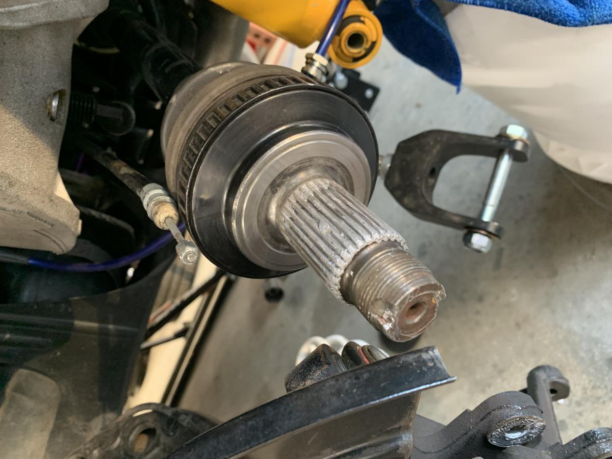

                    I decided to follow my friend's advice. Here is how the outboard end of the axle looked:

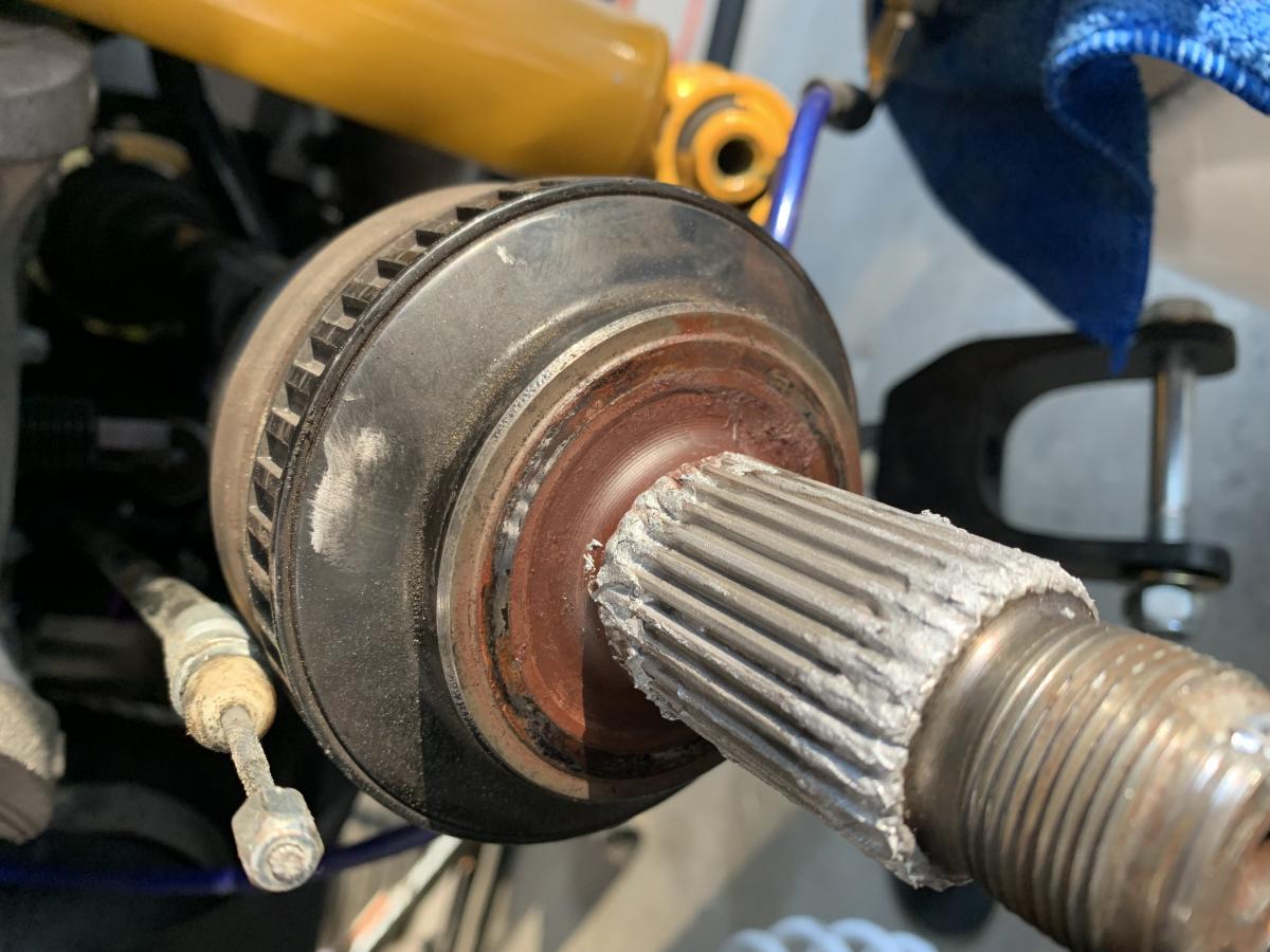

                    Cleaned up:

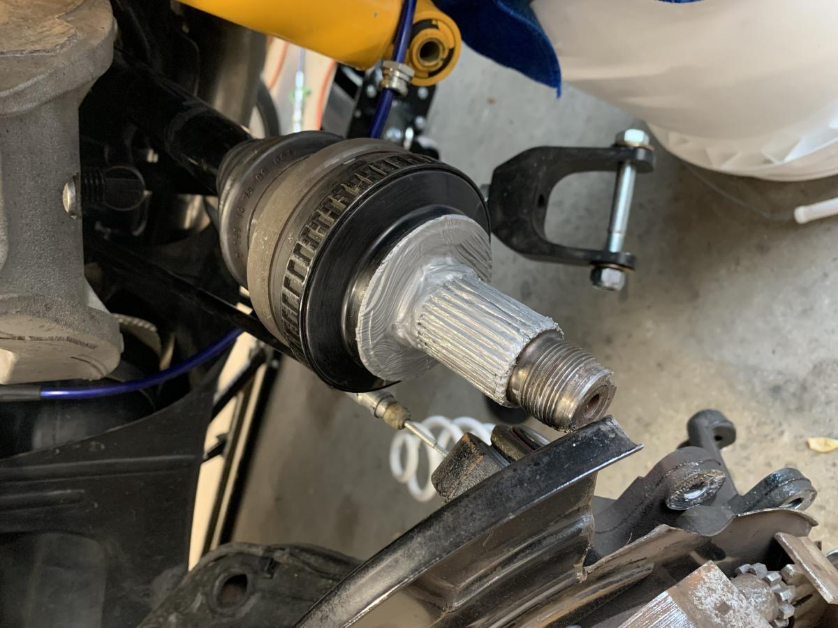

                    Nice coating of anti-seize:
                    Put it all back together and no more clicking.
