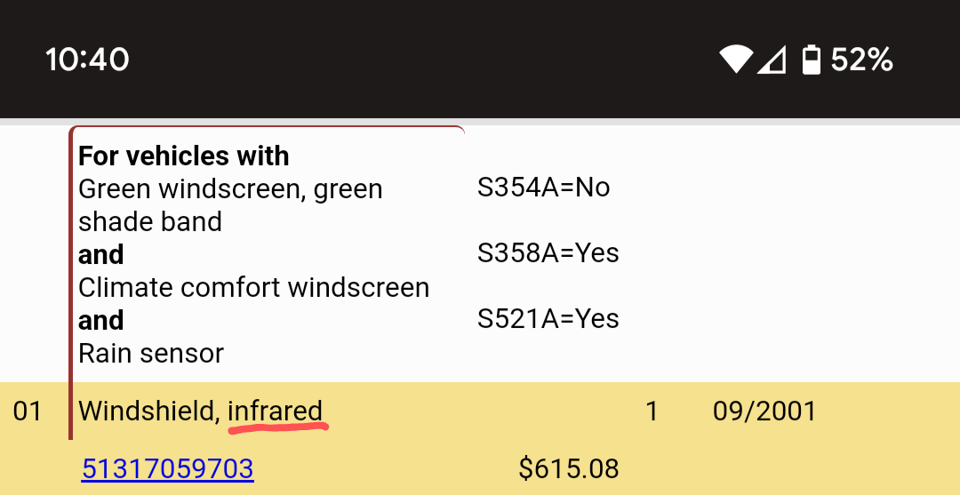

                          For E46s if you actually look in real OEM website, climate comfort is not the same as infrared
                          When you guys are asking for climate comfort, I assume you're actually asking for the infrared windshield which is the purple tinted windshield that blocks out uv/heat/ir from the sun.
                          There was already another forum post five pages long about the this
                          https://nam3forum.com/forums/forum/m...oem-windshield
                          You want infrared windshield.
                          The part number for the coupe infrared windshield with rain sensor and no green band is 51317059703
                          Straight from the real OEM site

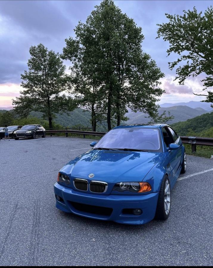

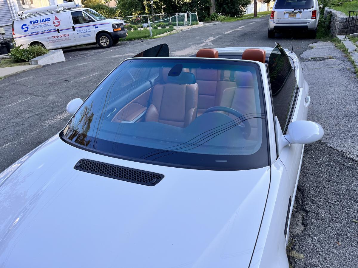

                          I already have somebody locally that used that part number I gave them and got it for their E46 M3 and it looks Great. They ordered it from the local BMW parts desk.
                          And the pictures I attached one shows the part number from real OEM website, The other picture shows the infrared windshield on a car that a person I know locally has and the other picture shows how to easily tell the infrared windshield from others.
                          It's the only windshield that has the trapezoid looking section in the center at the top. Even the non- rain sensor version of the infrared windshield has the trapezoid cutout that's for the toll passes etc... And then on the rain sensor version it has the rain sensor right underneath it.
