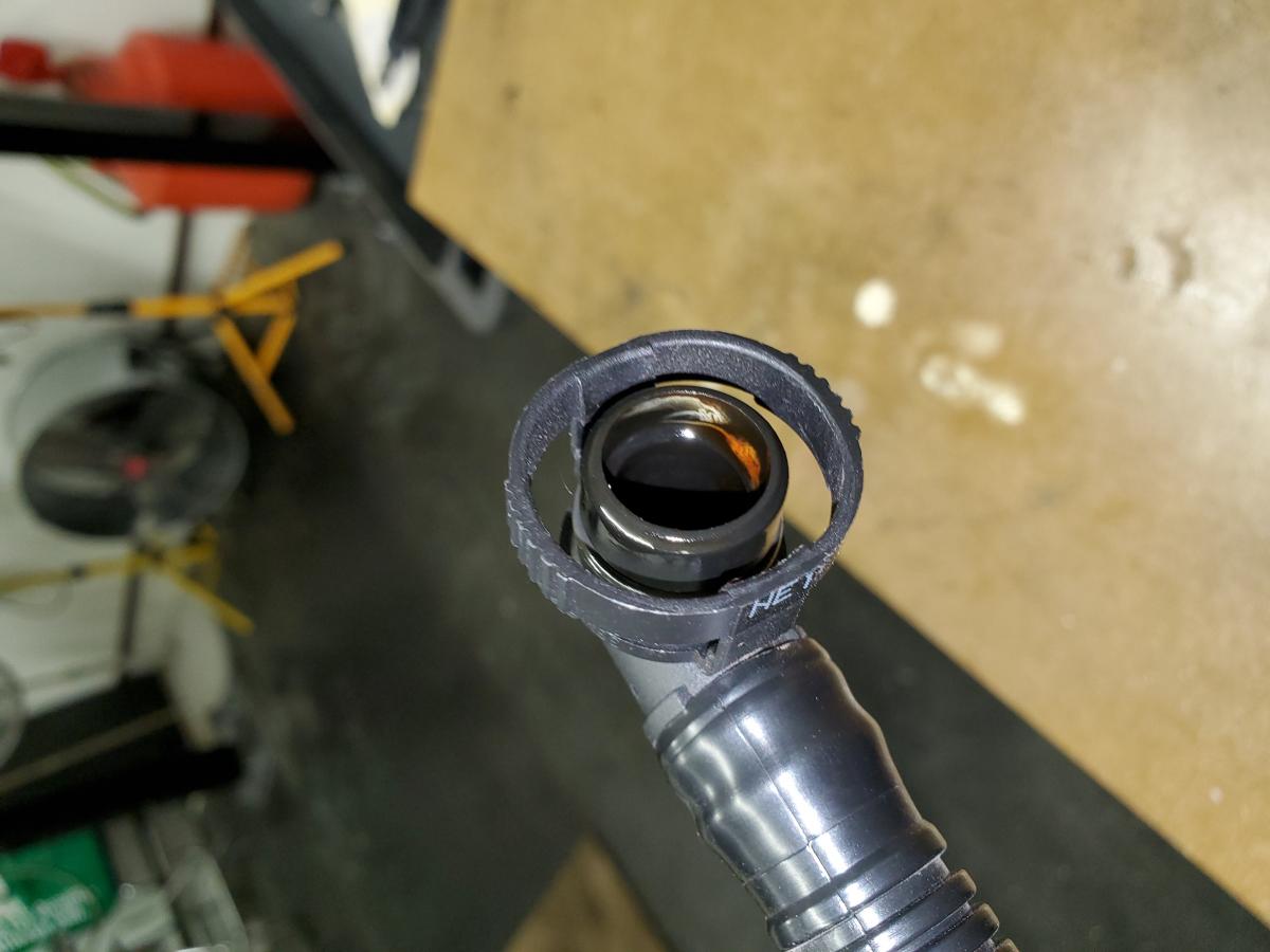

    Tonight I noticed the smell of oil regardless of driving style and when I pulled the breather tube I saw the dreaded white milky oil one might see when you have a bad HG.

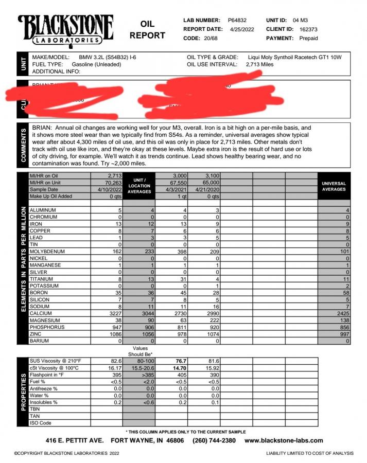

    I very recently changed the oil and it showed no signs of water contamination and my last 2 oil analysis reports were stellar, still waiting on results from the most recent report.

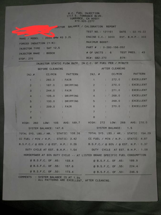

    One thing that has changed (and will not shown in my most recent oil report) is my fuel injectors were cleaned. The injectors at 70k were surprisingly bad, in some cases the spray pattern was listed as "dripping" or "poor" and the before/after flow went up ~45%.
    I contacted Hassan, I remember him telling me he had to add fuel to match the airflow he was seeing, I have yet to log my AFR's.
    I wonder if what I am seeing is fuel contamination as the oil in the breather tube seems to have a faint fuel smell.

      Are you fully warming your car up every time you drive it? Moisture from the air can get into the oil and make it milkshakey if it doesn't get hot enough to boil the water off.

          Eh if the oil on the dipstick or underneath the fill cap isn't frothy, then the engine is probably fine.
          But yeah, pull the plugs and check the oil separator while you're in there

                    FWIW my recent oil report (oil change <1 mo. ago) did not show signs of water/fuel contamination which is good but I will at least do the recommended items above.
