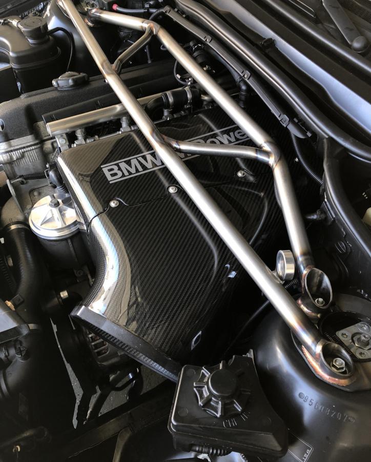

There is a photo in this thread that might help:

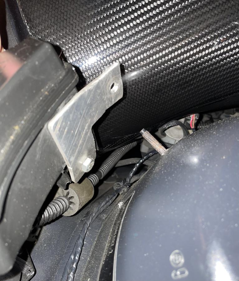

give me an hr and I’ll take a pic of mine. It’s mounted to the bolt coming out of the strut tower but someone made an upside down L shape bracketLast edited by COVID-19; 05-24-2022, 08:51 AM.06 ZCP SMG | HTE CSL MAP QuaranTune | SL CSL Airbox | Eventuri Scoop | DMG Strut Bar | RE El Diablo | CPI Euro200R | AP Headers | Porsche BBK | ST XTA | TMS 3-Pulleys/F-Sway/Mono FCAB | AKG Trans/diff/Subframe/RTAB | SPL RCA | SGT SCZA Trunk | ACL | Beisan | Redish | AFD E85 |

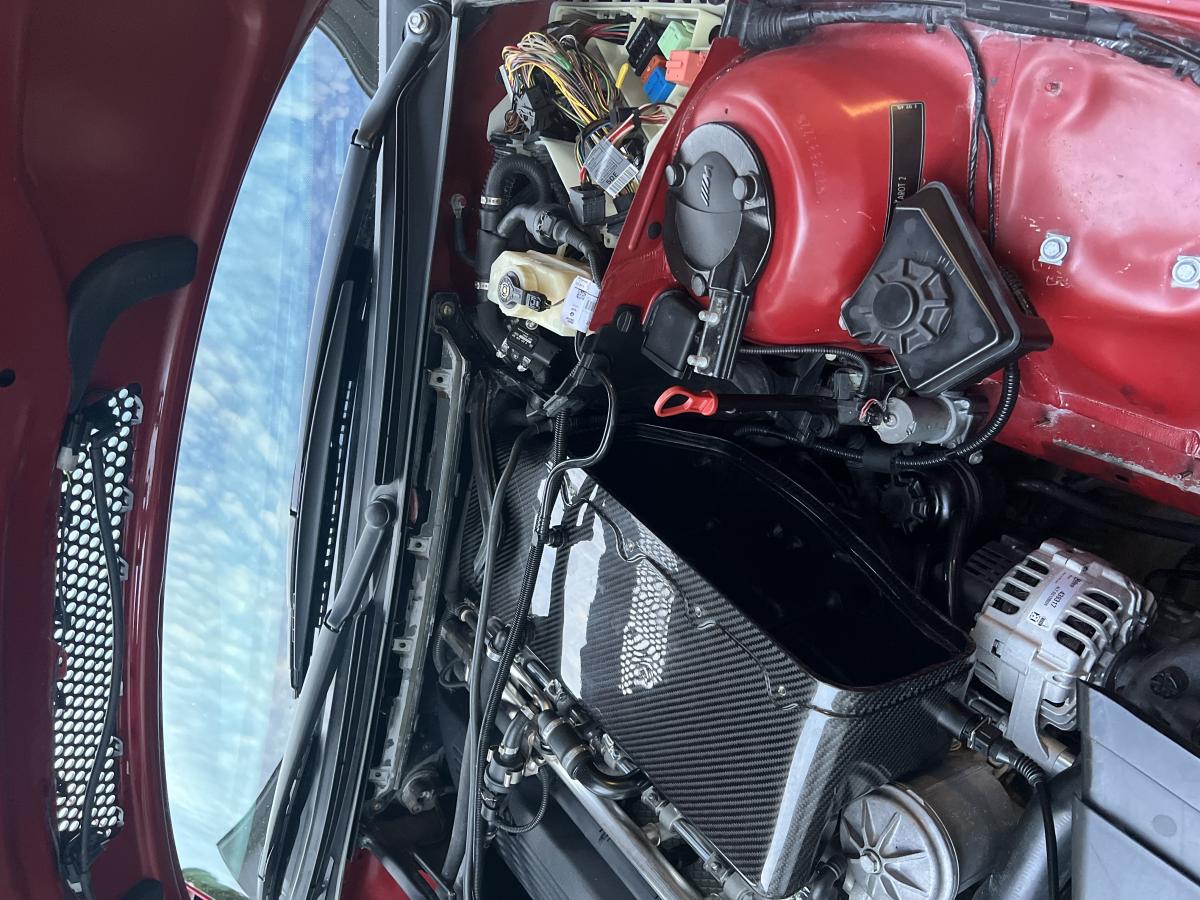

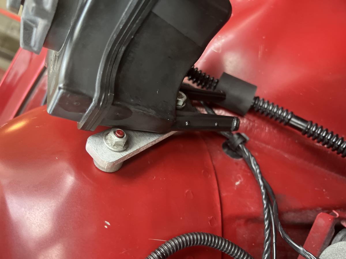

What is the size nut used for the strut tower threaded “bolt”?Originally posted by /M3 View PostUpon digging around the garage, found the spacers that came with the dual pipe Supersprint section 2, that I didn’t end up using. Like it was made for this purpose. Glad I didn’t have to drill a hole or two in the strut tower.
