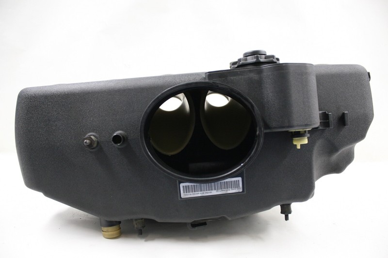

          I have a reservoir somewhere in my garage that bolts to the driver side strut tower and goes down to the smg pump.

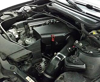

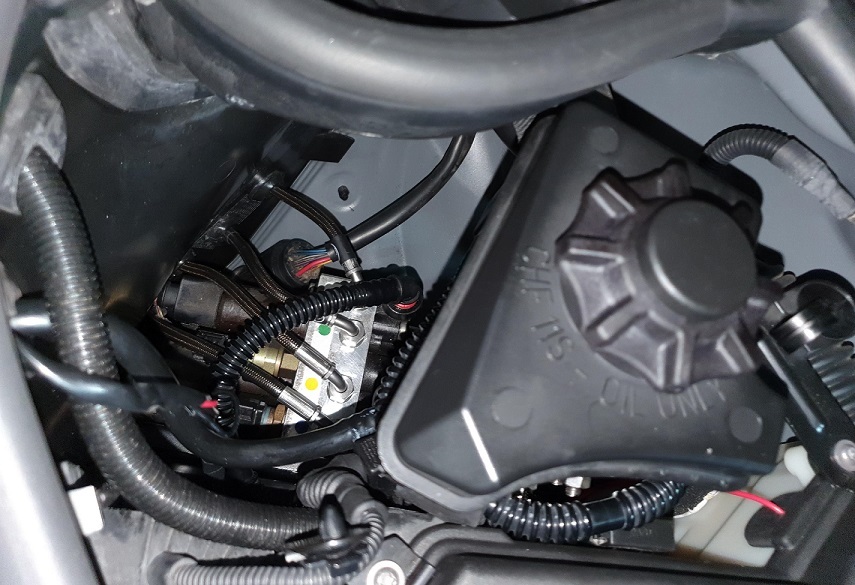

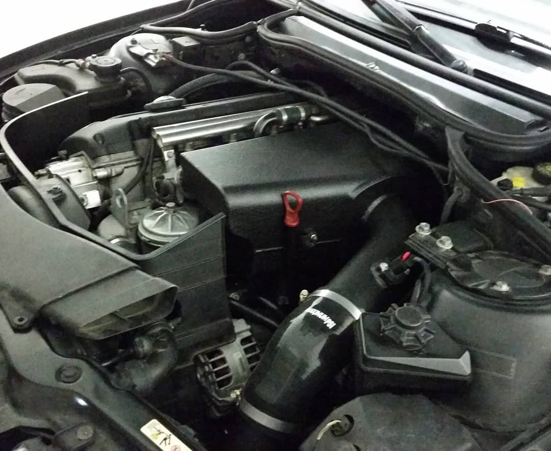

                        The one and only reason to buy the CSL SMG Reservoir that I am aware of is relocating the SMG pump to the drug bin - as you can no longer use the original reservoir - below is my RHD relocation replete with CSL reservoir
