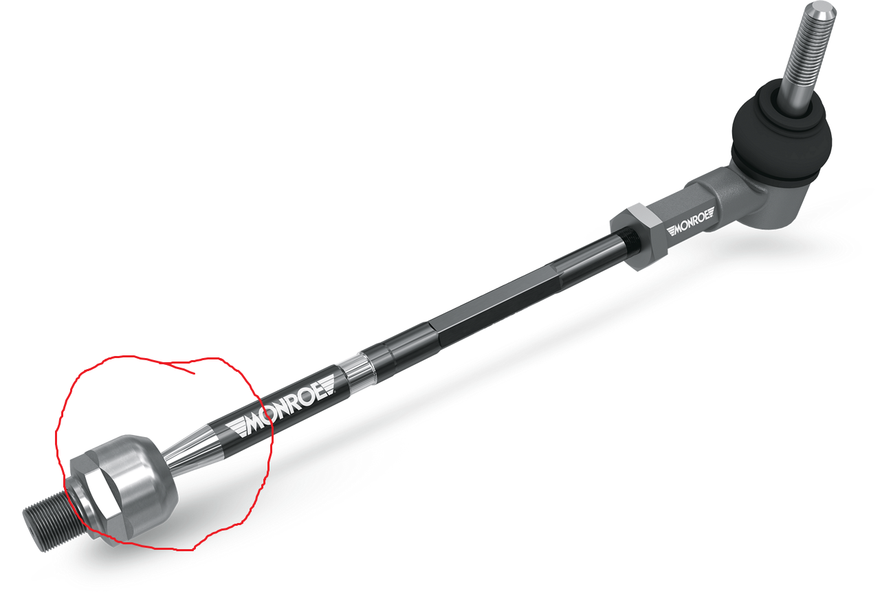

    I circled it.

      Originally posted by slavik1988 View Post
      I circled it.
      I replaced this entire arm tierod on both sides. The issue im having happened before and after this change

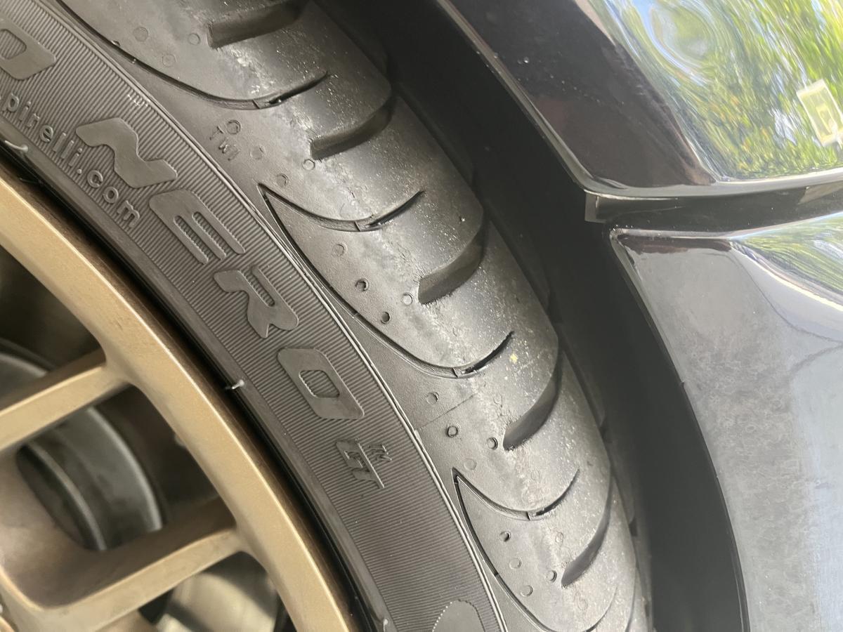

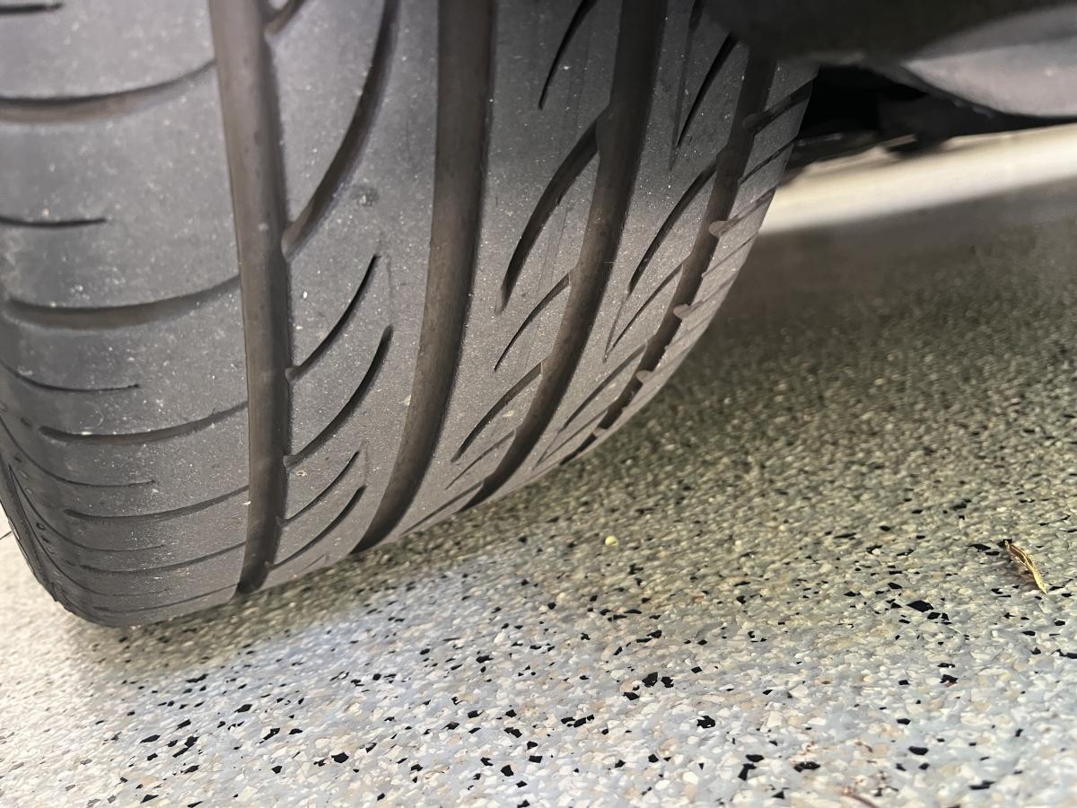

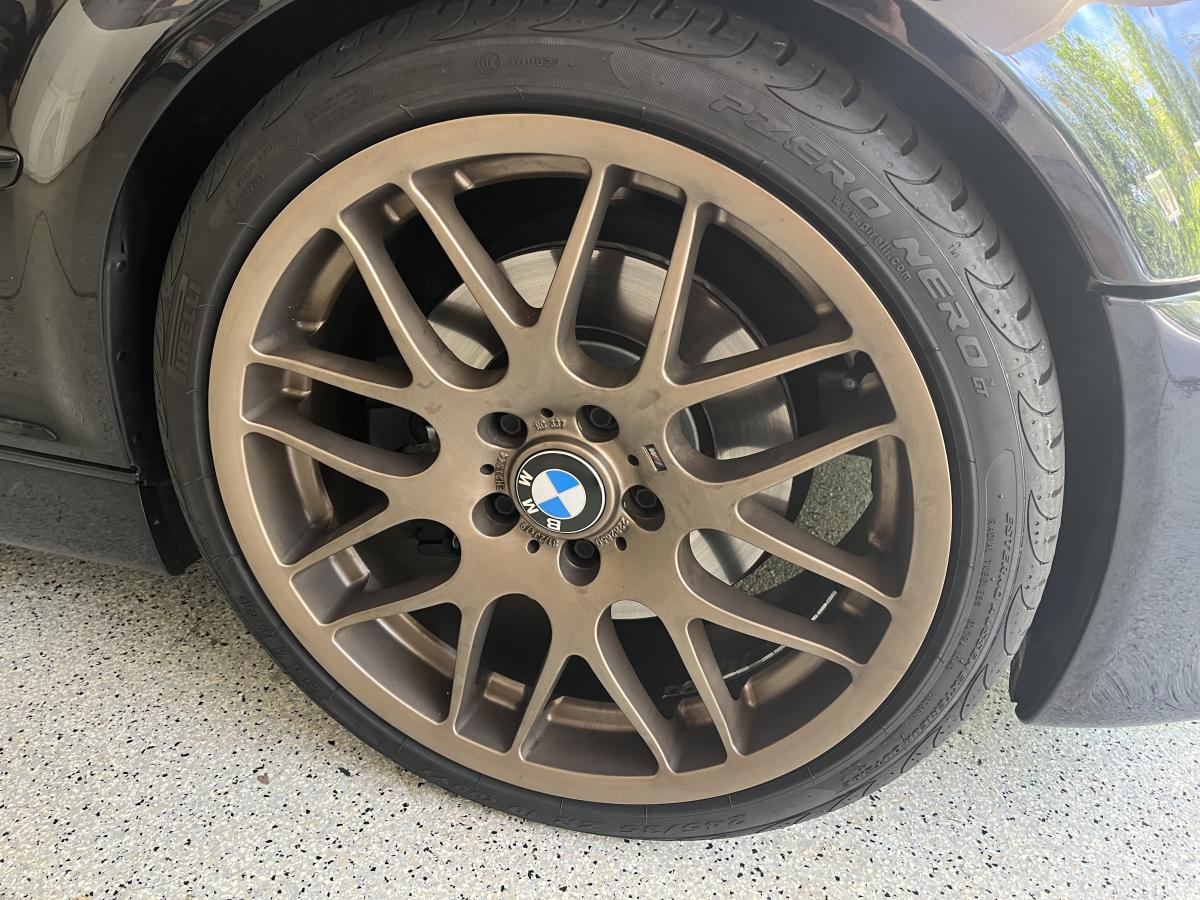

        Here are my front tires
          #64

            Hate to bump this thread bur just bought a set of 18s (219m) and its still having this issue. Honestly i dont even know if tramlining is the right word. I would say more sometimes drives straight sometimes veers off the road. I just drive a kia forte that drives better….pretty demoralizing considering how much ive spent redoing all suspension on this car.
              #66
              Which tires? It matters.

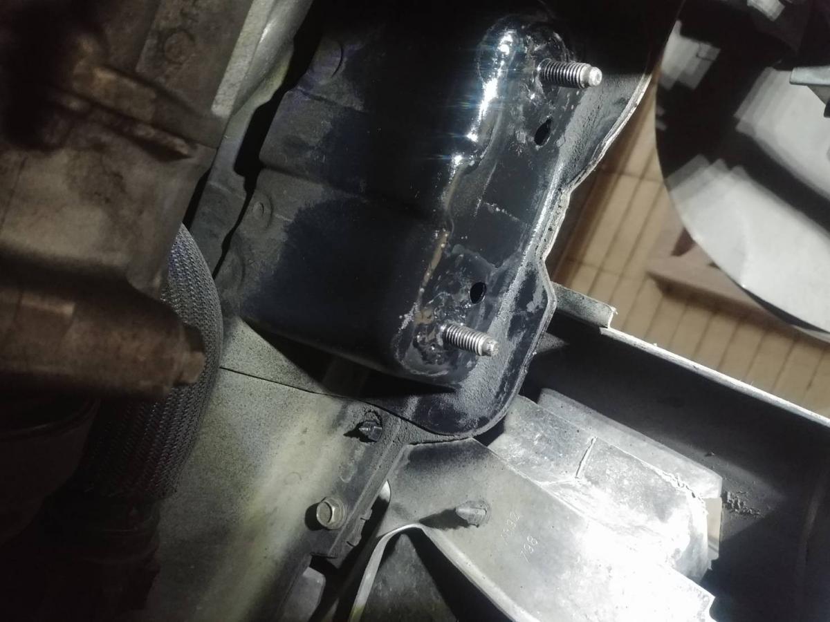

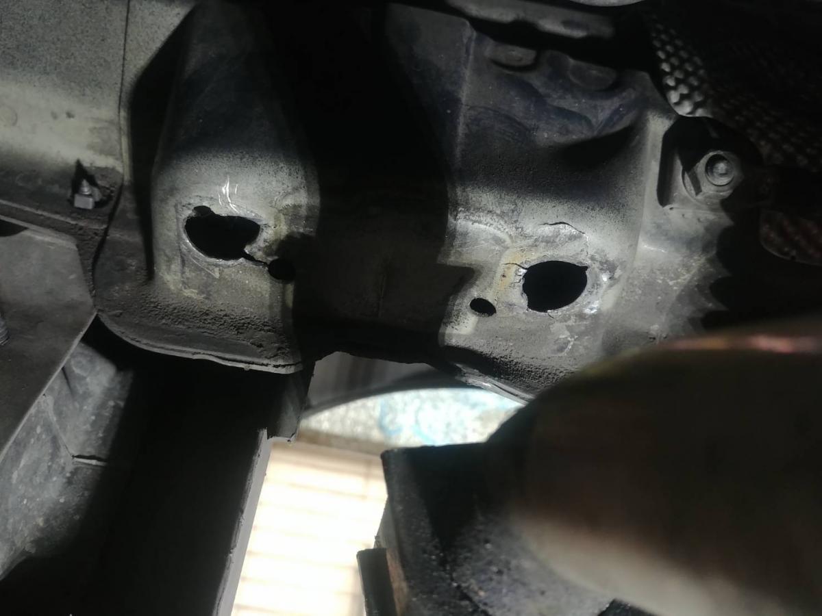

                it's worth checking your "mounting studs" for your front sway bar ..
                the issue that i was experienced before...
                one day, car starts to develop those "road pulling" experience when passed through uneven road surfaces ..
                sometimes it went straight, sometimes it pulled ..
                thought it was caused by the old bushing / end-link / or steering arm and etc...
                then it ended up to be the mounting studs (which got popped) ..
                as shown in the attached image. FYI
                    No issues here just checked
                        These were pulled off a friends BMW e90 m3. They are old crappy 2014 Nankang tires. I did, however, drive these on my friends e90 m3 before and there were no noticable driving issues. I dont see how on one car the tires wouldnt matter much then would on the other. That being said, they are old cheap tires. But given this has been happening on my relatively new 19inch P zero Nero tires too I dont think the issue is the tires.
