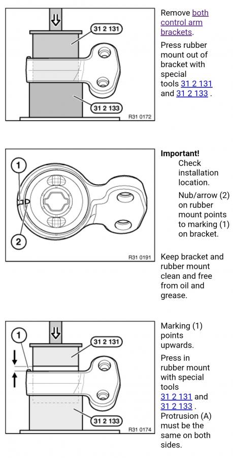

            Ah so sounds like I need to Redo my FCAB mounting bolts. That should be much easier to do!
              #96
              Actually that should be fine. No bolt goes through the bushing so no way to torque and preload it. The way to adjust preload on that bushing would be to press the rubber part out and clock it differently within the housing.
              If you bought the entire assembly, it should come properly clocked. If you just bought the rubber part and pressed it in, it might be worth checking that it's clocked correctly.
              Click image for larger version  Name:	Screenshot_20220718-202100_Chrome Beta.jpg Views:	0 Size:	62.8 KB ID:	176550
                #97
                Oh I see. I bought it already installed in the carrier arm.
