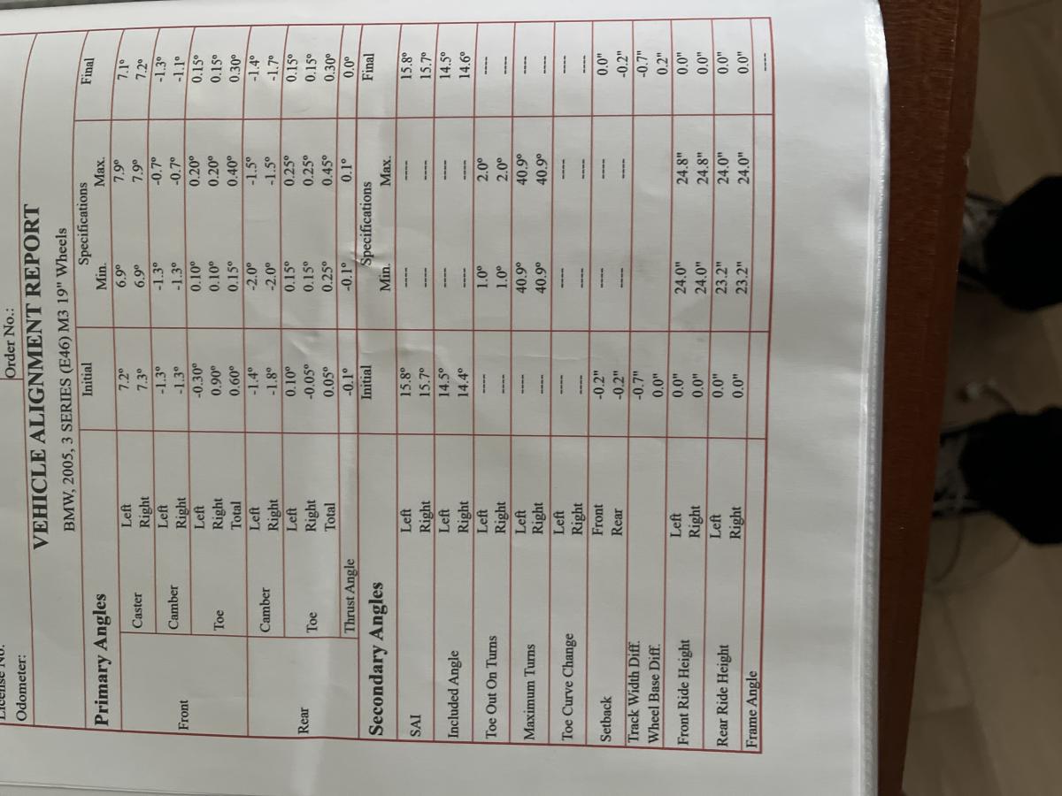

                      Here are the recent alignment results
                        You have an unnecessary amount of toe on the front AND rear of the car. That's why it's tramlining like crazy, because the super aggressive toe is following the road front and rear. You need to go back and ask them for zeroed out front and rear toe. That much toe will cause tire scrubbing and wear, mess up your fuel mileage and make it drive like shit.
                        Get it corrected ASAP and the car will drive much better.

                          This is interesting, but it seems the toe is within range still?
                            Do you track the car? If no, I would zero out front toe at least. Actually just noticed they are both positive toe which is a bit weird. They try to sell you tires as well?
                              I guess this makes sense. I will tell the alignment shop. What doesn’t make sense though is that the toe is within range, unless their range is messed up. I do not track the car also.
