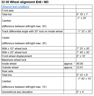

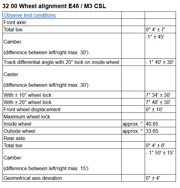

              I have attached the normal M3 as well as the CSL specs in images.
              If you use the CSL specs, which have very little toe-in on the front and rear, close to 0 as others have recommended, the car will drive great.

                This is what I had before a more aggressive alignment for track and it is great for street use and some more spirited drives. Not sure where they are getting those min and max from for "in spec". Looks way off to me.
