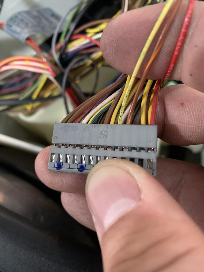

    Frank had his Snap-On diagnostic tool plugged into ODB port. We were watching refresh values of +122F, 33F, -10F, +132F....it went on and on. I had a spare IAT sensor plugged into the airbox (since I relocated the sensor) and using a different sensor, the same error readings occurred, so we ruled out the sensor.
    I had to do a full check of wiring on the spot. I pulled up 0-06's post and checked all the wires; the only discrepancy was pin 16/17. I solded into 17 on the spot, we checked the diagnostic scan and boom, straight +68F.
    At the risk of sounding uninformed (I am uninformed so hell with it), if you do a continuity check between 16 and 17, there is no continuity. I know that's probably due to circuitry limitations (total blackbox for me) but it doesn't help with peace of mind.
    Sorry, I left out one other bit of detail in this write-up. Sharing for sake of transparency. I am using the same source for two grounds: 1) the IAT and 2) flap position sensor
    Using pin 16 for IAT and flap position sensor: I got faulty IAT readings
    Using pin 17 for IAT and flap position sensor: fixed my faulty IAT readings.

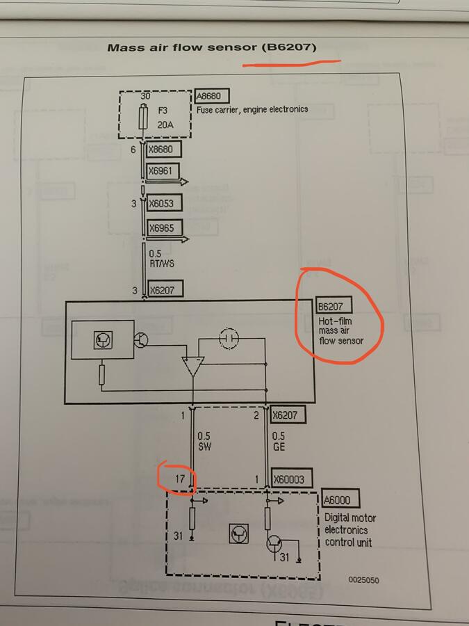

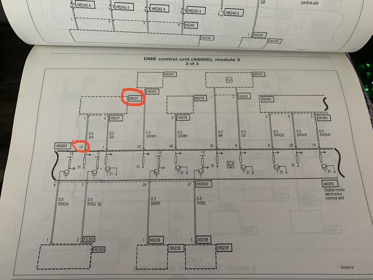

                        Pin 17 is the MAF sensor on a non-CSL model car. You can unplug that wire and replace it with the MAP sensor wire OR just tap into it. It's really up to you...you might want to keep the wiring, if you ever consider removing the CSL airbox and going back to stock. If you plan to keep it forever, just remove the MAF sensor wiring all together.
                        Below are the wiring diagrams as a reference.
