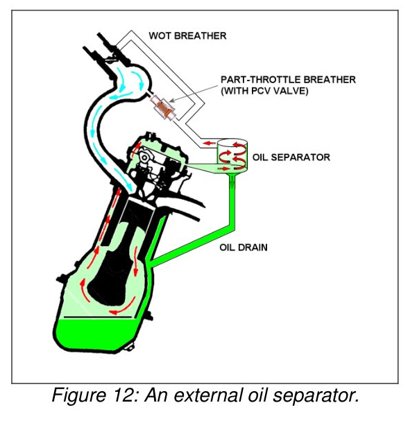

          Generally speaking, the goal with the PCV system (positive crankcase ventilation, also called CCV) is to pull blow-by gases out of crankcase.
          Yeah, I've been trying to get my head around the two versions of this system in S54s for a while too. Maybe you can help me with my understanding. I think the earlier version is a basic CCV, i.e. it vents the crankcase through the cyclone separator but isn't positively scavenged using manifold vacuum. This is because the ITB design means that - unlike normal cars - the airbox doesn't have vacuum (vacuum being a function of the restriction of airflow by the throttle plates and/or ICV depending on throttle position.) If you connected the airbox and the air rail directly (bad PCV valve), you would have a vacuum leak proper. So the PCV valve must be sealing against air rail vacuum even if not powered electrically (CSL tune).
          We're not talking the crankcase here, we're talking the valve train but the term and idea remains; there are some blow-by gases (unburned hydrocarbons) in the valve train as well as oil vapor. After those gases/vapors pass through the oil separator, they are pulled out through the corrugated vent hose (the topic of this thread) and sucked into the intake manifold where they are fed into the engine.
          The valvetrain and crankcase are connected, right? Is there a meaningful distinction there?
          During engine idle, and at very low loads, the throttle valves aren't open. That means no vacuum in the intake manifold and ultimately, no pulling the gases out of the valve train under these conditions.
          Right, so there's just positive crankcase pressure built up by mild blowby at idle which is then vented into the airbox through the cyclone separator, but not drawn out by vacuum.
          So, where is there vacuum during idle and very low loads? In the idle air system. That's why you have the small corrugated line on post '04 vehicles feeding into the air rail. The air rail is giving the engine its necessary air for combustion and will burn successfully burn off the gases/vapors during idle/very low load.
          That's where I think the "emissions benefit" is ultimately coming from on the later vehicles.

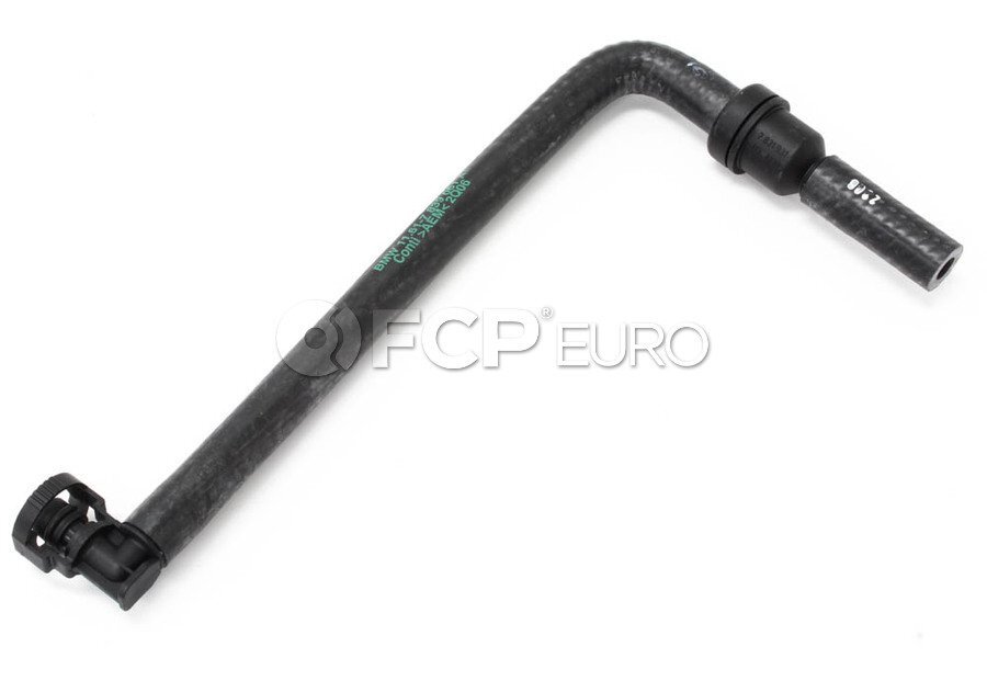

                              Stock piece from FCP for reference:

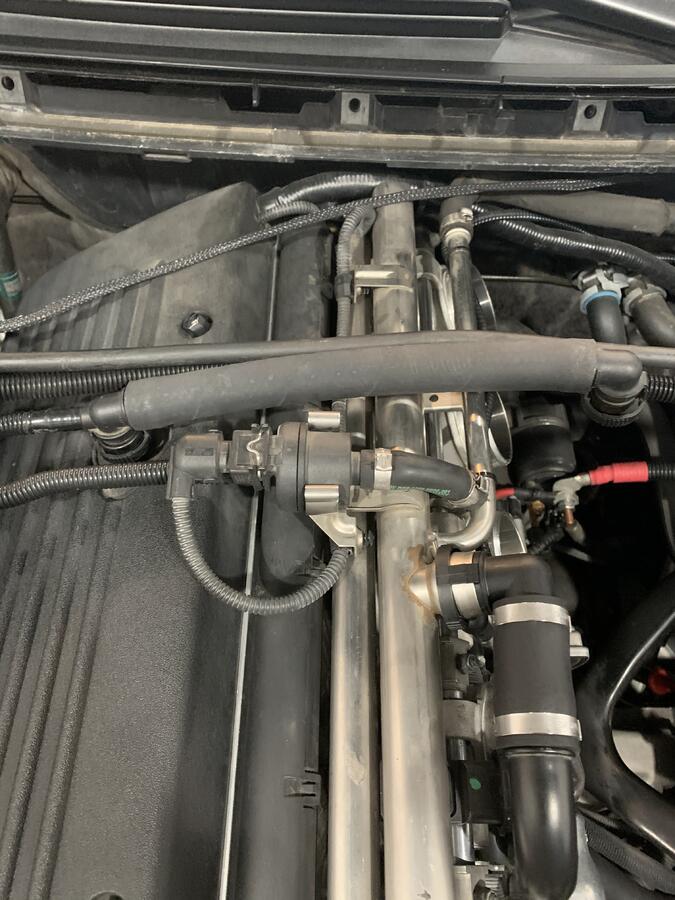

                              My tube:
                              Click image for larger version  Name:	1.jpg Views:	0 Size:	134.3 KB ID:	18084
                              The check valve has an arrow on it labeled "Top" (meaning to airbox presumably), but the flow through the check valve runs opposite the direction of the arrow haha - thanks BMW.
                              Click image for larger version  Name:	3.jpg Views:	0 Size:	50.3 KB ID:	18085
                              Makes sense - otherwise crankcase vapors could just bypass the cyclone separator on pre-04 cars with no vacuum draw on the case by way of this tube.
                                You were right! Also well done with pulling everything.
                                I understand better your comments around a fresh air breather and theory of operation. And yes, I agree the check action prevents vapors from escaping with no vacuum draw it seems. I don't envision a scenario where blowby is so excessive that you have net positive pressure in the system, and that check valve would come into play. Rather I'm under the impression vacuum is always going to exceed blow-by forces in an engine with properly sealing rings.
