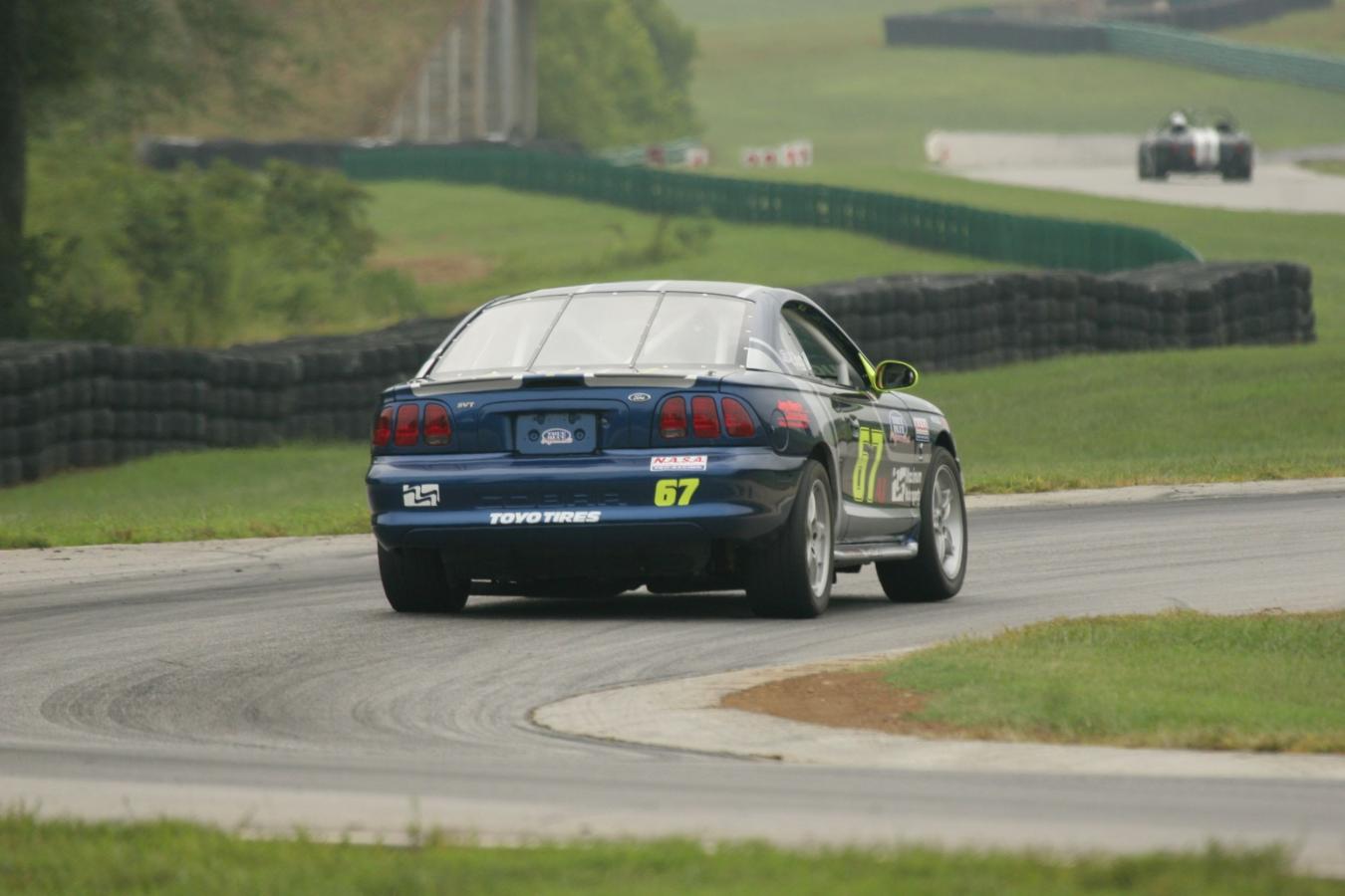

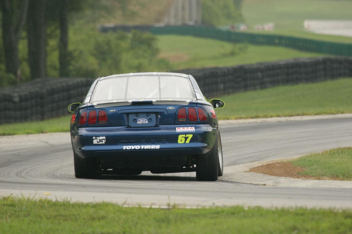

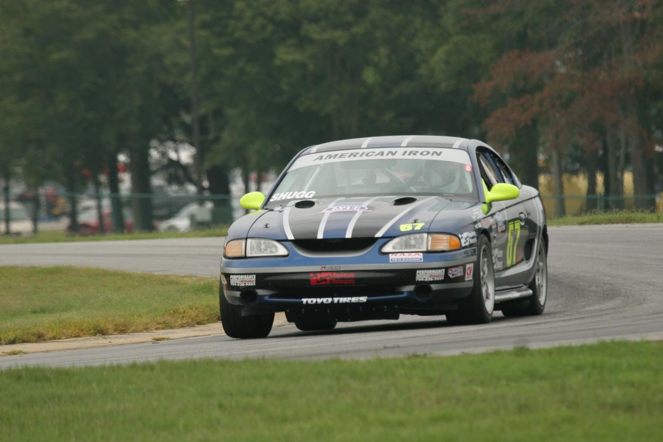

                            I removed the rear bar when I built the roll cage but before I put any aero devices on. It adds a lot of rear end grip. A sway bar makes an axle less independent and more of a solid axle...like a Mustang
                            I apologize in advance for it because "this isn't M3", but a quick tangent related to the parts I bolded. I'm still sorta on topic. bigjae46 not singling you out on purpose despite me quoting you. Nothing directed at you other than progressing the conversation, my brother in speed.
                            People like to point to the Mustang as the poster child for bad handling (myself included), in large part because of its Model T suspension design and propensity for snap oversteer. That reputation is due to its stock 4-arm suspension design which binds under heavy lateral/cornering loads, effectively taking the spring rate way up. However, there are a lot of suspension designs built around a live axle rear that are pretty amazing. Like a Watts link or panhard bar combined with a torque arm.
                            The beauty of a properly setup solid/live axle is that you don't need to worry about the camber changing - BOTH rear tires stay planted on the ground regardless of what the chassis is doing above it. This equates to lots of grip, better braking, a more predictable behavior at the limit (oh the irony) and the ability to put the power down incredibly well. Especially with a torque arm which loads those rear tires up like John Pinette's plate at a Chinese buffet.
                            Here are 3 pics, all in the same relatively high-G corner, that illustrate two points:
                            1) Removing the sway bar on the M3 allows the inside tire to stay in contact with the road. With the solid axle, it just happens naturally. Despite its reputation, the stick in the rear can handle like a mofo.
                            2) The downsides to static negative camber on a McPherson strut design.
                            First pic in mid-corner, look how flat the rear axle is compared to the inside front tire. Same thing with the second pic on corner exit.

                            Third pic is the same corner but shot from the front. It illustrates my 2nd point. On this car, this is pretty perfect [front] negative camber for that track at that corner - even still, the inside tire is marginalized (pic 1 and 2) due to that static negative camber. But look at the contact patch on the rear inside tire...

                            I love that you did this!! How do you know you're at 1.8Hz?
                              This is awesome illustration of how negative camber is affecting at turn in.
