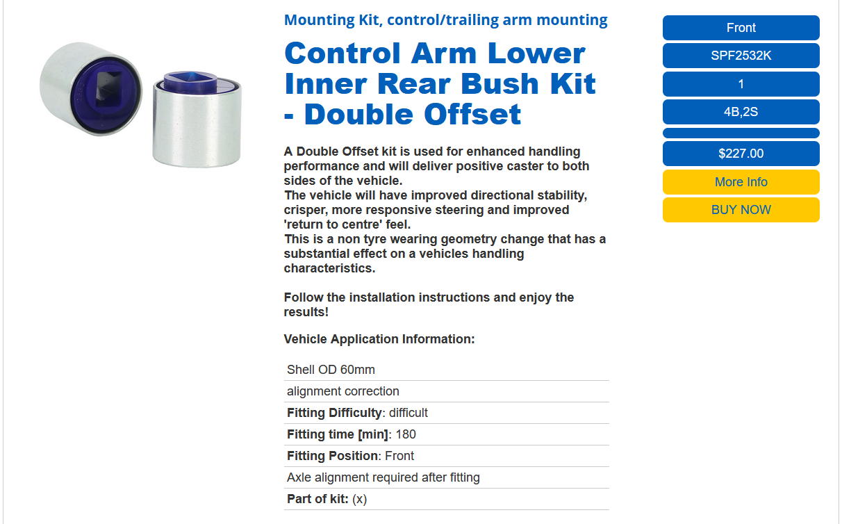

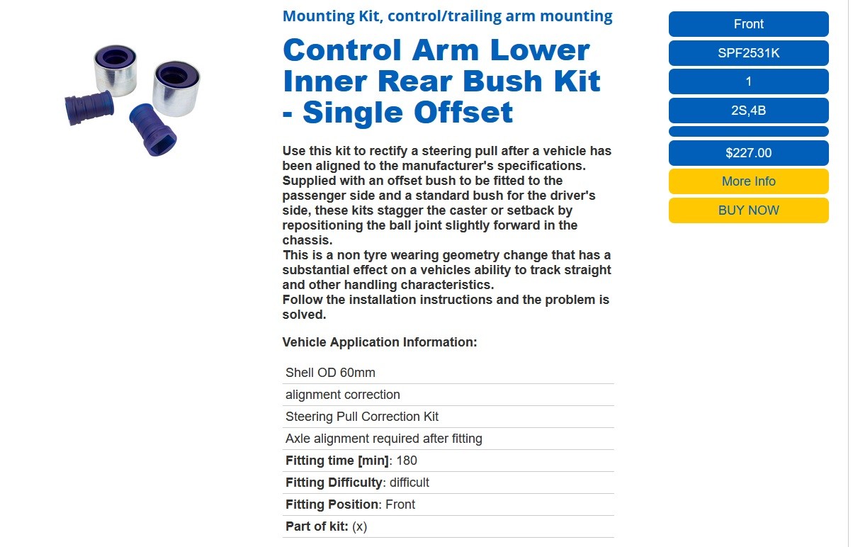

              tomasidris
              ​We have these here in Australia, It might help
              I am struggling just to find standard springs here, Every thing is EX USA, U.K or Europe, All the after market spring don't suit SMG accept Suplex, and off course is " out of stock "
