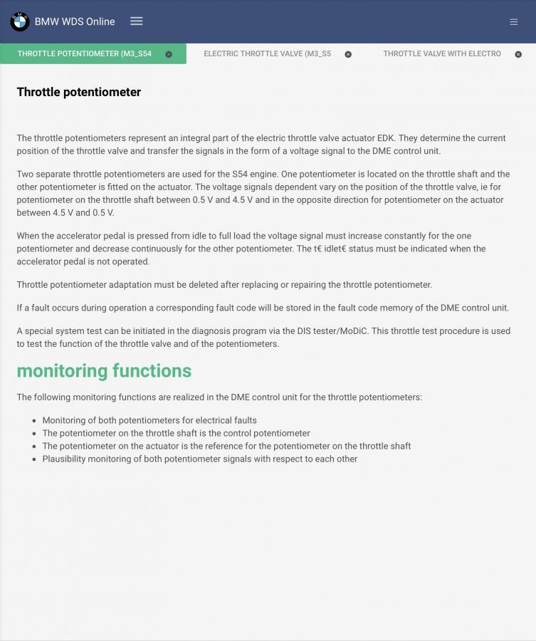

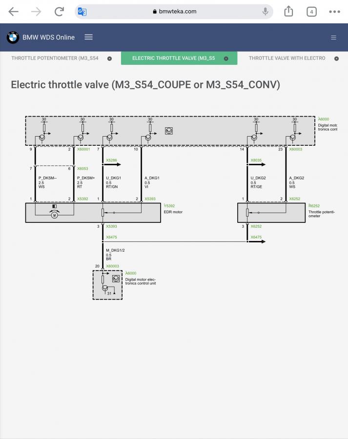

              TPS 2 is definitely the one by oil filter housing. On schematic it’s R6252
                Pedal position sensor schematics below. Hope it helps
