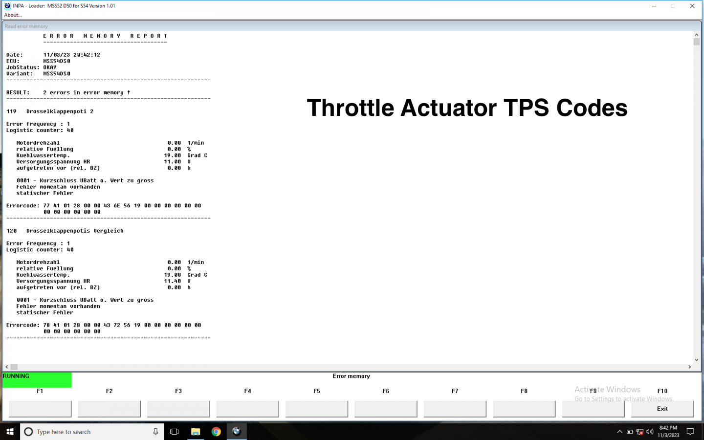

INPA code "Throttle valve pot. 2" -- which TPS is that?
    Realized I never updated this with my findings.
    Swapped all three things on my car and while doing so, I decided to disconnect each TPS one at a time and check codes to finally settle the debate.
    TPS by the oil filter housing disconnected:
    Click image for larger version  Name:	Oil Filter Housing TPS Codes.png Views:	9 Size:	198.9 KB ID:	244115
    TPS on the throttle actuator disconnected:
    Click image for larger version  Name:	Throttle Actuator TPS Codes.png Views:	9 Size:	196.6 KB ID:	244116
    Pedal disconnected:
    Click image for larger version  Name:	Pedal Codes.png Views:	9 Size:	188.8 KB ID:	244117
    In summary, TPS 1 is by the oil filter housing, TPS 2 is on the throttle actuator and the pedal throws its own codes.
    Edit: Oh! Caveat to all of this is that I'm running CSL engine management. I think the mapping is the same as stock, but did not confirm that.
