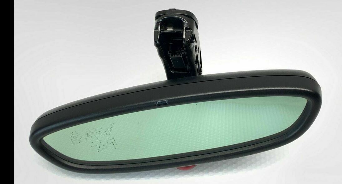

    The original Oval mirror in my 2001 recently fall apart from age and I was looking at replacing it with a Oval Mirror from a Z4. Will this directly fit without any issues?

    Yes, from what I recall, the updated part is the Z4 mirror - https://www.ecstuning.com/b-genuine-...r/51169142225/
      Yes, I bought a manual dimming Z4 mirror off eBay and it fit right up. I can’t recall if I had to open it up to transfer wiring and keyless entry receiver. Looks fine in the car.

        Good to know. I was looking at a Auto-Dimming version. How does the manual dim version function?

            On the unit I got, the red plastic “clown nose” is grey and twists 1/4 turn to angle the mirror surface. It’s nice looking, I have control of the “dim”, and it’s leak-proof!
              Yes, but if you have SOS mirror on your M3 DO NOT PLUG IT IN. It will explode....literally. Ask me how I know that. Look up a tutorial about what wires to cut or relocate if you have SOS.
                Unless you want autodim feature, highly recommend going with manual dimming version in that shape; Its a lot cheaper while future-issue-proofing at the same time.
