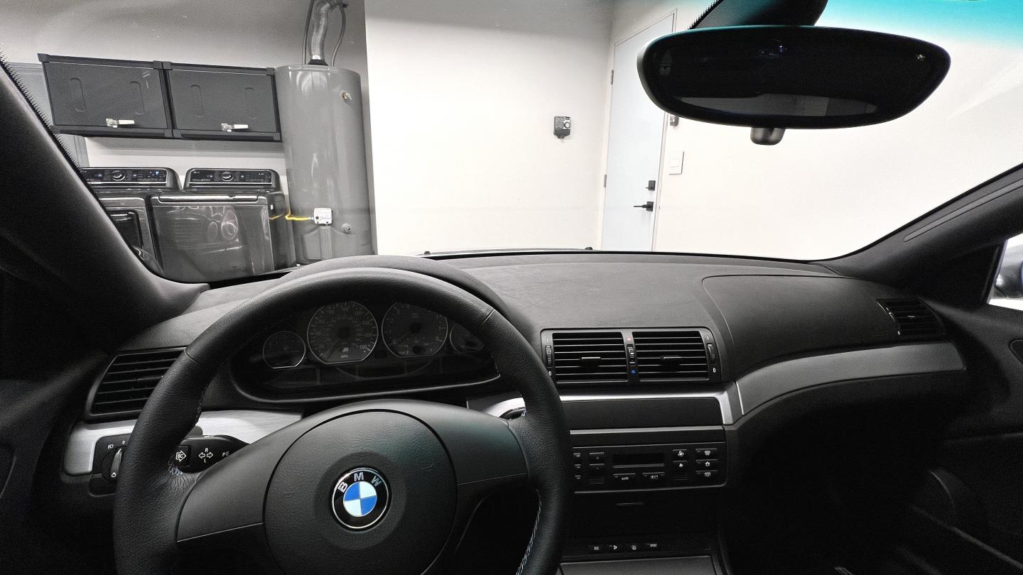

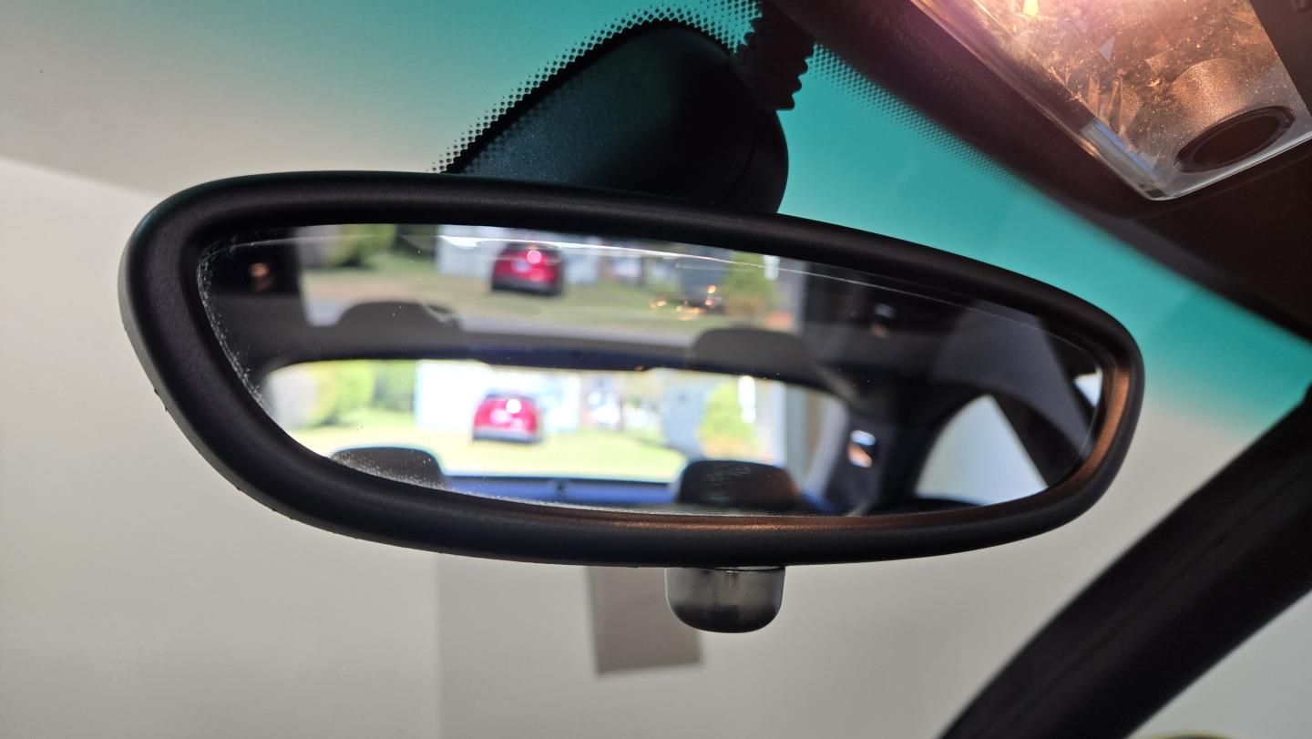

        Z4 mirror confirmed.
        Looks good.

              Finally getting around to replacing the mirror in my M3 with the Z4 mirror. Did you need to make any modifications to make this work?
                #52
                The hardware itself is 100% plug and play. Remove old mirror, twist new mirror on, reconnect harness. You may have to move some pins around on the wiring harness depending on your car. For my car, I just left the wiring harness unplugged, as I don't really care if the LED blinks when it is locked, the car stays in my garage 24/7. If you send me a message I can dig up and send you all the mirror wiring resources I have saved.
                Interesting fact, to make the mirror dip for night time driving, you twist the clown nose, there is no lever on the back like most mirrors.

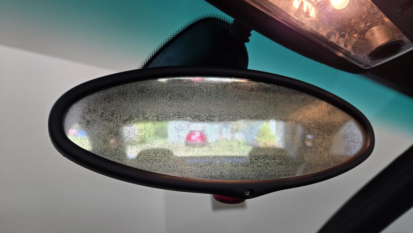

                  #53
                  I finally installed a Z4 manual rear view mirror this past weekend. The installation was effortless, and the harness plugged right up. My original oval mirror had been repaired by Sysbema's Electronics but developed a spotty haze in the glass a few years back. Replacing the rear view mirror was long overdue.
