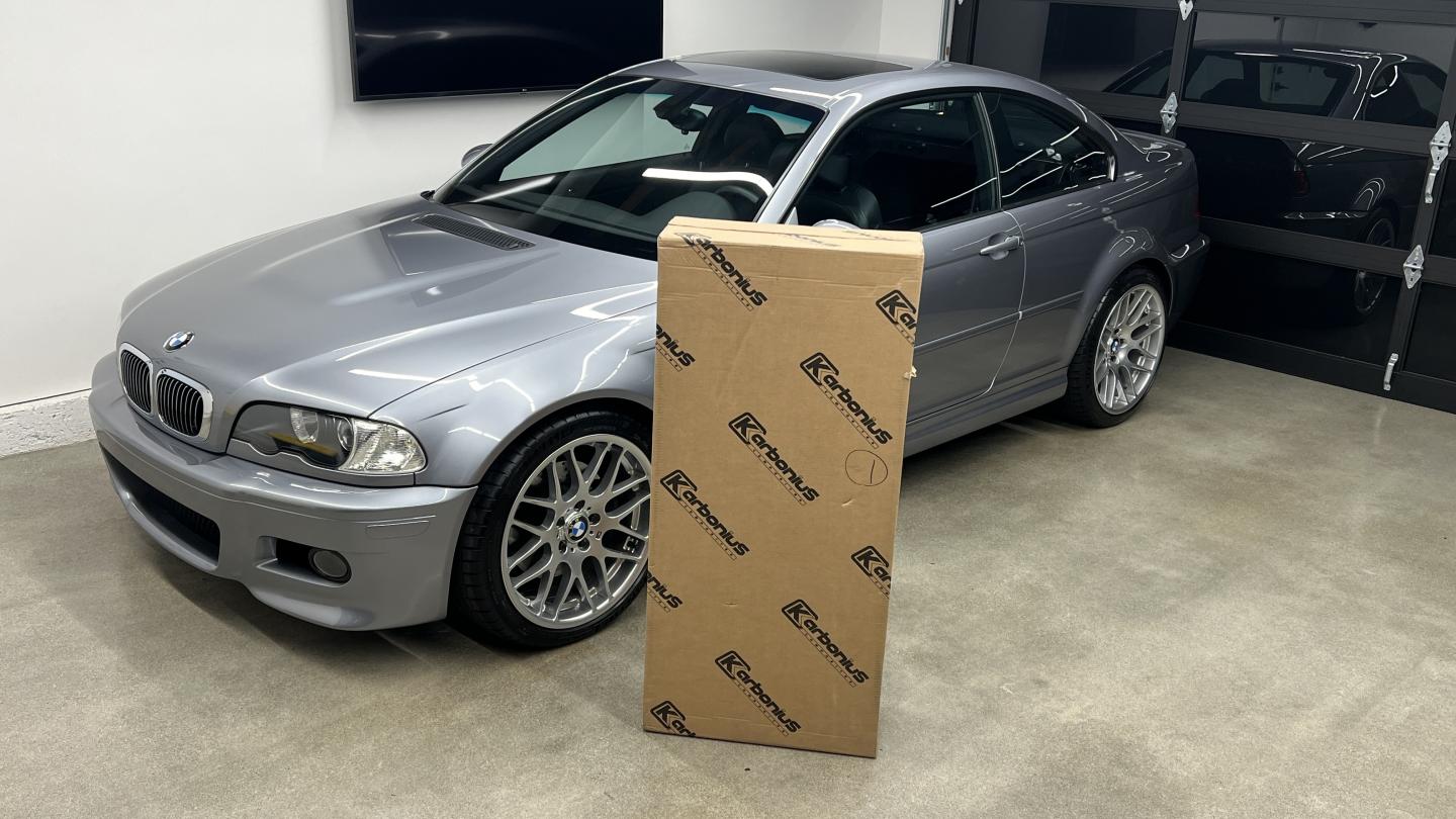

    Due to this, I ordered the Vorsteiner CSL rear diffuser. Judging by all the photos I have seen, it is a true 1:1 replica of the CSL diffuser, ridge and all. It actually seems to fit better than the original CSL diffuser, especially in the upper corners. Vorsteiner is local, so I will pick up the diffuser and do a mockup once ready.
    Karbonius CSL interior parts should ship near the end of this month (November 2023). I have been collecting all the accessory parts (hazard trim, mirror switch trim, brackets, etc) as well as preparing the wiring for a streamlined install.

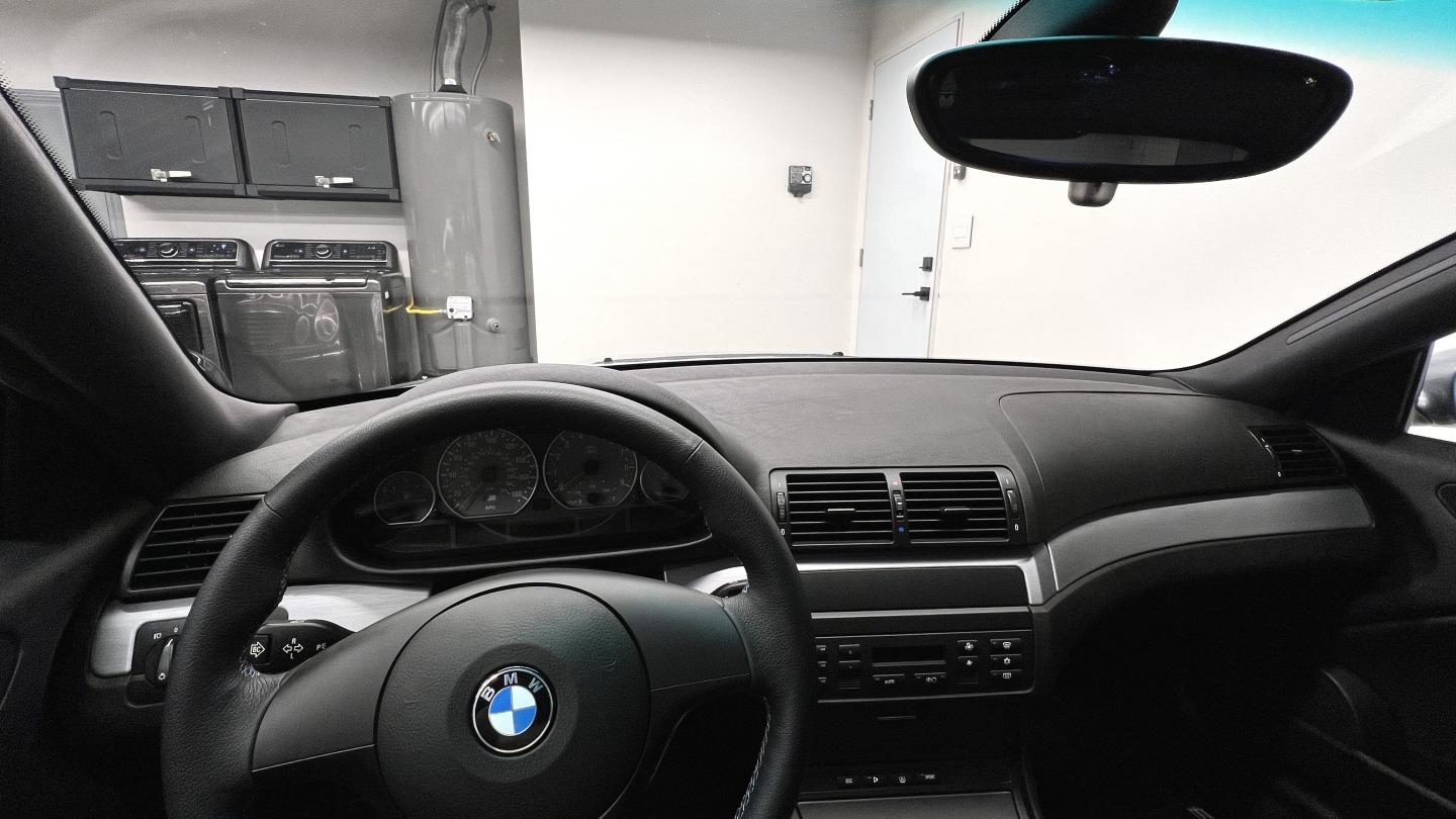

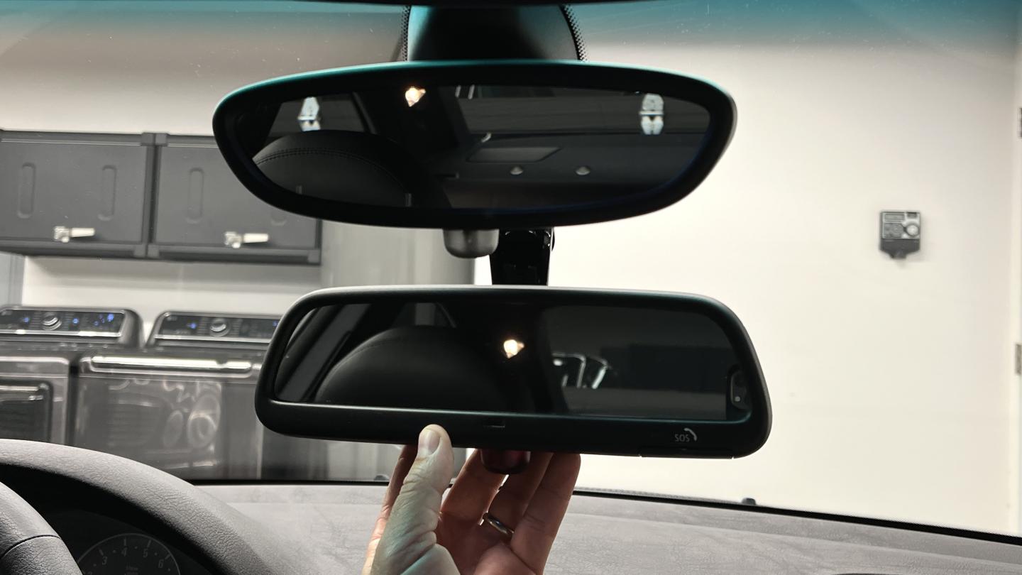

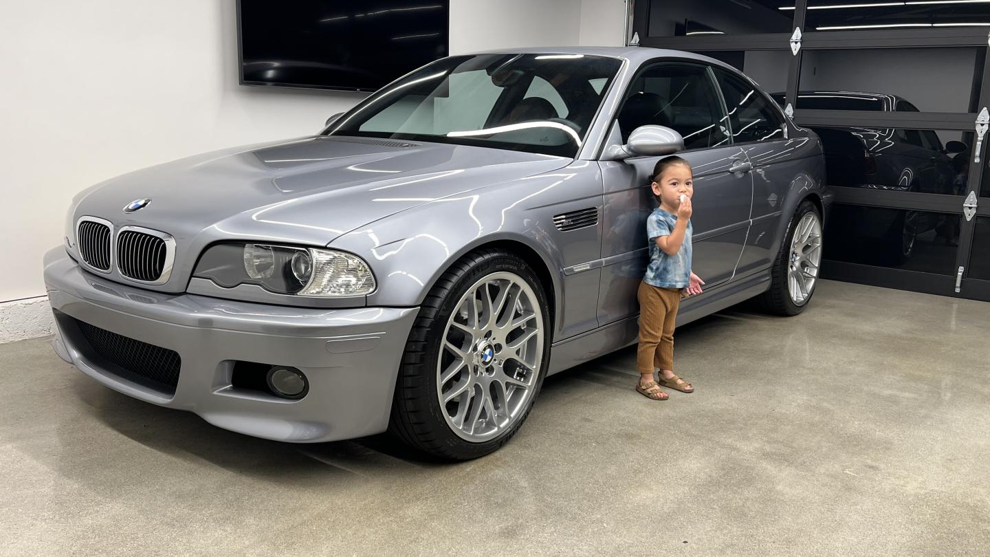

    Z4 rearview mirror (51-16-9-134-400) installed. The mirror that came with the car looked chunky and out of place, I previously deleted the SOS module in the trunk, and i'm not a fan of the auto-dim feature. The Z4 mirror has less features to potentially break, is shaped better, and has the smoked grey "clown nose". The mirror fits perfectly with the streamlined, driver focused theme I am going with. The simpler, the better.
    Click image for larger version  Name:	IMG_4476.jpg Views:	0 Size:	85.8 KB ID:	241057
    Click image for larger version  Name:	IMG_4477.jpg Views:	0 Size:	130.0 KB ID:	241058

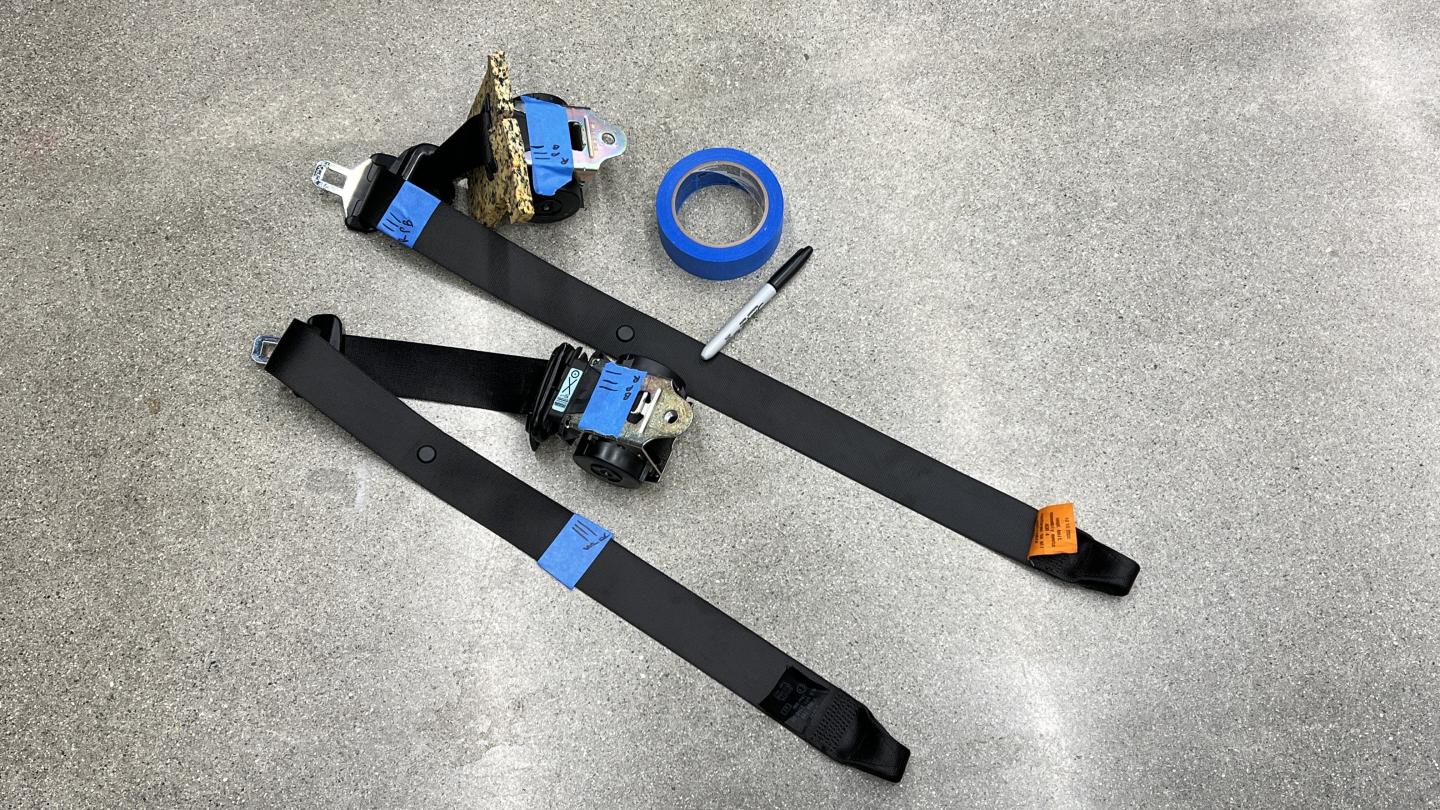

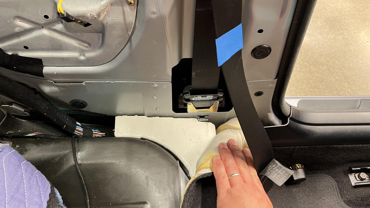

        A while ago, I decided that I wanted to add the M tri-stitch seat belts found in the more modern cars like the F80/G80/etc. I have been waiting for an opportunity to remove them and ship them out, and I decided to time the seat belt project with my Karbonius CSL parts installation project. The Karbonius parts should be shipping soon and it just made sense to remove all of the interior a single time, rather than doing it again at a later date.
        My son is now two years old and we recently welcomed our newborn daughter. It is difficult to find time for anything extra, so I took on the disassembly in the middle of the night while they slept. Dad life.

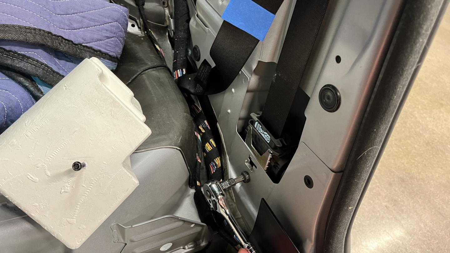

        Started by taking out the rear seats, rear door panels, and b-pillars to allow access to the front seat belts. The seat belt winder is tucked really low, and the bolt for it is behind a foam block. I tried pulling up the block but didn't realize there is a hidden screw underneath the carpet that is holding it in. I ended up popping some of the door sill trim clips and peeling back the carpet to allow access. Pesky screw!
        Click image for larger version  Name:	IMG_4678.jpg Views:	0 Size:	149.6 KB ID:	243203
        Click image for larger version  Name:	IMG_4680.jpg Views:	0 Size:	137.5 KB ID:	243205
        Click image for larger version  Name:	IMG_4681.jpg Views:	0 Size:	148.0 KB ID:	243206
        Front seat belts out. Interestingly, the passenger's side belt had a foam insulation around it, but the driver's side didn't. Anyone know if this is correct or know the part number for the driver's side?

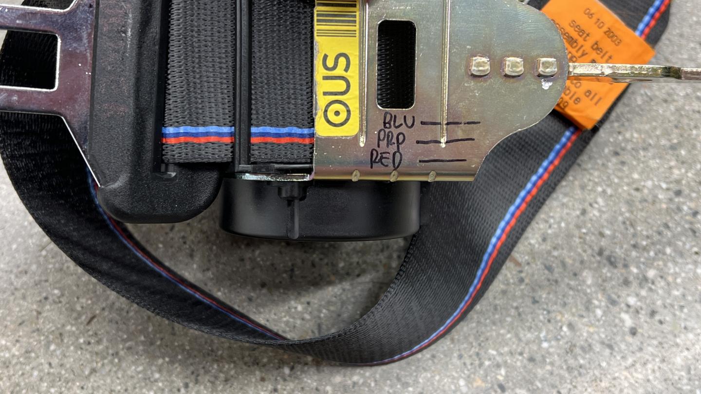

        Prior to removing them, I marked the belts with tape designating where the stripes should be. If you look at the modern cars, the orientation of the stripes changes depending on where the belt is in the car. For the rear seats, the red stripe is towards the outsides of the car. For the front seats, the red stripe is towards the front of the car. I wanted to make sure my seat belts followed the factory orientation.

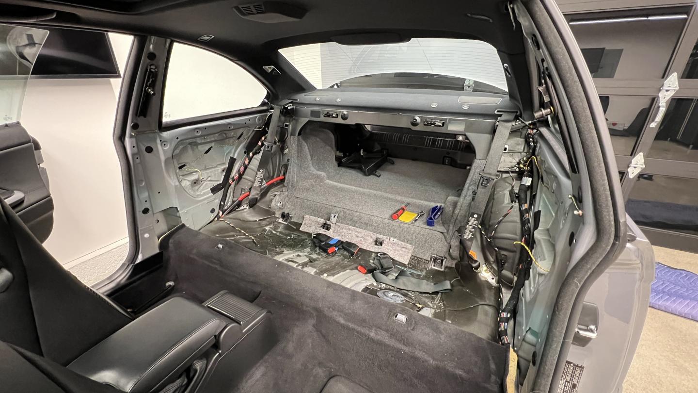

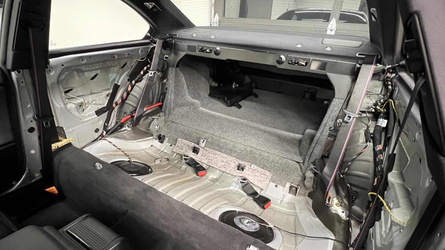

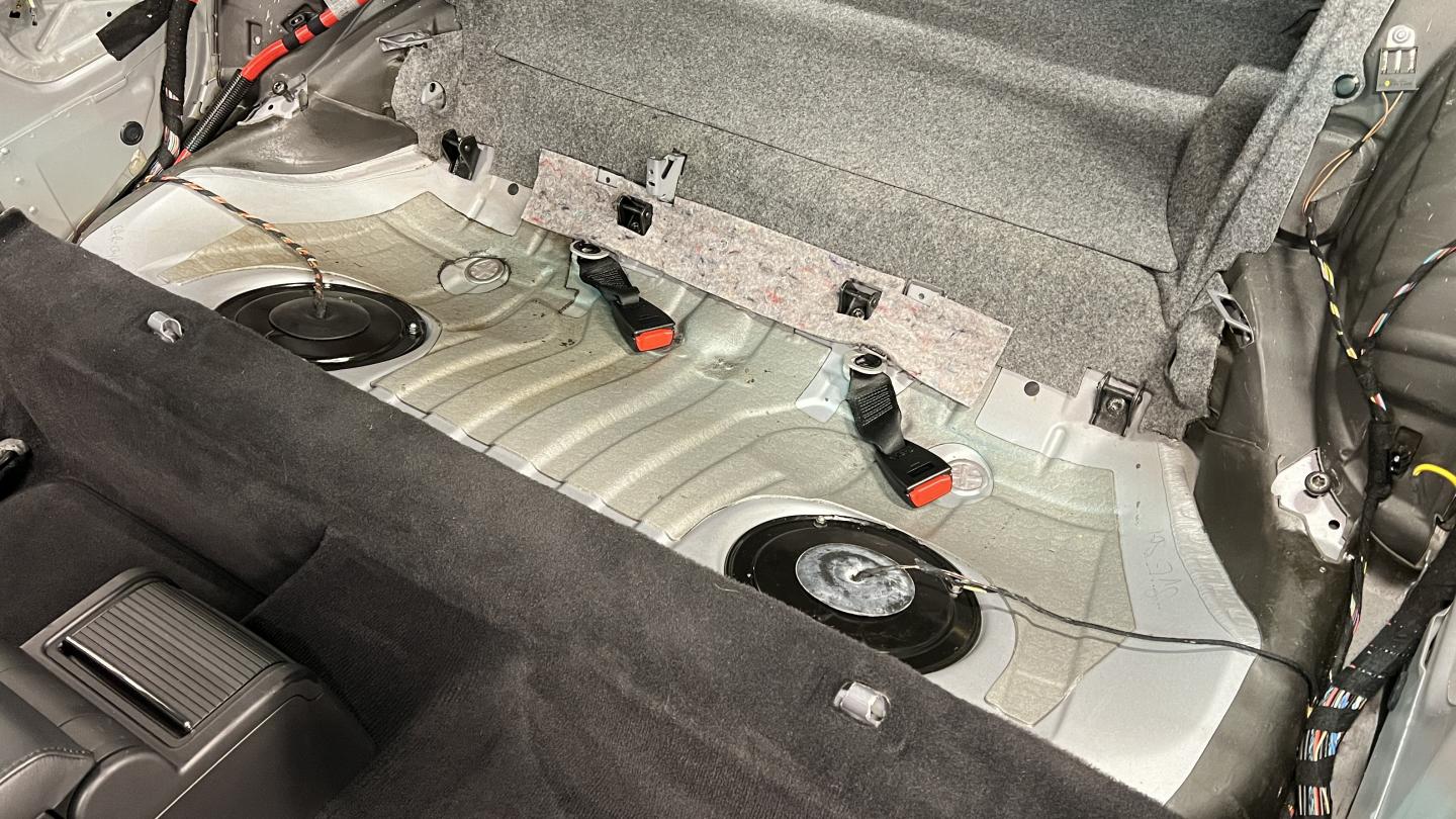

        Onto the rears. I took out the c-pillars, through loading trim, seat belt outlets, and the parcel shelf to allow access to the rear seat belts.
        Click image for larger version  Name:	IMG_4693.jpg Views:	0 Size:	182.7 KB ID:	243209
        Rear seat belts were removed and marked just like the fronts.
        Click image for larger version  Name:	IMG_4689.jpg Views:	0 Size:	322.3 KB ID:	243239
        While they were out, I deleted the center lapbelt. I always hated how sloppy it looked in the rear seat, even when it was wrapped up. I used my seat belt cutter to remove the lapbelt/buckle.
        Click image for larger version  Name:	IMG_4692.jpg Views:	0 Size:	356.9 KB ID:	243211

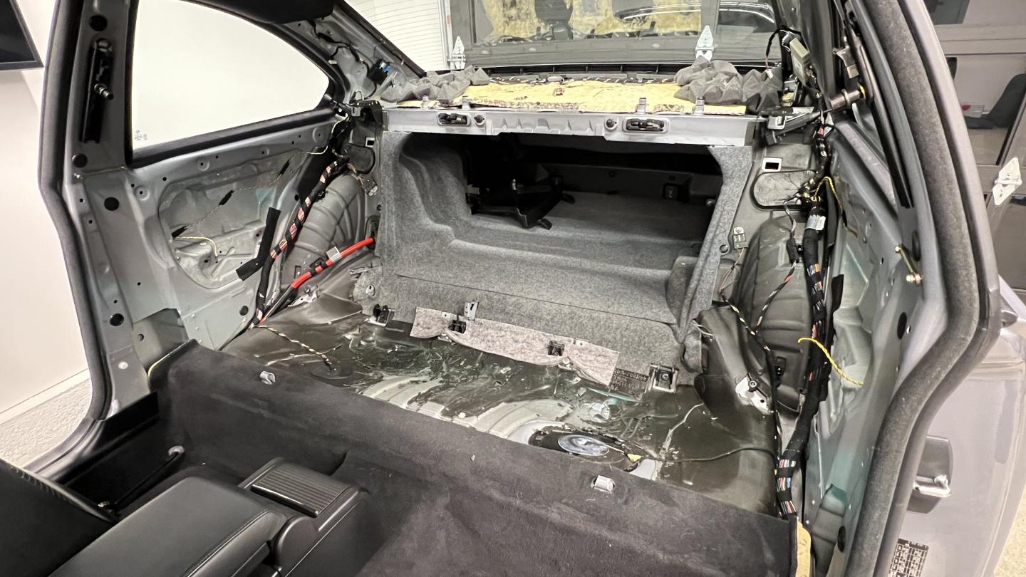

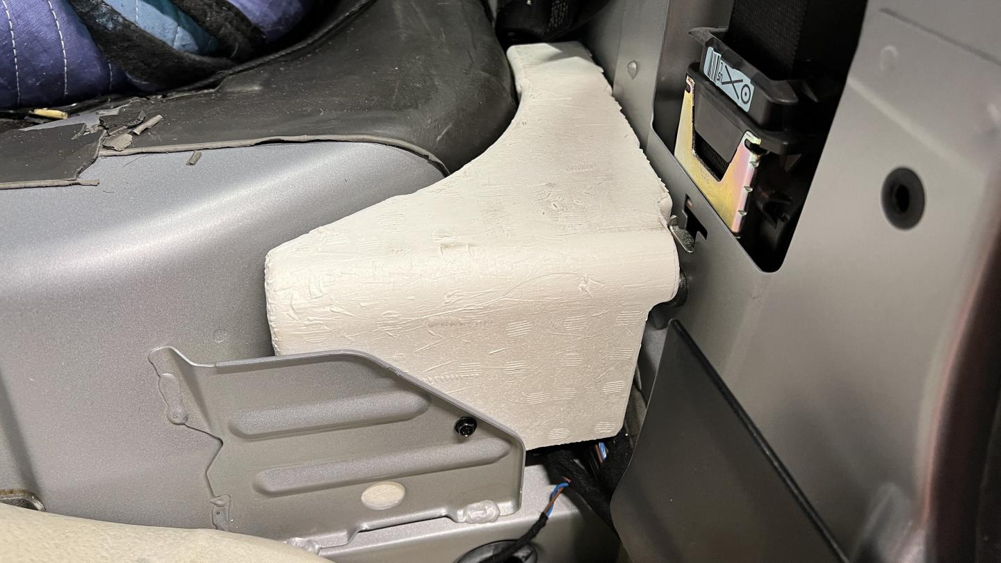

        As I was working on the seat belts, I contemplated removing the disintegrating sound insulation under the rear bench. The center portion of it was a total loss, but the sides were still in good condition. Ultimately, I committed to removing most of it. I stole one of my wife's surgical scalpels and cut a clean line around the edges.
        Click image for larger version  Name:	IMG_4694.jpg Views:	0 Size:	217.1 KB ID:	243214
        Click image for larger version  Name:	IMG_4695.jpg Views:	0 Size:	171.8 KB ID:	243213

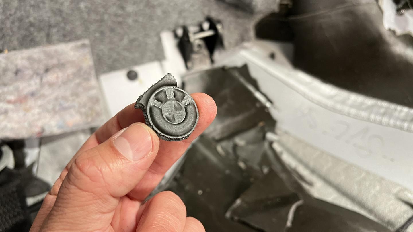

        Thought this one was kind of a cool find.
        Click image for larger version  Name:	IMG_4696.jpg Views:	0 Size:	93.2 KB ID:	243212

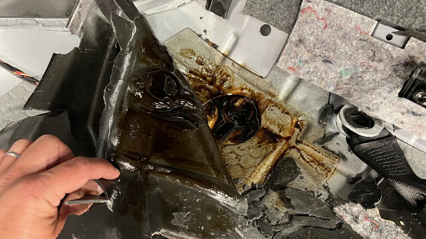

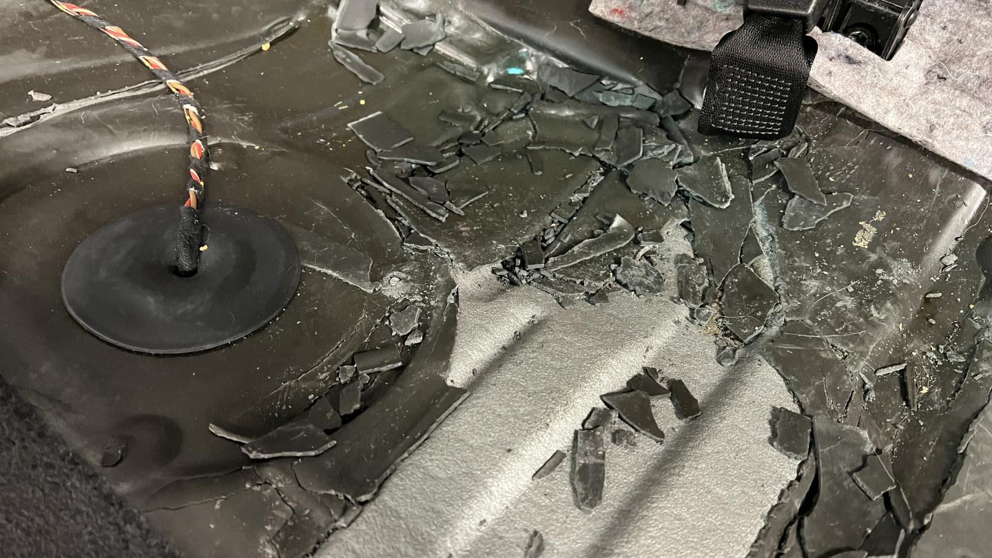

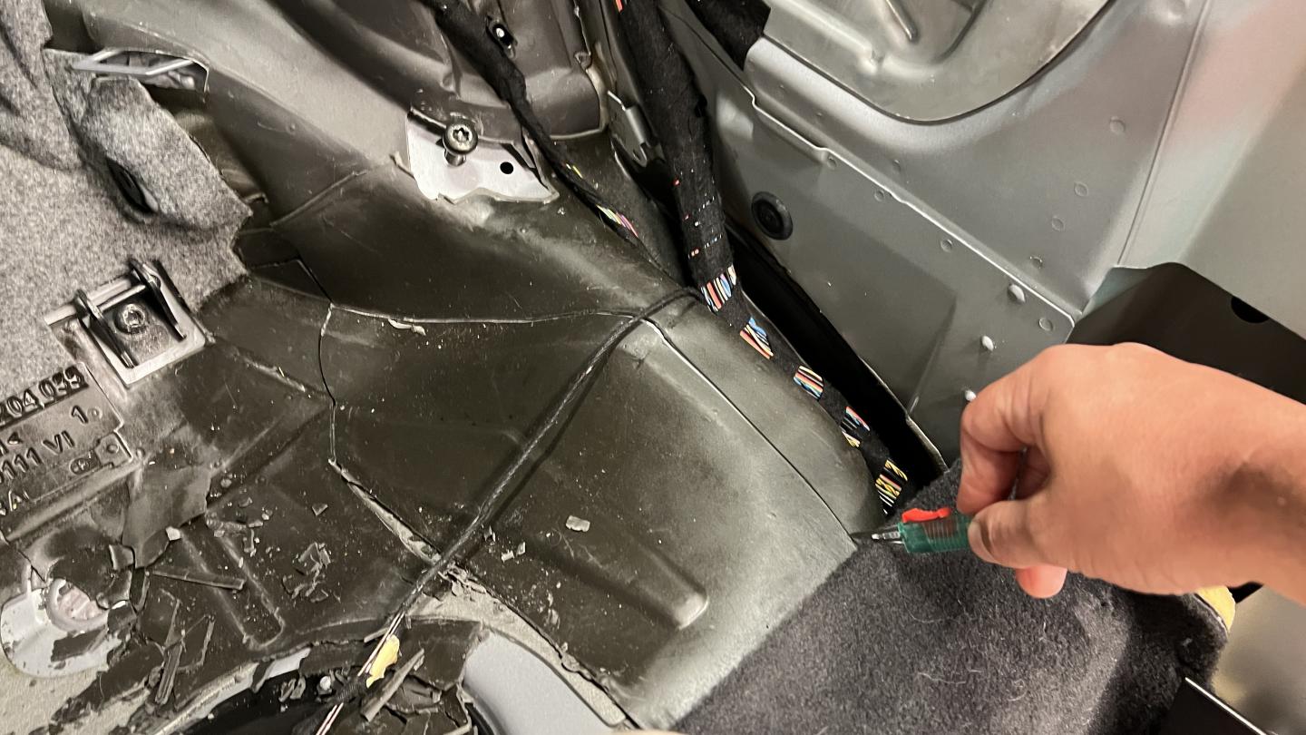

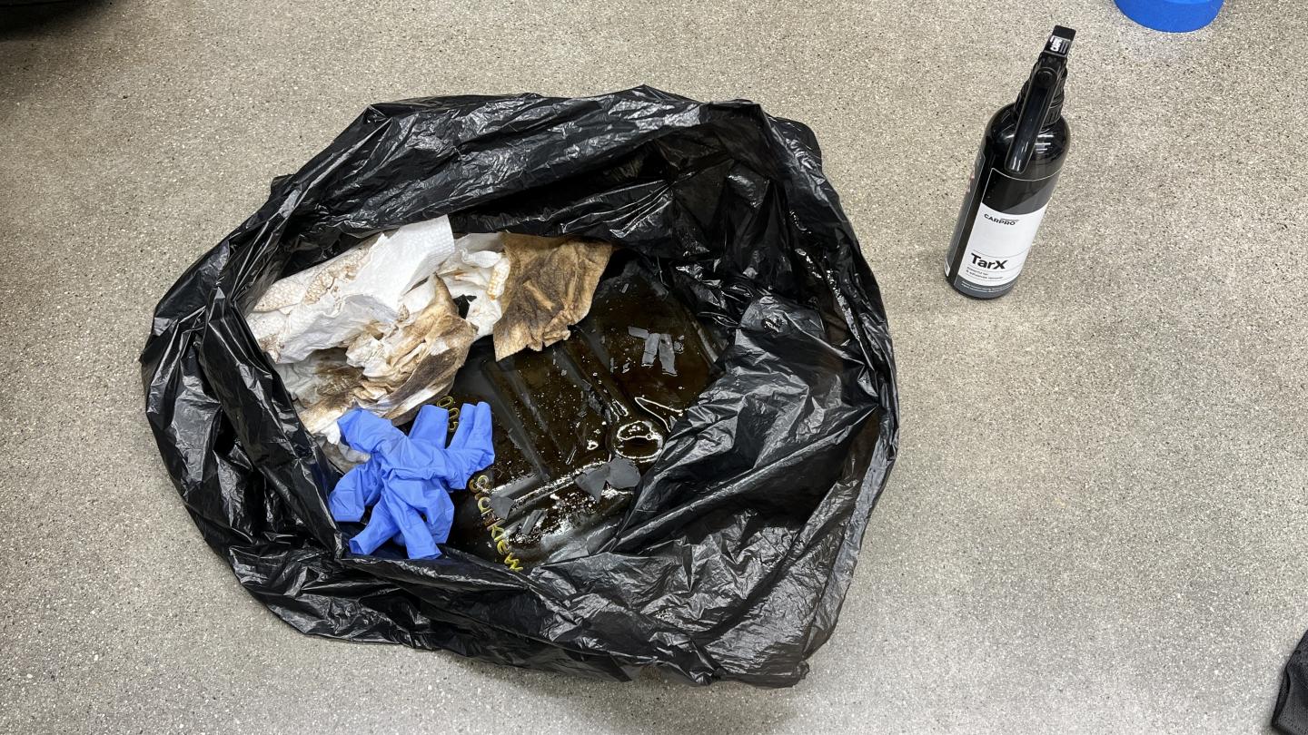

        The driver's side came off really cleanly. When I got to the passenger's side, I uncovered a huge sticky mess of what I am assuming is old melted adhesive? At that point that I thought, "Why the hell did I commit to this?" Immediately followed by, "Why did I not put gloves on?"
        Click image for larger version  Name:	IMG_4697.jpg Views:	0 Size:	243.1 KB ID:	243215
        Many moons later it was all cleaned up. I used Carpro Tarx and a ton of paper towels to loosen and soak up the mess. I threw the whole lot in a trash bag and was surprised by just how much it all weighed, I get why the CSL ditched it.
        Click image for larger version  Name:	IMG_4699.jpg Views:	0 Size:	323.0 KB ID:	243217
        Click image for larger version  Name:	IMG_4700.jpg Views:	0 Size:	238.3 KB ID:	243216

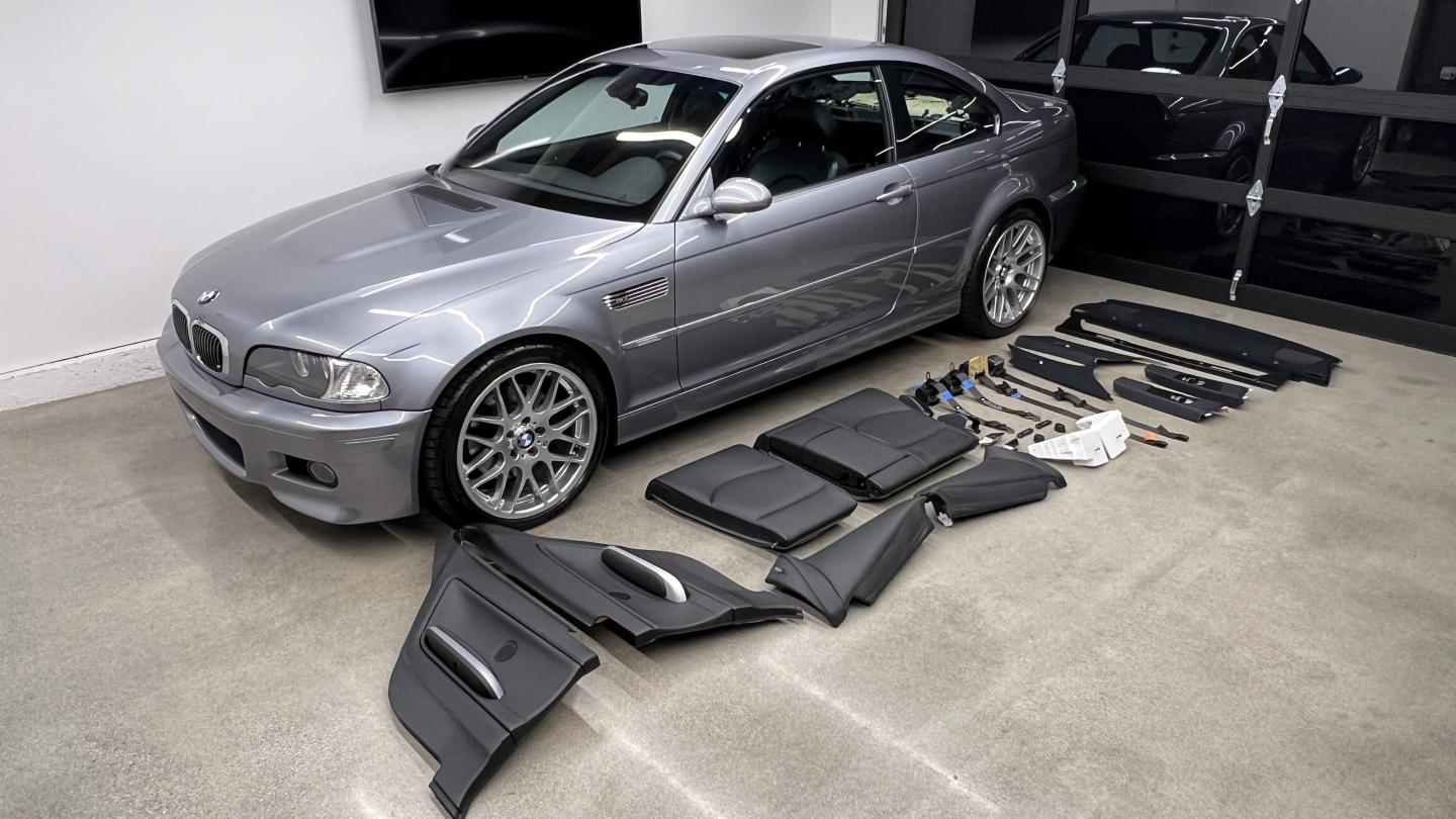

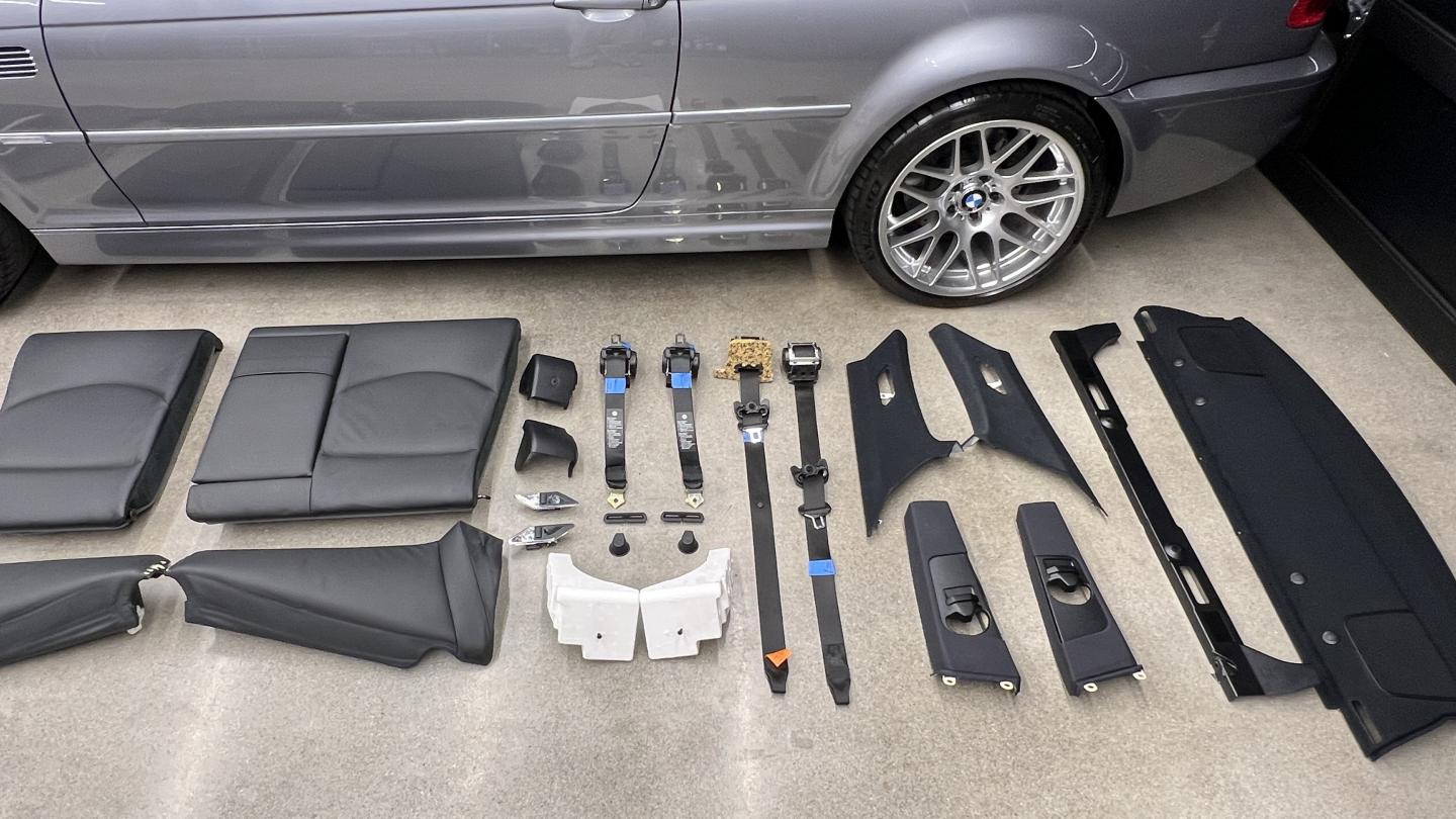

        Here is everything removed from the rear. Something satisfying about seeing it all out and organized. Now the seat belts are getting sent off to get redone as I wait for shipment from Karbonius.
        Click image for larger version  Name:	IMG_4701.jpg Views:	0 Size:	156.7 KB ID:	243218
        Click image for larger version  Name:	IMG_4703.jpg Views:	0 Size:	171.0 KB ID:	243219

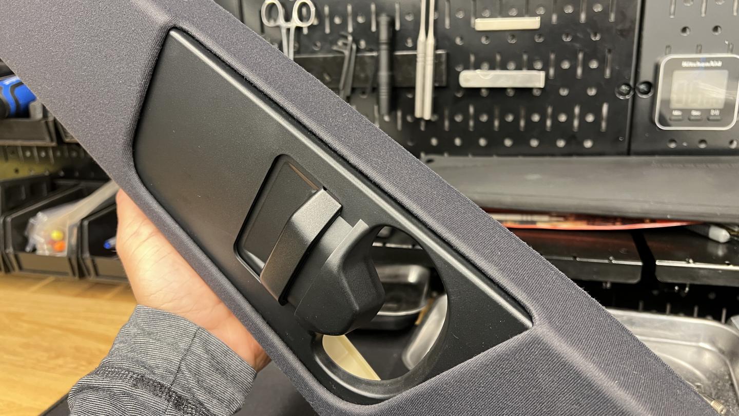

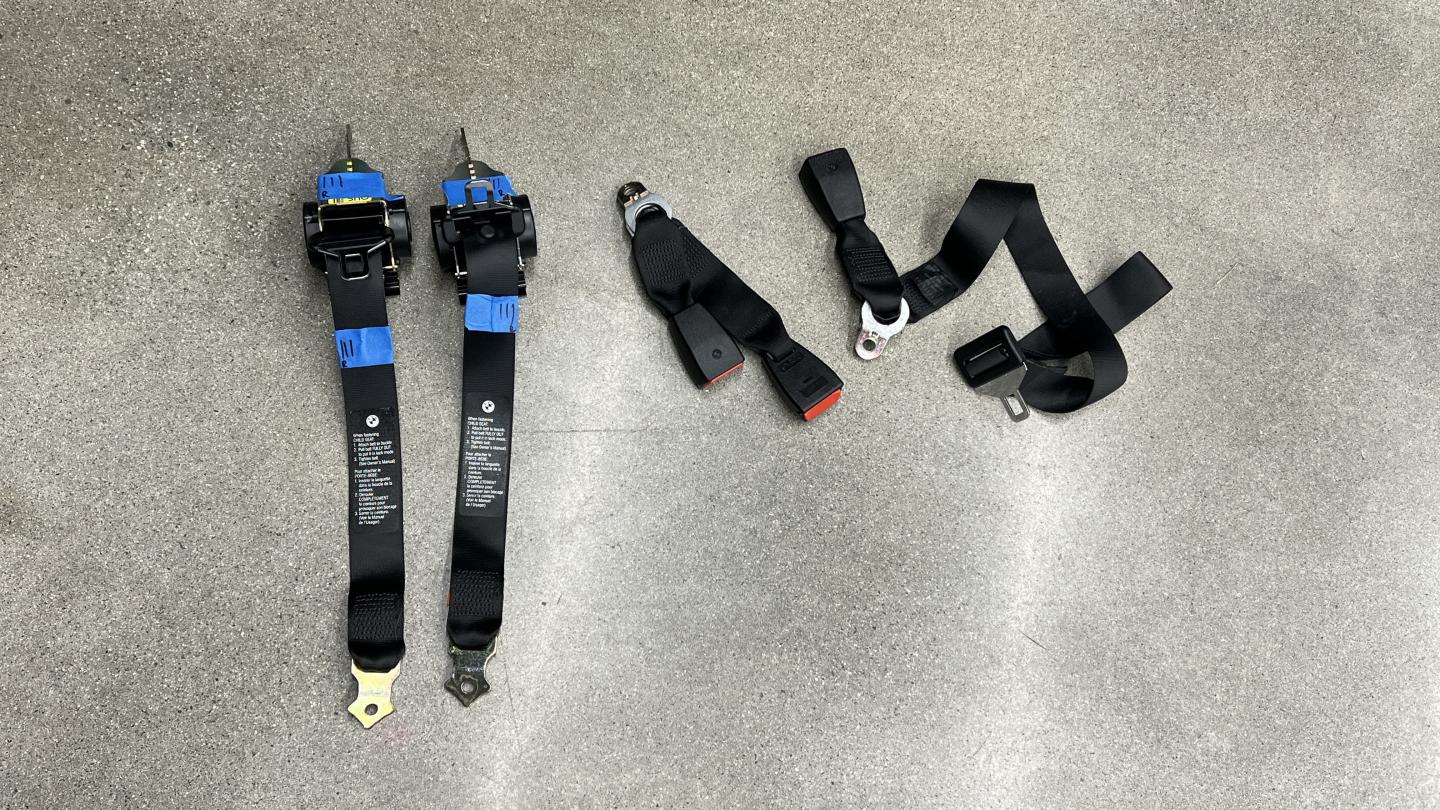

              Seat belts are back.

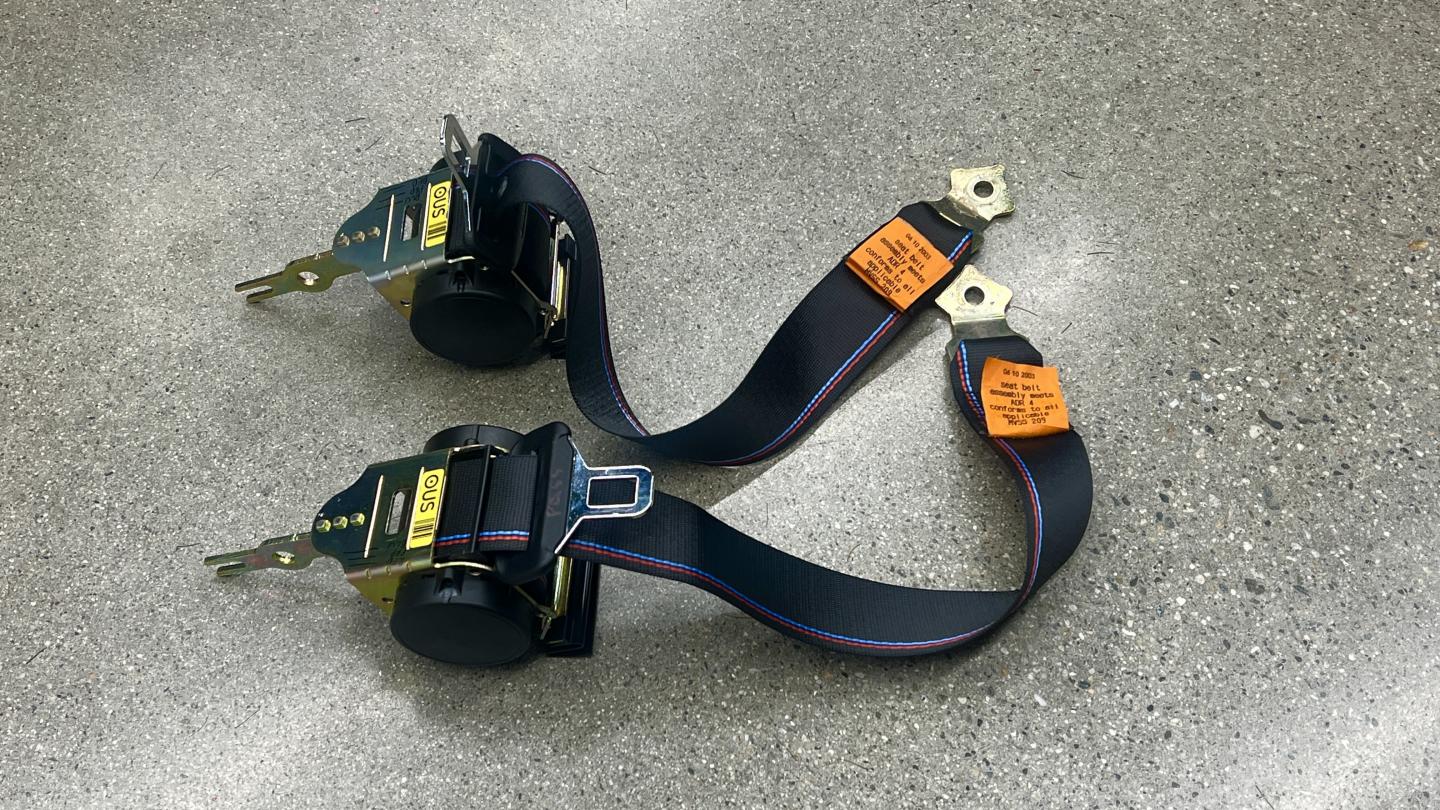

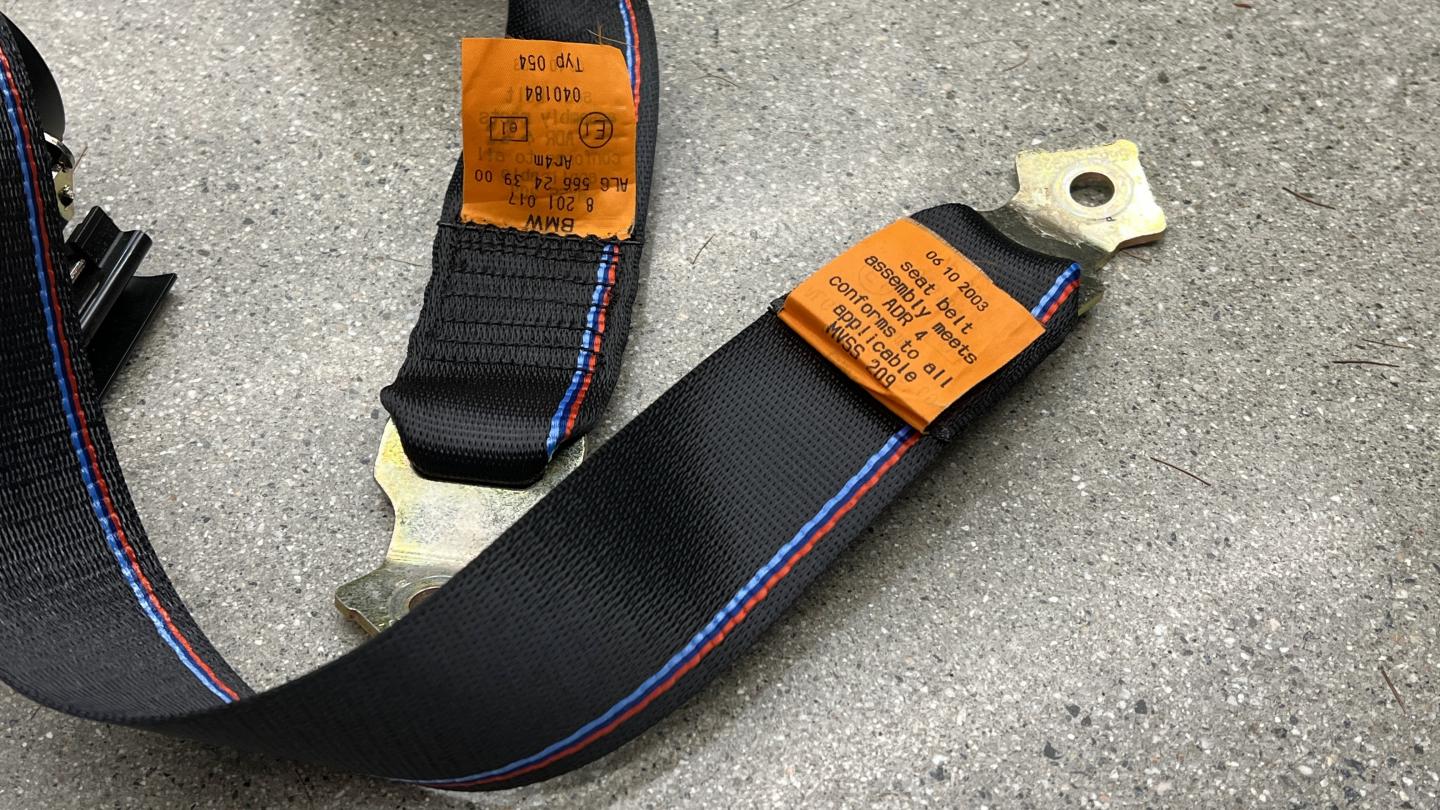

              I sent them off to OEM RDC (Seat Belt Masters on eBay). They have stellar reviews and their pricing was literally half of other popular vendors. They arrived at RDC on Monday, and shipped back out to me on Tuesday (24 hour turnaround). The belts look identical to the factory BMW ones. RDC claims they are from the OEM/Supplier, but I highly doubt that. Regardless, they look great and the orientation of the stripes matches the factory cars just as I specified in my order. All of my factory hardware, including the factory seat belt tags, were transferred over. The only thing that was not transferred over was the limiter button. I purchased some BMW buttons thinking that the RDC ones were going to be cheap shiny plastic. Now that I have them in hand, I don't think I'll be installing the BMW buttons. The RDC ones are decent quality and have a nice satin finish like the factory ones. I will get some better installed photos at a later time.
              Click image for larger version  Name:	IMG_4778.jpg Views:	0 Size:	304.7 KB ID:	244164
              Click image for larger version  Name:	IMG_4779.jpg Views:	0 Size:	271.7 KB ID:	244163
              Click image for larger version  Name:	IMG_4780.jpg Views:	0 Size:	174.8 KB ID:	244162
              Click image for larger version  Name:	IMG_4789.jpg Views:	0 Size:	164.7 KB ID:	244161
              While everything was out I did a small fabric repair on the b-pillar.
              Click image for larger version  Name:	IMG_4760.jpg Views:	0 Size:	199.3 KB ID:	244166
              Click image for larger version  Name:	IMG_4761.jpg Views:	0 Size:	189.6 KB ID:	244165

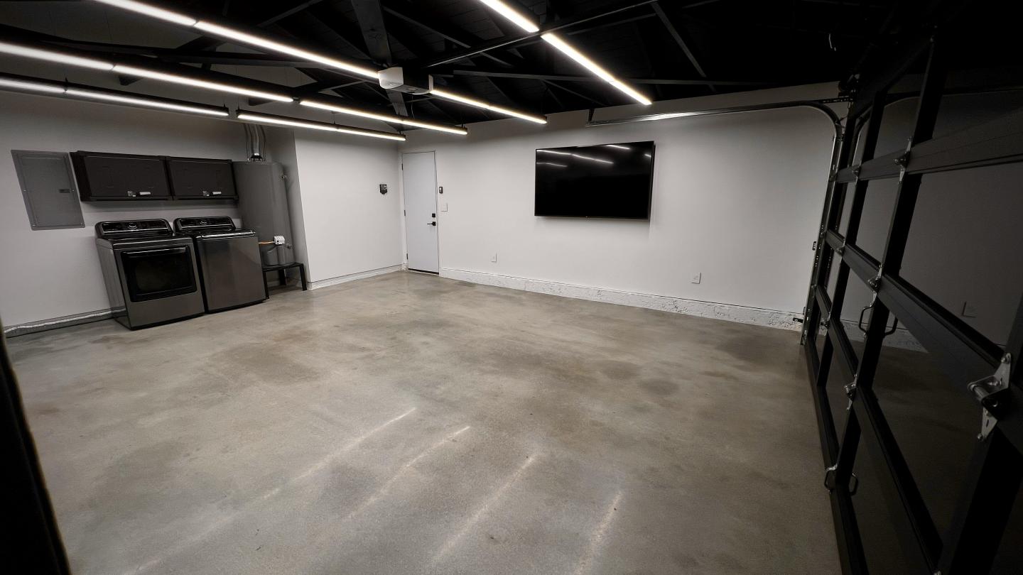

              what's the lighting setup in your garage? even pics taken from inside your car the lighting seems very generous!
              Here is a LINK to the exact lights. I have 4 rows hanging from the ceiling. Each row has 4 lights tied together for a total of 16 lights. They are set to 3000k for a little warmer look. The lighting is great and evenly distributed throughout the whole garage. Although the lighting inside the car is decent, I think my iPhone's camera exaggerates the amount of light in photos.

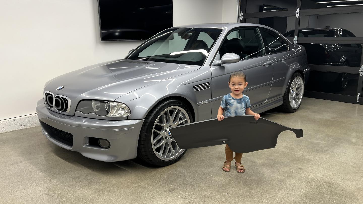

                  Christmas came early!
                  Click image for larger version  Name:	IMG_4817.jpg Views:	0 Size:	153.6 KB ID:	283850
                  Click image for larger version  Name:	IMG_4826.jpg Views:	0 Size:	197.6 KB ID:	283851
                  Click image for larger version  Name:	IMG_4822.jpg Views:	0 Size:	204.3 KB ID:	283854
                  Click image for larger version  Name:	IMG_4825.jpg Views:	0 Size:	297.3 KB ID:	283853
                  Click image for larger version  Name:	IMG_4824.jpg Views:	0 Size:	200.0 KB ID:	283852

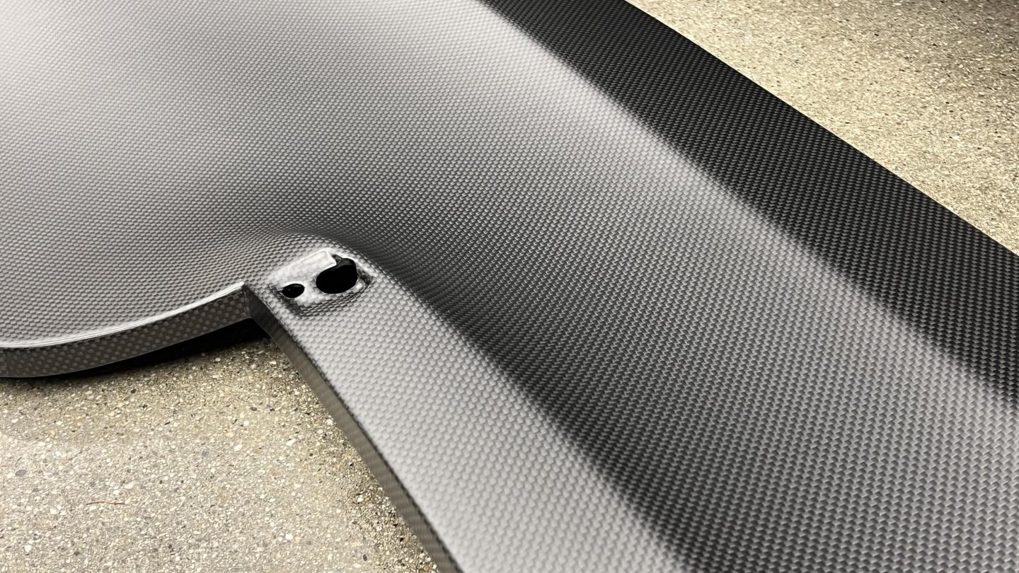

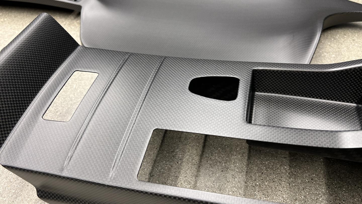

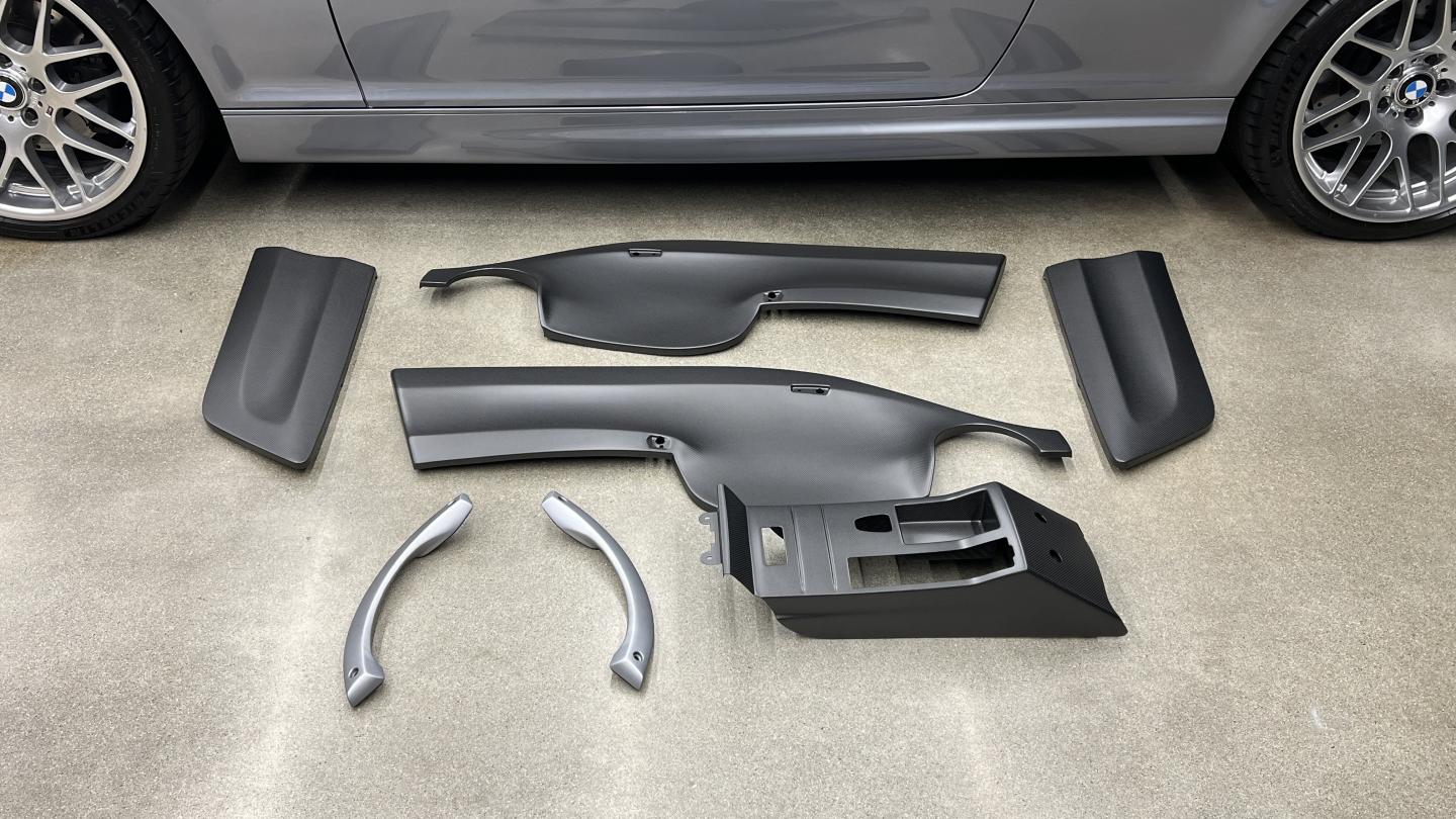

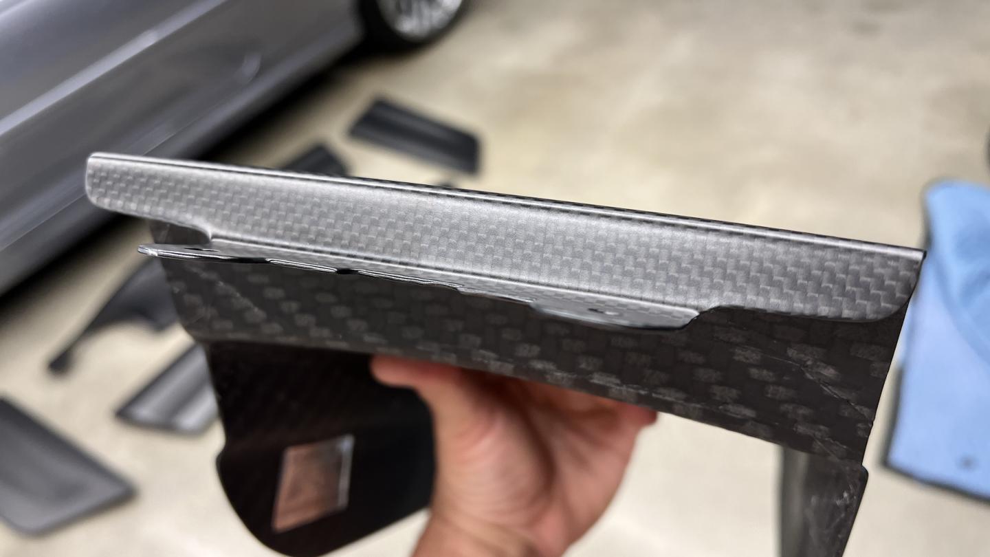

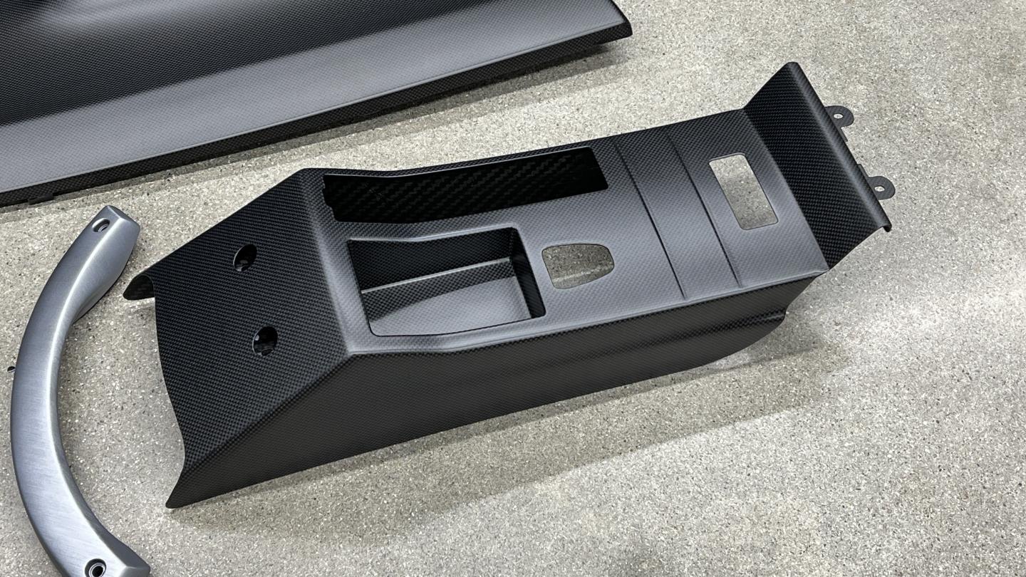

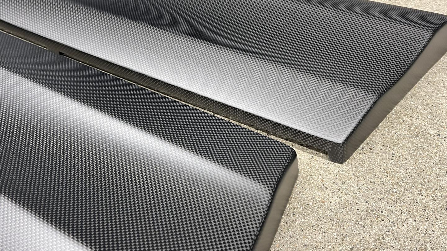

                  I always loved the CSL, and nearly every detail of it. One of the things that always seemed slightly out of place to me was the gloss carbon in the interior. I love the shape of the panels, and the concept/thinking behind them, but something about a big glossy panel inside a 2000's era interior just seemed ever so slightly off. As the title of the thread states, CSL inspired, not CSL replica. I made some changes.

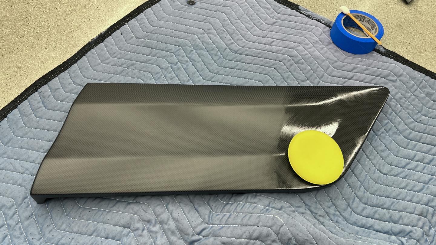

                  First deviation from the traditional CSL carbon components was matte clear coat instead of full gloss. Prior to ordering, I had the idea of using a traditional gloss ceramic coating on top of the matte finish. From all the research I had done, this would give the panels a deeper satin-like finish, without any gloss/reflectivity.
                  I tested a small spot on the front of the center console to confirm my research. It can be hard to tell on camera, but the coated portion has a much deeper finish and the black is definitely more saturated.Turned out just as I had hoped.
                  50/50 coated and uncoated (left is coated)
                  Click image for larger version  Name:	IMG_4833.jpg Views:	0 Size:	83.1 KB ID:	283855
                  With that test successful, I moved onto a larger panel. Here you can really see the difference. He is a before, during, and after.
                  Click image for larger version  Name:	IMG_4834.jpg Views:	0 Size:	236.0 KB ID:	283848
                  Click image for larger version  Name:	IMG_4836.jpg Views:	0 Size:	227.3 KB ID:	283847
                  Click image for larger version  Name:	IMG_4837.jpg Views:	0 Size:	237.4 KB ID:	283849

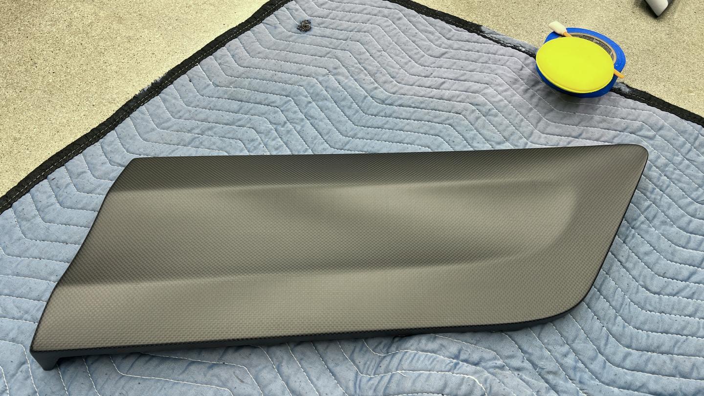

                  I then moved on and ceramic coated each panel. I am very confident when it comes to detailing, but this project made me nervous. If the application, and more importantly the removal of the coating wasn't done perfectly, it would be glaring. Not only would it look blotchy, but it would be semi-permanent. Due to this, I used an initial 3 stage buff off to ensure that there were no high spots and that the application/removal was even. After the 3 stage wipe off, I took the panel into the direct sunlight to check for errors. The final check was to take the panel into the garage, turn off all the lights and check each panel with a small flashlight. This was the only way I could confirm and reconfirm that I did a proper job coating the panels. They turned out perfect. Maybe the only satin finish 1x1 CSL door panels in the world? Who knows, who cares, all I care about is that it looks amazing!
                  Click image for larger version  Name:	IMG_4838.jpg Views:	0 Size:	311.9 KB ID:	283857
                  Click image for larger version  Name:	IMG_4839.jpg Views:	0 Size:	342.4 KB ID:	283856
                  Click image for larger version  Name:	IMG_4842.jpg Views:	0 Size:	271.7 KB ID:	283861

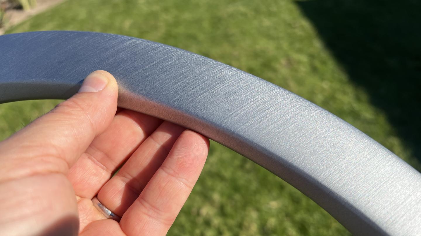

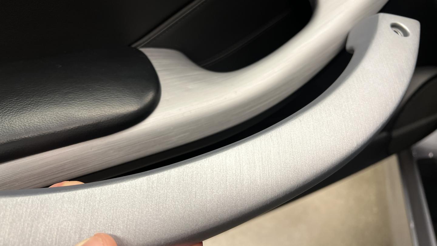

                  The second deviation from the traditional CSL interior components was the door handles. Normally they are painted titan shadow to match the rest of the CSL dash trim. It’s funny how plans change. When I first purchased the car, I had planned on changing all the dash trim out to titan shadow or 1x1 carbon. I have since grown to love the brushed aluminum finish that came with the car. The brushed aluminum finish also matches the factory grey instrument cluster gauges and the aluminum pedals I added. I asked David if he could attempt to match the color of the factory aluminum trim when painting the door handles. David was incredibly generous to accommodate my request and said he would do some testing. They were not able to capture any photos of the process or the outcome, so I had absolutely no idea what I would be receiving. Turned out even better than I imagined.
                  Click image for larger version  Name:	IMG_4819.jpg Views:	0 Size:	117.6 KB ID:	283859
                  Some photos of the door handles next to the factory aluminum trim.​ It is not a perfect color match, but it looks far better than titan shadow. The brushed effect looks great and I am very happy with the results.
                  Click image for larger version  Name:	IMG_4820.jpg Views:	0 Size:	112.6 KB ID:	283860
                  Click image for larger version  Name:	IMG_4821.jpg Views:	0 Size:	96.7 KB ID:	283858

                    That looks awesome! Great job and loving the personalised twist you're putting on the classic CSL interior! Also love the photos of your son, I had my 5 year old under the car with me earlier in the year and it's special memories to form.
                    Loving following this build!
                      #55
                      Never considered matte carbon for the CSL interior parts. That's a 10/10 decision.
                      2003.5 SG/Grey
                        #56
                        ^ this
                          #57
                          The Matte looks amazing. Even better with the Ceramic coat, that was a great idea. Excellent picks all around.

                            Great updates! Matte looks amazing.
                                Have you driven the car yet and observed any change in cabin noise?
