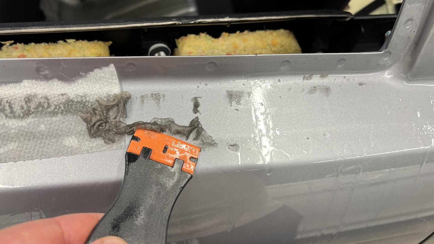

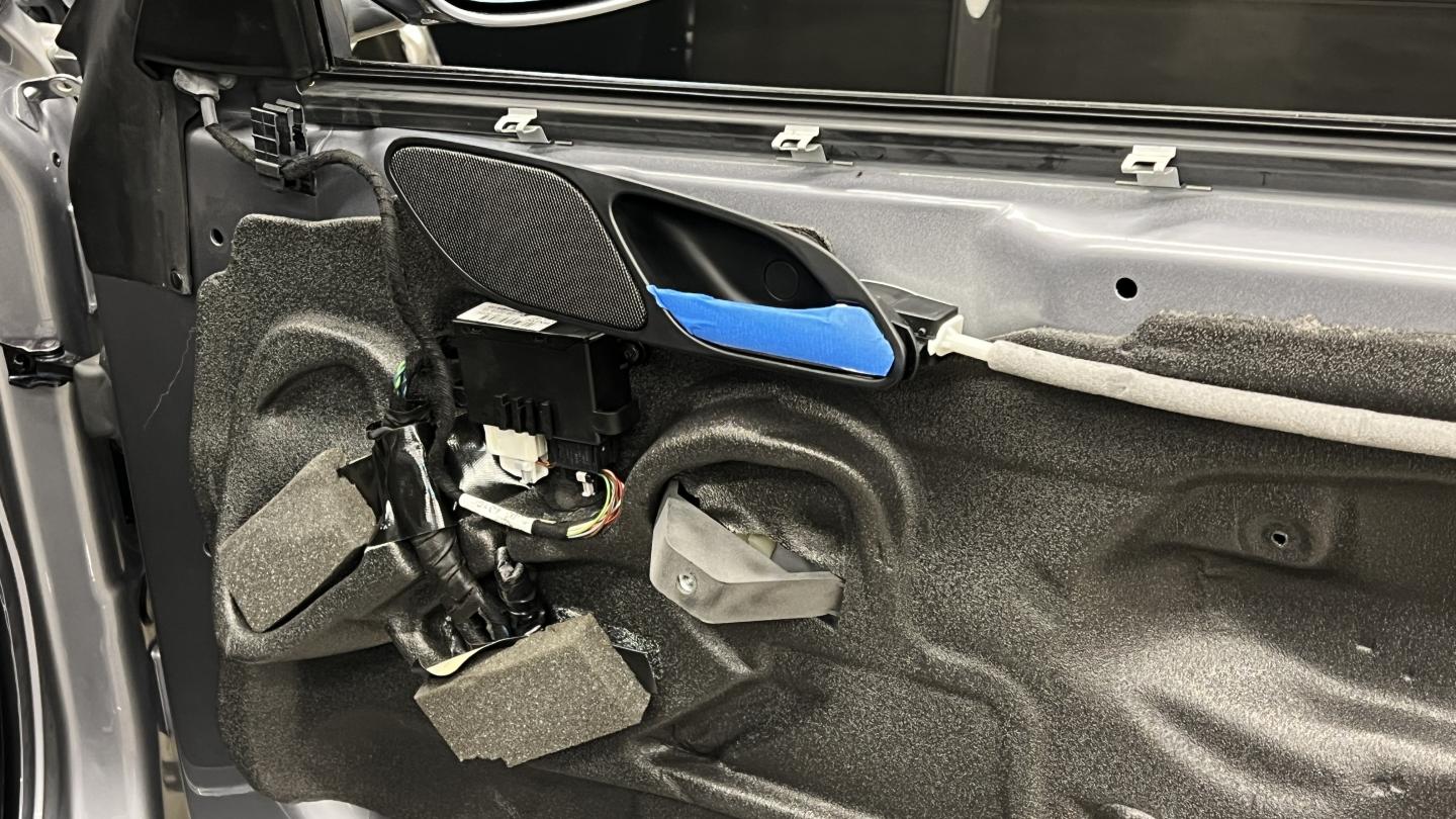

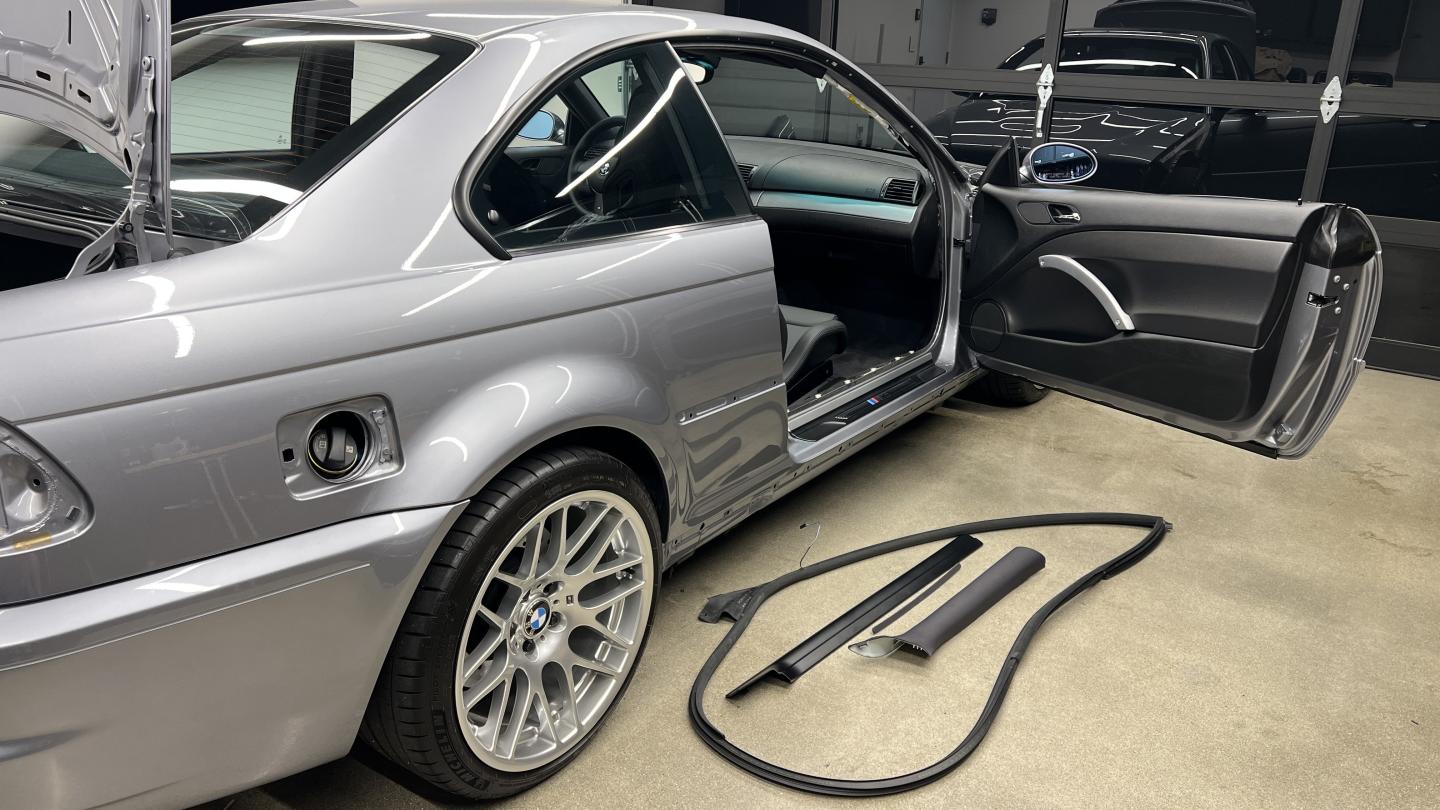

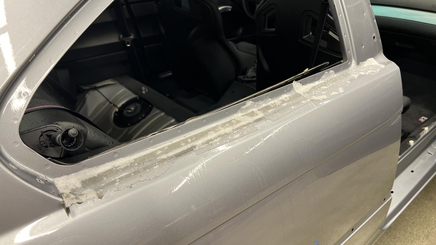

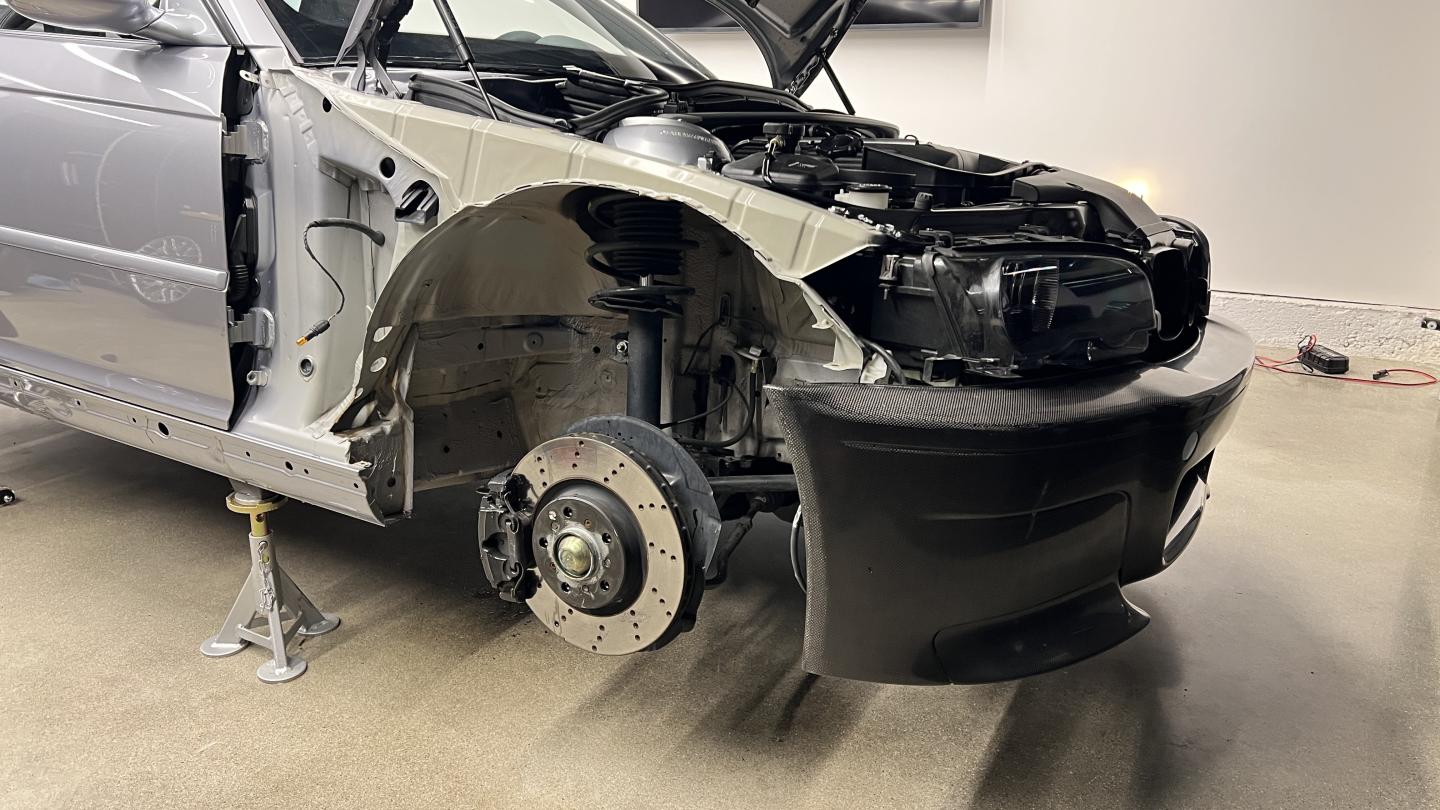

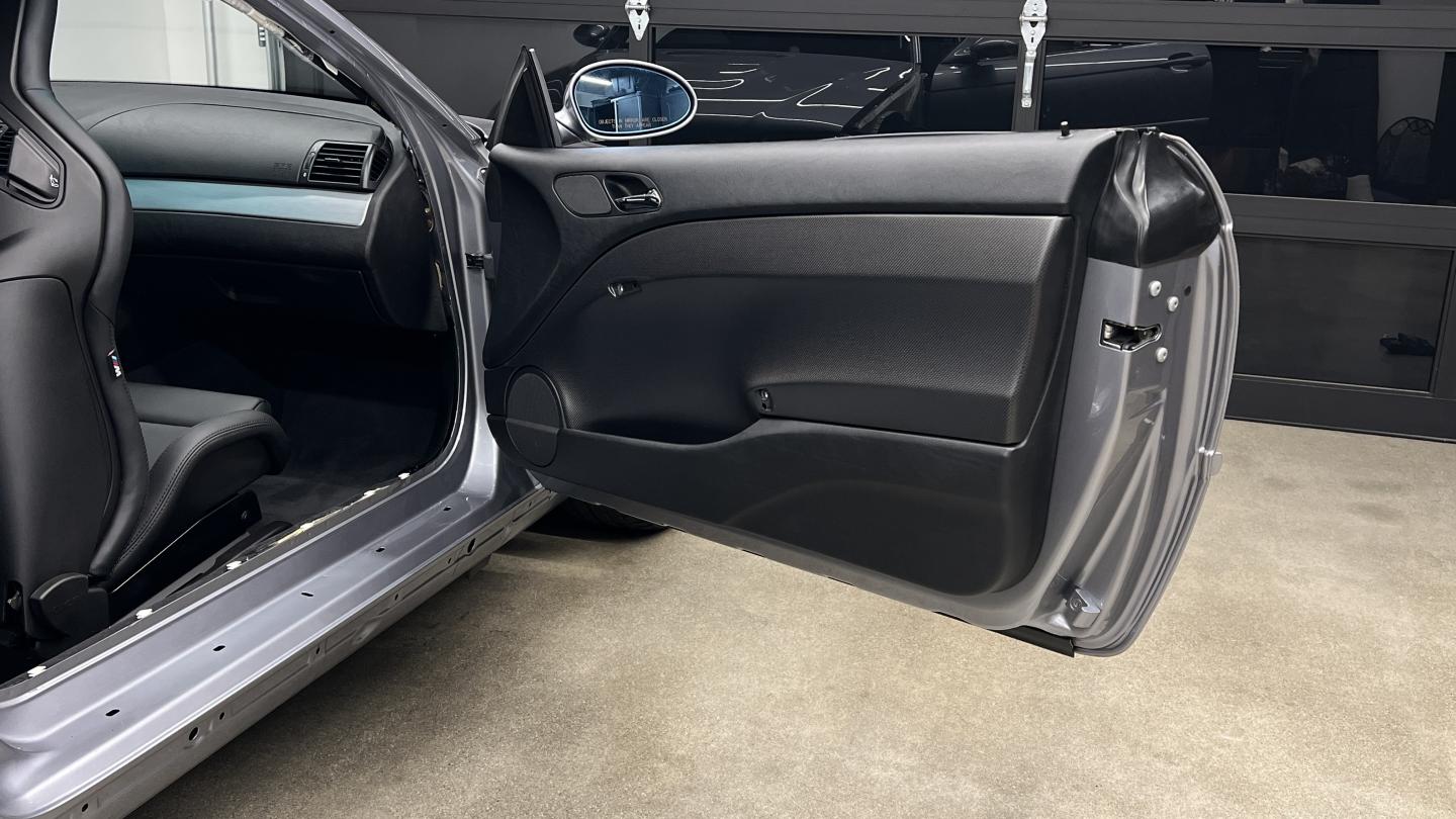

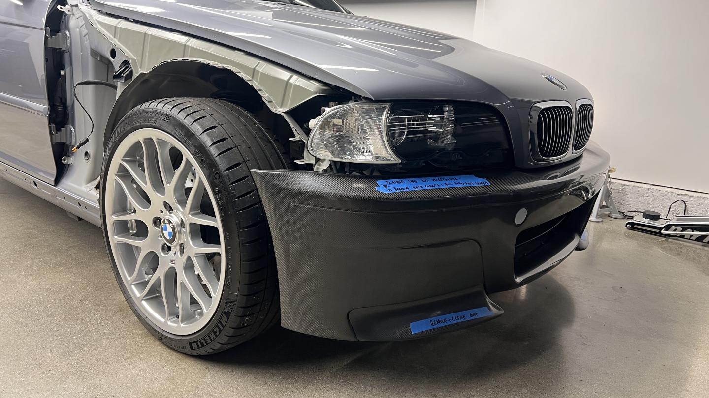

    You are probably wondering why I’m disassembling the entire passenger side of the car for a CSL front bumper, trunk lid and diffuser. When I first bought the car, the seller was transparent about the passenger side quarter possibly being painted by a previous owner. From what I could tell in photos and videos sent by the seller, the paint work was done incredibly well, and I was okay with it. Texture, color match, etc were all done with great attention to detail.

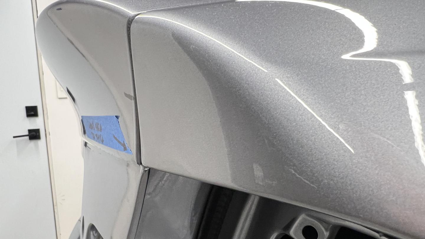

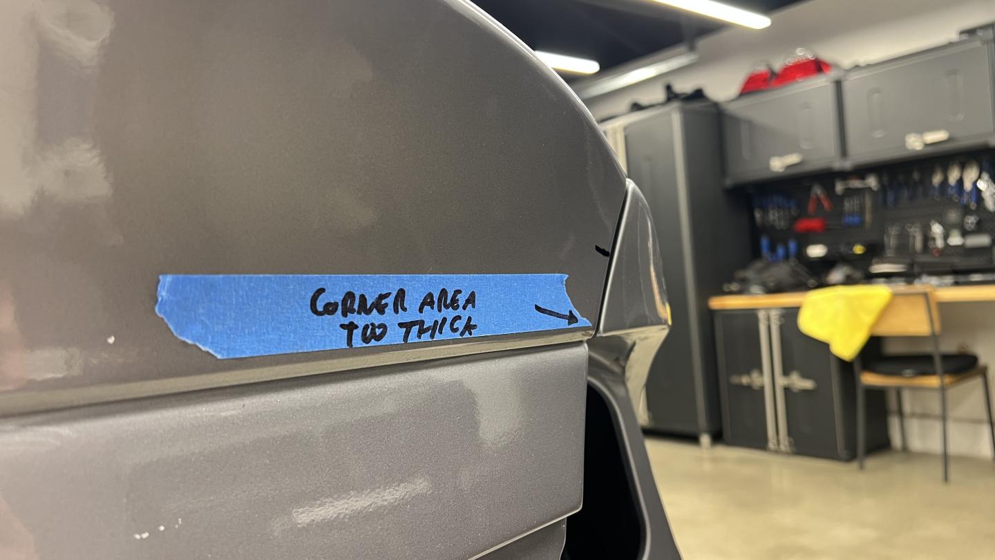

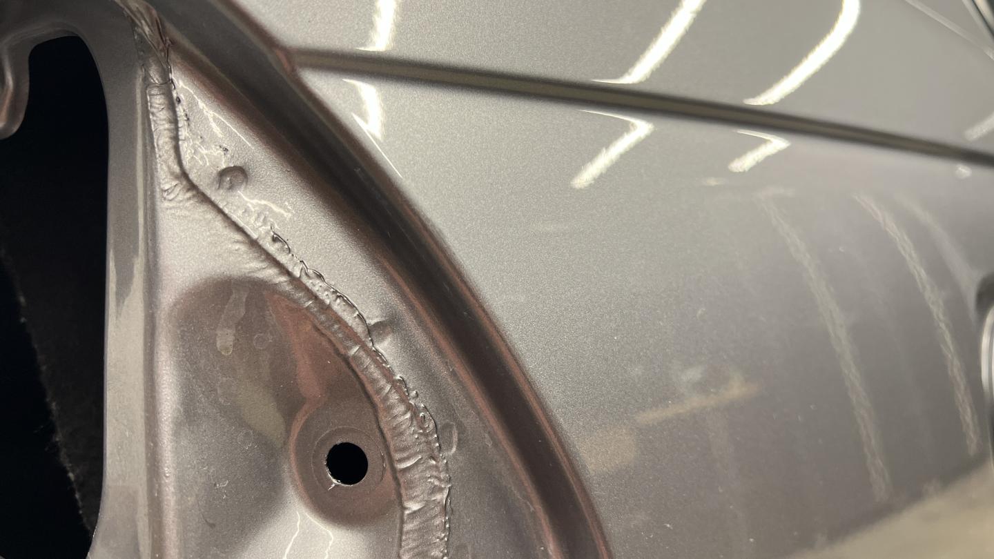

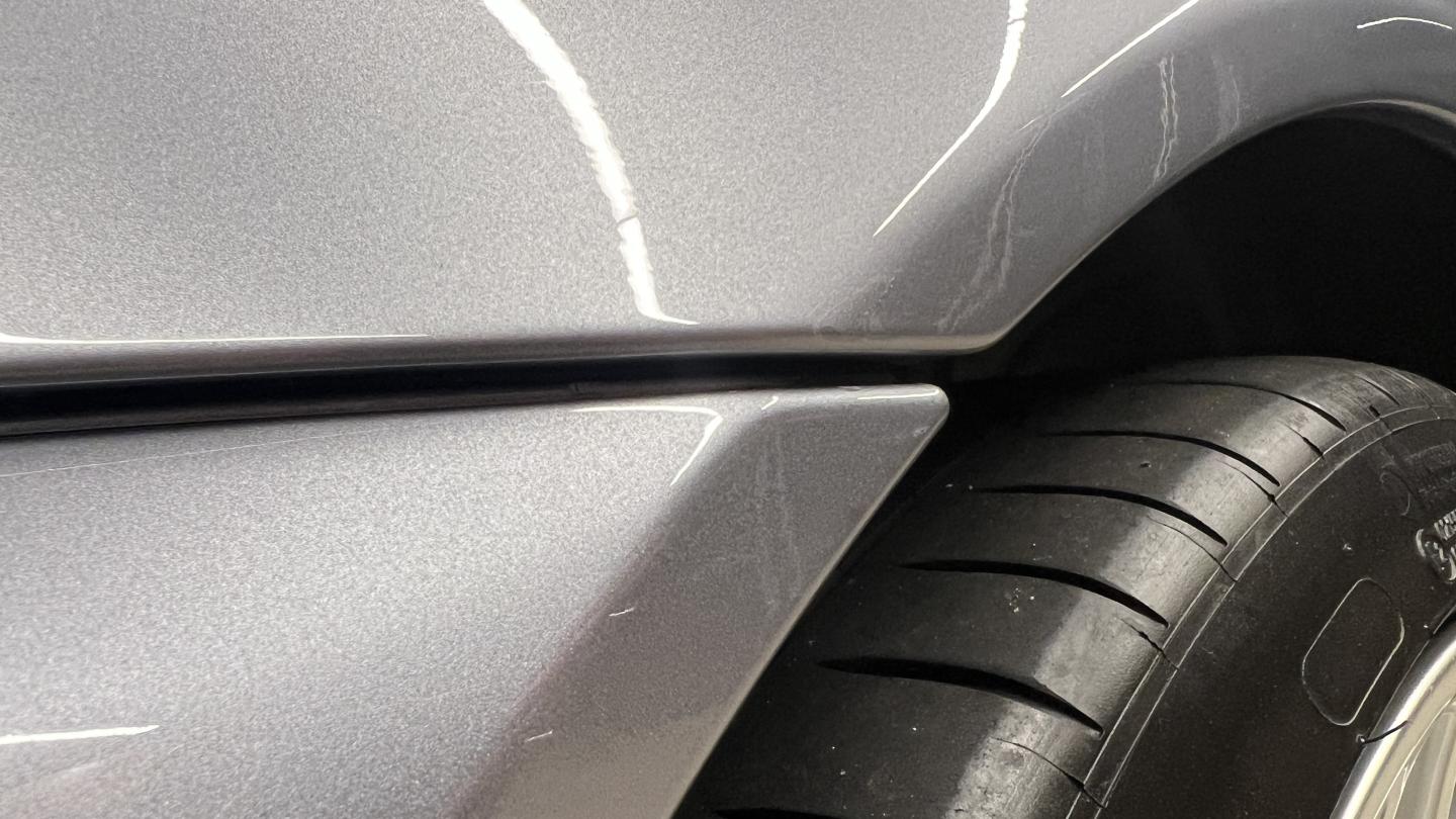

    When I received the car, the paint was as advertised. Zero masking lines, orange peel was super accurate and the color match was about 90-95% accurate. Whoever did the paint did an outstanding job. That said, I found a tiny burn through in the clear coat where the rear arch meets the rear bumper and another one on the edge where the quarter panel meets the taillight.
    Based on what I know about detailing and finish work, it appeared the body shop mowed down the entire panel with the massive rotary machine and wool pad. While rotaries make quick work of defects, especially in large areas, they can be incredibly risky on edges and adjoining panels. While 99% of people would never notice the burn through it bothered me and I wanted it fixed. It was also a good opportunity to go from 90-95% color match to near 100%.
    Click image for larger version  Name:	IMG_2824.jpg Views:	0 Size:	164.1 KB ID:	306349
    Click image for larger version  Name:	IMG_2825.jpg Views:	0 Size:	120.3 KB ID:	306350
    After discussion with Dave, we decided to paint essentially the whole rear: trunk lid, rear bumper, rear diffuser, passenger’s side rear quarter including door jamb and a-pillar, and side skirt. This was the only way we could ensure perfect color match with the new components, while simultaneously repairing the rear quarter panel. In order to do this right, the front fender, front door, side glass and trim would need to be removed.

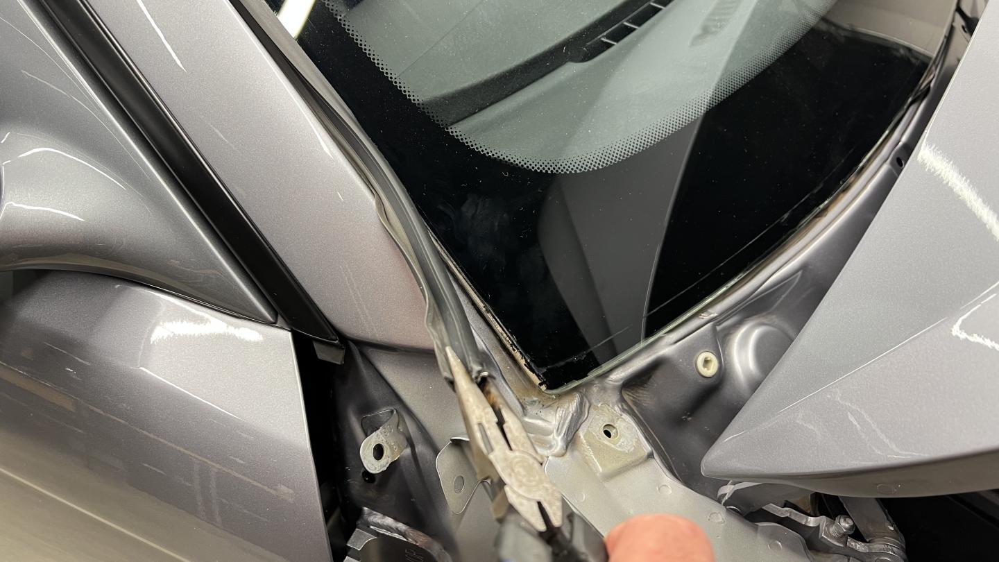

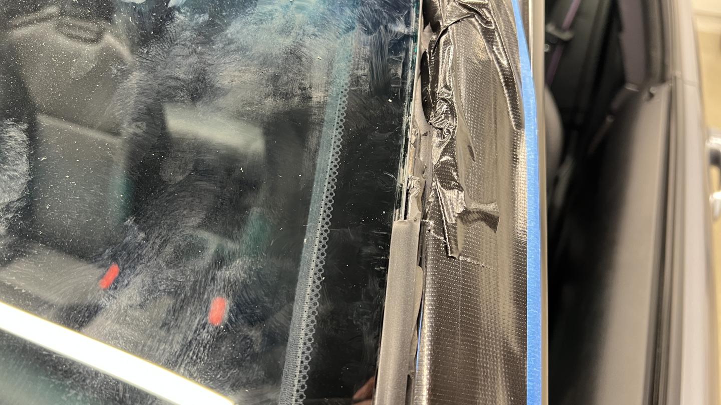

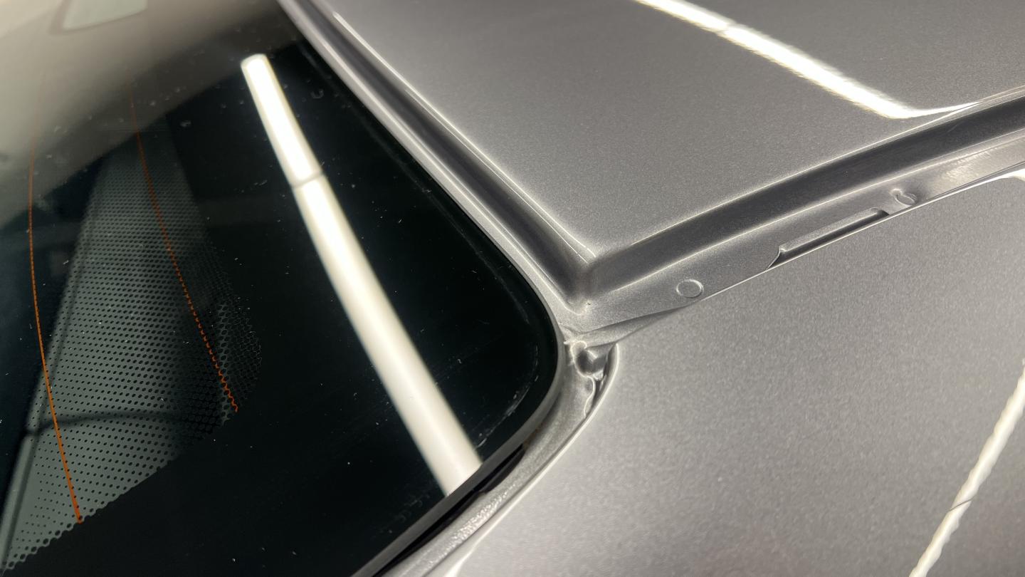

    I then moved on and pulled the windshield seals. The rear came off really easily and gave me false confidence for the front. The front was extremely difficult to get off. Parts of it came off without issue, but many parts of it required numerous tries and f-bombs to get it out. It came out in 10+ pieces, and I had to take multiple breaks in-between, but the job got done.
    Click image for larger version  Name:	IMG_2856.jpg Views:	0 Size:	145.4 KB ID:	306352
    Click image for larger version  Name:	IMG_2858.jpg Views:	0 Size:	117.0 KB ID:	306353
    Click image for larger version  Name:	IMG_2862.jpg Views:	0 Size:	195.8 KB ID:	306354
    Afterward, I cleaned the channels really well and flushed them with hot water.

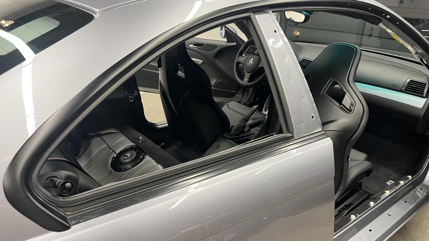

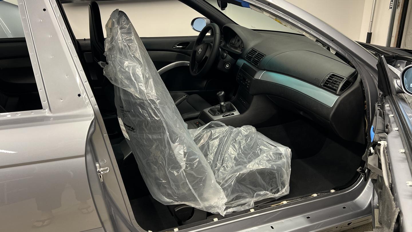

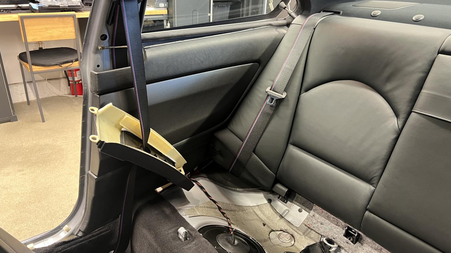

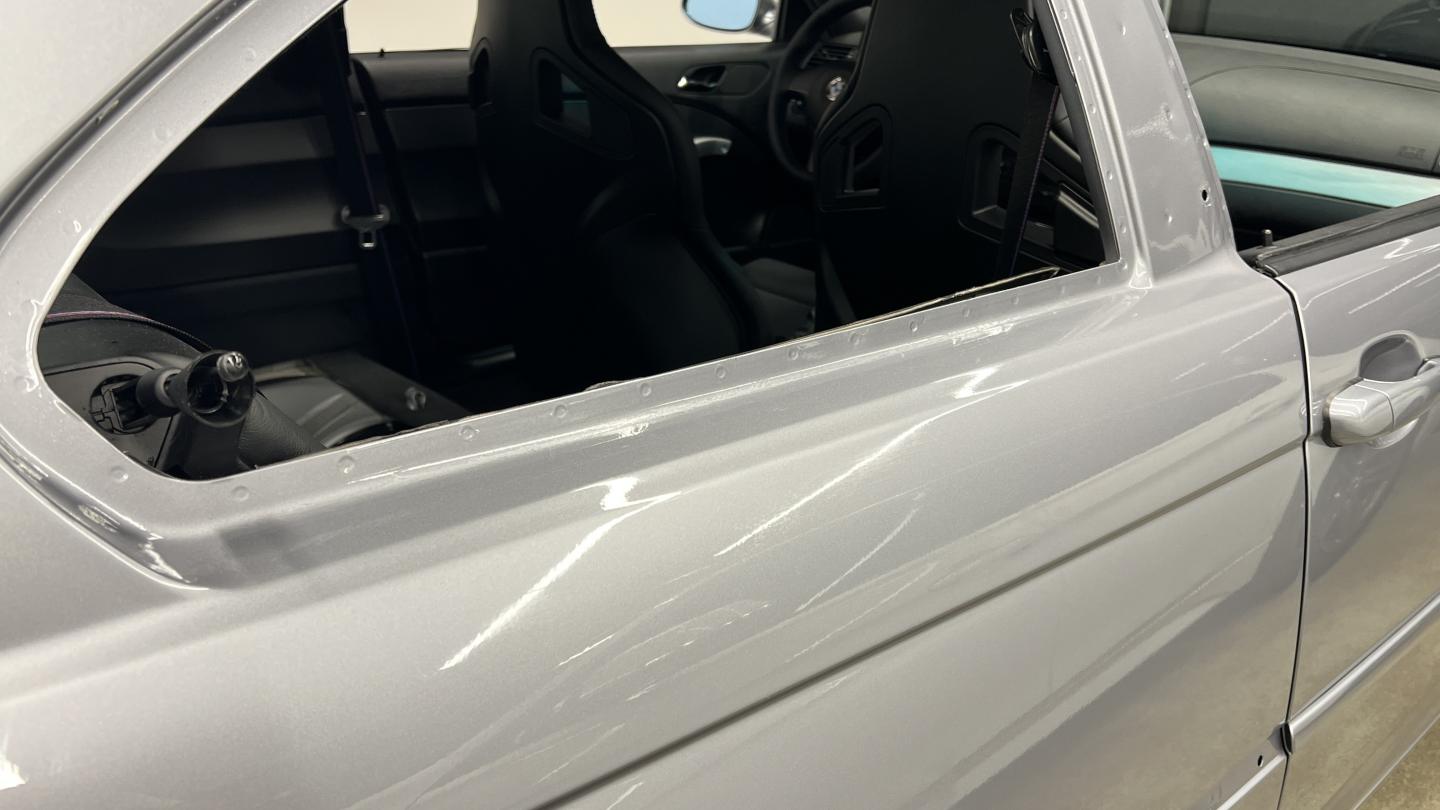

    Up next was the rear quarter window and shadowline window trim. This required some interior panels to be removed, but overall the job was pretty easy.
    Click image for larger version  Name:	IMG_2865.jpg Views:	0 Size:	167.1 KB ID:	306358
    Click image for larger version  Name:	IMG_2867.jpg Views:	0 Size:	142.4 KB ID:	306357
    Once the window was out, I could remove the rubber window seal, then the shadowline trim.

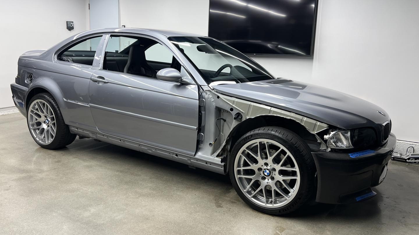

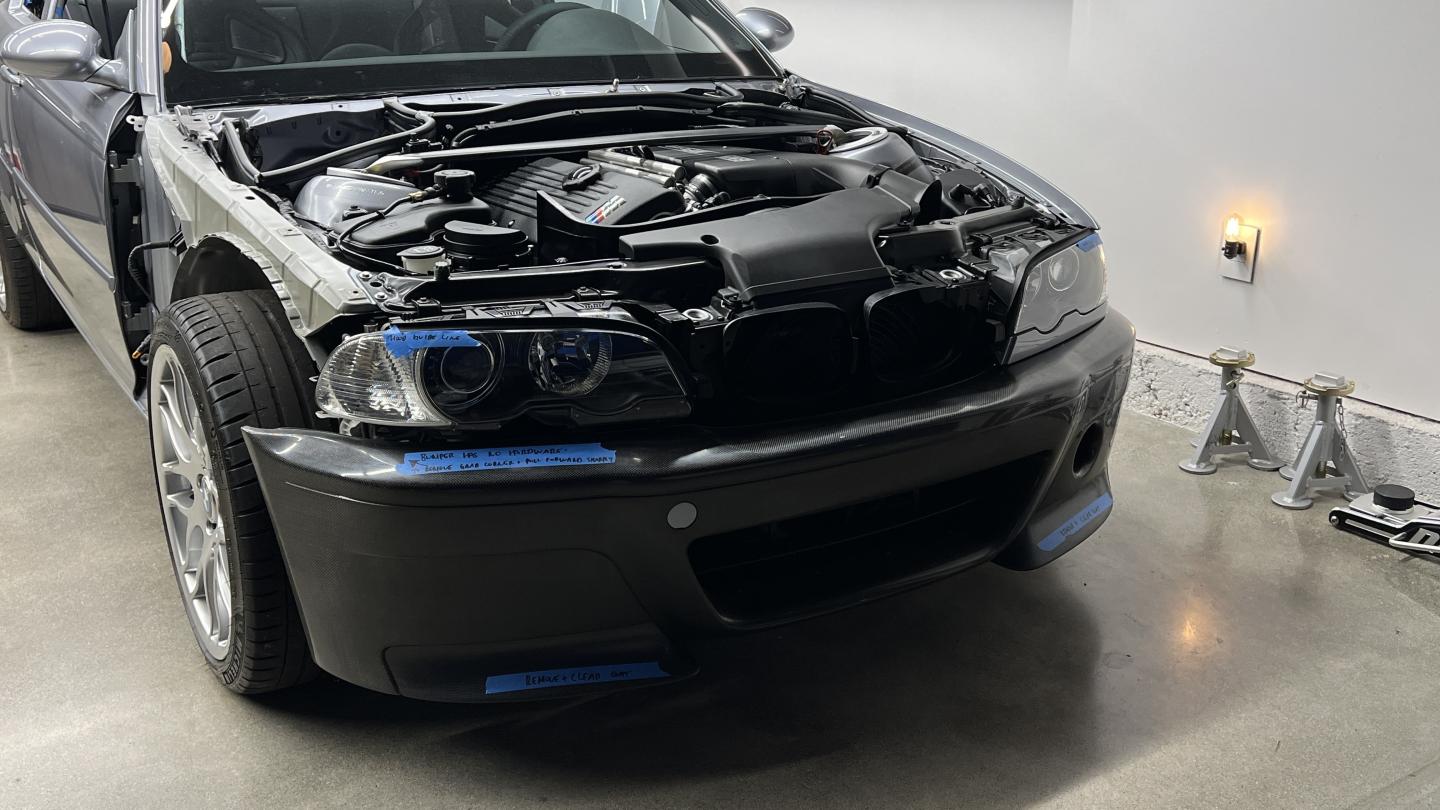

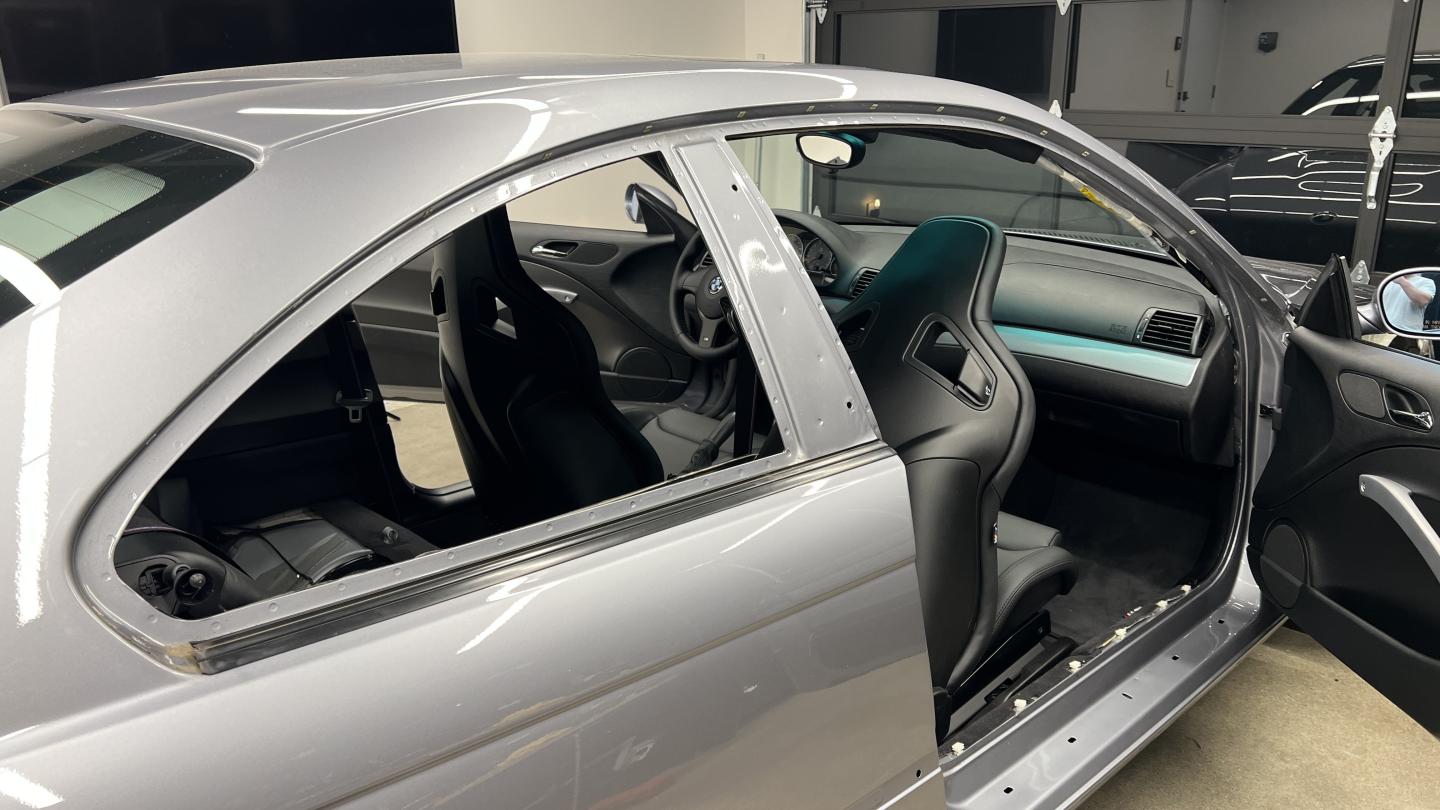

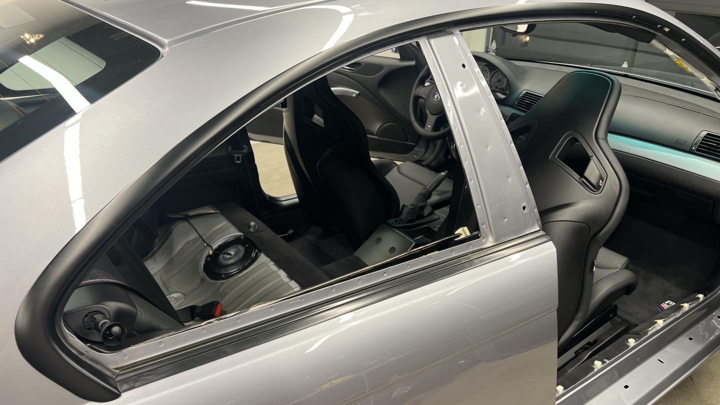

    Here is the car almost fully stripped and ready for paint. I left a lot of little notes around the car for the painters. For example, how I wanted the CSL diffuser painted, how to remove the bumpers, and little areas that I felt needed extra attention.
    Click image for larger version  Name:	IMG_2992.jpg Views:	0 Size:	144.5 KB ID:	306364
    Click image for larger version  Name:	IMG_3091.jpg Views:	0 Size:	143.1 KB ID:	306365
    Click image for larger version  Name:	IMG_3093.jpg Views:	0 Size:	176.4 KB ID:	306366
    Click image for larger version  Name:	IMG_2994.jpg Views:	0 Size:	102.4 KB ID:	306368
    Click image for larger version  Name:	IMG_2995.jpg Views:	0 Size:	109.7 KB ID:	306367

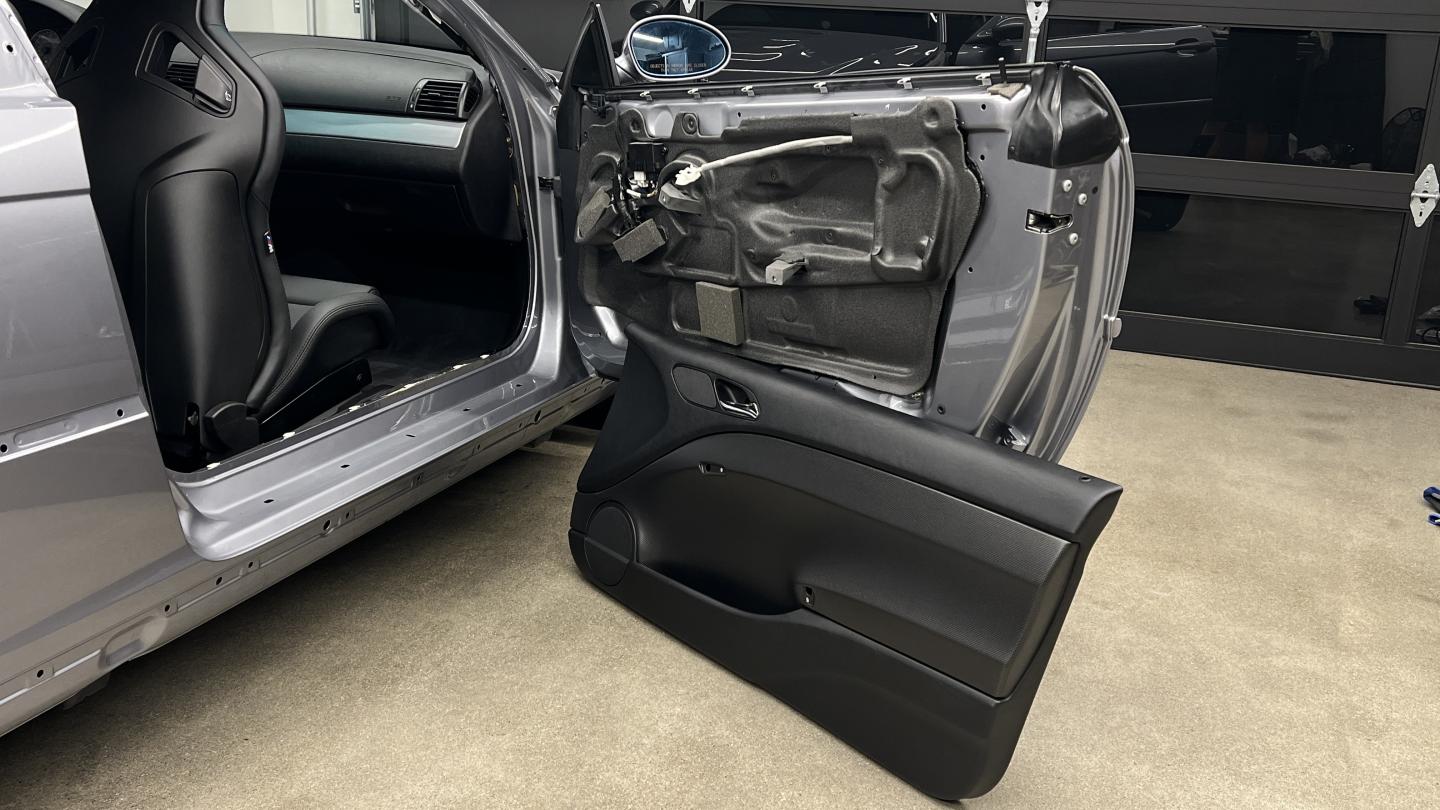

                Continuing where I left off, prepping for paintwork. Lots of little loose ends, last minute removals, and notes added. My goal is to do as much as possible prior to drop off. Even though I genuinely believe Dave is one of the best painters in California, I have an inherent distrust in body shops. I’d rather remove the extra exterior trim piece or interior panel than risk accidental damage while the car is out of my hands.
                The passenger door will be getting removed by Dave just prior to paint. I disconnected the wiring harness, removed the CSL door panel, and reinstalled the interior door pull onto the bare door. Again, the goal is to make it as easy and safe as possible for Dave and his team.

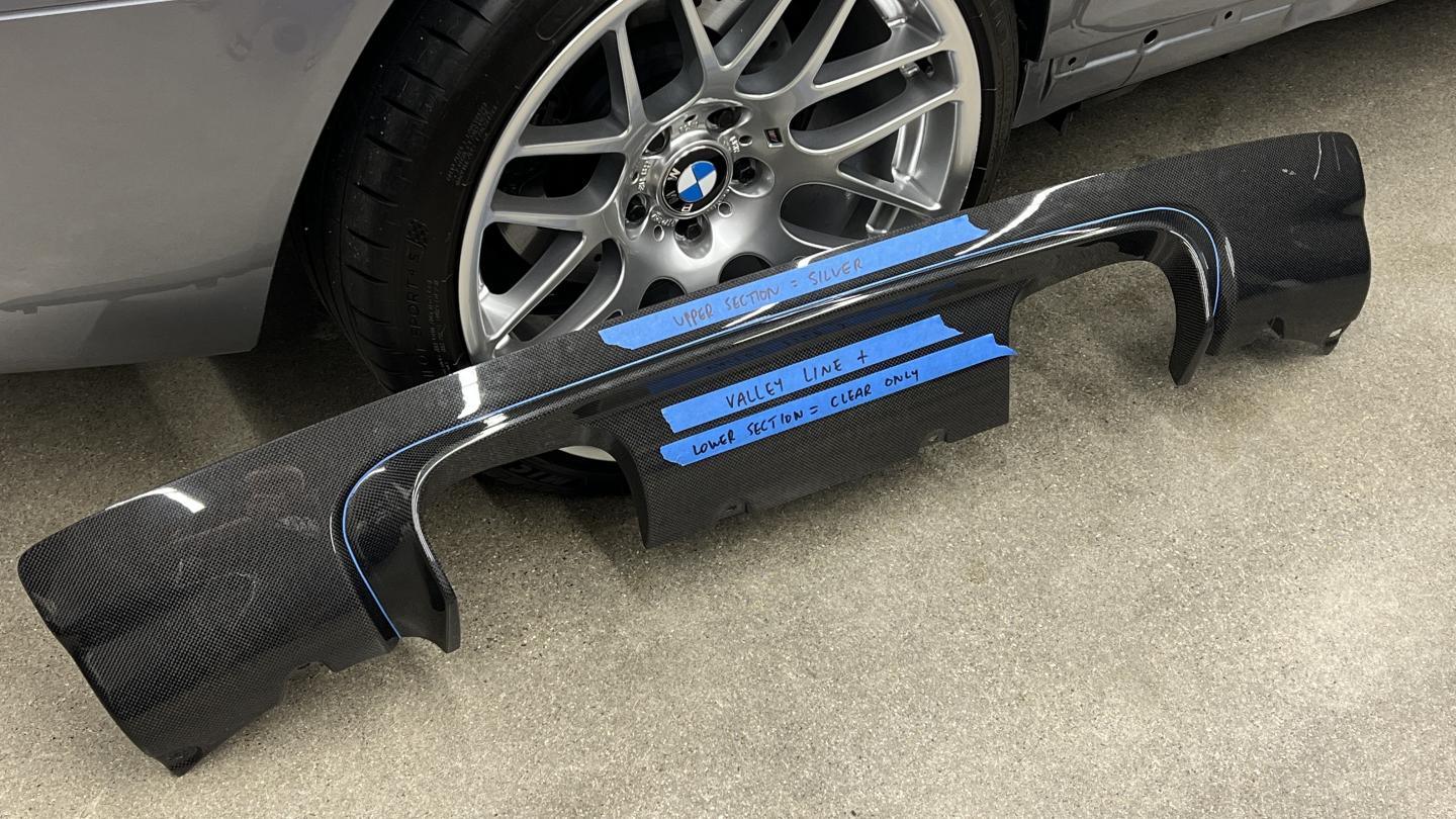

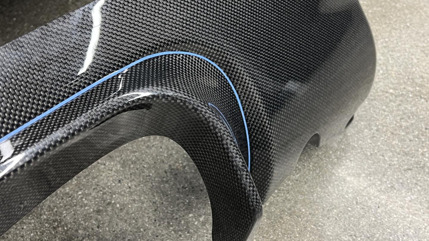

                Next, I prepared the CSL diffuser for paint. Most of you know this already, but the factory CSL diffuser has a valley line that separates the painted portion and unpainted portion of the diffuser. If you look really closely, you’ll see that the valley line is actually painted. I know it’s a small detail, but I absolutely hate how this was done from the factory. It looks like someone just did a really poor job masking, especially in the top portion. Below is an image I stole which shows what I’m rambling on about.
                Click image for larger version  Name:	IMG_2671.png Views:	0 Size:	963.0 KB ID:	308363
                Again, my build is CSL inspired, not a CSL replica. I’m going to make a tiny (but in my eyes substantial) change by purposely not painting the valley line. Essentially I’m doing the opposite mask as the factory. I special ordered some super thin masking tape just so that I could show Dave how I wanted it masked without there being any assumptions or misinterpretation. I have issues, I know.

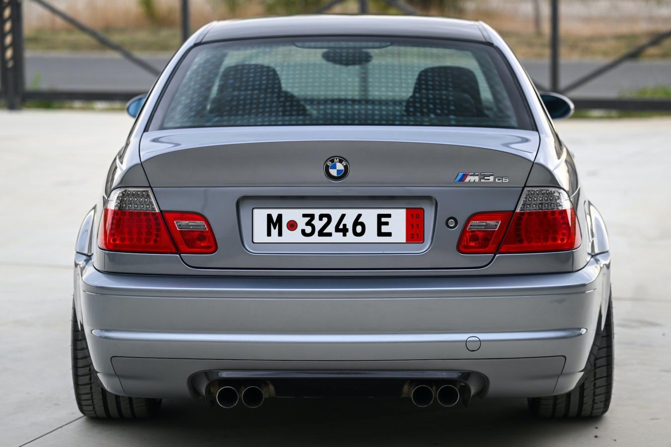

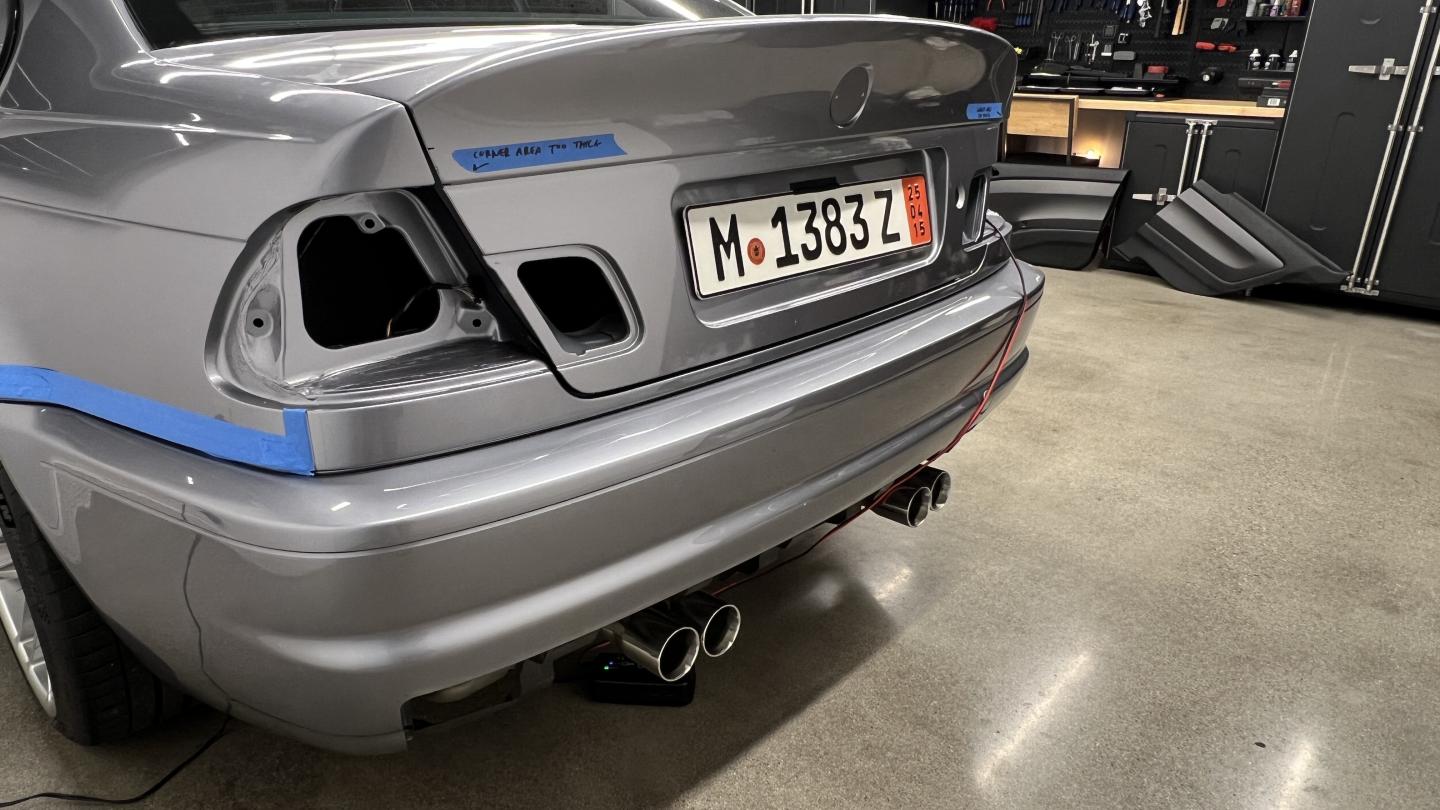

                In the back of my head, I always had the idea of putting a German plate on the car, but I had no hard plans. In 2015, my wife did a European Delivery of her F30 335i. The car came with the German Zoll plates with Munich marking (first letter M), and tourist registration stamp. I thought it would be a fun idea to play off of this. I put one of her plates on the car then did a few digital mockups. I always tell my son that the M3 is going to be his car one day, so I settled on the plate M 3246 E. The letters being his initials, the 3246 for the displacement of the S54. The registration date is 10.11.21 which is his birthday.
                Click image for larger version  Name:	IMG_3272.jpg Views:	0 Size:	154.2 KB ID:	308367
                While I was at it, I mocked up the a digital version of the plate, and the placement of the ///M3 badge on the trunk. This is what I settled on.
                Click image for larger version  Name:	M3_BADGE_PLACEMENT_MOCKUP_GUIDES.jpg Views:	0 Size:	112.8 KB ID:	308370
                Click image for larger version  Name:	IMG_3458.jpg Views:	0 Size:	110.7 KB ID:	308369
                I also toyed with the idea of doing an ///M3cs badge. Thoughts?

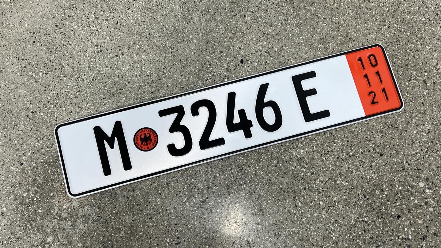

                After the renders, I ordered the real version
                Click image for larger version  Name:	IMG_3539.jpg Views:	195 Size:	332.3 KB ID:	308748

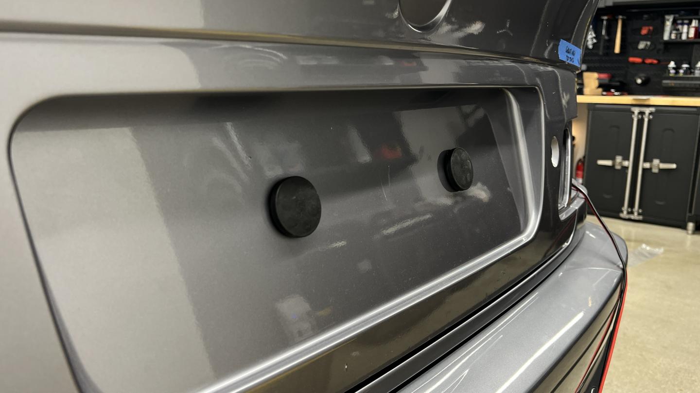

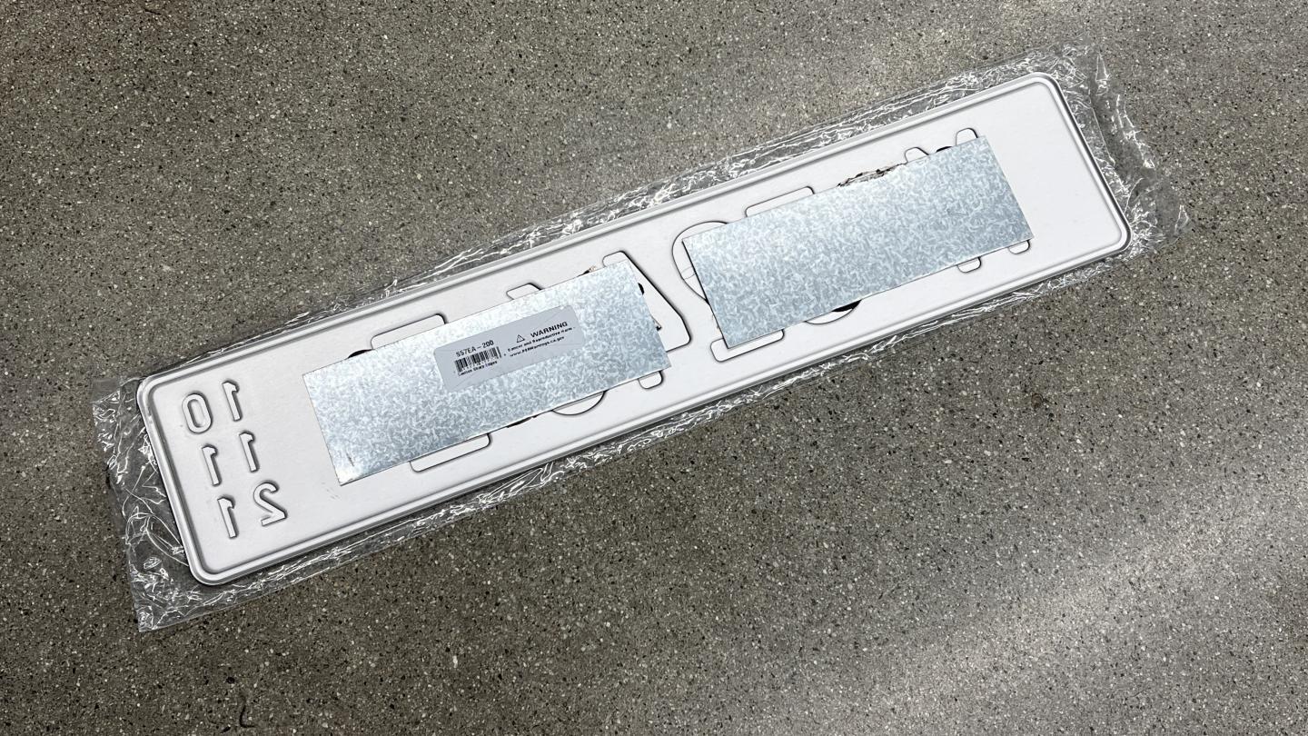

                I wanted a quick and easy way to change plates between the California and German versions. I found a set of rubberized magnets with a M5 sized stud built in. They fit perfectly in the license plate mounts that get pushed into the CSL trunk.
                Click image for larger version  Name:	IMG_3503.jpg Views:	0 Size:	138.3 KB ID:	308373
                Cool idea except the plates are aluminum and don’t work with the magnets. I initially purchased some magnets to glue onto the plate itself. It didn’t work out, as the connection was weak, and the magnets were too thick. I settled on the thinnest piece of galvanized steel I could find. It was significantly stronger and more low profile. I epoxied them to the plate so that I could simply snap the plate on and off. I might end up just bailing on the whole idea and just using double sided tape so that it's even more low profile. Either way, it was a fun mini project.
                Click image for larger version  Name:	IMG_3504.jpg Views:	0 Size:	319.1 KB ID:	308374 Click image for larger version  Name:	IMG_3506.jpg Views:	0 Size:	98.2 KB ID:	308371
                Click image for larger version  Name:	IMG_3507.jpg Views:	0 Size:	151.9 KB ID:	308372

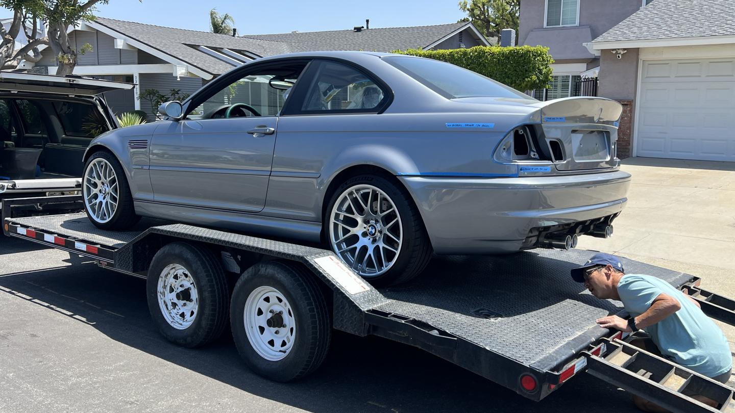

                    I finalized my drop off date and time and got to all the little last minute details to prep the car for paint. I then removed the hood and found some heavy duty plastic seat covers to protect the Recaros while in the shop.
                    I’m really fortunate to have a neighbor who is a Nissan master-tech, GT-R owner, and 240sx track car driver. He is infinitely knowledgeable and experienced with cars and was generous enough to help me load up my M3 on his trailer.

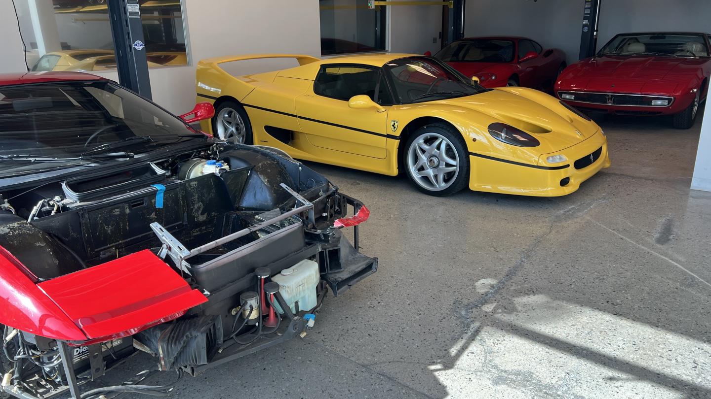

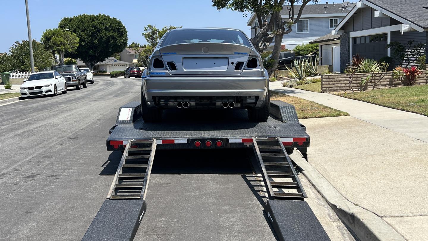

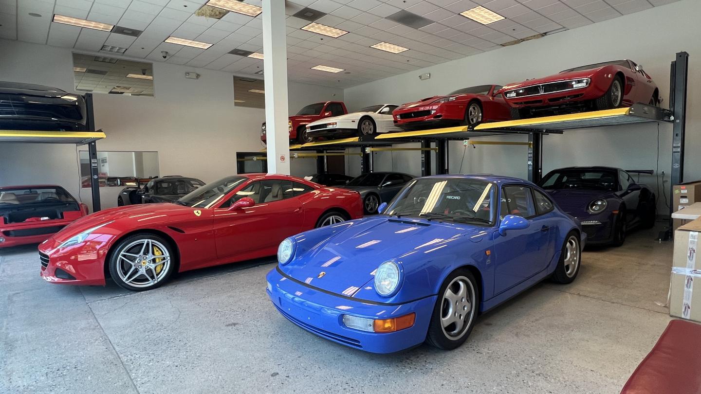

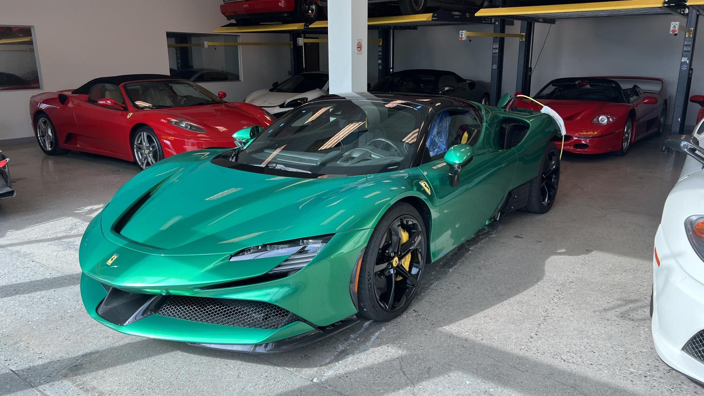

                    We arrived at Premier Motorsports and were greeted with a new group of ridiculous cars, including this fully exposed carbon McLaren Senna
                    Dave came out and went over every little detail of the job (for the third time). I really appreciated his willingness to listen to my wants, point of view, and concerns. He has a lot of big projects going on, so it’s going to be a while before I get the car back. I will continue to order parts and prep for the return of the car. I will keep you all updated along the way.

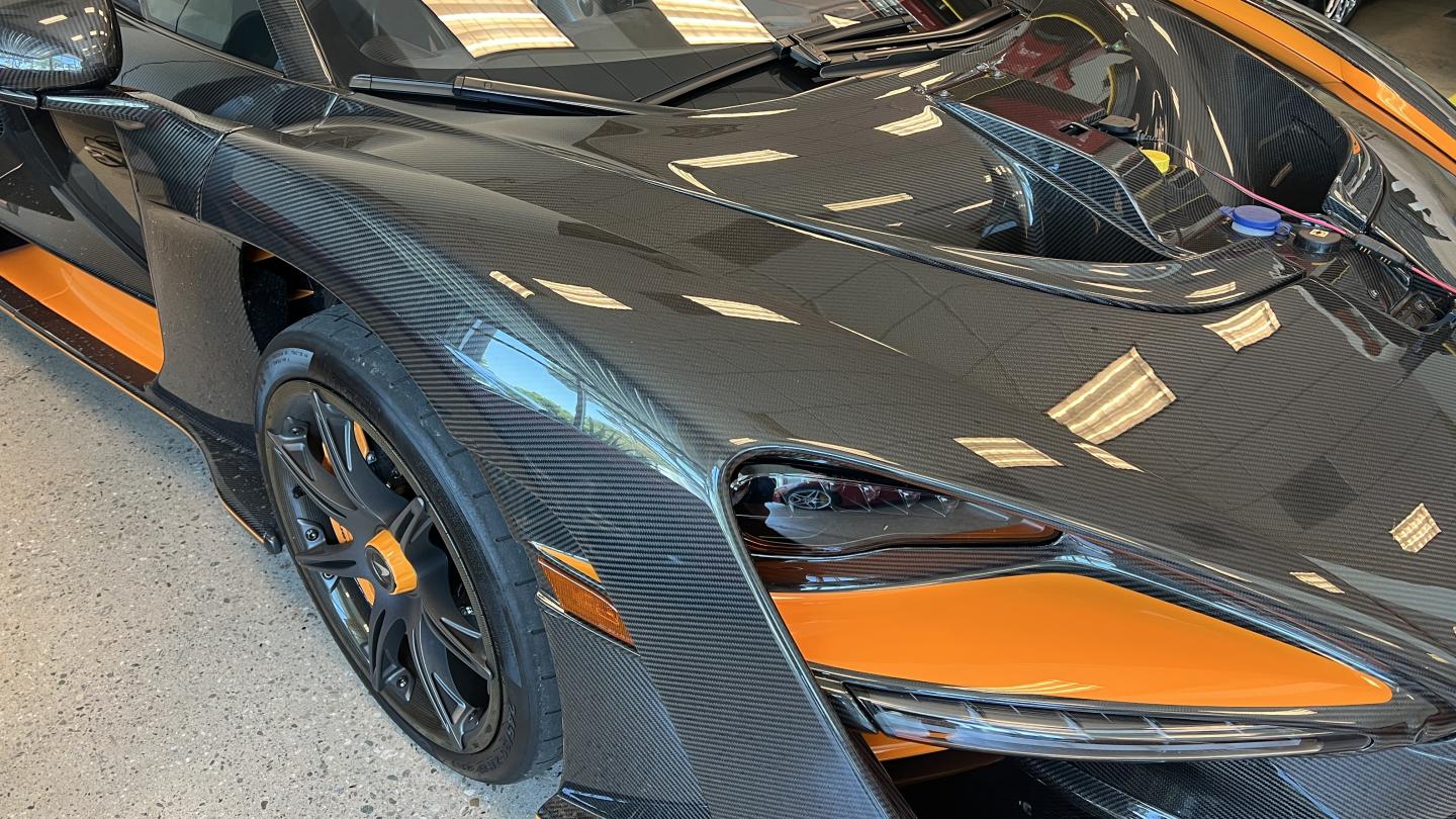

                      The lineup of cars in there is wild. Did he say what kind of work the Senna was getting? I wouldn't even want to touch the original panels and paint, but stuff happens to even supercars I guess!

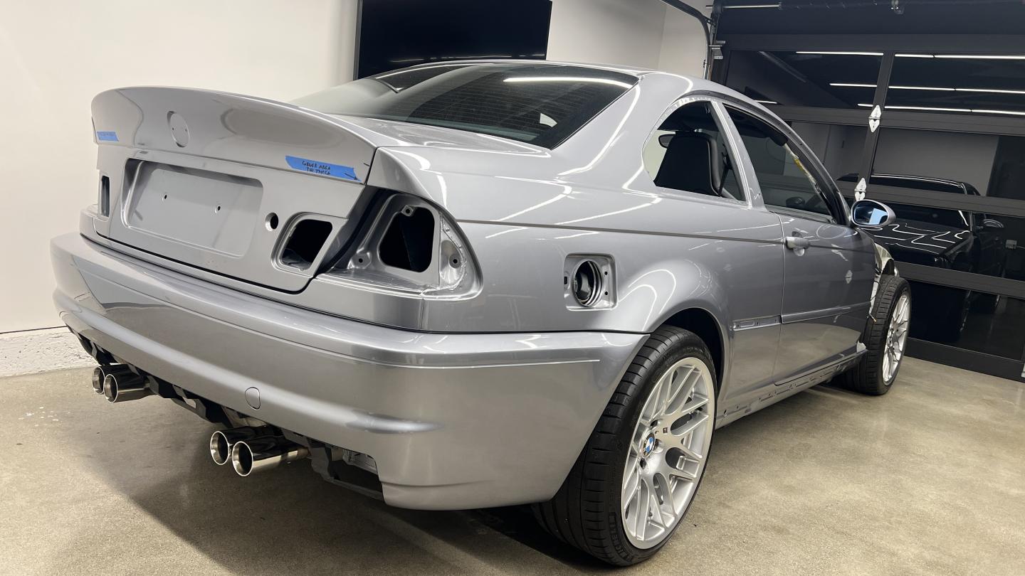

                          Went to Premier Motorsports today to check on the progress. As expected (and disclosed to me) there was not much movement on the project. They had some really big projects that they needed to wrap up for Monterey car week before they could get to my M3.
                          Again, when I arrived the lobby was full of different supercars. I went to the body shop area and was happy to see my car was in the queue and was protected with plastic wrap. Dave unwrapped the car and went over all the little details on how they had to prep the CSL trunk. A lot of work went into the corner area and the sides that meet the rear quarter panel (shut lines). It still needs alignment after paint.
                          Click image for larger version  Name:	IMG_4621.jpg Views:	0 Size:	182.3 KB ID:	315835
                          Click image for larger version  Name:	IMG_4626.jpg Views:	0 Size:	191.8 KB ID:	315836
                          Click image for larger version  Name:	IMG_4625.jpg Views:	0 Size:	212.4 KB ID:	315834
                          Click image for larger version  Name:	IMG_4622.jpg Views:	0 Size:	151.7 KB ID:	315842
                          Click image for larger version  Name:	IMG_4623.jpg Views:	0 Size:	130.8 KB ID:	315841
                          Click image for larger version  Name:	IMG_4624.jpg Views:	0 Size:	132.2 KB ID:	315840

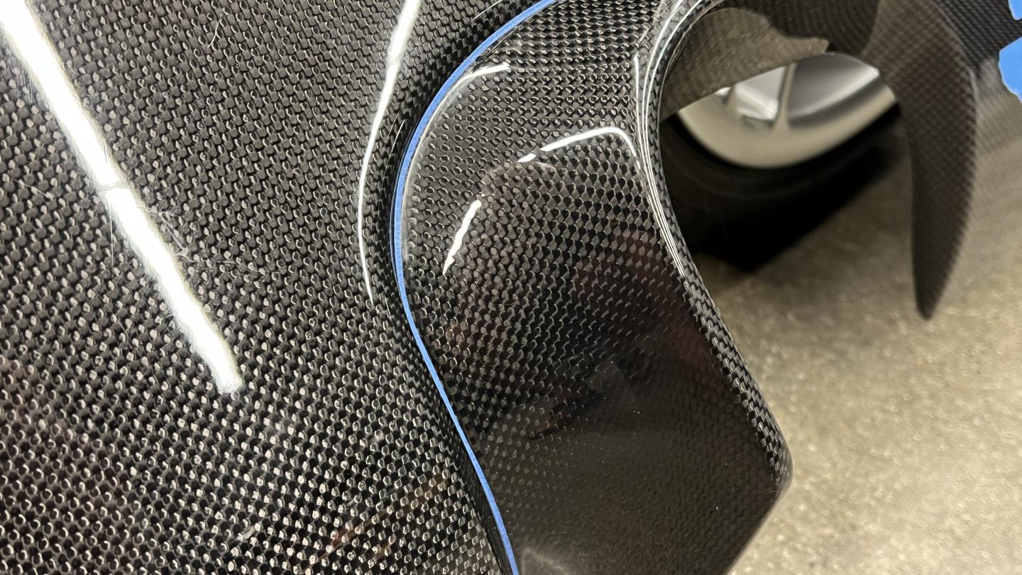

                          Dave also showed me the prep work needed for carbon parts. They were in the early stages, but the carbon parts were rough sanded, and the inside taped off to retain the carbon look and prevent overspray.
