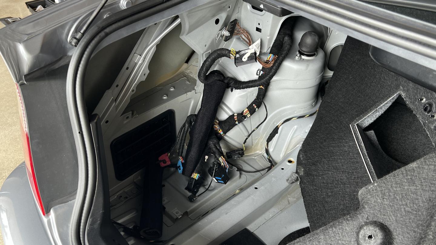

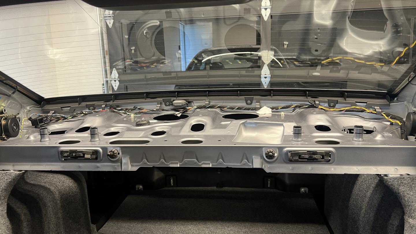

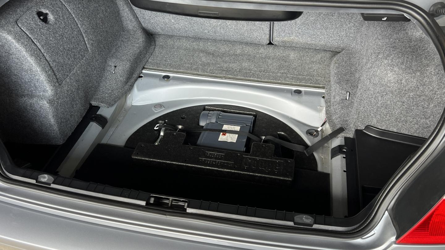

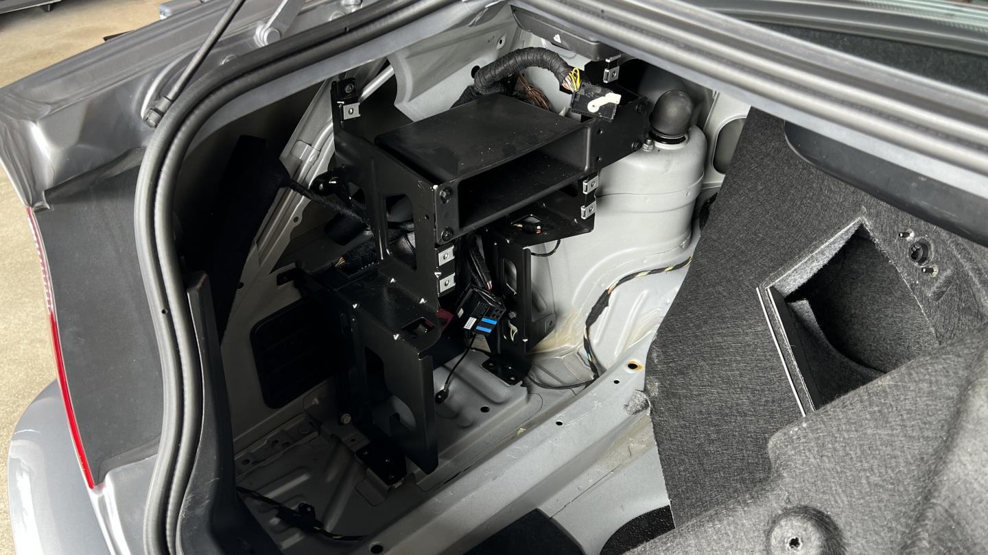

          Spent the morning continuing on with the radio / audio components delete. I started with the trunk area and removed the SOS module, navigation, radio, HK amp, and mounting frame.
          Click image for larger version  Name:	IMG_2565.jpg Views:	0 Size:	173.3 KB ID:	221551
          Click image for larger version  Name:	IMG_2566.jpg Views:	0 Size:	169.8 KB ID:	221553
          Click image for larger version  Name:	IMG_2567.jpg Views:	0 Size:	172.5 KB ID:	221552

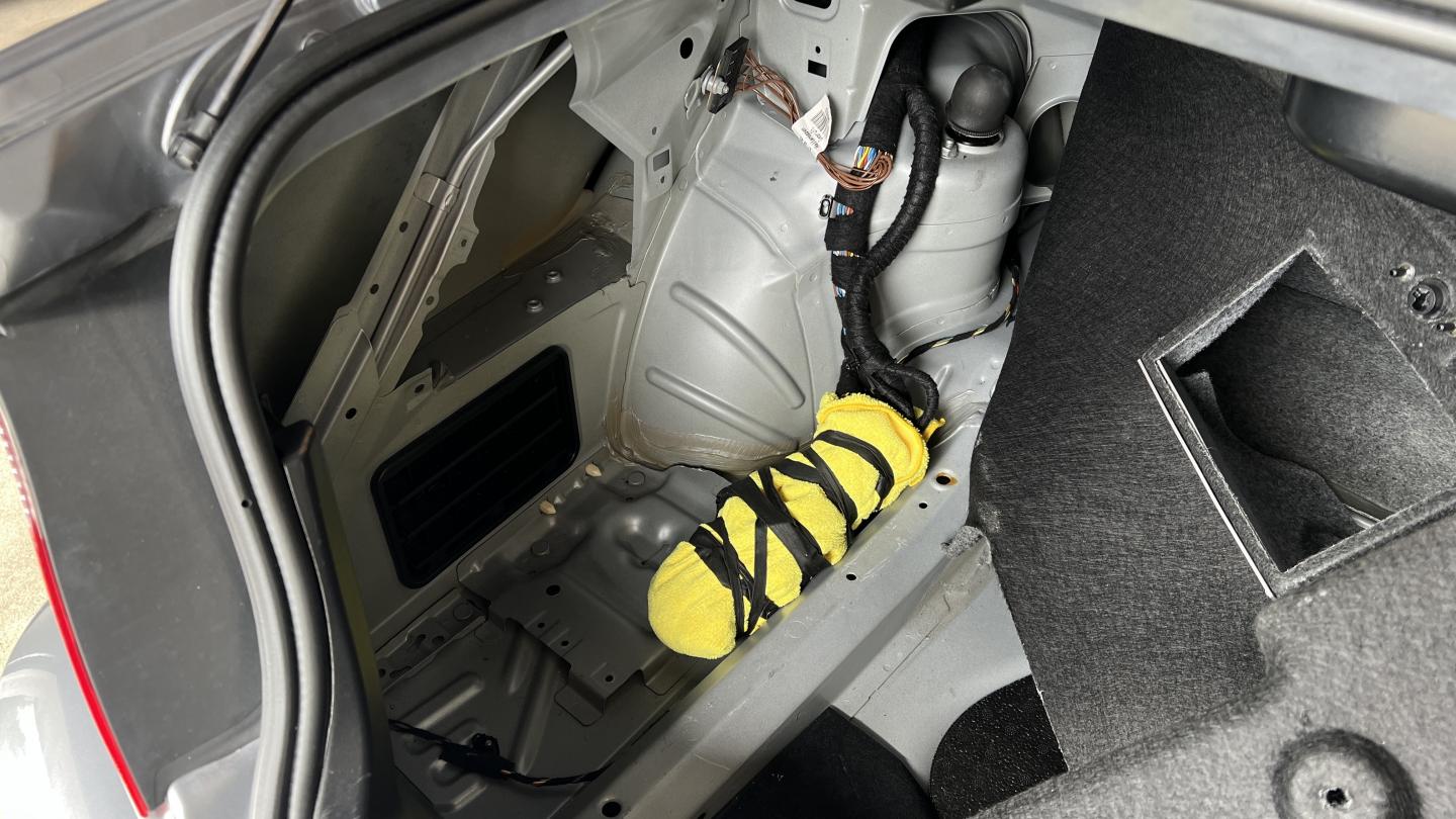

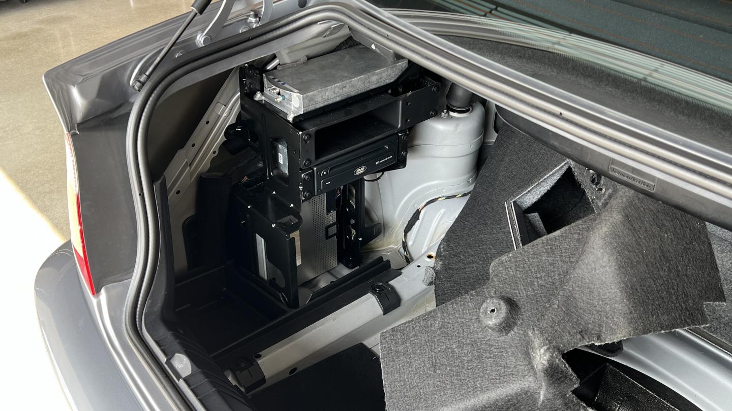

          I bundled up all the wiring harnesses in a microfiber towel then wrapped it tightly with friction tape. The bundle fit nicely in a little nook. I will find a more legitimate wrapping solution at a later time
          Click image for larger version  Name:	IMG_2568.jpg Views:	0 Size:	168.2 KB ID:	221558

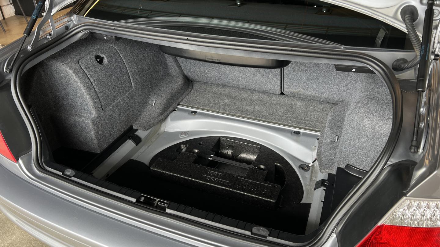

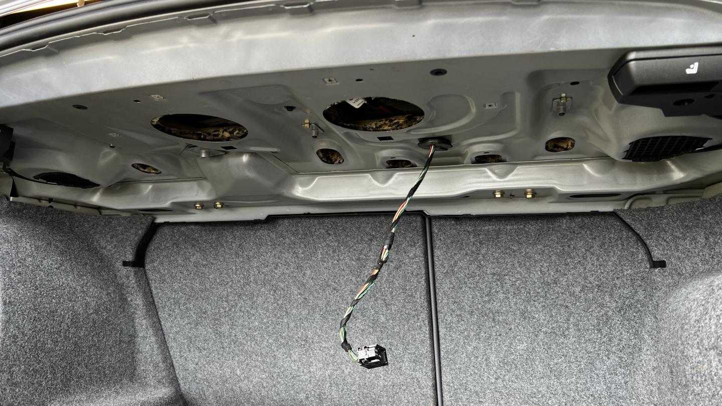

          Everything back together neatly. I then removed the emergency m-mobility system.
          Click image for larger version  Name:	IMG_2564.jpg Views:	0 Size:	190.7 KB ID:	221554
          Click image for larger version  Name:	IMG_2569.jpg Views:	0 Size:	195.9 KB ID:	221559
          Next up was the HK under-deck mounted subwoofer
          Click image for larger version  Name:	IMG_2570.jpg Views:	0 Size:	228.3 KB ID:	221563

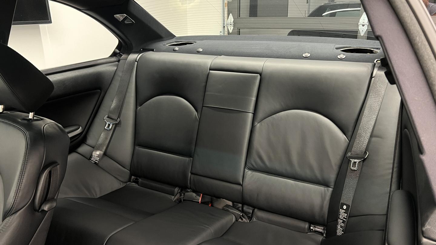

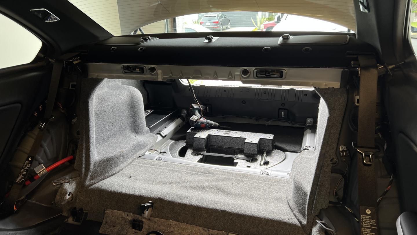

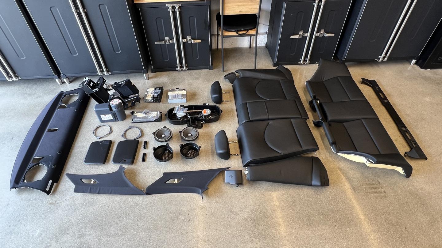

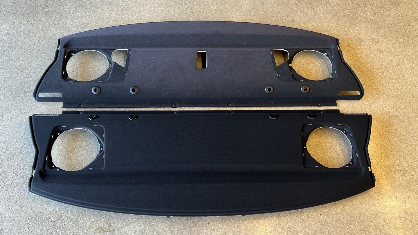

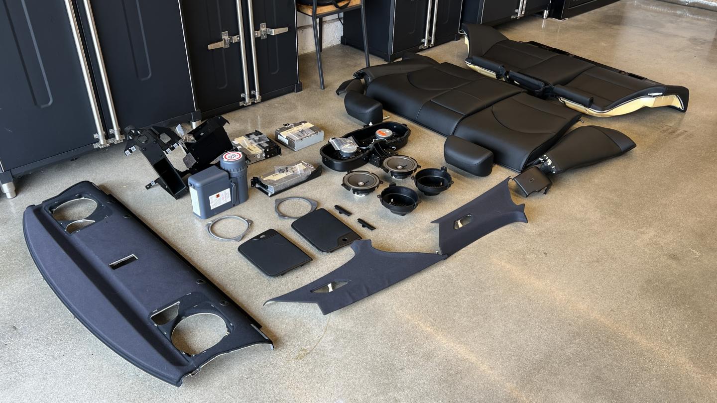

          In addition to removing the speakers, I also had planned on replacing the rear parcel shelf with the streamlined Euro version and new c-pillars. Although the c-pillar trim was not faded, the fabric had started peeling from the edges closest to the rear windscreen. First the rear seat backs were removed.
          Click image for larger version  Name:	IMG_2571.jpg Views:	0 Size:	136.3 KB ID:	221556

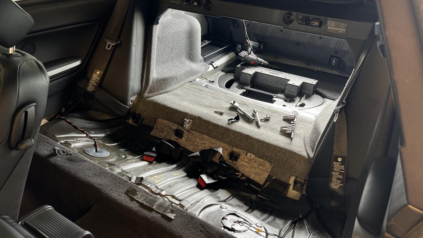

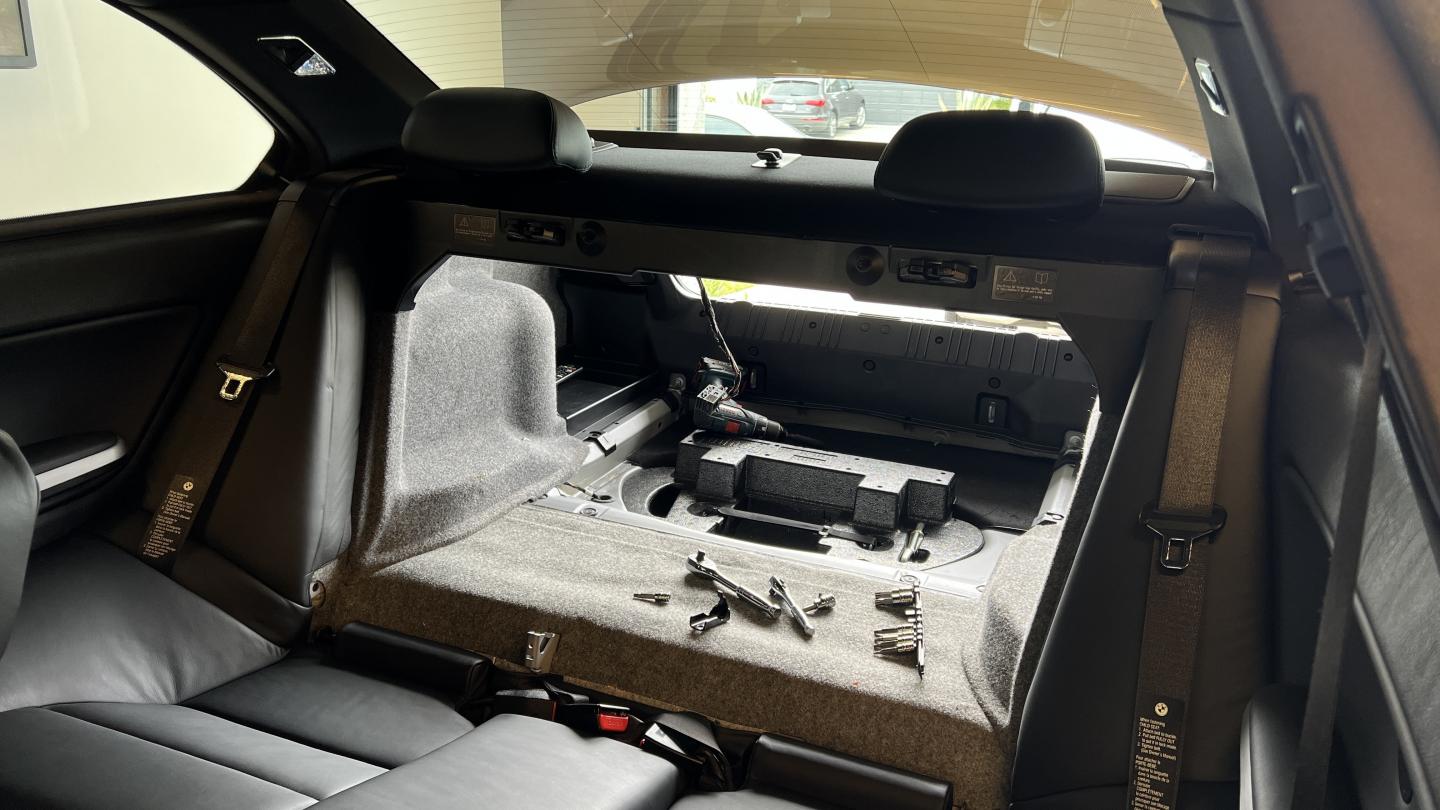

          Rear bench removed
          Click image for larger version  Name:	IMG_2572.jpg Views:	0 Size:	158.9 KB ID:	221561
          Side bolsters removed. Next up was the removal of the plastic through-loading cross member trim. The plastic rivets were 100% stuck, and I had to cut the heads off just to get the trim off.
          Click image for larger version  Name:	IMG_2573.jpg Views:	0 Size:	147.7 KB ID:	221557
          I then removed the c-pillars, unbolted the seatbelts, removed the seatbelt cover outlet, latch systems, speaker covers, speakers, and speaker mounts. I did not photograph everything step by step, as I kind of got into a nice work groove and did not want to stop to take photos. Here is everything removed.
          Click image for larger version  Name:	IMG_2575.jpg Views:	0 Size:	210.0 KB ID:	221562 Click image for larger version  Name:	IMG_2577.jpg Views:	0 Size:	191.1 KB ID:	221555
          Click image for larger version  Name:	IMG_2578.jpg Views:	0 Size:	193.5 KB ID:	221560

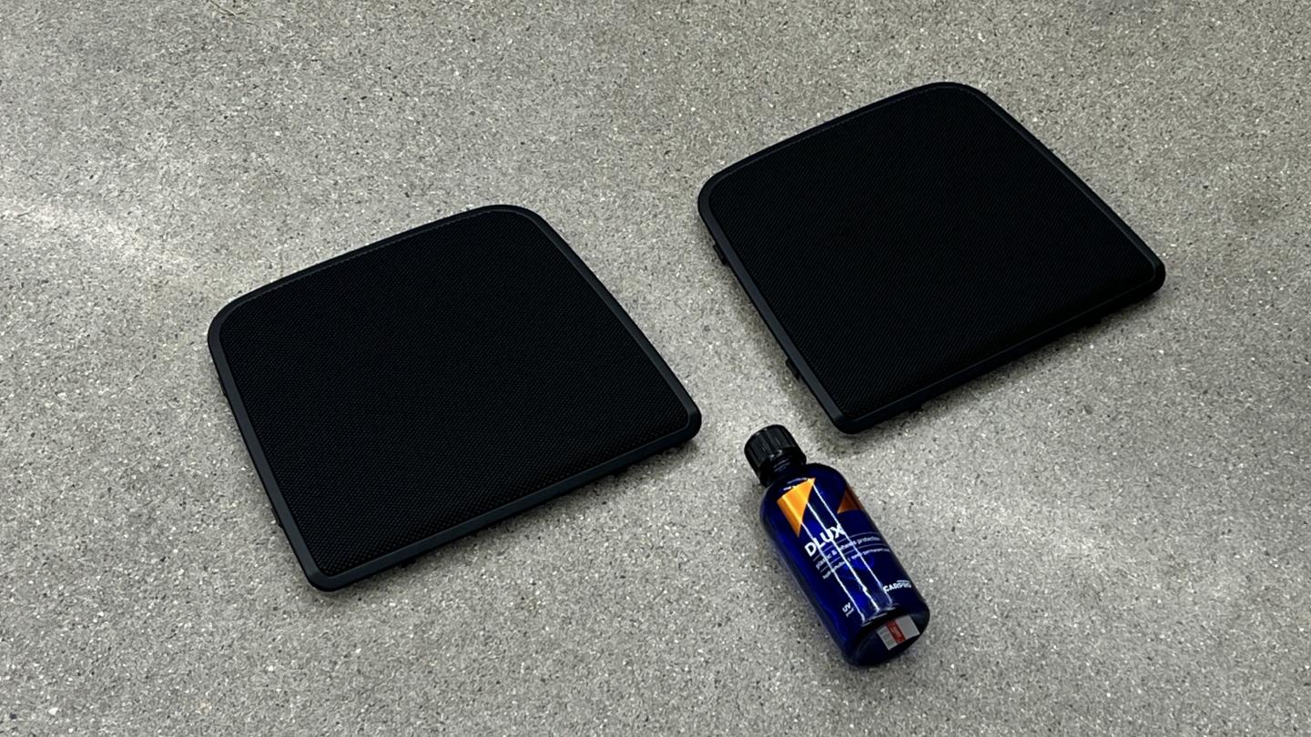

          The new parcel shelf and c-pillars were treated with Carpro fabric coating to reduce UV fade. Some new vs old photos below

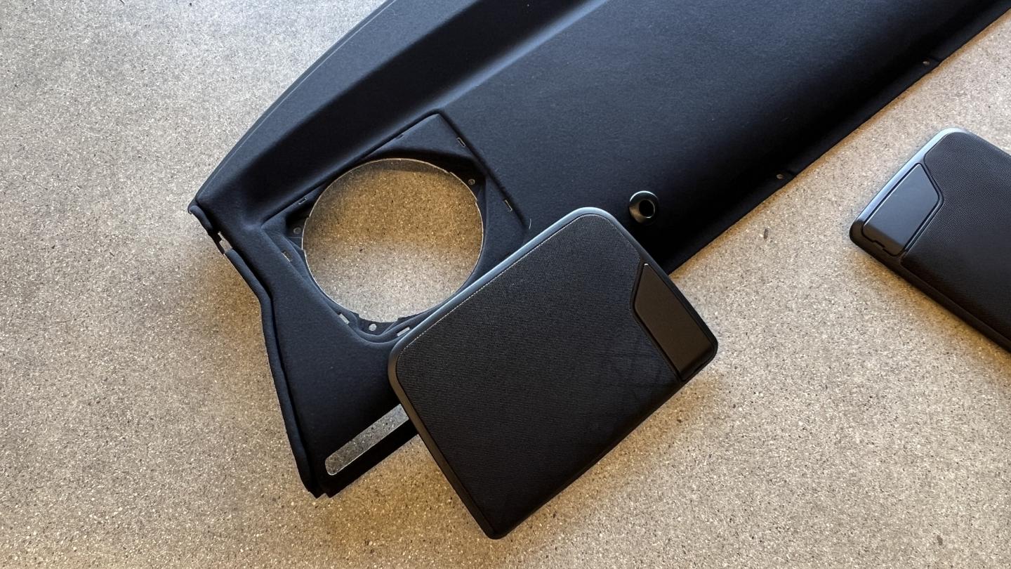

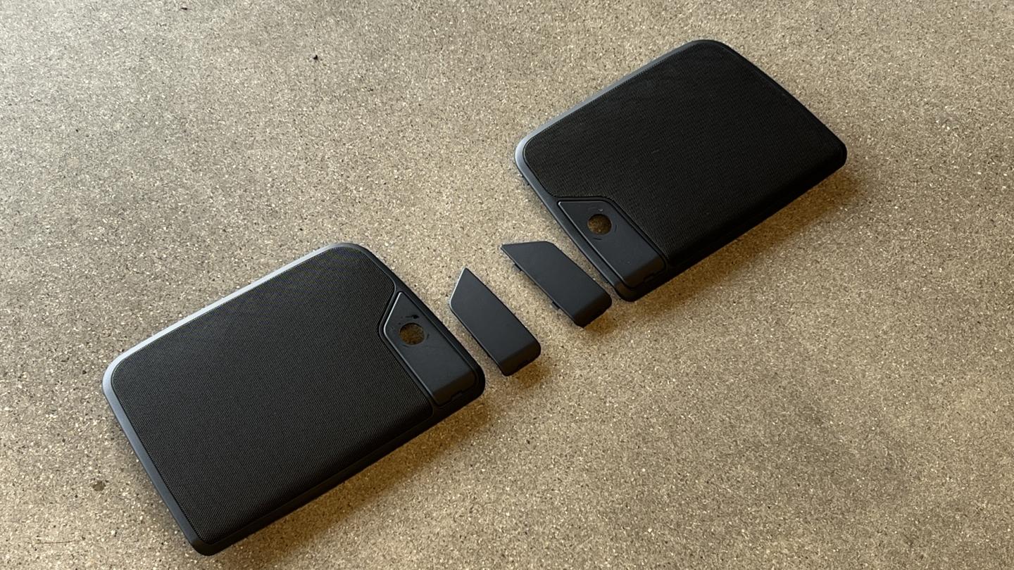

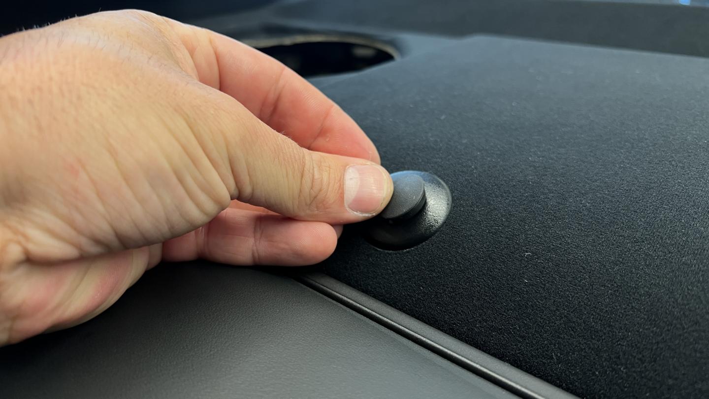

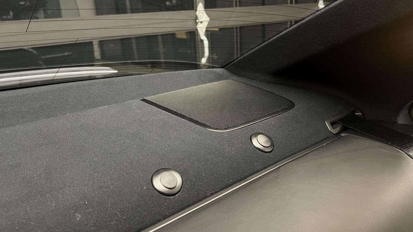

          I wanted to keep the parcel shelf as sleek as possible. I purchased the latch delete plugs for the speaker grills to plug the hole.
          Click image for larger version  Name:	IMG_2583.jpg Views:	0 Size:	284.2 KB ID:	221542
          Click image for larger version  Name:	IMG_2584.jpg Views:	0 Size:	267.0 KB ID:	221543
          I attempted to install these into my new euro parcel shelf, only to realize the new shelf uses the smaller speaker grills! Turns out I purchased these, ceramic coated them, and installed them into the speaker grill for absolutely no reason. Oh well, smaller speaker grills already purchased and awaiting shipment.
          Click image for larger version  Name:	IMG_2587 2.jpg Views:	0 Size:	240.9 KB ID:	221548

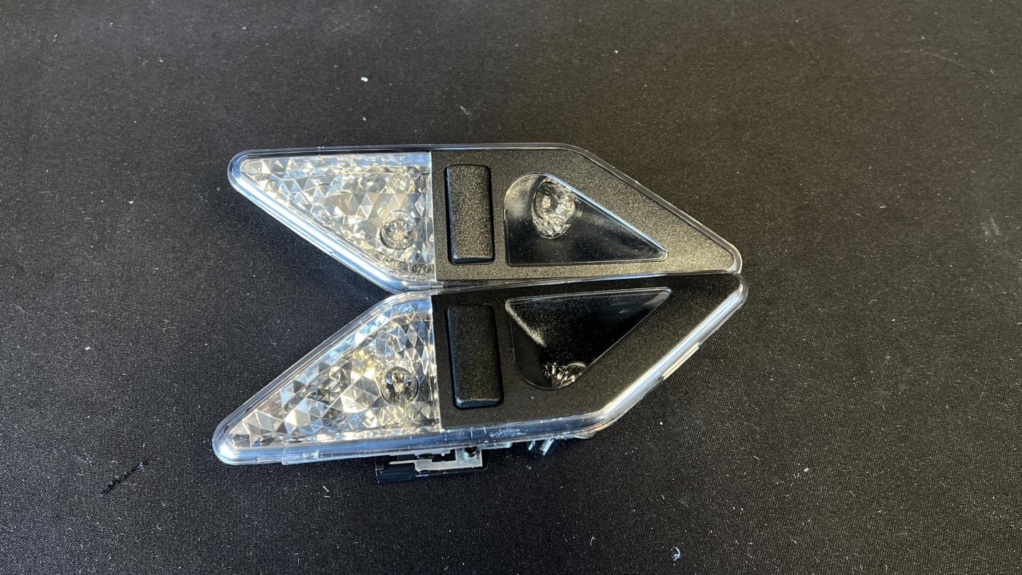

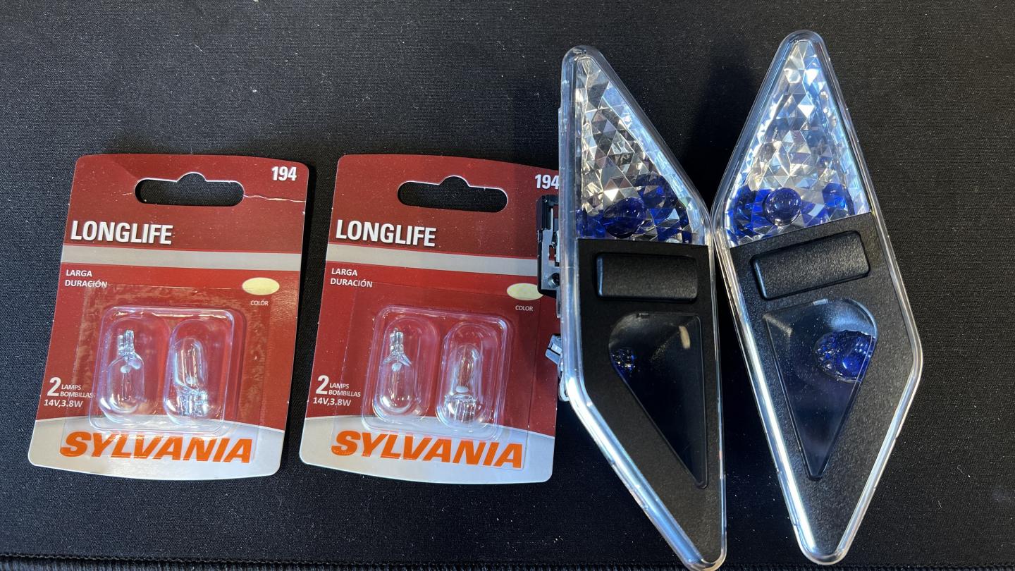

          While the c-pillar lights were out, I swapped out the hideous blue wedge bulbs one of the previous owners installed. They were swapped out with Sylvania long life 194 bulbs. The blue ones went directly into the trash can.
          Click image for larger version  Name:	IMG_2580.jpg Views:	0 Size:	244.6 KB ID:	221547
          Click image for larger version  Name:	IMG_2581.jpg Views:	0 Size:	267.1 KB ID:	221546

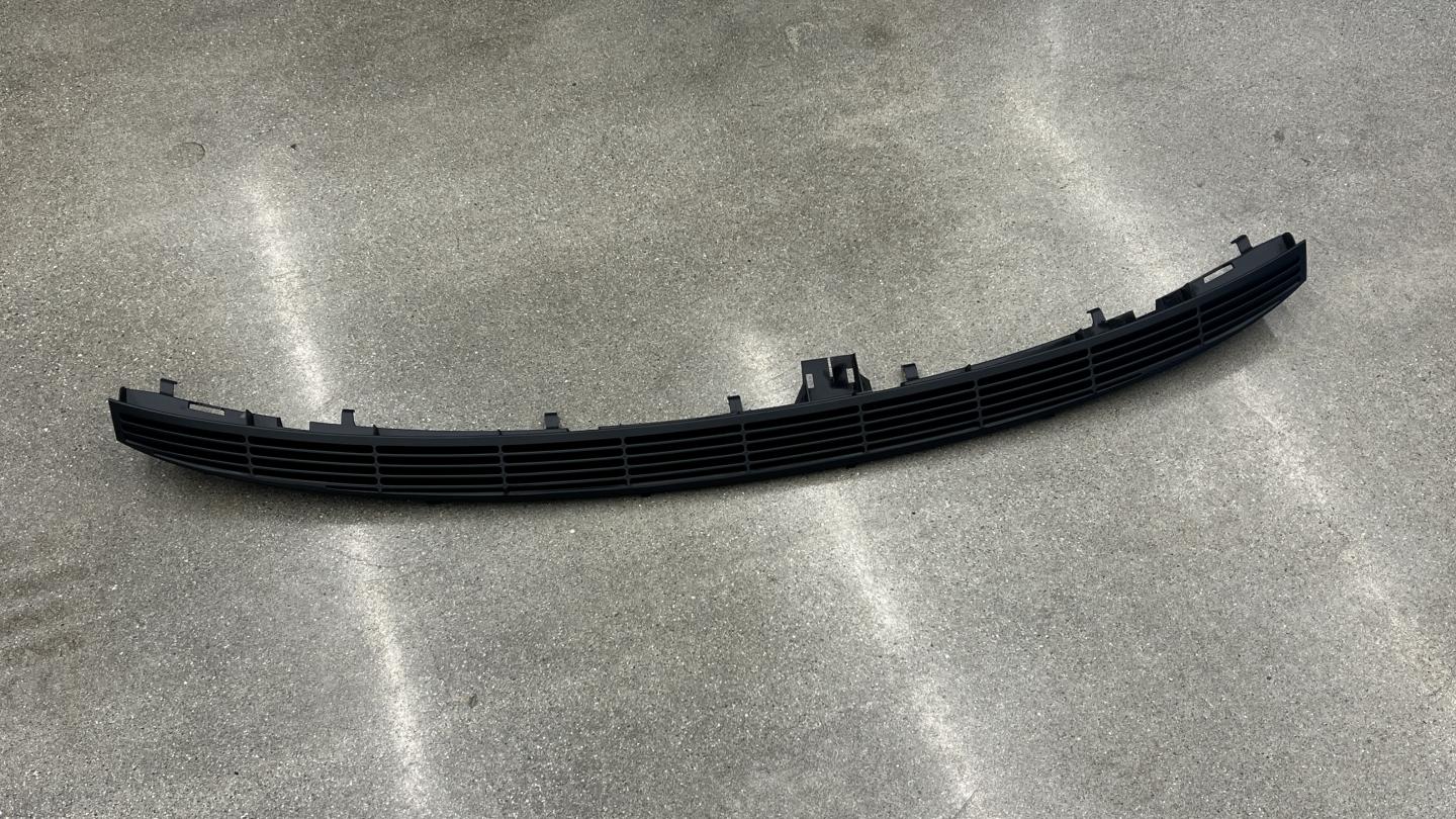

            Part # for the speaker grille blanks? Didn't know they had 'em!
              BMW Part No. 51468243667 and 51468243668. Weirdly, one is 3-4x times the price vs the opposite side.

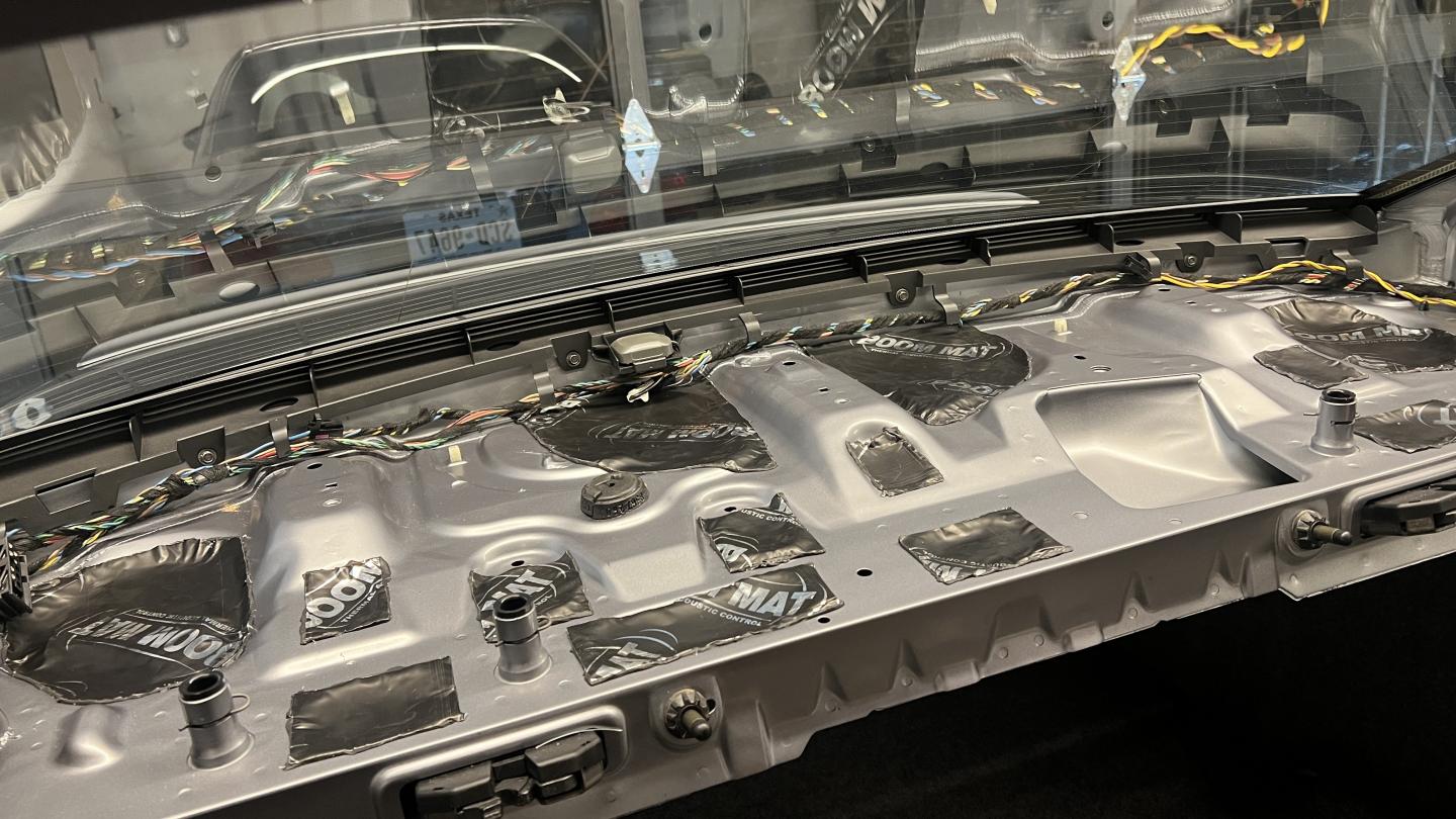

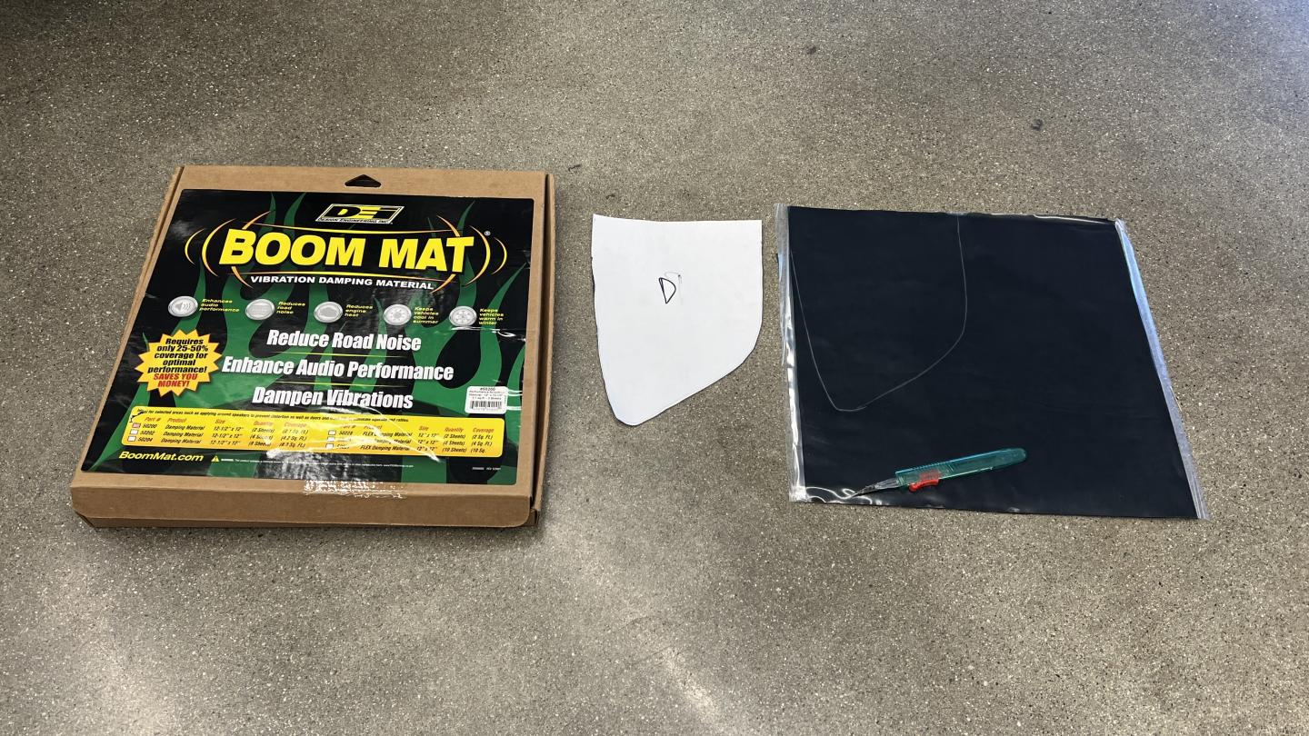

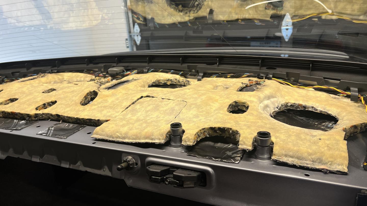

              This morning I continued on with the rear deck project. I remember seeing Tbonem3 build thread where he added acoustic mat to the holes in the rear deck. Great idea, so I stole it. Although I want to remove some of the weight from the car, I don't want it to sound stripped out and unfinished. I created some templates and cut the acoustic mat to shape.
              Factory sound deadening foam removed
              Click image for larger version  Name:	IMG_2592.jpg Views:	0 Size:	174.2 KB ID:	221694
              Templates cut and installed
              Click image for larger version  Name:	IMG_2594.jpg Views:	0 Size:	285.1 KB ID:	221699
              Click image for larger version  Name:	IMG_2595.jpg Views:	0 Size:	197.3 KB ID:	221696 Click image for larger version

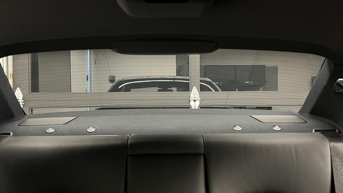

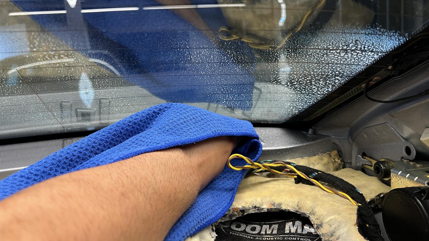

              I then test fit the new rear parcel shelf. I checked my work from the outside of the car and saw that the area between the rear windscreen and rear parcel shelf vented trim was dirty. I had to take out the sound insulation foam, then remove the vented trim. While the trim was out, I ceramic coated it with Carpro Dlux. It was incredibly time consuming but worthwhile due to it being exposed to UV constantly.
              Click image for larger version  Name:	IMG_2597.jpg Views:	0 Size:	289.1 KB ID:	221698
              Click image for larger version  Name:	IMG_2599.jpg Views:	0 Size:	232.3 KB ID:	221695
              Window was deep cleaned
              Click image for larger version  Name:	IMG_2598.jpg Views:	0 Size:	222.3 KB ID:	221697
              Click image for larger version  Name:	IMG_2604.jpg Views:	0 Size:	135.4 KB ID:	221692
              Everything reinstalled. Along the way, I broke some clips which will need to be replaced at a later date. For now, I will be leaving the headrests out as well. The headrest holes were plugged with a rubber BMW blind plug. Thank you to Casa de Mesa for the idea. I will update once the new speaker grills and replacement clips arrive.

                      New through-loading cross member trim, seatbelt outlet guides, retaining clips and speaker grills came in. I ceramic coated all the parts prior to installation. The euro parcel shelf project is complete. Looks amazing. In person it looks so fresh and so minimalist.

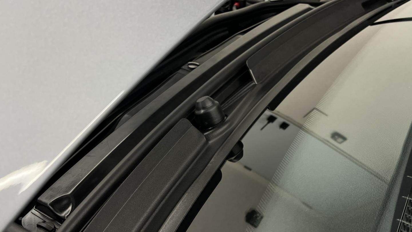

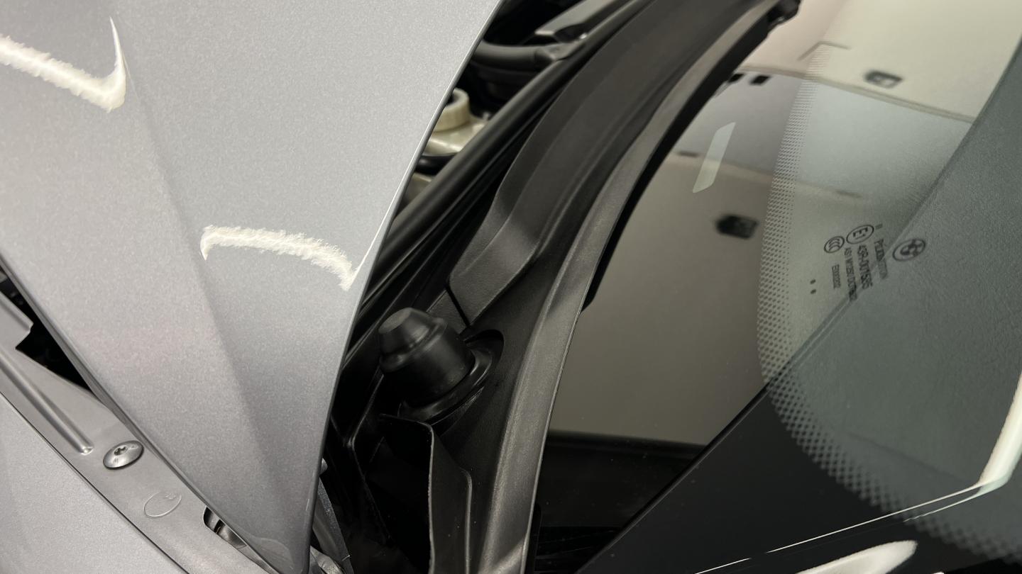

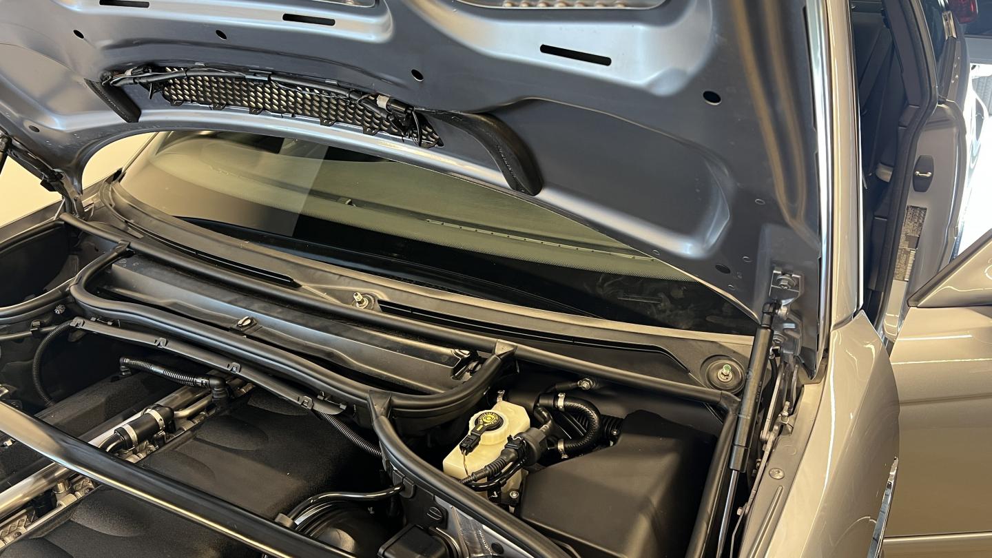

                          To me, the windshield wipers have always stood out and cluttered the front end, which is otherwise near perfection. At this point in its life, this car is a once a month, perfect weather, SoCal coastal/canyon run type of treat.
                          I have a long term plan of deleting the windshield wiper motor, arms, and plugging the holes. Until then I still wanted to get rid of the wipers. I picked up a set of No-Coast engineering threaded windshield wiper delete caps. They are 3D printed and are model/chassis specific.

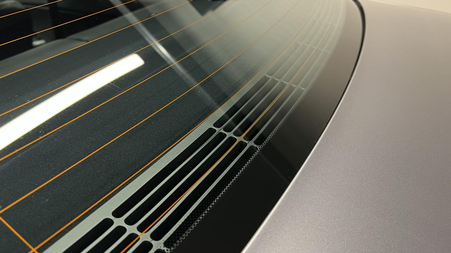

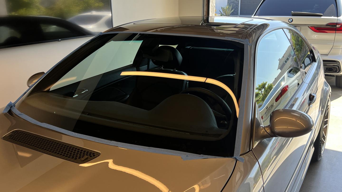

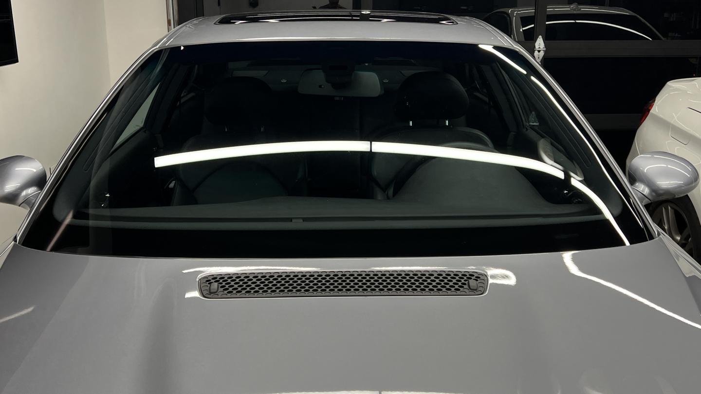

                          First I removed the wipers/arms
                          Click image for larger version  Name:	IMG_3006.jpg Views:	0 Size:	179.1 KB ID:	226696

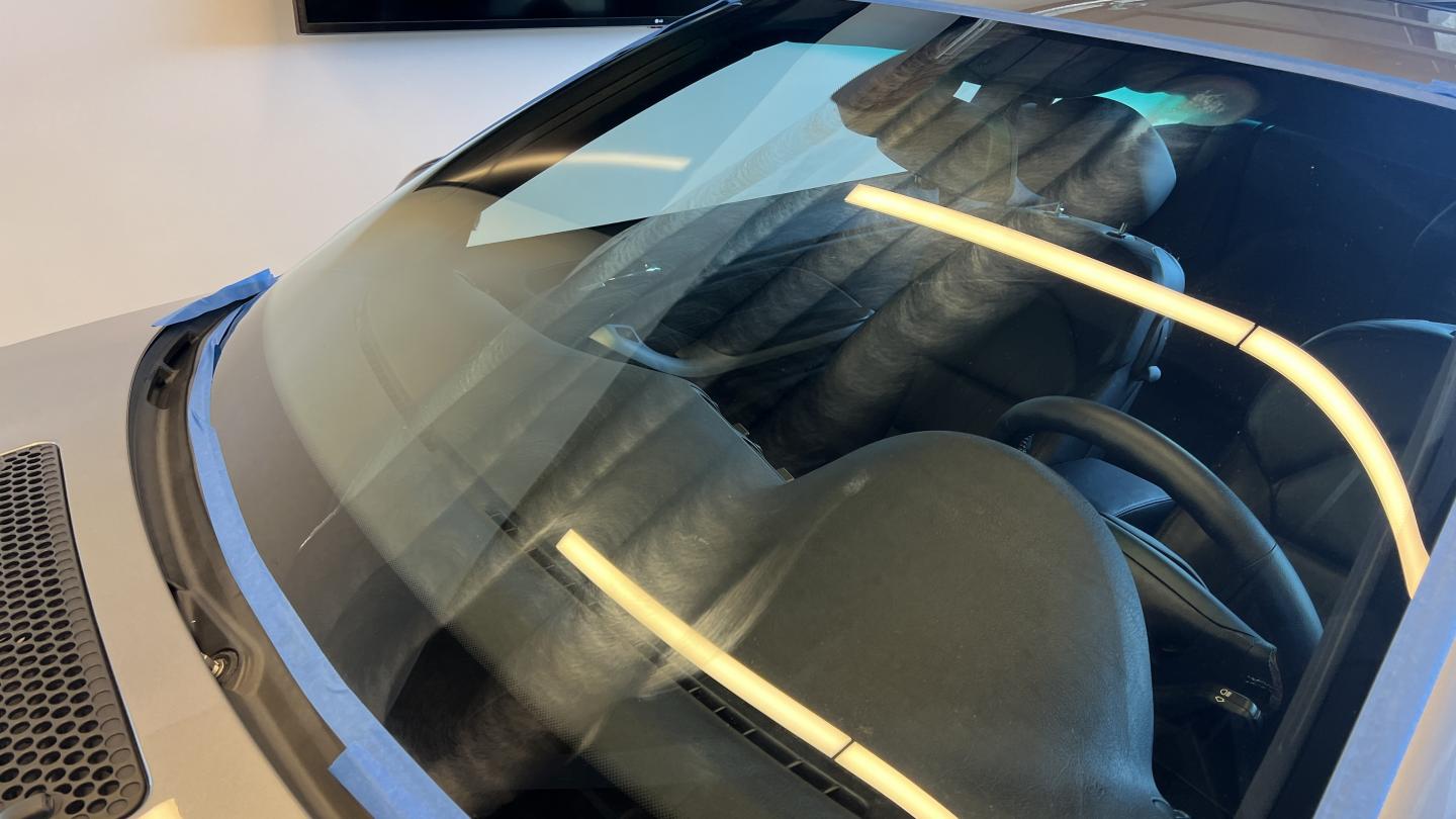

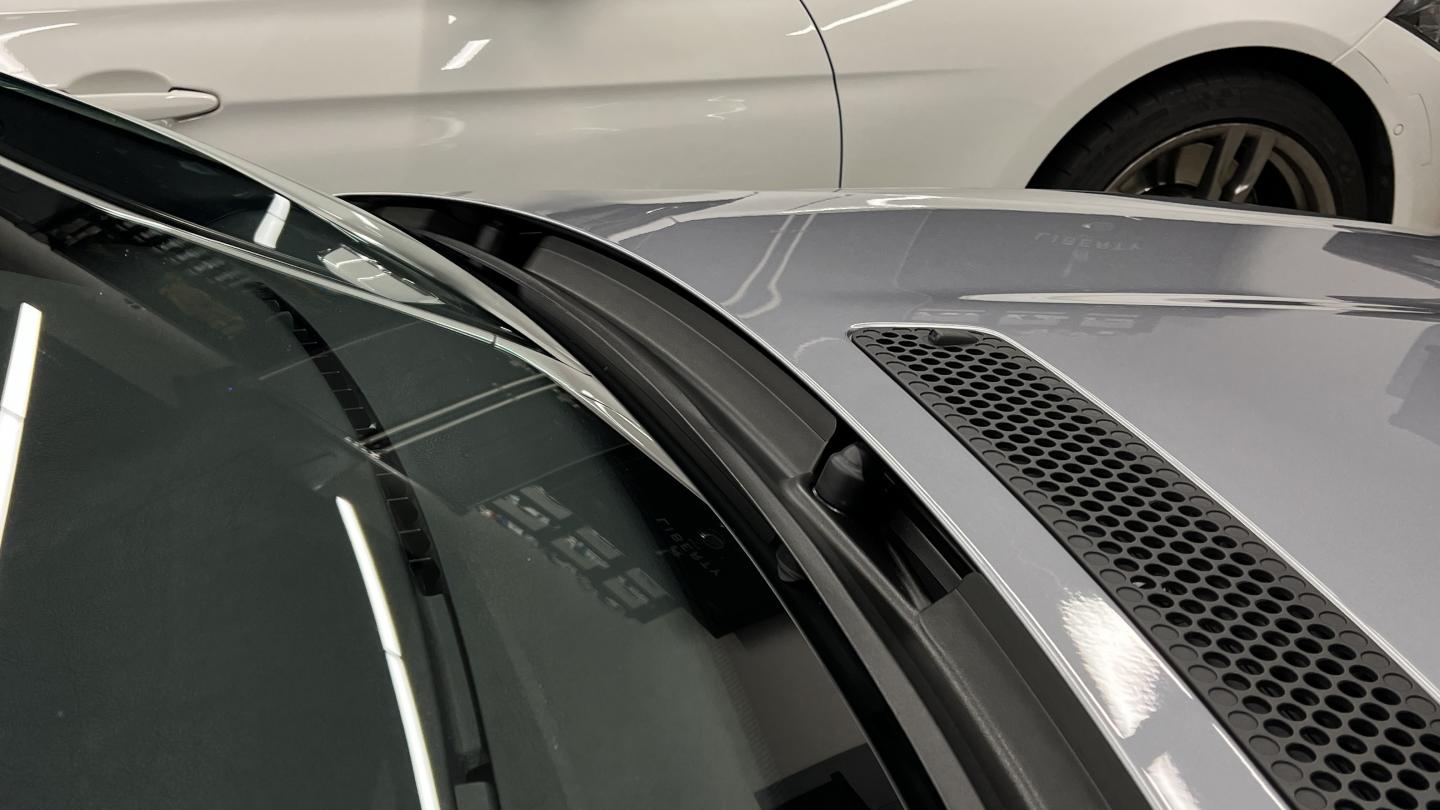

                          Then taped everything off and polished the windshield
                          Click image for larger version  Name:	IMG_3007.jpg Views:	0 Size:	125.9 KB ID:	226692
                          Click image for larger version  Name:	IMG_3008.jpg Views:	0 Size:	110.4 KB ID:	226693

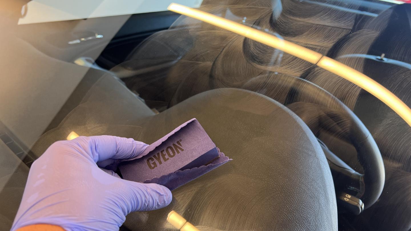

                          Windshield was then coated with Gyeon View coating
                          Click image for larger version  Name:	IMG_3009.jpg Views:	0 Size:	128.3 KB ID:	226697

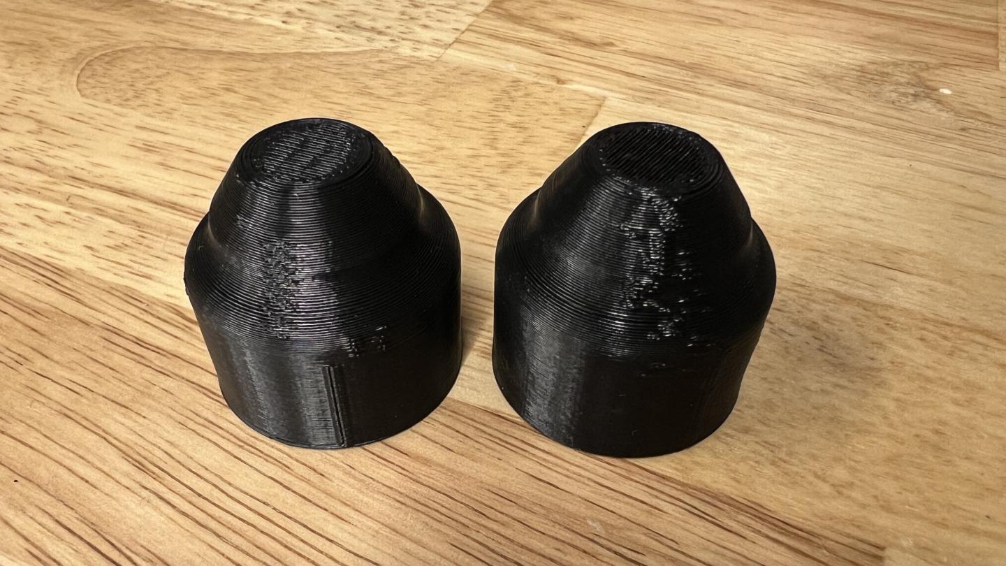

                          3D printed texture was a bit too unrefined for my liking. I put them on the end of a drill and sanded them down. Texture didn't turn out perfect, but far better than how they looked when I received them. This is the before photo. After texture can be seen in installed photos.
                          Click image for larger version  Name:	IMG_3089.jpg Views:	0 Size:	180.0 KB ID:	226695

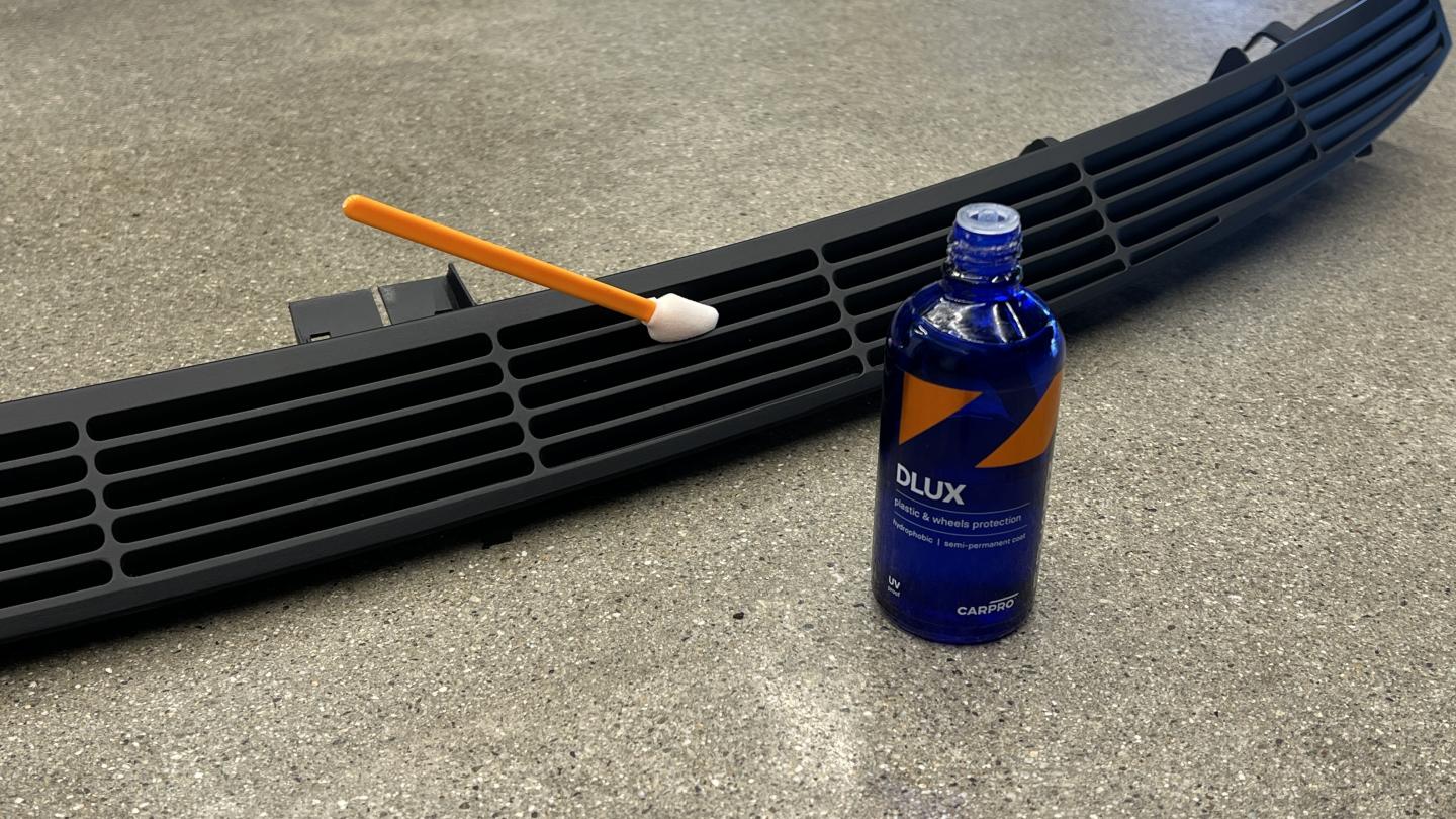

                          Ceramic coated the windshield cowl with CarPro Dlux, then installed the wiper delete caps. Final look, much cleaner.
                          Click image for larger version  Name:	IMG_3091.jpg Views:	0 Size:	101.9 KB ID:	226694
                          Click image for larger version  Name:	IMG_3092.jpg Views:	0 Size:	88.4 KB ID:	226689
                          Click image for larger version  Name:	IMG_3093.jpg Views:	0 Size:	111.4 KB ID:	226691
                          Click image for larger version  Name:	IMG_3094.jpg Views:	0 Size:	94.7 KB ID:	226688
