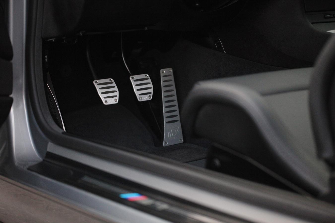

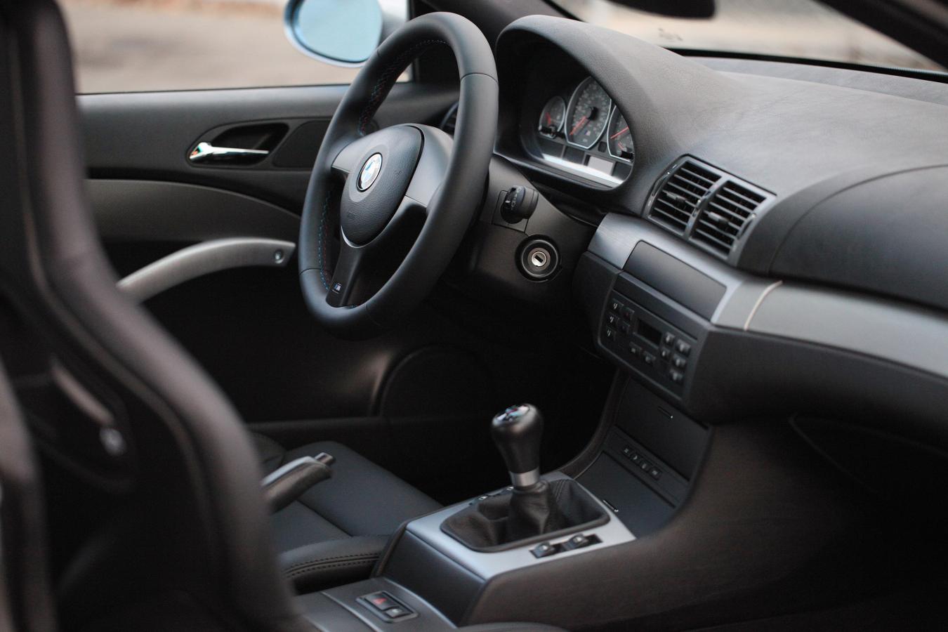

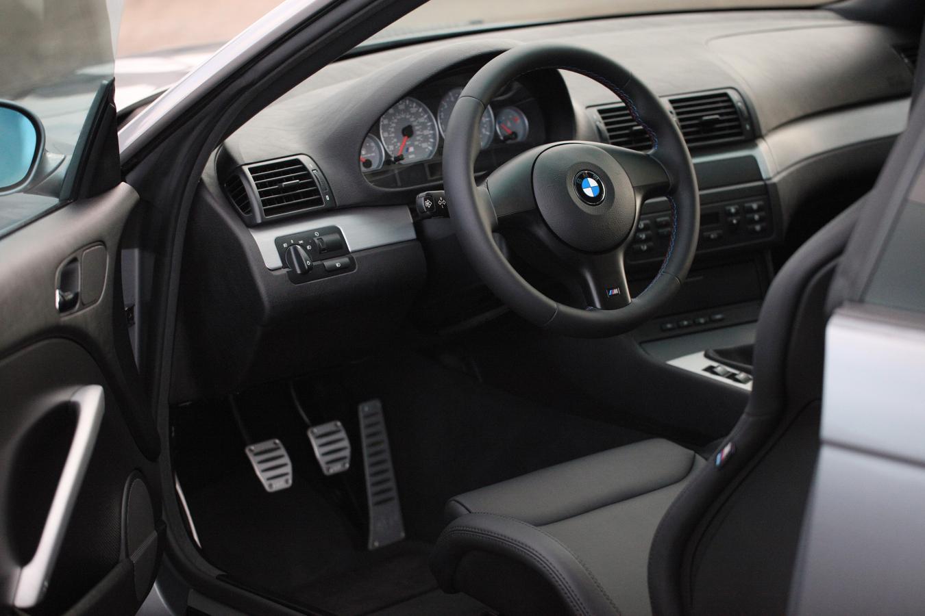

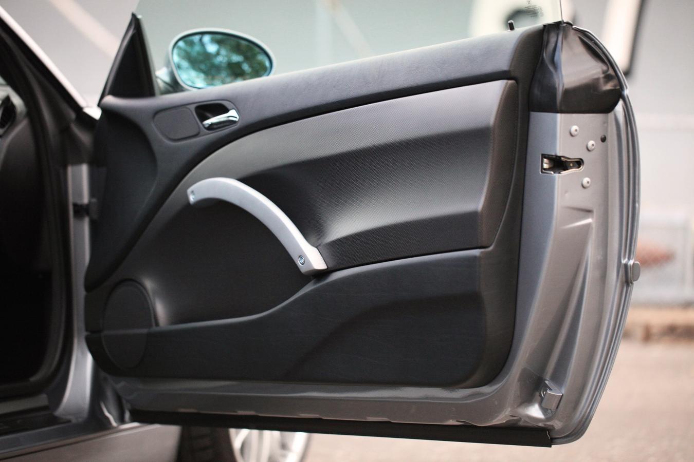

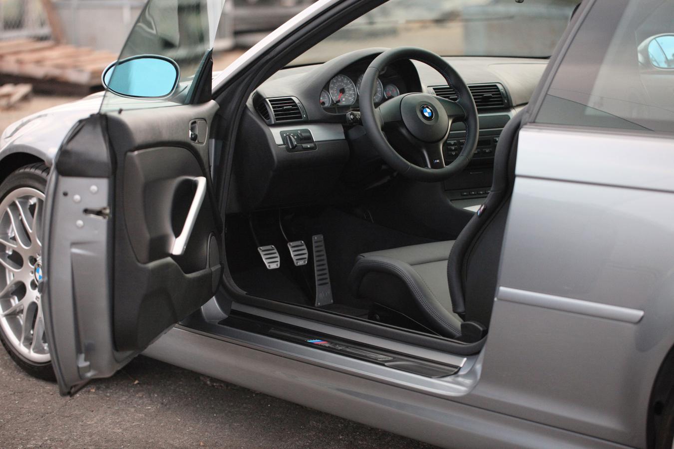

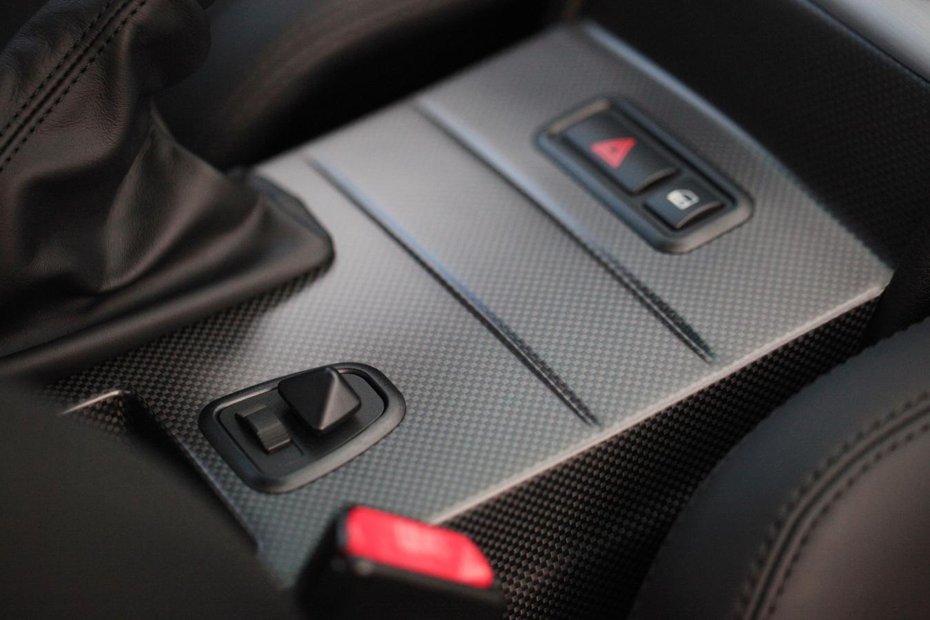

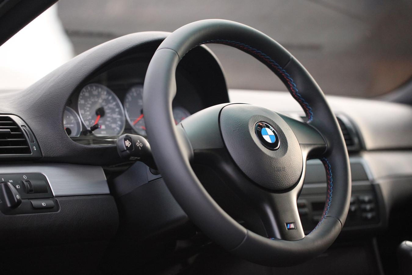

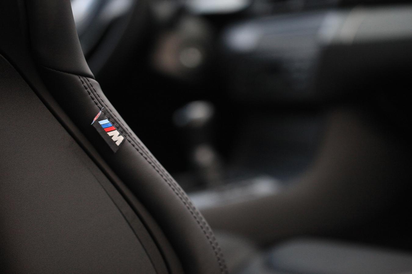

            Now that the interior is done, I wanted to share some completed photos and summarize everything in one post. The interior portion of this build has been spread over ten different pages, and I thought it would be useful to have one post that contained everything I’ve been working on for the last two years.
            First, the photos
            Click image for larger version Name:	IMG_1656_EDIT_2.jpg Views:	0 Size:	100.1 KB ID:	291176
            Click image for larger version Name:	IMG_1660_EDIT_2.jpg Views:	0 Size:	94.9 KB ID:	291174
            Click image for larger version Name:	IMG_1635_EDIT_2.jpg Views:	28 Size:	79.5 KB ID:	291175
            Click image for larger version Name:	IMG_1637_EDIT_2.jpg Views:	0 Size:	101.2 KB ID:	291181
            Click image for larger version Name:	IMG_1657_EDIT_2.jpg Views:	0 Size:	70.3 KB ID:	291182
            Click image for larger version Name:	IMG_1652_EDIT_2.jpg Views:	0 Size:	121.2 KB ID:	291183
            Click image for larger version Name:	IMG_1669_EDIT_2.jpg Views:	0 Size:	101.6 KB ID:	291179
            Click image for larger version Name:	IMG_1641_EDIT_2.jpg Views:	0 Size:	96.0 KB ID:	291178
            Click image for larger version Name:	IMG_1648_EDIT_2.jpg Views:	4 Size:	104.1 KB ID:	291180
            Click image for larger version Name:	IMG_1667_EDIT_2.jpg Views:	4 Size:	90.5 KB ID:	291177
            Click image for larger version Name:	IMG_1672_EDIT_2.jpg Views:	0 Size:	97.1 KB ID:	291184
            Click image for larger version Name:	IMG_1642_EDIT_2.jpg Views:	0 Size:	70.5 KB ID:	291172
            Click image for larger version Name:	IMG_1673_EDIT_2.jpg Views:	0 Size:	114.9 KB ID:	291980
            Click image for larger version Name:	IMG_1678_EDIT_2.jpg Views:	0 Size:	84.2 KB ID:	291981
            Click image for larger version Name:	IMG_1681_EDIT_2.jpg Views:	0 Size:	63.1 KB ID:	291173
            From the front of the interior to the rear, here’s everything that was done:
            • Dinan brushed aluminum pedals.
            • Custom / refurbished steering wheel, 1cm thicker diameter, smooth Nappa like leather, ///M colored tri-stitch. Blank upper trim (button delete), lower trim refinished in matte black.
            • Steering wheel and dashboard airbags replaced under recall.
            • Navigation delete, radio delete panel, new instrument switch panel, HVAC controls moved up, new lower sunglass holder.
            • Z4 rear view mirror, manual adjustment with grey clown-nose alarm.
            • New sunroof motor cover without home link and sunroof switch.

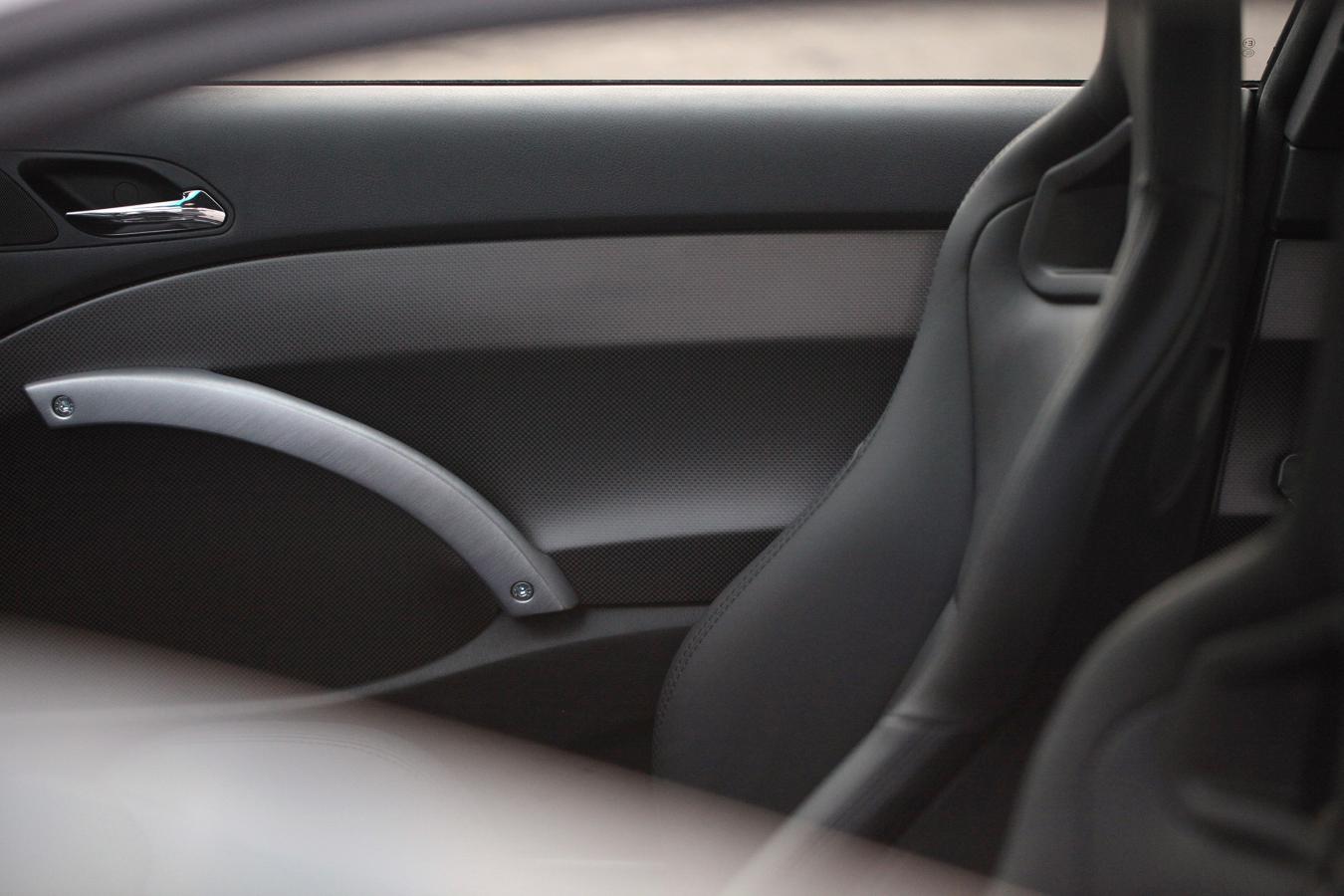

            • New inner door handles without HK logo

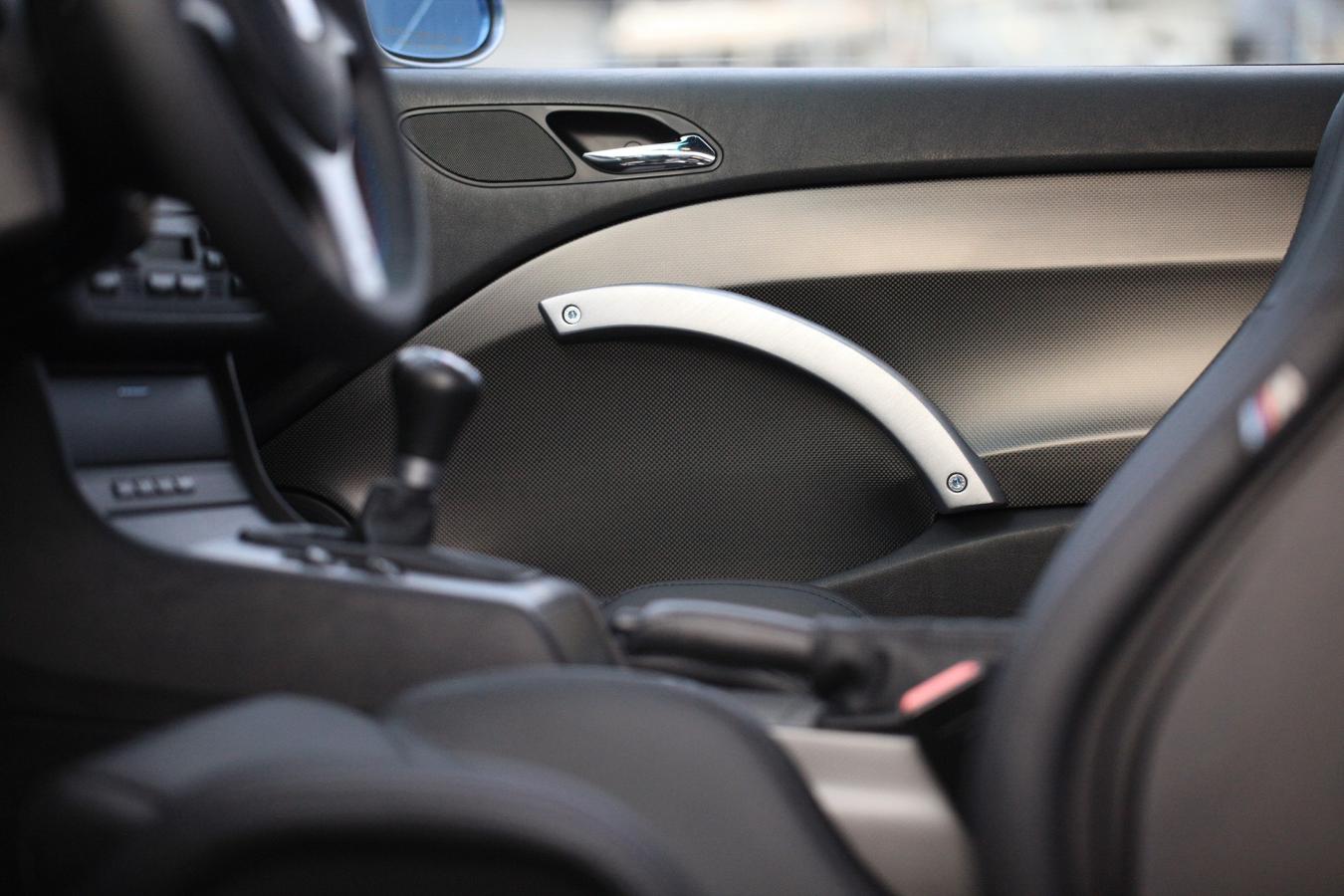

            • CSL front door panels in matte 1x1 carbon fiber, ceramic coated for a satin finish. CSL door handles in custom brushed aluminum finish. Sound deadening on back of panels. Door panel speakers deleted. Airbags deleted.

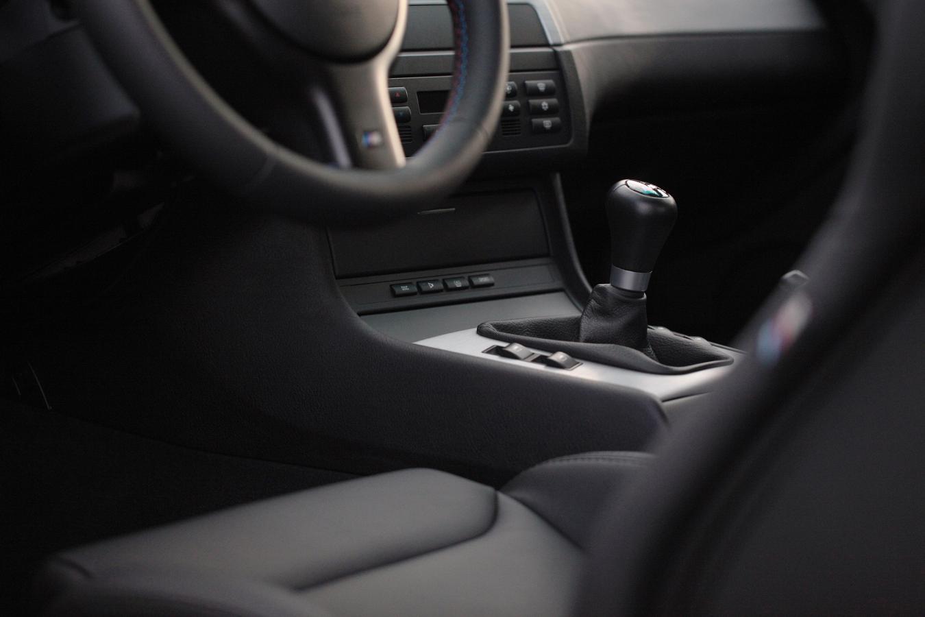

            • CSL center console in matte 1x1 carbon fiber, ceramic coated for a satin finish. Mirror adjustment switch moved to center console. New hazard switch and mirror switch trim. CSL leather e-brake boot.

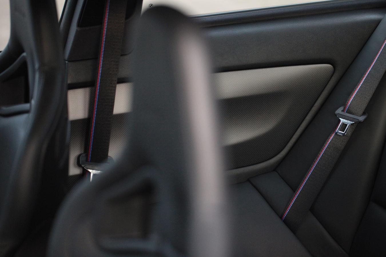

            • Seat belt assemblies sent off and replaced with ///M colored tri-stitch belts. Factory seat belt tags were re-sewn on.

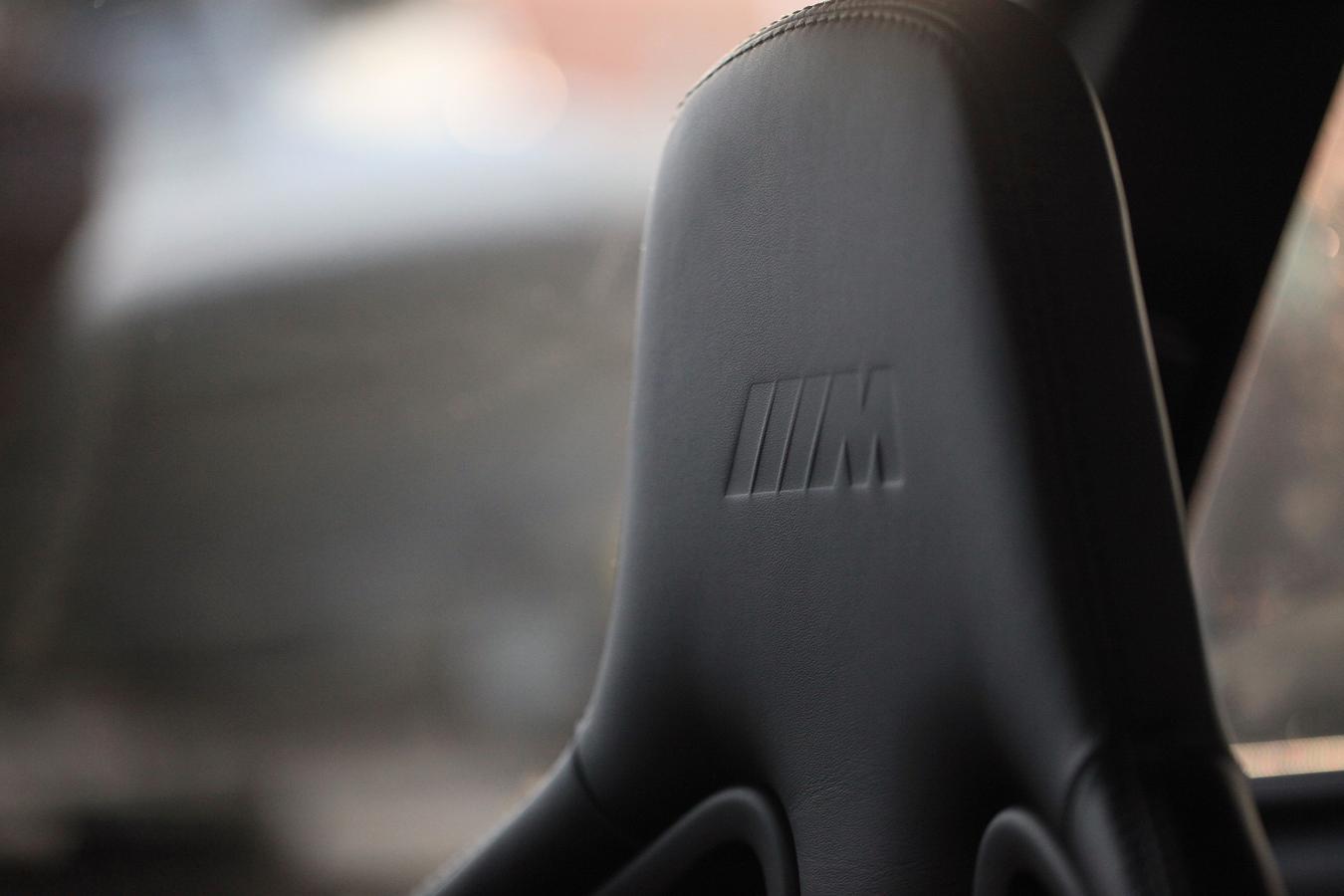

            • Recaro Sportster CS front seats, custom Nappa like leather by AMX performance, ///M logo embossed in headrests, ///M logo tag sewn into side bolster. Seats were installed onto factory seat power sliders with custom seat brackets. Momentary switch was wired for forward and backward movement. New nuts, bolts and bolt covers for seat brackets.
            • CSL rear door panels in matte 1x1 carbon fiber, ceramic coated for a satin finish. Sound deadening on back of panels. Door panel speakers deleted. Airbags deleted.
            • Rear headrest deleted, headrest holes plugged with BMW blind plug. Rear center seatbelt delete.
            • Rear parcel shelf replaced with European version (no LATCH holes), smaller speaker grills without HK logo. Rear deck speakers and subwoofer deleted. New through loading cross member trim. New rear seat belt outlets.
            • New c-pillars and interior light bulbs.
            • Amplifier, navigation and all other audio components deleted from trunk.
            • Massive amount of new clips, screws and fasteners throughout the interior.
            Phase 1 of this build complete.​
