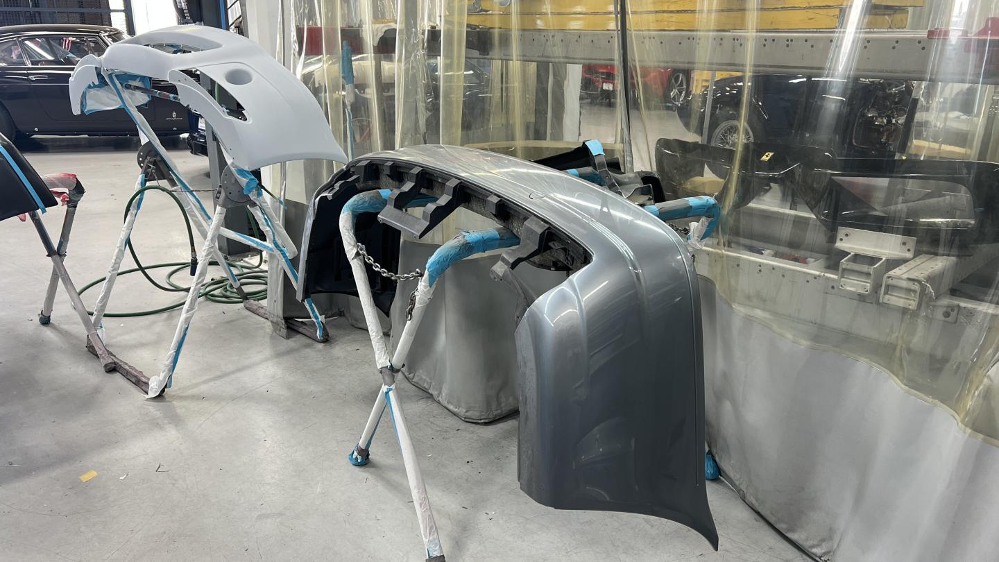

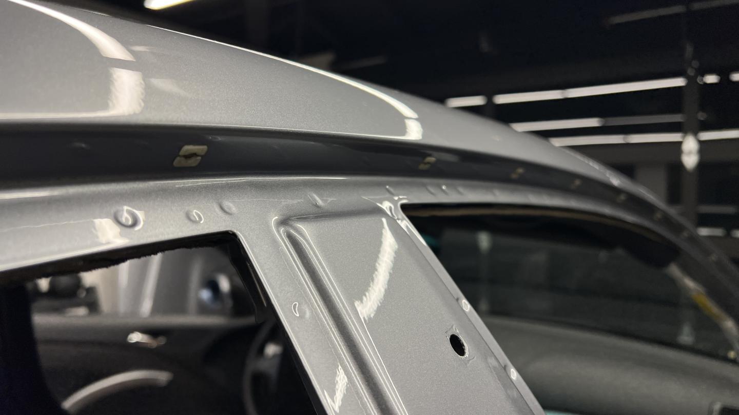

    Fridays have become my day to go and check on the progress of the paintwork. Now that all the big Monterey Car Week jobs are done, Dave was able to have his team make progress on my M3. Not a bad list to be on!
    Click image for larger version  Name:	IMG_4851.jpg Views:	4 Size:	142.4 KB ID:	317750

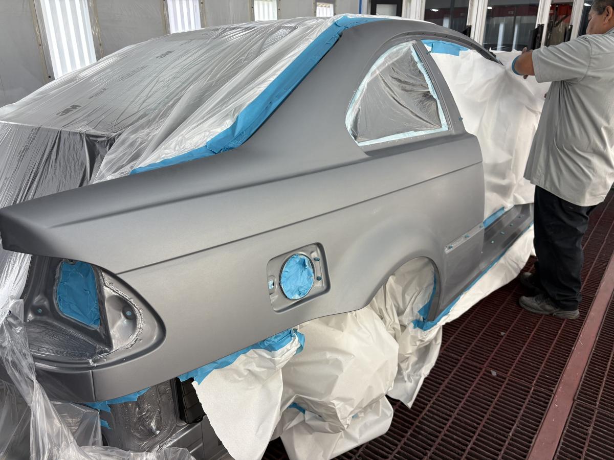

    Prior to getting there, my M3 was already in the paint booth. The booth was already closed and pressurized, so I couldn't really get inside to snap photos of all the prep work they did. Even so, I could see that the paint was sanded down, and all the holes and sensitive areas were meticulously masked off.
    Click image for larger version  Name:	IMG_4852.jpg Views:	4 Size:	162.7 KB ID:	317751

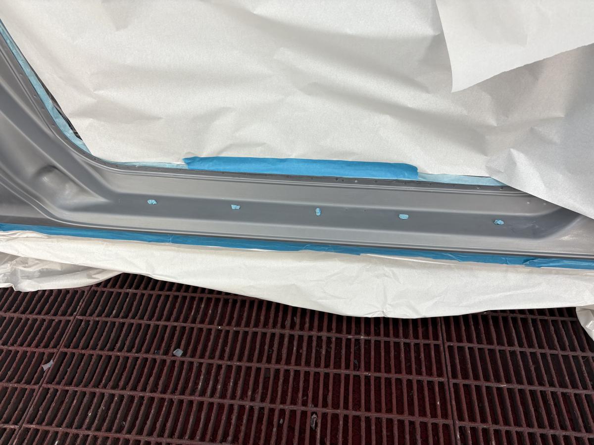

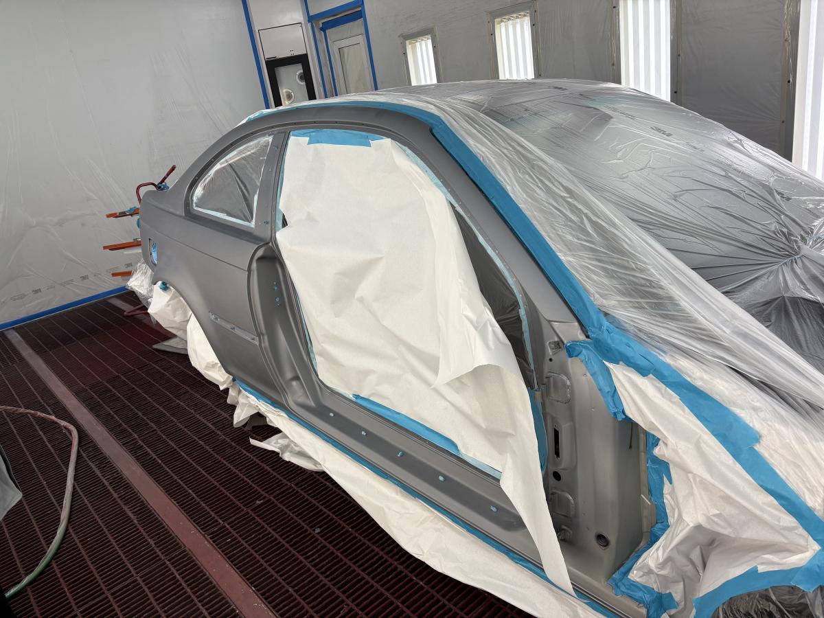

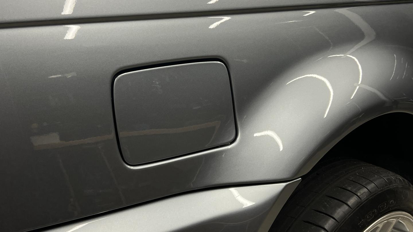

    That said, Dave knew that I wanted photos for this build thread, and he snapped some photos before I arrived.
    Click image for larger version  Name:	IMG_1204.jpg Views:	3 Size:	162.0 KB ID:	317755
    Click image for larger version  Name:	IMG_1208.jpg Views:	3 Size:	147.1 KB ID:	317753
    Click image for larger version  Name:	IMG_1205.jpg Views:	3 Size:	134.7 KB ID:	317754

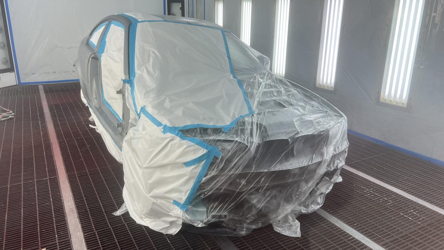

    I am not an expert on paintwork, and I had a lot of basic and probably annoying questions about the process. Dave handled my barrage of questions with grace and gave me a tour of the paint mixing room. I mentioned in a previous post that Dave did 10 color/texture samples for my car, each utilizing different paint manufacturers, spray guns, and adjustments. I was surprised to find that they got the best match with PPG paint. Dave went over all the paint brands he stocks (Sikken, PPG, and Glasurit), and their different applications. The conversation was far beyond my knowledge level but I appreciated the time and explanation. Fun note, the binders on top of the paint cabinets contain every car that they have painted in this paintbooth. They are able to pull every detail, the brand, mixing formula, spray gun, nozzle, pressure settings, etc should they need to work on that same car in the future.

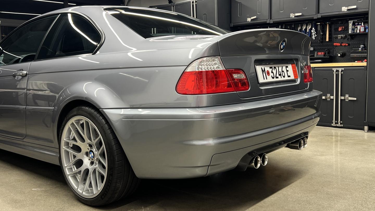

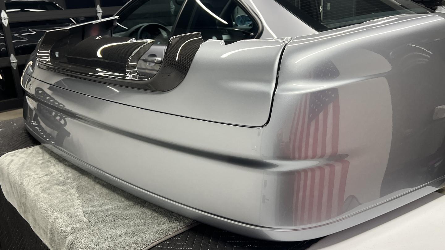

                The painting process took a lot longer than expected, but I’m really impressed with the results.
                After Monterey Car Week, Dave was able to get my car painted. If you recall, he sprayed about 10 color samples a while ago, two of which looked incredibly close. He picked the best color match and sprayed the quarter panel before painting all the accessories. Dave wanted to make sure he was happy with the color match before painting the bumpers and trim pieces.
                About a week later Dave called me and informed me the color match was not to his standard. Despite us both agreeing on the color samples being an excellent match, the color did not quite translate to a larger scale for some reason. I have so much respect for his professionalism and perfectionism. I can almost guarantee you that any other shop would have pushed the job through. Dave special ordered some large scale panel spray outs so he could test the color match at a larger scale. They mixed up a few more batches and settled on a new formula.
                Another week later, Dave called me and this time was much happier with the results. He invited me to come to the shop to see the color in person, and asked for my final approval. What I appreciate about Dave is his willingness to allow the customer to be a part of the process, ensuring that my concerns are heard, and that I am satisfied with the work being done.

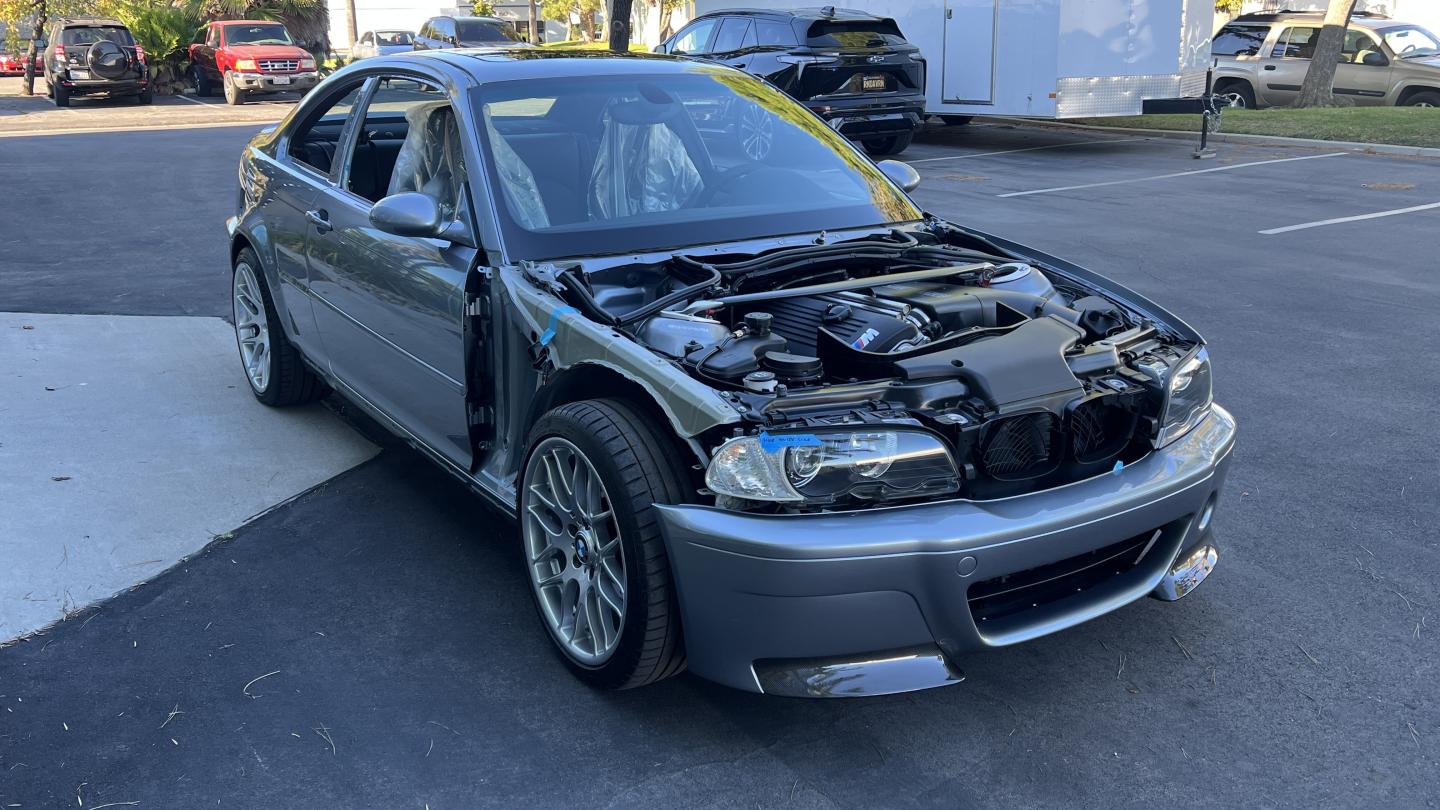

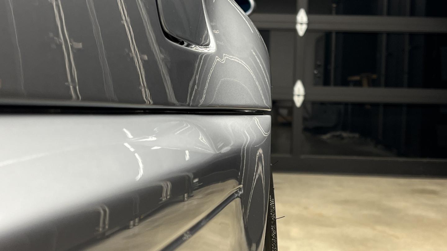

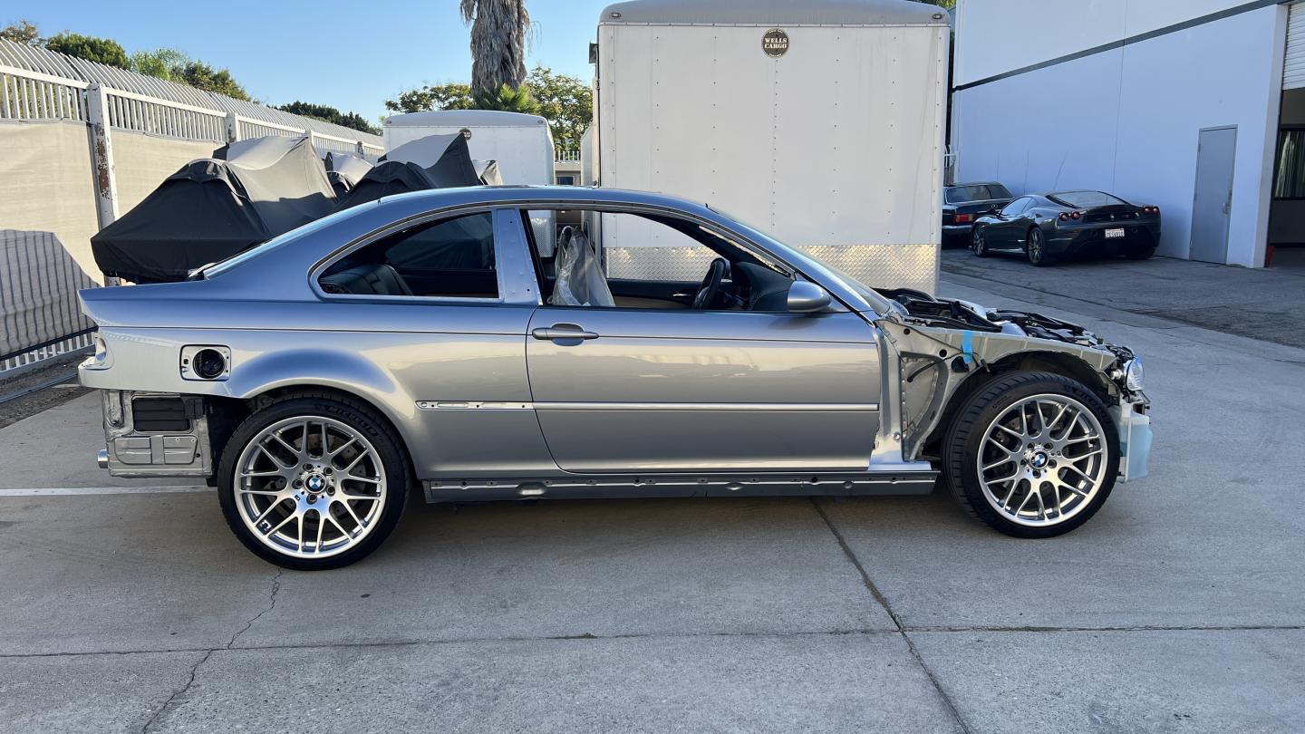

                When I arrived, the car was parked outside, and I got my first look at the paintwork. This was straight out of the paint booth. The color match was so good, and the orange peel texture was identical to factory. The most impressive part of it all? Zero body shop dust on the car, not a single spec. No over spray, no surprises, just great work.
                Click image for larger version  Name:	IMG_5216.jpg Views:	9 Size:	188.3 KB ID:	323342
                Although I always knew paintwork was difficult, I’ve gained an even deeper appreciation for this skill. There are so many variables that go into a good paint match including the manufacturer itself, mixing the colors, the amount of metallic, pressure settings and arm speed for orange peel, blending vs butt matching, etc. Doing it at a high level is kind of an art form.

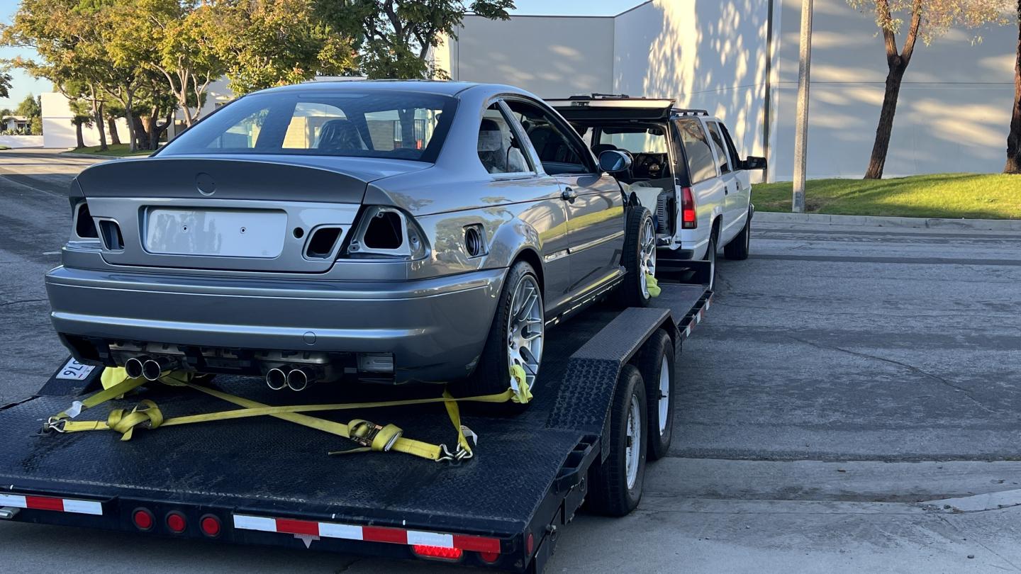

                Couple days later, the rest of the parts had been painted, and the car was ready to pick up. I got my first look at the finished result, which was stunning. My goal for the paintwork was to go from the previously repainted quarter panel’s 90-95% color match to 95-98% color match (depending on the angle). I’d say we absolutely accomplished that goal. The only way the paint match could have been any closer would be to blend in the adjoining panels, which I was not willing to do.
                Click image for larger version  Name:	IMG_5551.jpg Views:	9 Size:	190.2 KB ID:	323341
                I cautiously loaded the car up onto my neighbor’s trailer, then followed anxiously as we caravanned back home.
                Click image for larger version  Name:	IMG_5554.jpg Views:	9 Size:	206.5 KB ID:	323340
                Click image for larger version  Name:	IMG_5557.jpg Views:	8 Size:	166.9 KB ID:	323343

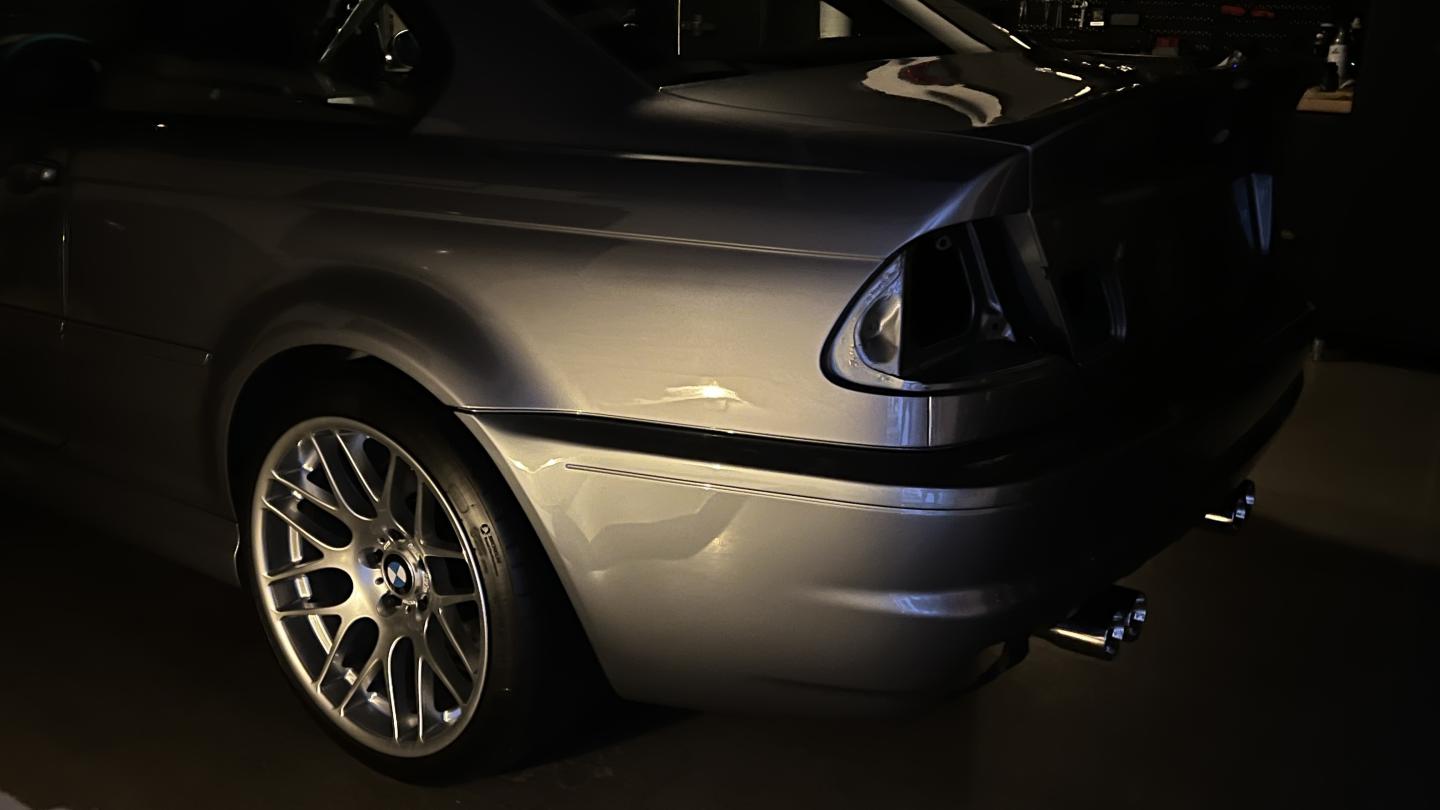

                It felt so good to have the car safe, undamaged, and back in my garage.

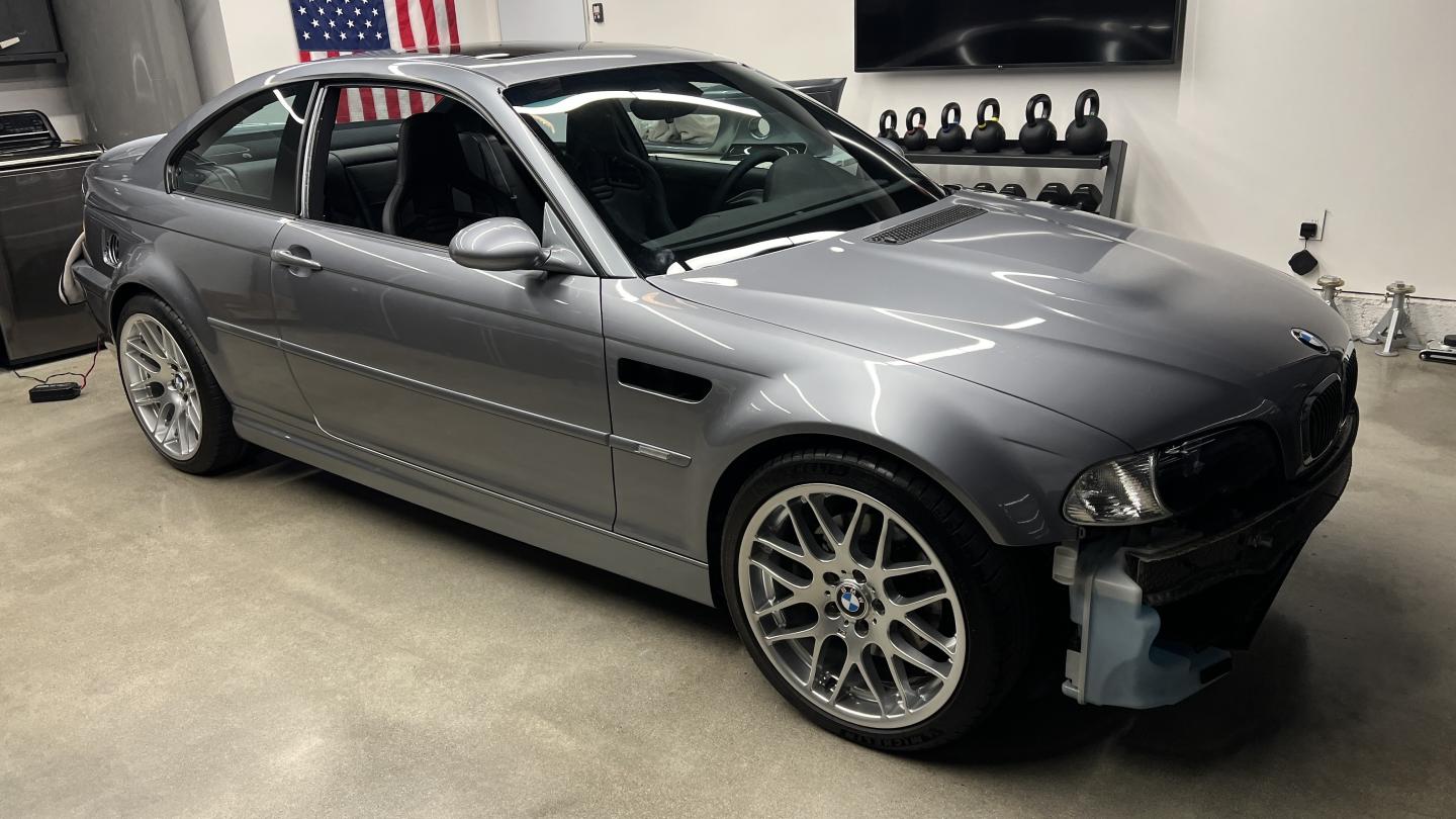

                Click image for larger version  Name:	IMG_5562.jpg Views:	8 Size:	164.4 KB ID:	323339
                Click image for larger version  Name:	IMG_5564.jpg Views:	9 Size:	110.1 KB ID:	323338
                Lights out for the night, let the rebuild begin in the morning!​
                Click image for larger version  Name:	IMG_5566.jpg Views:	8 Size:	66.8 KB ID:	323337

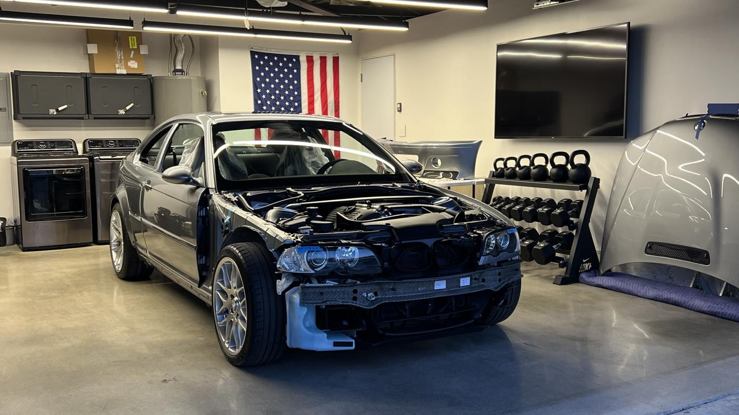

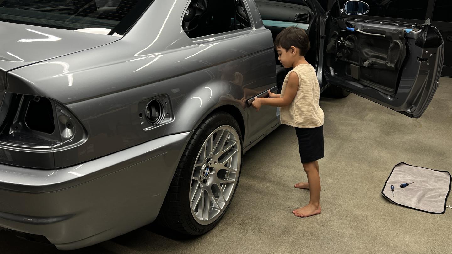

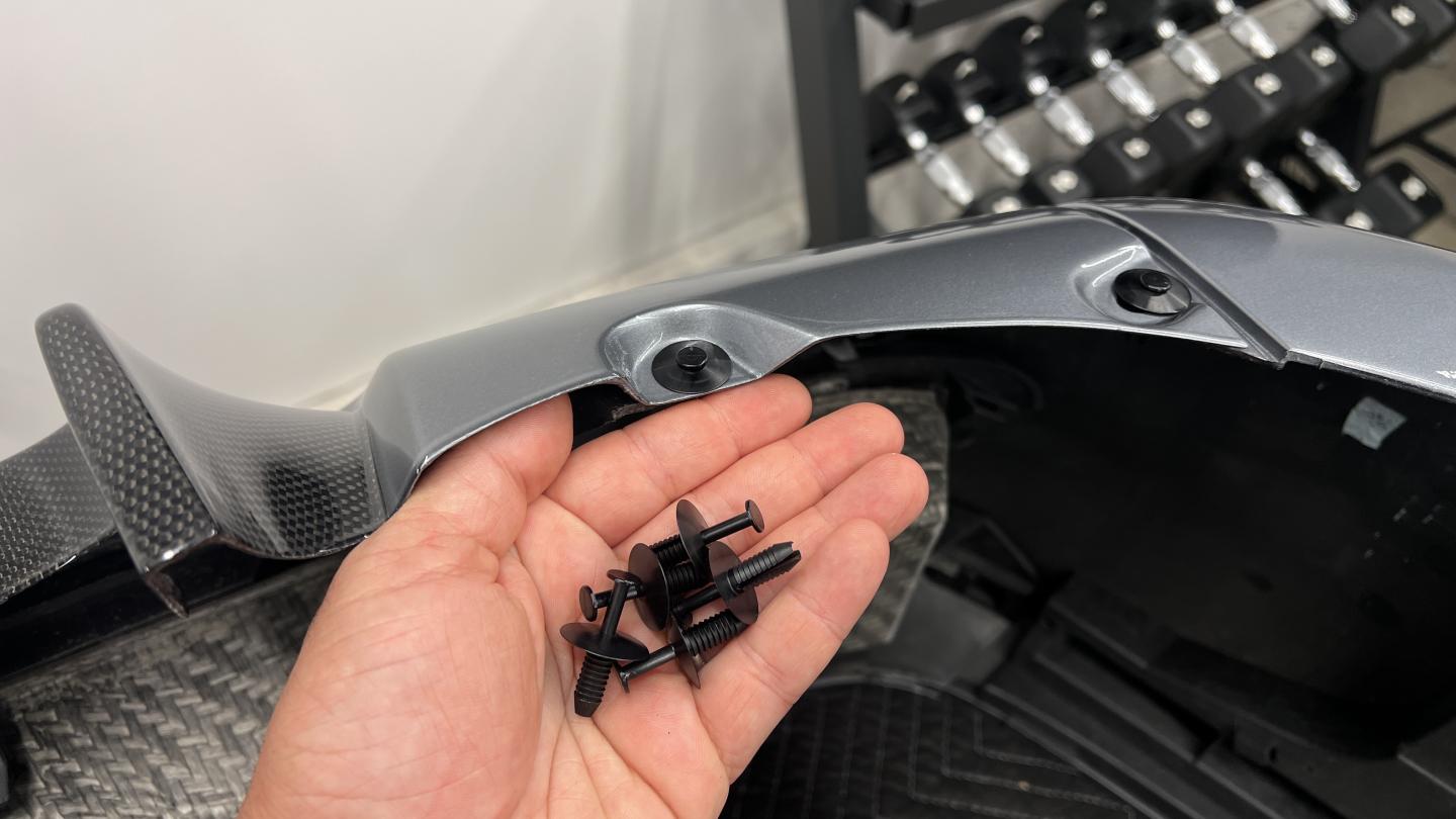

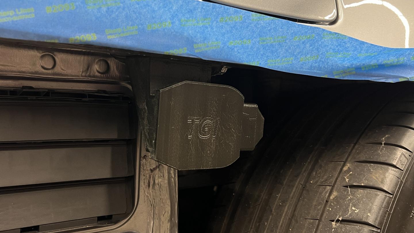

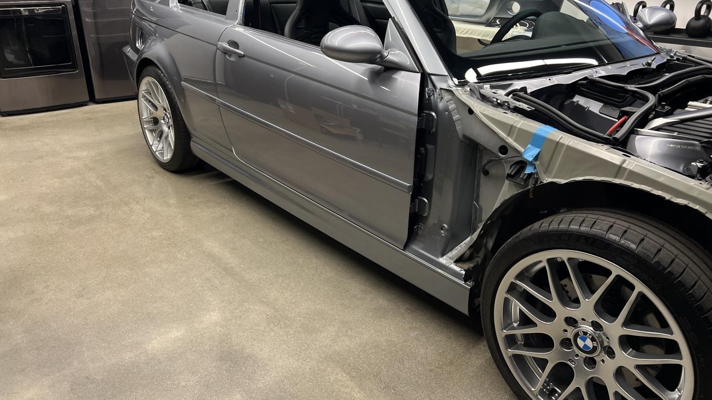

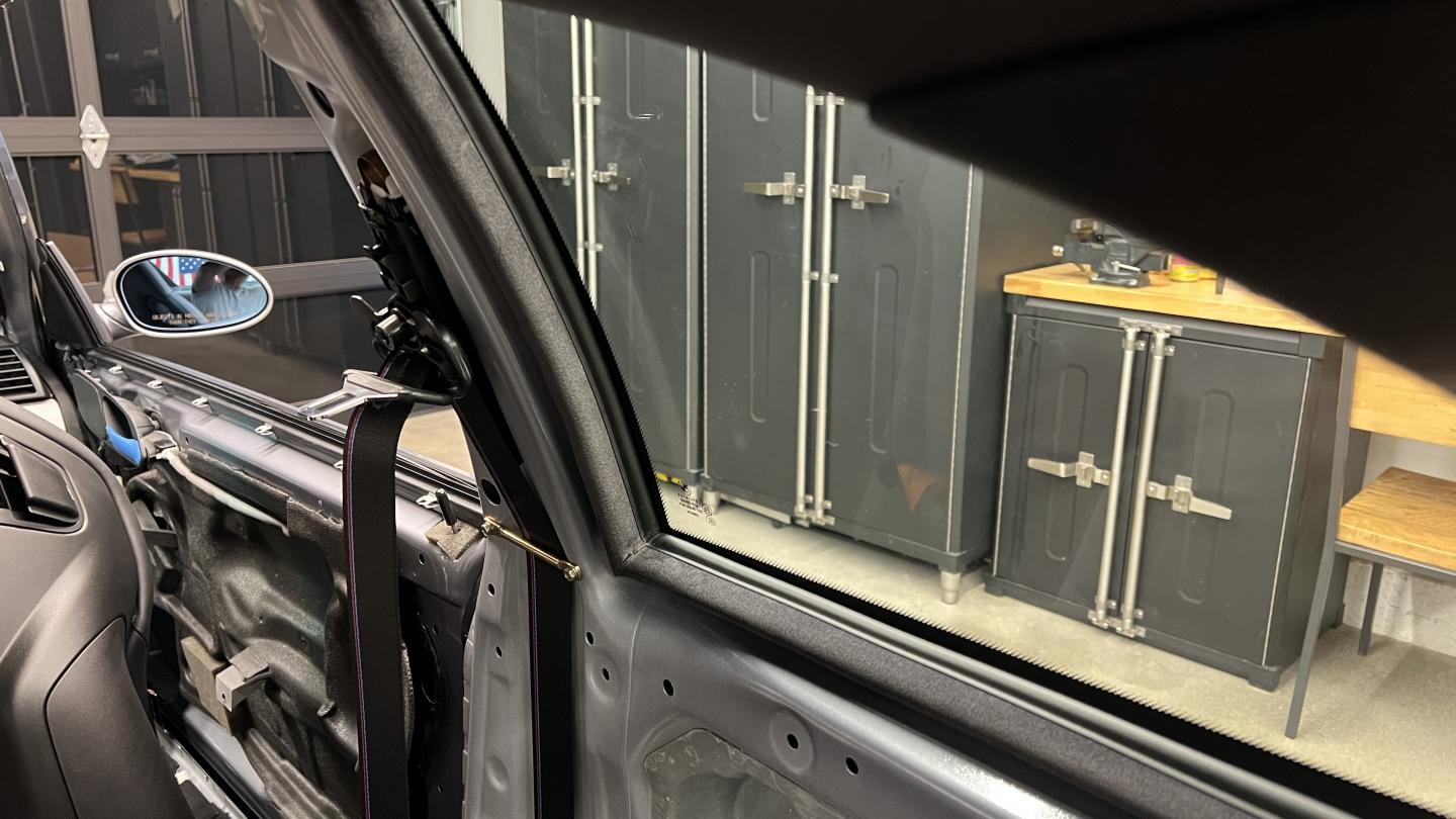

                        I had typed out an entire order of operations for the exterior rebuild so that I could stay on track and organized. Having a plan was nice, but when my son realized that “his” M3 was back in the garage, he couldn’t wait to work on it.
                        We went out to the garage and took on all the easy tasks. The order that we were doing things made absolutely no sense, but it really wasn’t about being efficient. I know these are memories are something I’ll hold onto forever, and I was happy to just be present, productive, and bonding with my son. It’s been really fun to see his understanding and passion for cars grow as he has gotten older.
                        Click image for larger version  Name:	IMG_5570.jpg Views:	0 Size:	193.6 KB ID:	323408
                        Click image for larger version  Name:	IMG_5572.jpg Views:	4 Size:	146.7 KB ID:	323397
                        Click image for larger version  Name:	IMG_5573.jpg Views:	0 Size:	112.9 KB ID:	323394
                        Click image for larger version  Name:	IMG_5579.jpg Views:	0 Size:	144.4 KB ID:	323403
                        After he got sick of working on the car, I stayed on the passenger side of the car and kept reassembling. All new hardware went into the body and onto the side skirt, then side skirt was reattached.
                        Click image for larger version  Name:	IMG_5580.jpg Views:	4 Size:	96.9 KB ID:	323395
                        Click image for larger version  Name:	IMG_5583.jpg Views:	0 Size:	181.4 KB ID:	323407
                        New lower window trim went down, then I reinstalled the shadow line trim, window gasket, window, b-pillar, and reattached the seatbelt.

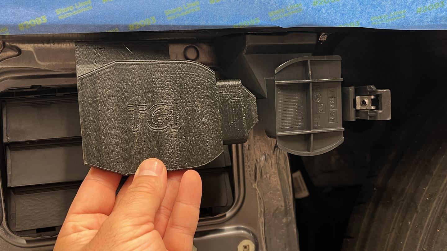

                        I then detoured and took full advantage of having my neighbor home for the day. I used his extra set of hands to install the hood and passenger side fender.
                        Click image for larger version  Name:	IMG_5593.jpg Views:	0 Size:	147.3 KB ID:	323401

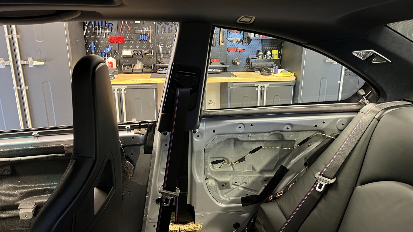

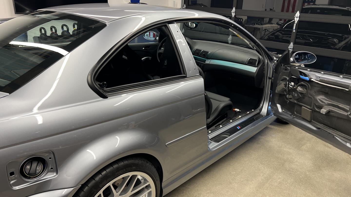

                        I went back to the passenger side and installed the rubber door sill, plastic lower kick plate, rear door panel, rear bench and front door panel. Really good progress for a single day, i'll keep this thread updated as I continue the exterior rebuild.
                        Click image for larger version  Name:	IMG_5595.jpg Views:	0 Size:	180.8 KB ID:	323406
                        Click image for larger version  Name:	IMG_5596.jpg Views:	0 Size:	151.2 KB ID:	323400
                        Click image for larger version  Name:	IMG_5597.jpg Views:	0 Size:	150.3 KB ID:	323396

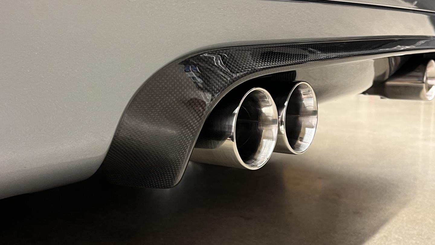

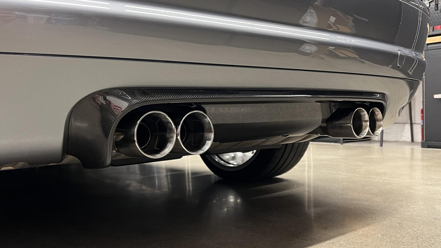

                          Picking up where I left off, the passenger side of the car. The fuel door went back in, and it was kind of a pain in the butt. I should have paid more attention when doing the disassembly, because I struggled through the reassembly of the fuel door area more than I should have. There a lot of accessory parts and little tricks to get everything back together just right. It doesn’t help that the hand space to work is really tight. You can tell I’m paranoid about damaging anything during this rebuild.
                          Click image for larger version  Name:	IMG_5599.jpg Views:	0 Size:	143.9 KB ID:	323459
                          Click image for larger version  Name:	IMG_5600.jpg Views:	0 Size:	91.9 KB ID:	323456
                          Click image for larger version  Name:	IMG_5602.jpg Views:	0 Size:	102.8 KB ID:	323461
                          Click image for larger version  Name:	IMG_5601.jpg Views:	0 Size:	138.8 KB ID:	323457
                          Click image for larger version  Name:	IMG_5638.jpg Views:	0 Size:	133.5 KB ID:	323460
                          Click image for larger version  Name:	IMG_5641.jpg Views:	0 Size:	120.5 KB ID:	323458

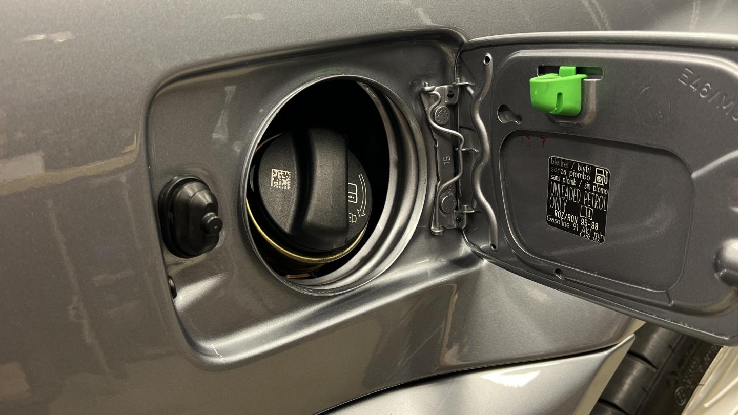

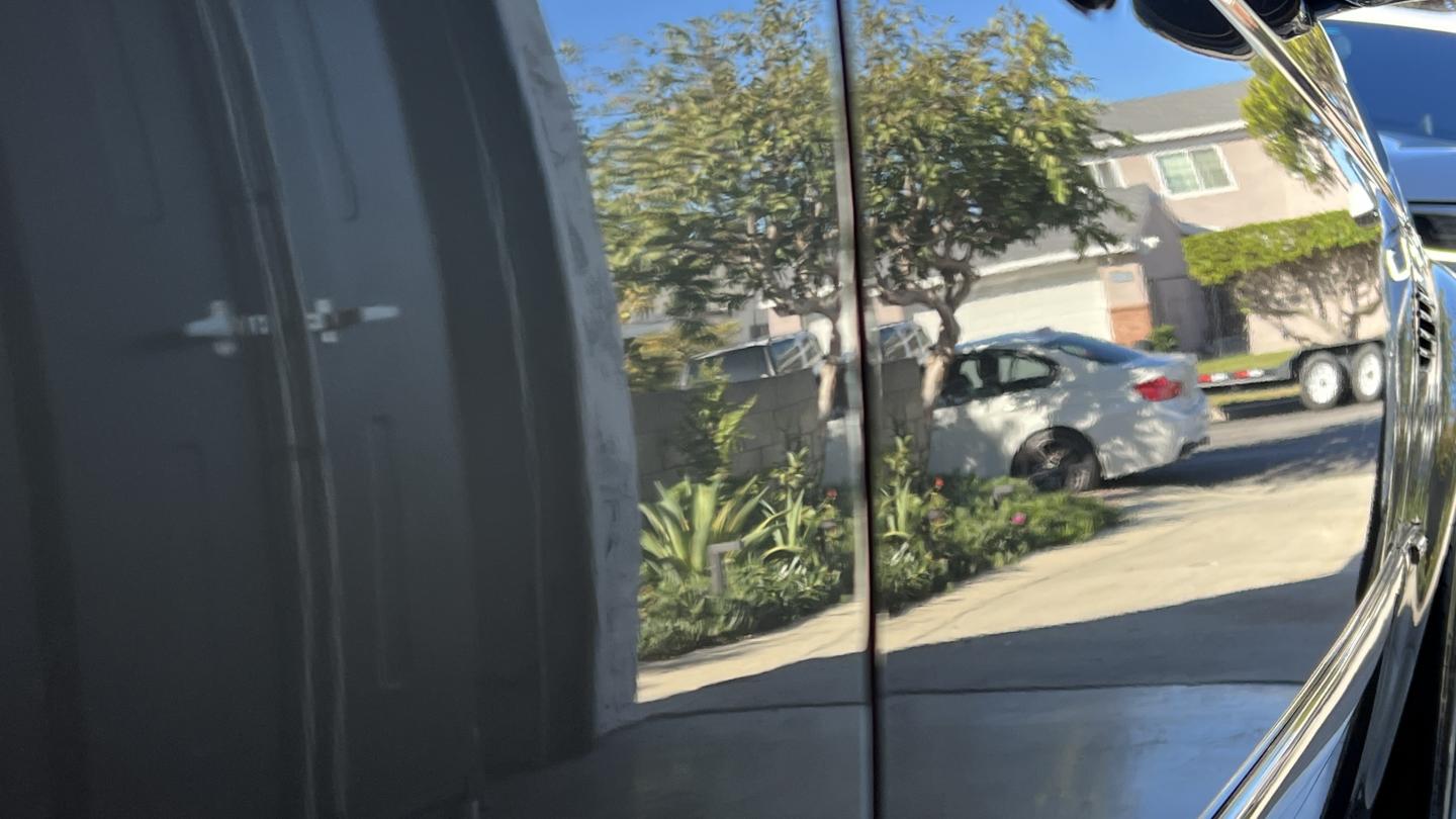

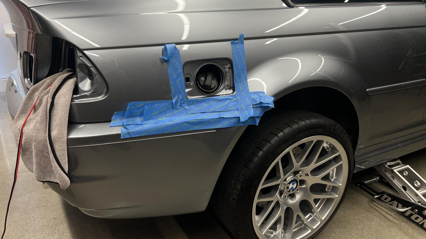

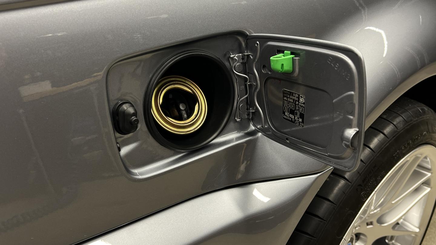

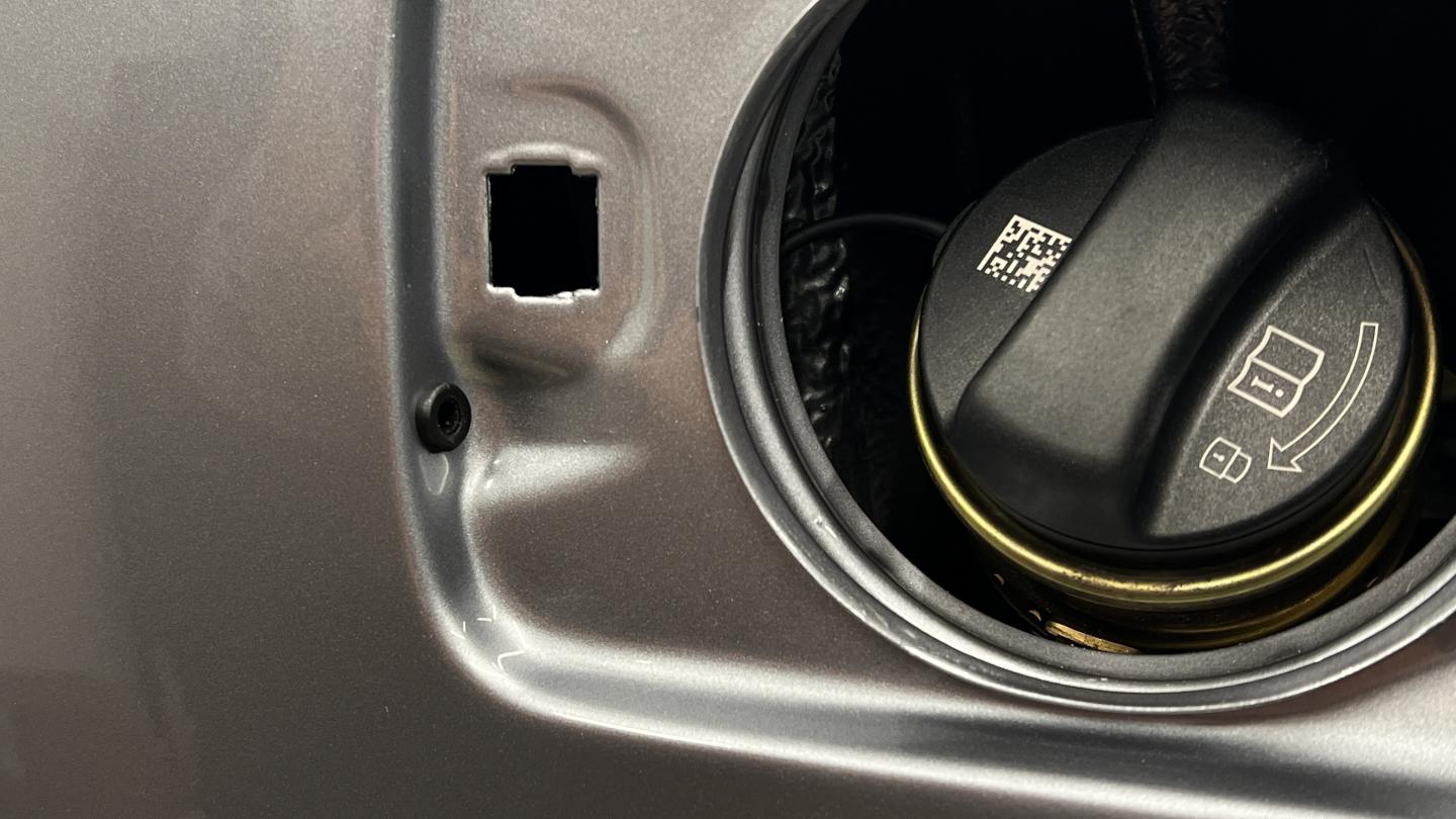

                          While working on the fuel door, I couldn’t help but notice and appreciate just how accurate the orange peel on the new paint was vs the factory texture.
                          Click image for larger version  Name:	IMG_5639.jpg Views:	0 Size:	116.9 KB ID:	323462

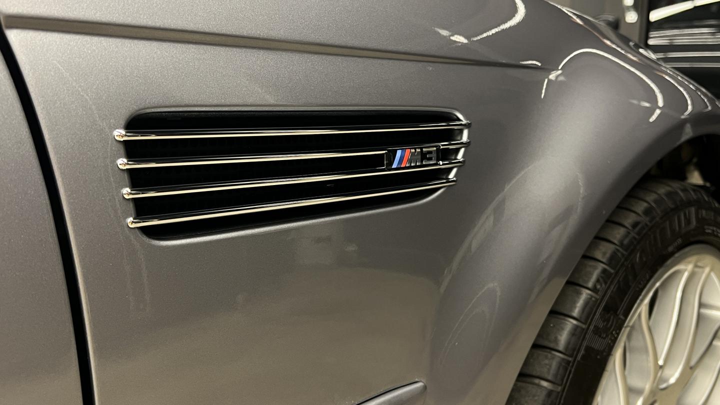

                          In order to complete the passenger side fender, I needed to ceramic coat/install new side grills and side marker lights. First the side grills.

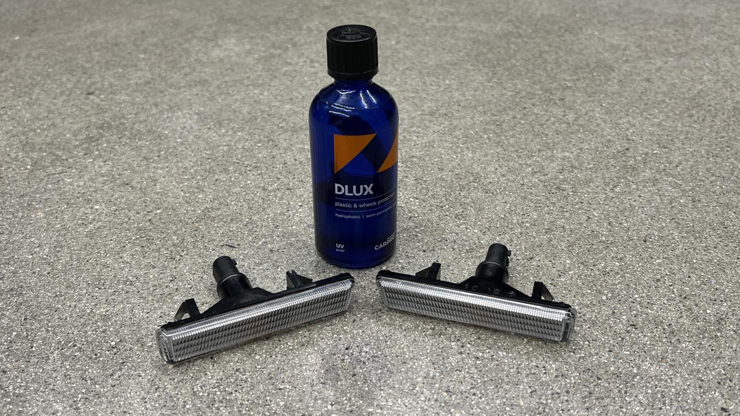

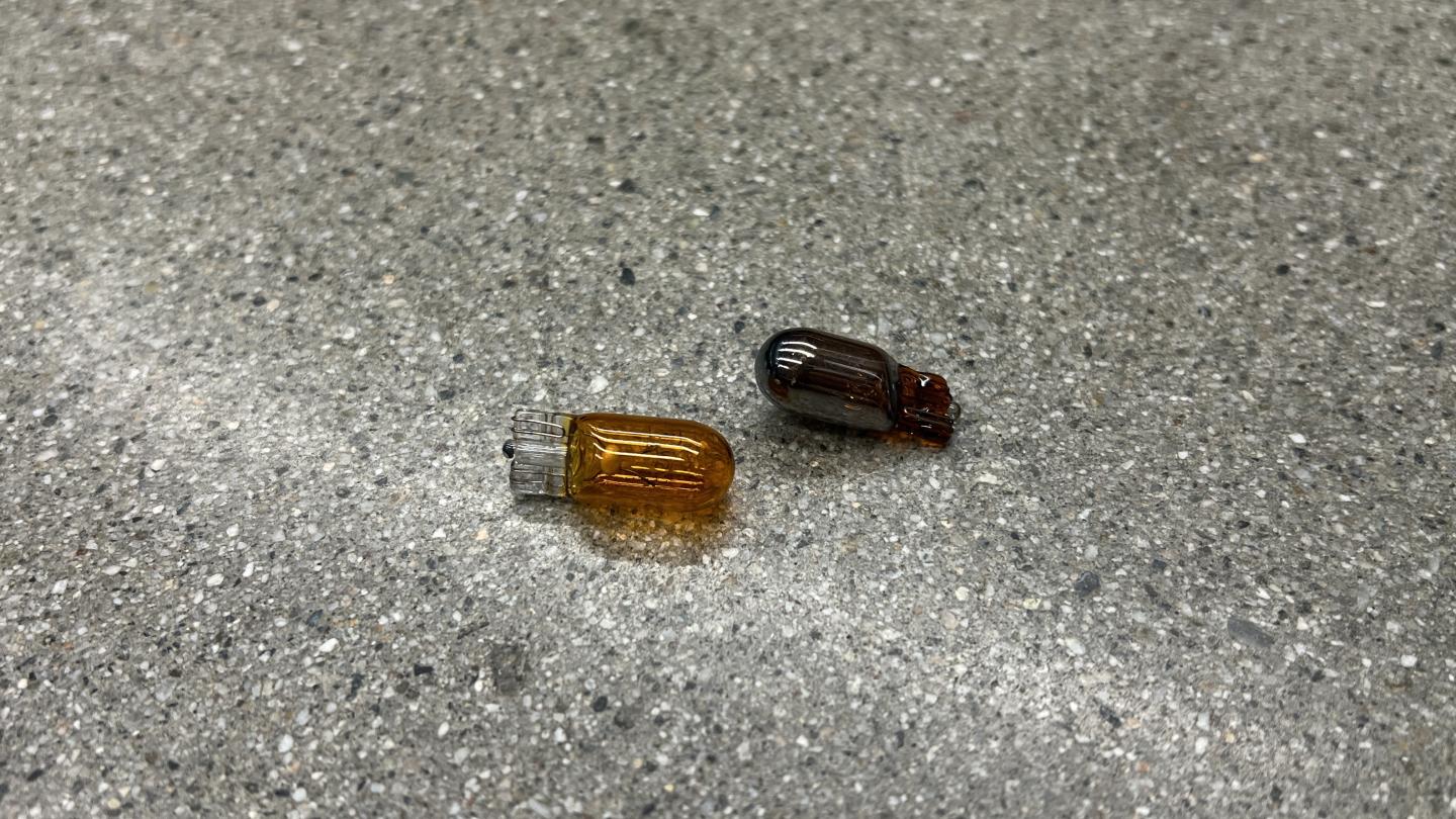

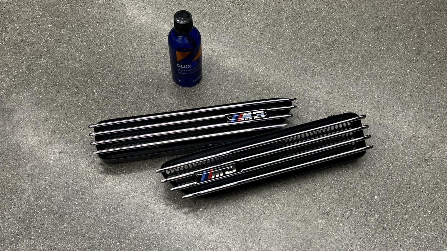

                          Next, the side marker lights. After the ceramic coating, I installed some stealth bulbs, then reinstalled the side marker lights into the fender. I should note that both the driver side and passenger side got the same parts/treatment, I just didn’t take photos of the other side.
                          Click image for larger version  Name:	IMG_5634.jpg Views:	0 Size:	272.8 KB ID:	323468
                          Click image for larger version  Name:	IMG_5635.jpg Views:	0 Size:	244.9 KB ID:	323467
                          Click image for larger version  Name:	IMG_5636.jpg Views:	0 Size:	140.6 KB ID:	323465
                          Click image for larger version  Name:	IMG_5637.jpg Views:	0 Size:	124.5 KB ID:	323466

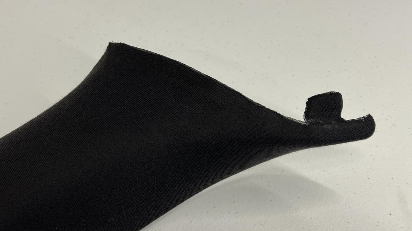

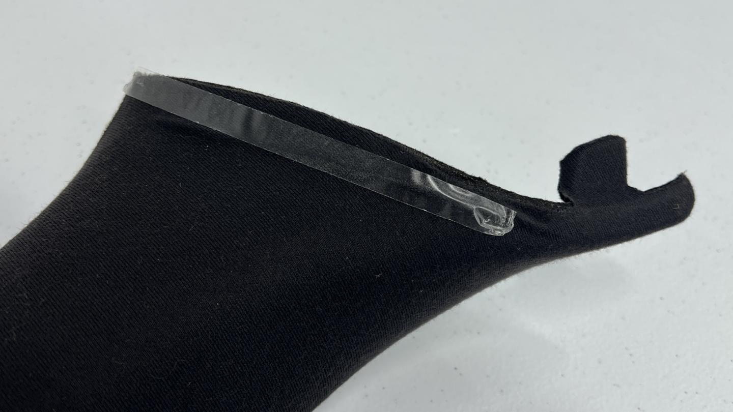

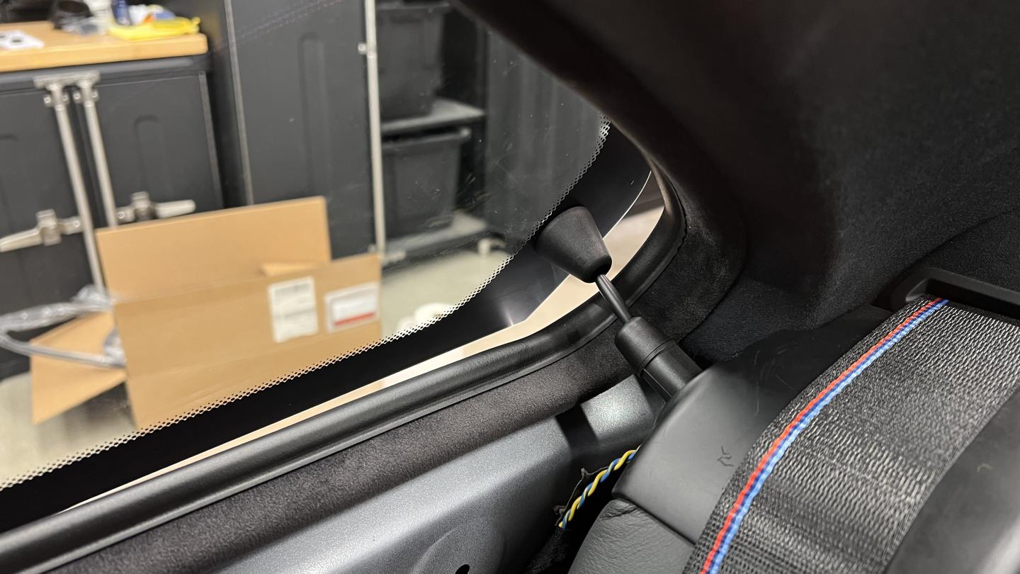

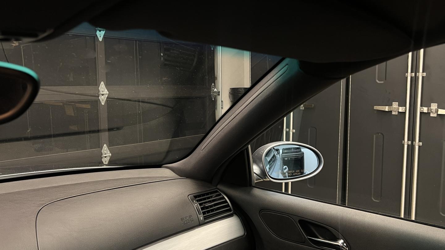

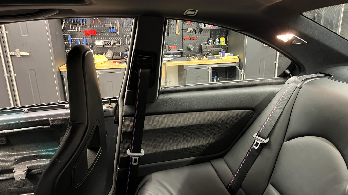

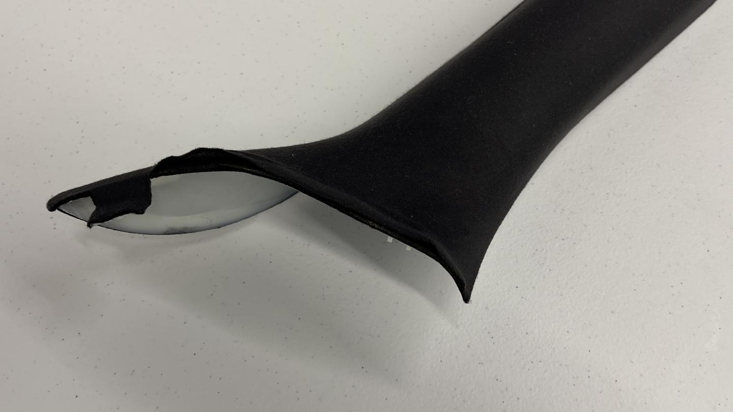

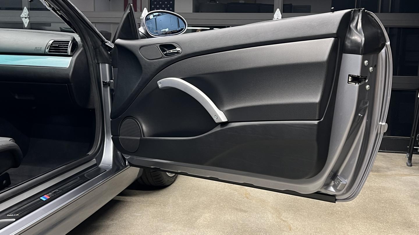

                          I moved onto the last missing interior piece, the a-pillar. The pillar had the common issue where the bottom 1/2 inch of fabric delaminates and bunches up. Fortunately, the fix was really simple. Fold the fabric back, mask the pillar, apply adhesive, tac dry, then affix the fabric.
                          Click image for larger version  Name:	IMG_5642.jpg Views:	0 Size:	68.4 KB ID:	323470
                          Click image for larger version  Name:	IMG_5643.jpg Views:	0 Size:	106.1 KB ID:	323473
                          Click image for larger version  Name:	IMG_5644.jpg Views:	0 Size:	88.3 KB ID:	323469
                          Click image for larger version  Name:	IMG_5645.jpg Views:	0 Size:	141.1 KB ID:	323474
                          Click image for larger version  Name:	IMG_5646.jpg Views:	0 Size:	97.0 KB ID:	323471
                          After the fix, the a-pillar was reinstalled. Not much to document on this one, the install is pretty straight forward. That’s all for today. I’ll chip away during my work week and report back in a week or so. Click image for larger version  Name:	IMG_5650.jpg Views:	0 Size:	114.4 KB ID:	323472

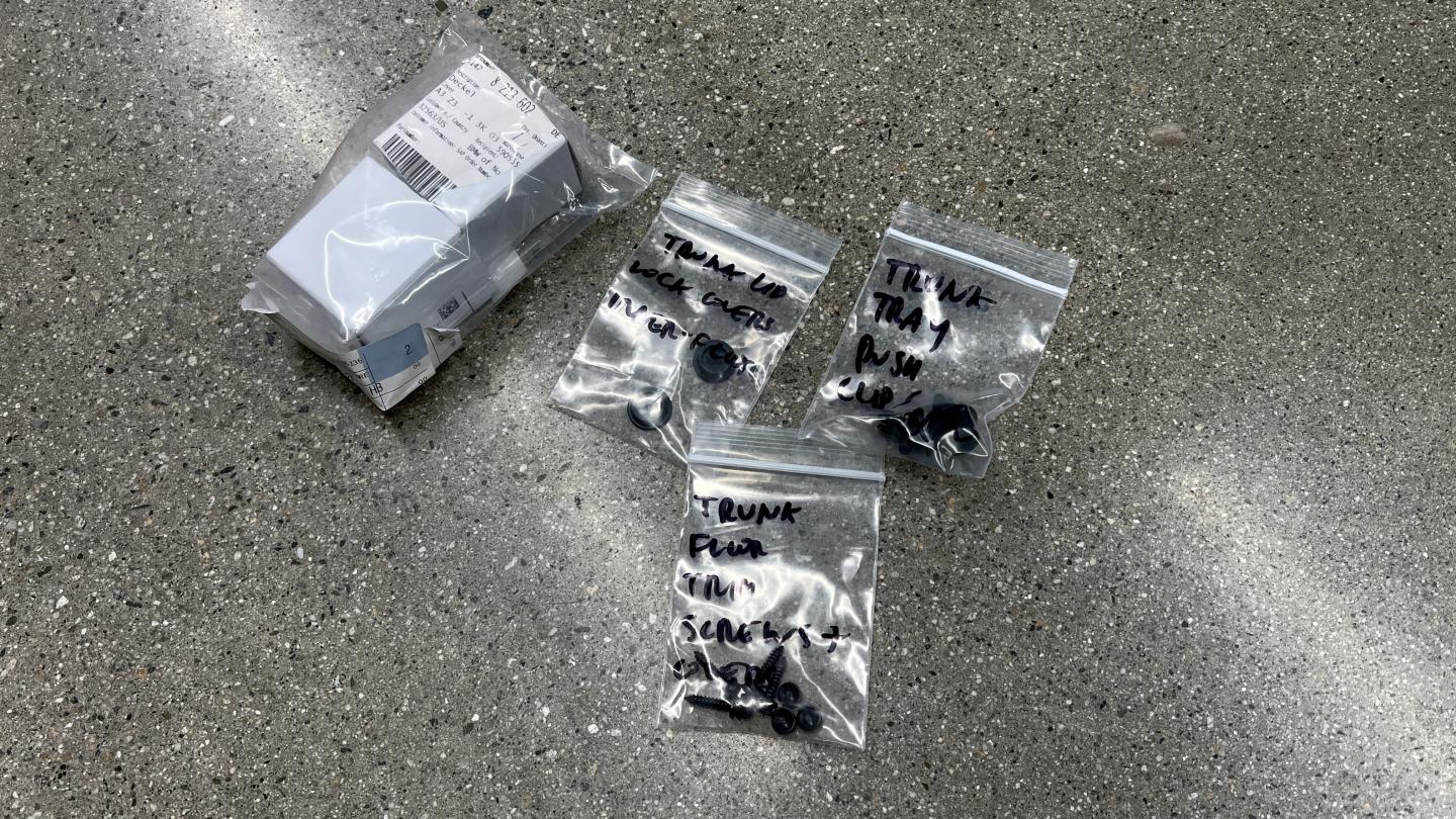

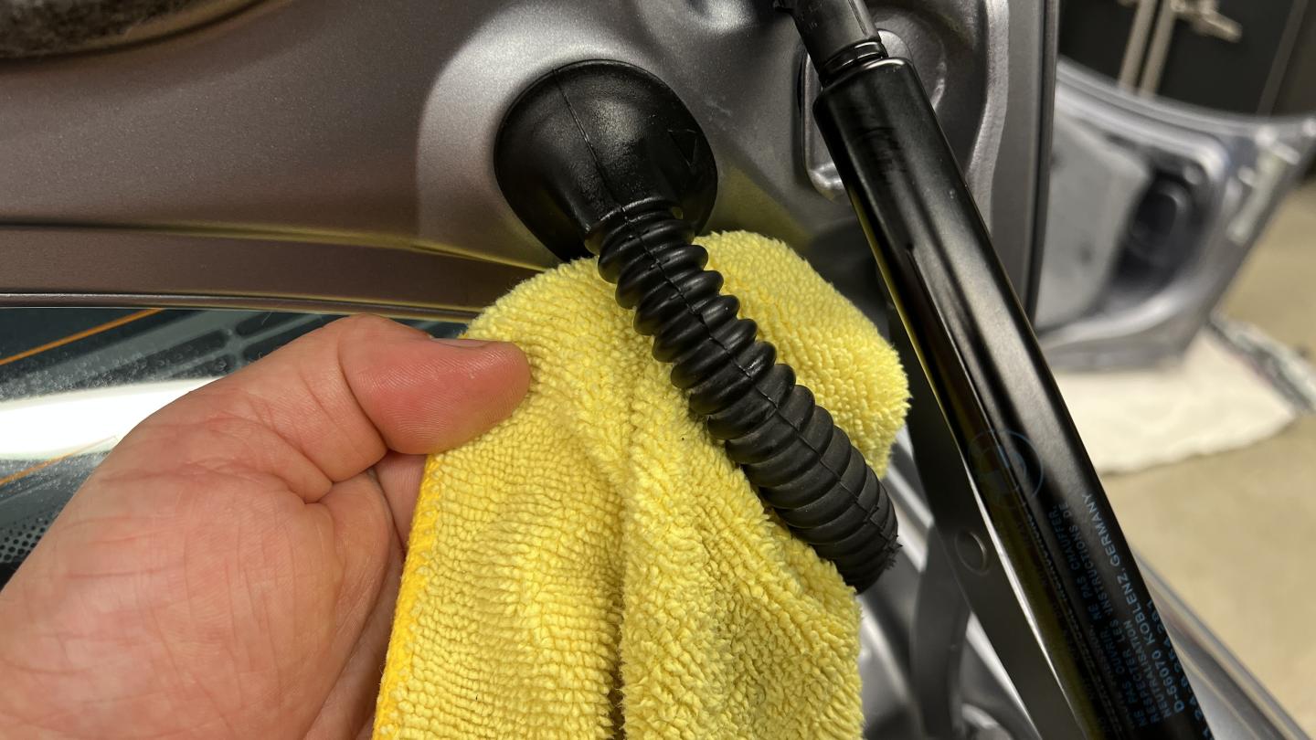

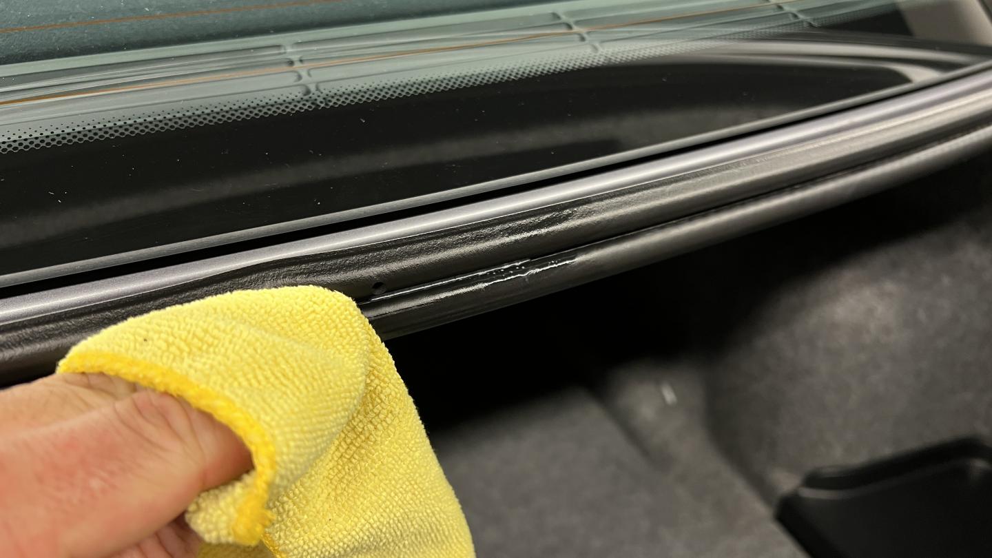

                            I ran the wiring loom back into the trunk prior to the inner taillights being installed. This way I had maximum hand space to work while installing the trunk lock mechanism. I taped the loom to a wire hanger, then pushed the loom up the channel and back into the trunk.
                            Click image for larger version  Name:	IMG_5699.jpg Views:	70 Size:	148.8 KB ID:	324111 Click image for larger version  Name:	IMG_5701.jpg Views:	67 Size:	161.1 KB ID:	324110
                            The lock gasket was installed, then the lock mechanism itself. I never noticed that the CSL didn’t have the emergency trunk release (from the inside of the trunk). I initially installed it onto the lock mechanism, but ended up deleting it after I realized it had nowhere to run to.

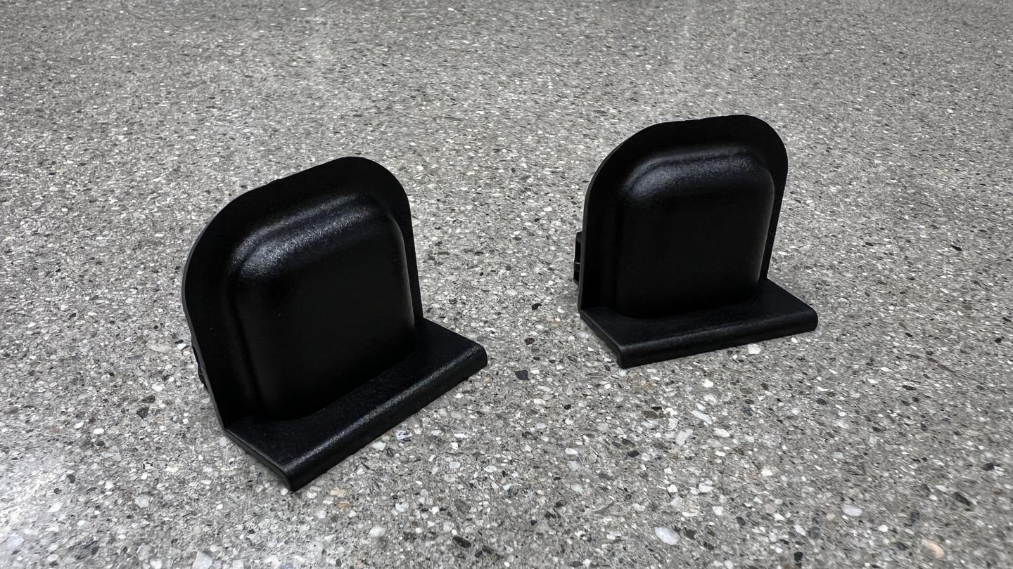

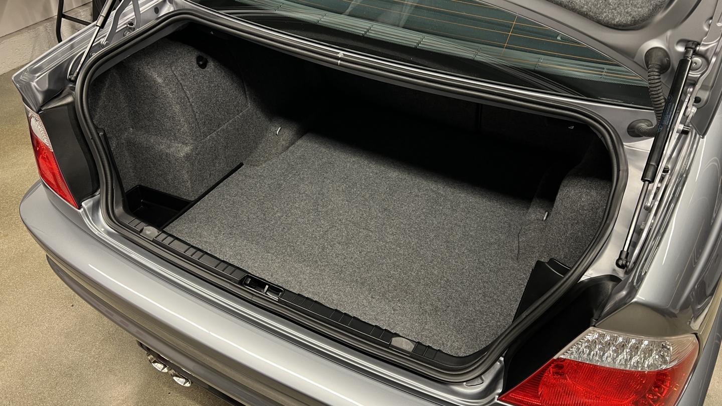

                            I then installed new rubber hinge caps, rubber stop buffers and fresh genuine BMW struts.
                            Click image for larger version  Name:	IMG_5720.jpg Views:	68 Size:	102.4 KB ID:	324118
                            Click image for larger version  Name:	IMG_5722.jpg Views:	72 Size:	152.8 KB ID:	324119

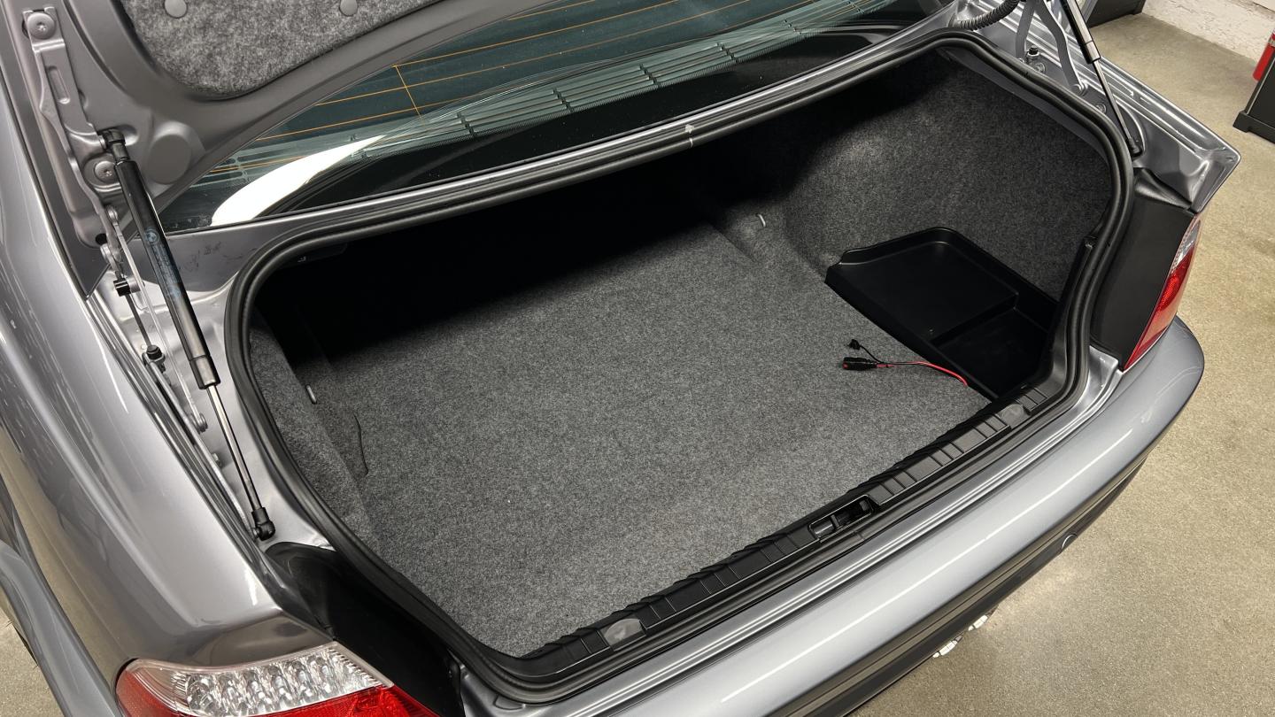

                            Next up, the license plate lights. When I purchased the CSL trunk, it came pre-wired for LED license plate lights. That said, the wiring was done poorly. I took the whole wiring harness apart and rewired/insulated it properly. Then the wiring harness went into the trunk, and staged for the lights themselves.

                            Once it was wired, I installed the roundel grommets and license plate grommets. The license plate lights needed a little work to fit. The opening on hook that clips into the trunk is slightly too narrow and protrudes slightly too far to clip into the trunk. I peeled back the foam gasket and filed the hook portion (not pictured). Afterward, they fit snugly into the opening.

                            The final piece of this project was the CSL specific inner trunk liner. I waited until everything was installed and tested for functionality. I attempted to install it but the fitment out of the box was seriously bad. The section closest to the rear bumper (with the trunk in the closed position) was far too wide. It was so wide that it prevented the liner from sitting flush with the trunk, meaning the expanding rivets that hold the two together would not go in. The fix was to cut about 1/4inch off of the bottom section so that it would sit flush. After I got it to sit flush, I could see that nearly every hole for the expanding rivet was either too small, or slightly off. You can see in the photo that there was one hole that wasn’t even drilled out during manufacturing! I used a drill bit to bore the holes out as necessary.
                            Click image for larger version  Name:	IMG_5732.jpg Views:	71 Size:	263.8 KB ID:	324128
                            Click image for larger version  Name:	IMG_5735.jpg Views:	70 Size:	155.7 KB ID:	324127
                            Nothing about this project was really difficult, just a lot of components. Once I started building it out, everything fell into place pretty intuitively. The trunk alignment still needs a few more micro adjustments, but the fit is 90% there.
                            Click image for larger version  Name:	IMG_5731.jpg Views:	73 Size:	170.3 KB ID:	324129

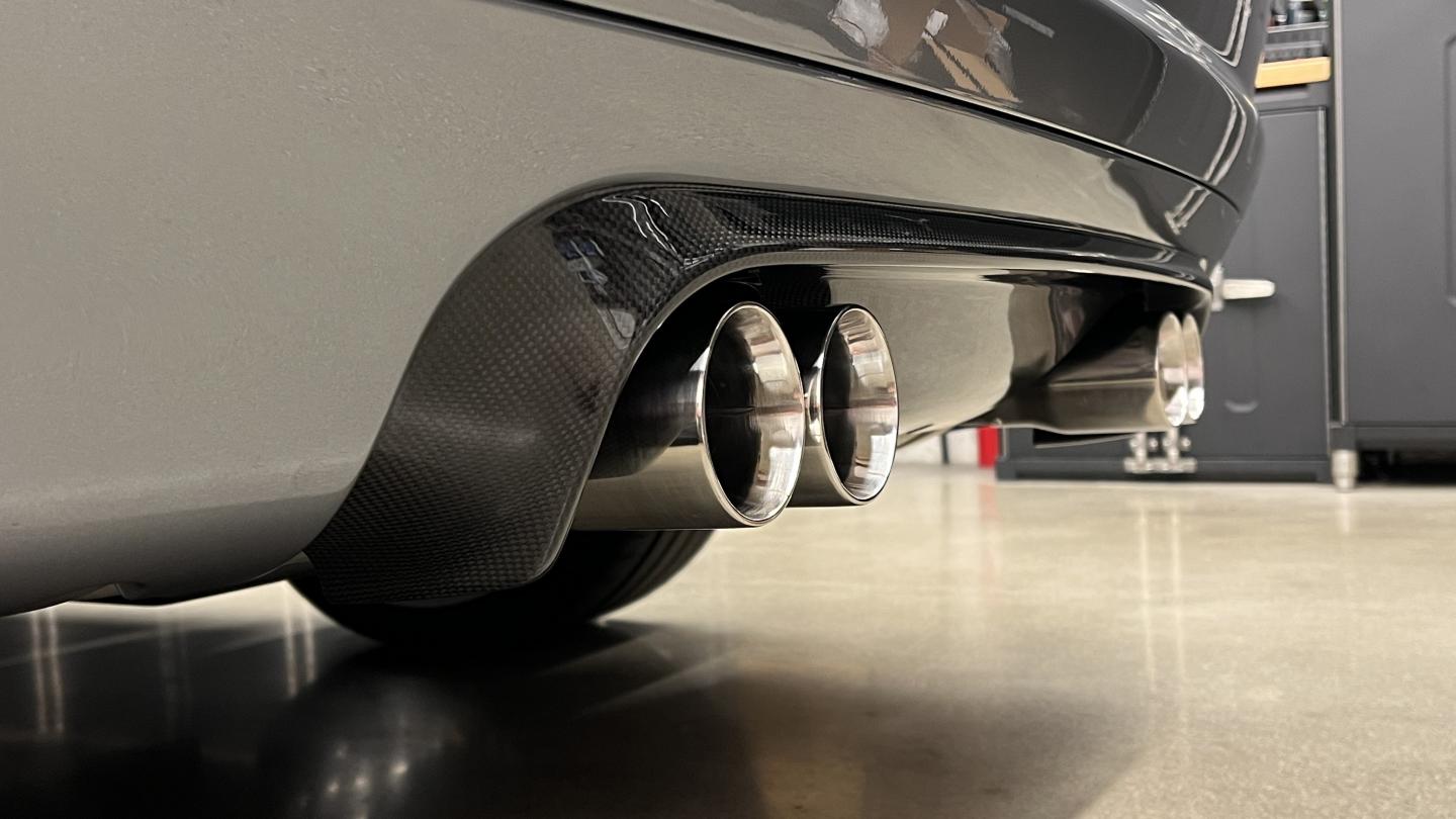

                              Made some great progress on the rear today. The car is starting to look like an actual rolling and functioning machine again.

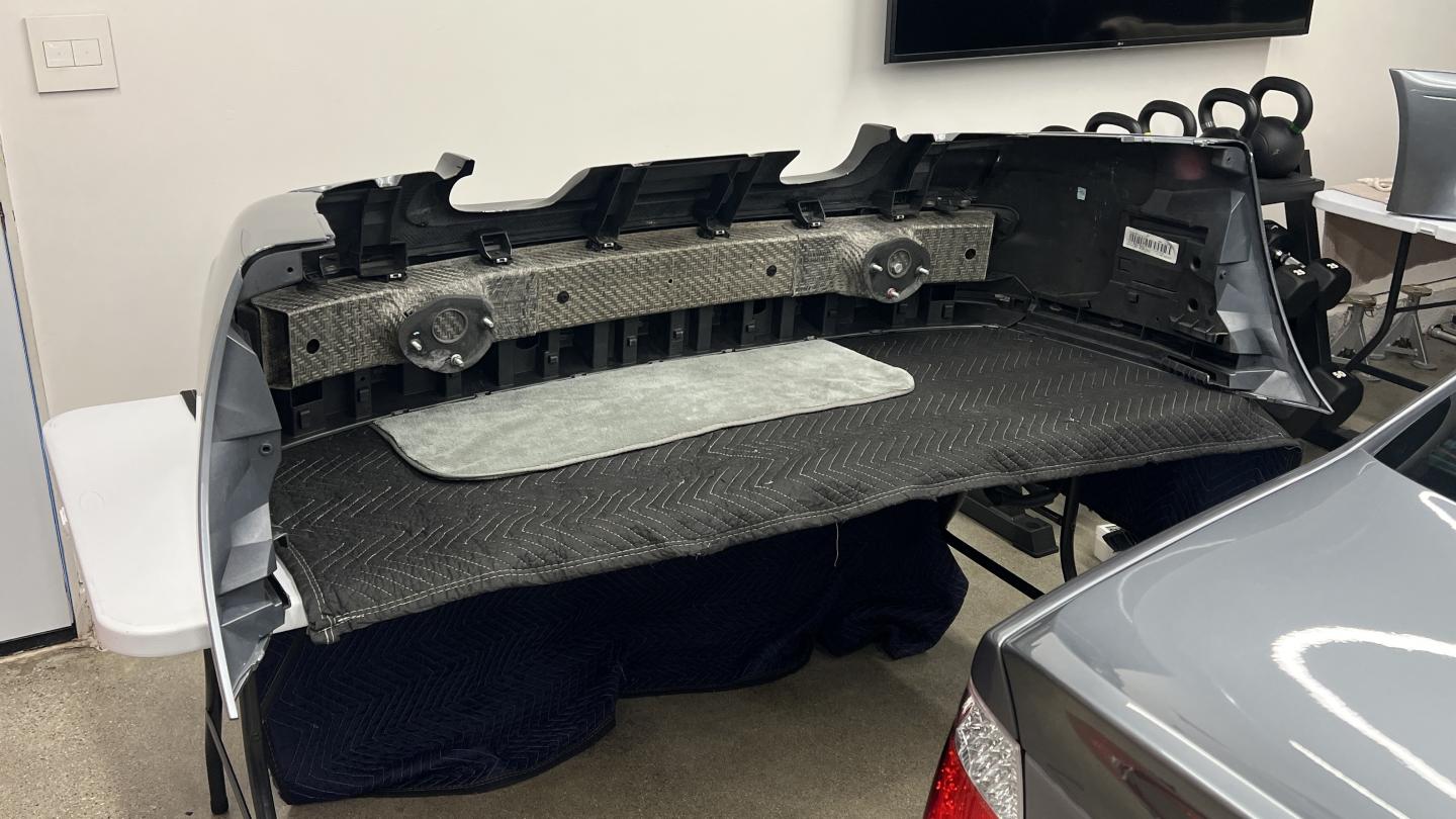

                              First, I pulled off the rear bumper and installed the diffuser. I did this while the bumper was resting on a table. It just made things so much easier to see. After it was secured with new hardware, I snapped a couple of beauty shots.
                              Click image for larger version  Name:	IMG_5768.jpg Views:	0 Size:	148.5 KB ID:	324291
                              Click image for larger version  Name:	IMG_5769.jpg Views:	0 Size:	127.9 KB ID:	324290
                              Click image for larger version  Name:	IMG_5771.jpg Views:	0 Size:	177.8 KB ID:	324293
                              Click image for larger version  Name:	IMG_5772.jpg Views:	0 Size:	95.7 KB ID:	324292
                              Next up was the Trinity Graphics rear bumper mounts. They are not only significantly beefier, but the mounting holes are extended so that you can get a huge amount of adjustment.
                              Click image for larger version  Name:	IMG_5774.jpg Views:	0 Size:	154.0 KB ID:	324295
                              Click image for larger version  Name:	IMG_5775.jpg Views:	0 Size:	131.6 KB ID:	324294
                              I got some more help from my neighbor and installed the rear bumper onto the new mounts. We put the adjustability feature to work, taking the rear bumper off no less than 15 times, each time making a micro adjustment. In the end it was worth it, I was able to get the rear bumper aligned with the quarter panel with millimetric precision. Although the alignment was done, I still need to install the clips that close the gap between the rear bumper and rear quarter panel. This will happen when all of the wheel well liners go back on.
                              Click image for larger version  Name:	IMG_5776.jpg Views:	0 Size:	157.6 KB ID:	324296
                              Click image for larger version  Name:	IMG_5780.jpg Views:	0 Size:	78.7 KB ID:	324297
                              Really glad I went with my gut on these exhaust tips. They pair so nicely with the CSL diffuser.
                              Click image for larger version  Name:	IMG_5777.jpg Views:	0 Size:	113.4 KB ID:	324299
                              Click image for larger version  Name:	IMG_5778.jpg Views:	0 Size:	100.3 KB ID:	324298
                              Click image for larger version  Name:	IMG_5779.jpg Views:	0 Size:	105.2 KB ID:	324300

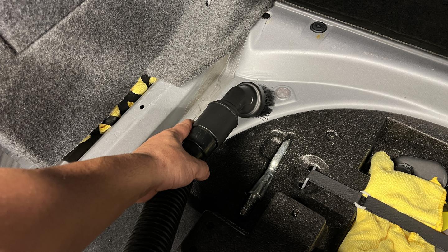

                              With the rear bumper mounted and secured, I installed all of the trim pieces in the trunk. It was probably the least sexy job so far, and therefore, not many photos were taken. I gave the trunk compartment a quick vacuum, then put everything back together with many overpriced genuine BMW fasteners.
                              Click image for larger version  Name:	IMG_5783.jpg Views:	0 Size:	206.8 KB ID:	324301
                              Click image for larger version  Name:	IMG_5781.jpg Views:	0 Size:	349.4 KB ID:	324305
                              Click image for larger version  Name:	IMG_5782.jpg Views:	0 Size:	289.1 KB ID:	324302
                              Click image for larger version  Name:	IMG_5784.jpg Views:	0 Size:	228.2 KB ID:	324303
                              Click image for larger version  Name:	IMG_5785.jpg Views:	0 Size:	211.1 KB ID:	324304
                              Lastly, I conditioned all the rubber components, which were in need of some good hydration.
                              ​ Click image for larger version  Name:	IMG_5786.jpg Views:	0 Size:	114.7 KB ID:	324306
                              Click image for larger version  Name:	IMG_5787.jpg Views:	0 Size:	137.9 KB ID:	324307
