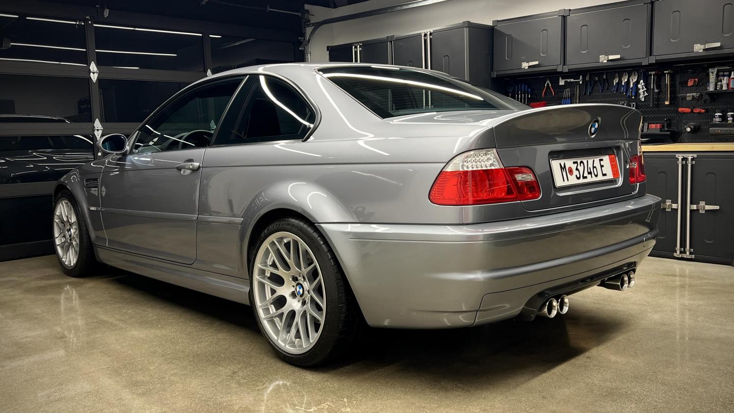

Immaculate low mileage 2004 Silver Grey CSL Inspired Build
    Man this is turning out excellent looking. Almost exactly what I'd like to do with mine.
    Looking forward to watching the rest of the progress!
      Love that you're knocking out these updates this week. Keep them coming! I hope the front bumper is next 😀

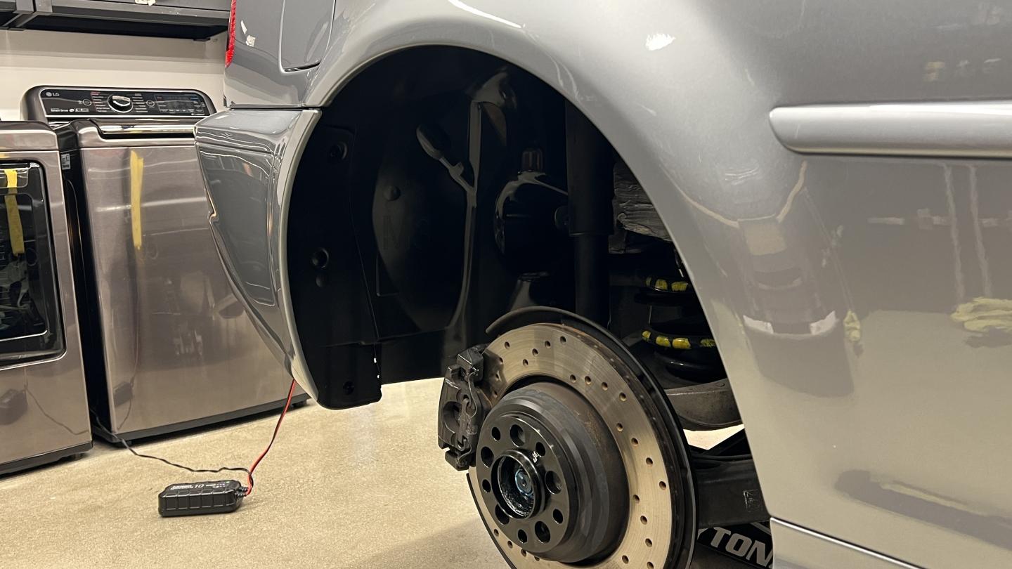

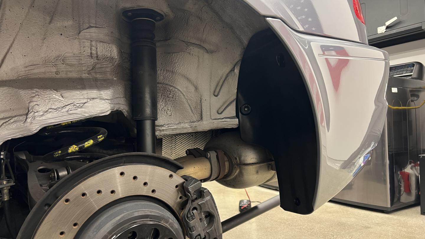

            After the meet, I was feeling inspired to finish my M3. I knew I wouldn’t finish the whole rebuild that day, but I could at least continue to chip away at it. I jacked up the rear end, removed the wheels, then reinstalled all the plastic wheel well liners with new hardware.
            Click image for larger version  Name:	IMG_5884.jpg Views:	0 Size:	161.9 KB ID:	325184
            Click image for larger version  Name:	IMG_5886.jpg Views:	0 Size:	126.7 KB ID:	325182
            Click image for larger version  Name:	IMG_5885.jpg Views:	0 Size:	153.5 KB ID:	325183

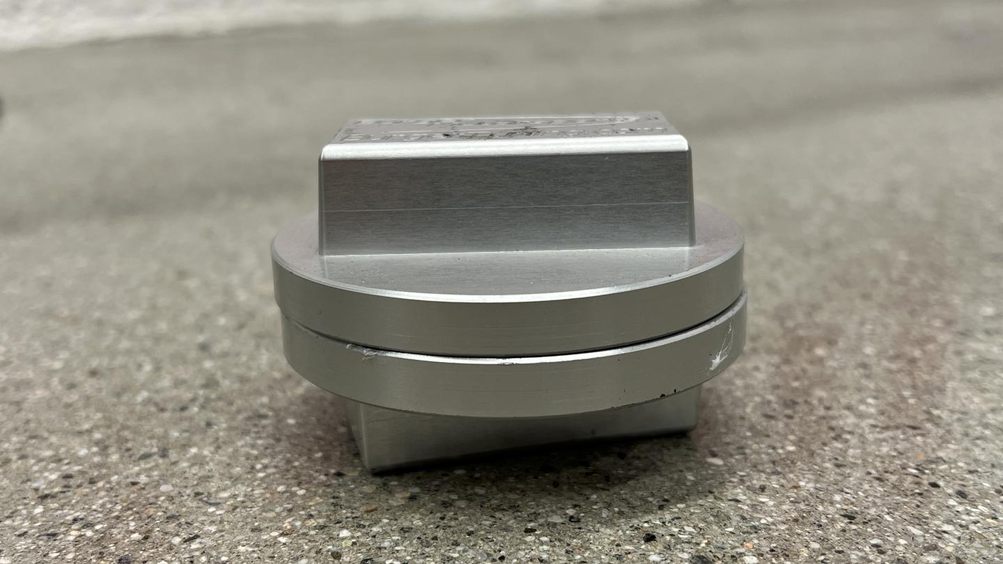

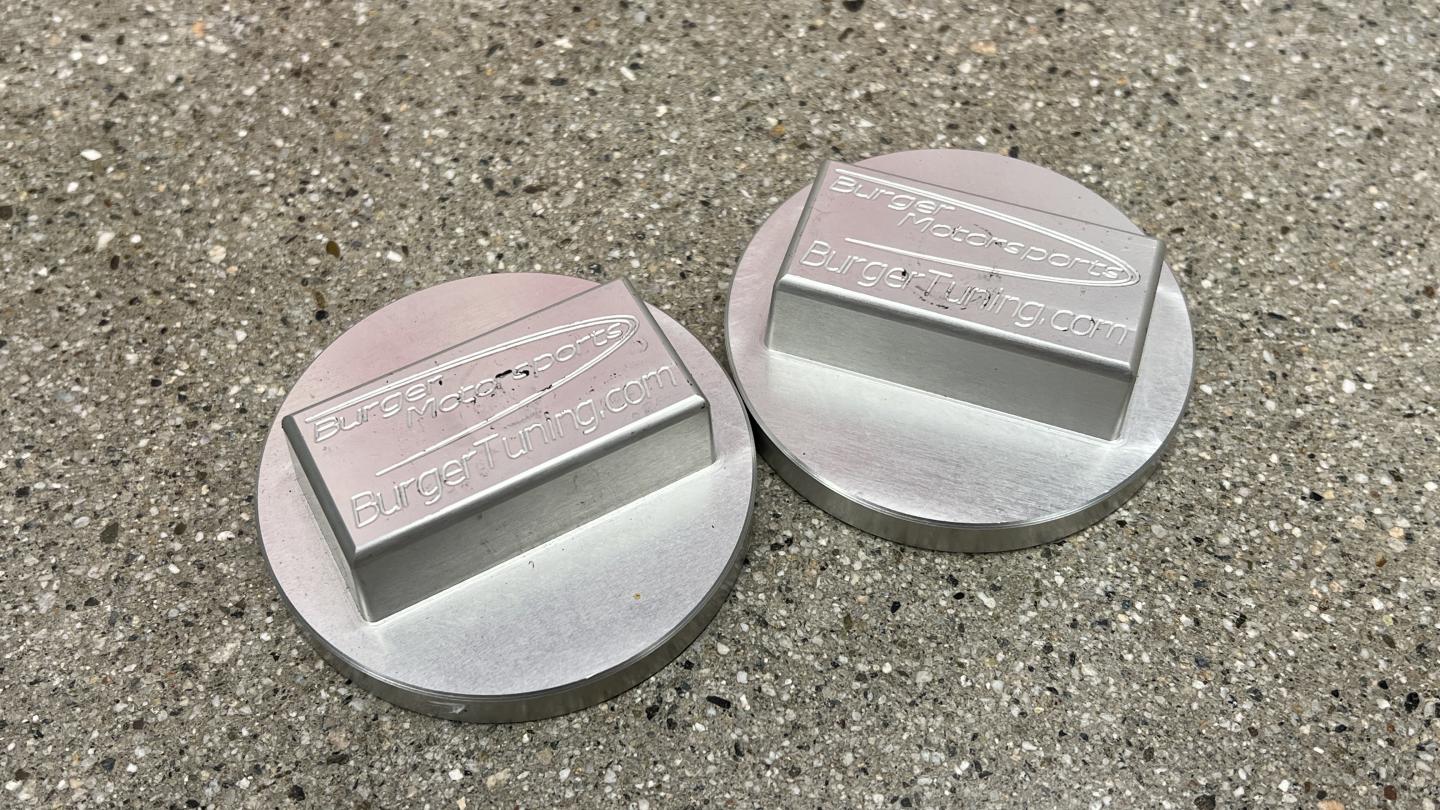

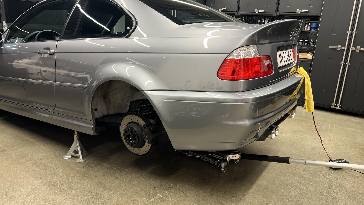

            If anyone is looking for the jack pad adapters, these Burger Motorsport adapters are the best. Manufacturing quality is super high, and they have a slight trapezoidal shape with beveled edges that matches perfectly with the factory jacking point.
            Click image for larger version  Name:	IMG_5887.jpg Views:	0 Size:	276.6 KB ID:	325186
            Click image for larger version  Name:	IMG_5890.jpg Views:	0 Size:	120.3 KB ID:	325185

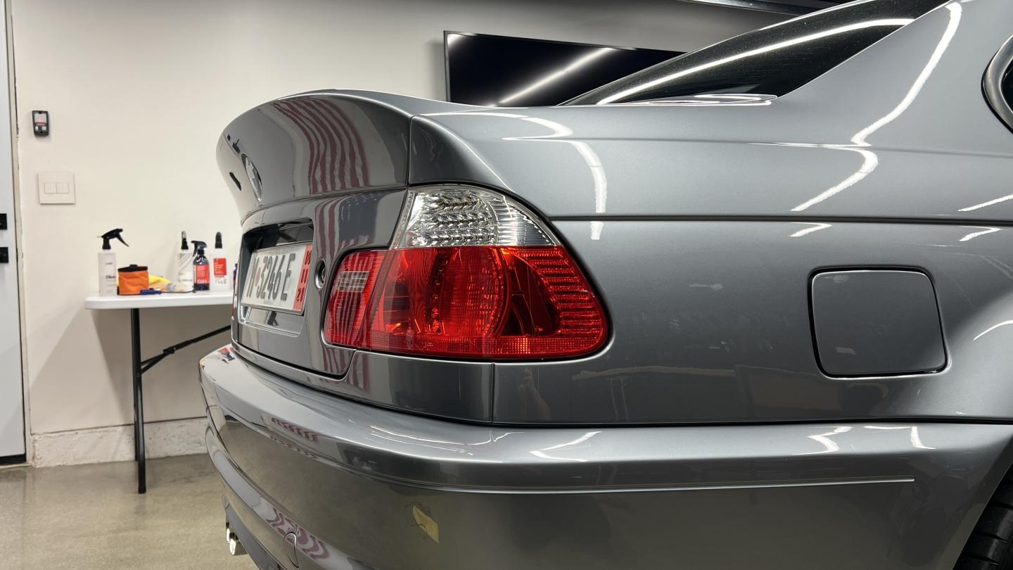

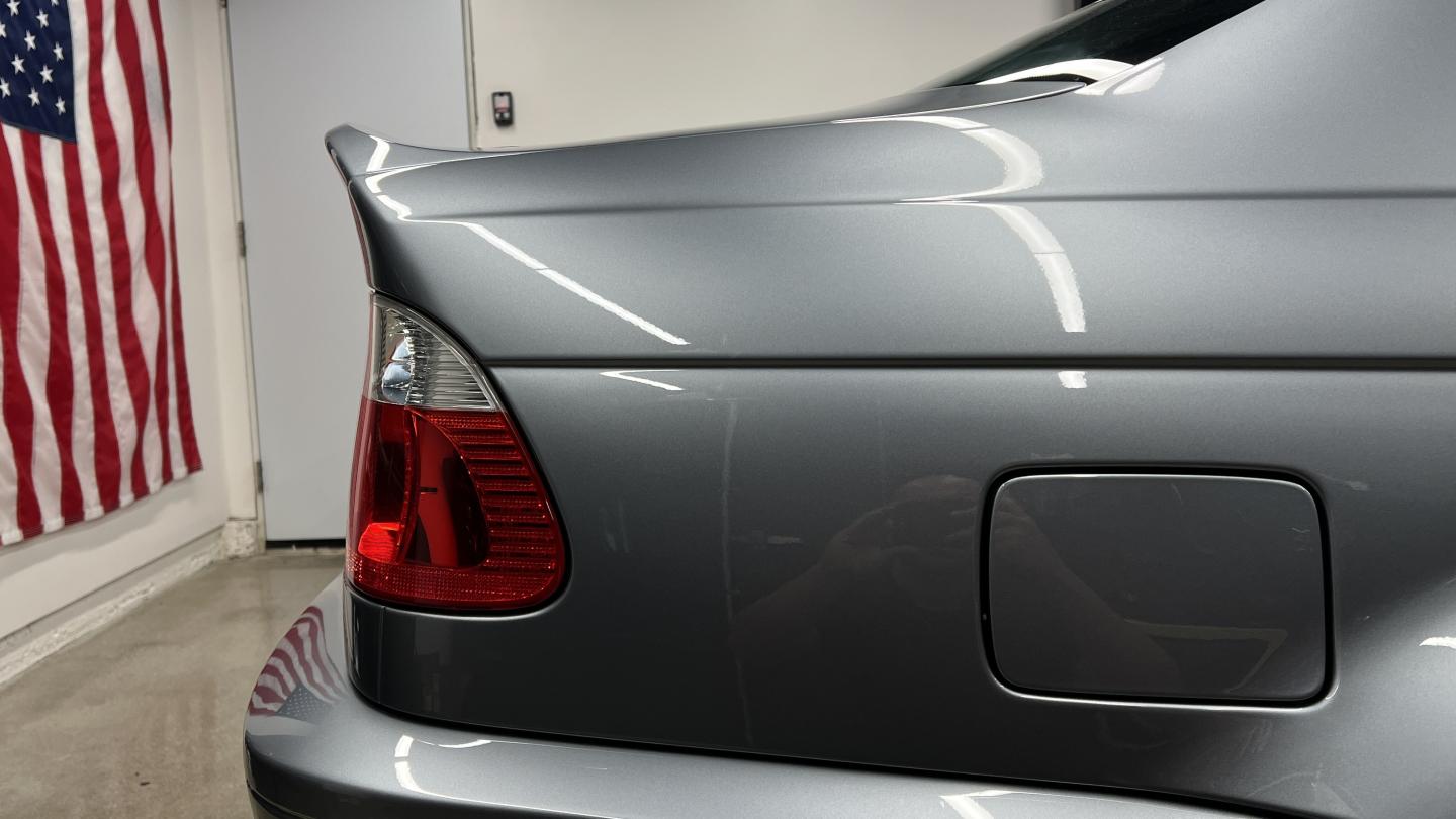

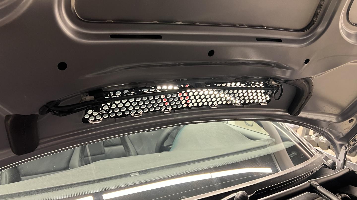

            Couple more adjustments to the trunk. This seems to be a never ending process based on compromise, not perfection.
            Click image for larger version  Name:	IMG_5902.jpg Views:	0 Size:	98.7 KB ID:	325187
            Click image for larger version  Name:	IMG_5903.jpg Views:	0 Size:	116.1 KB ID:	325188

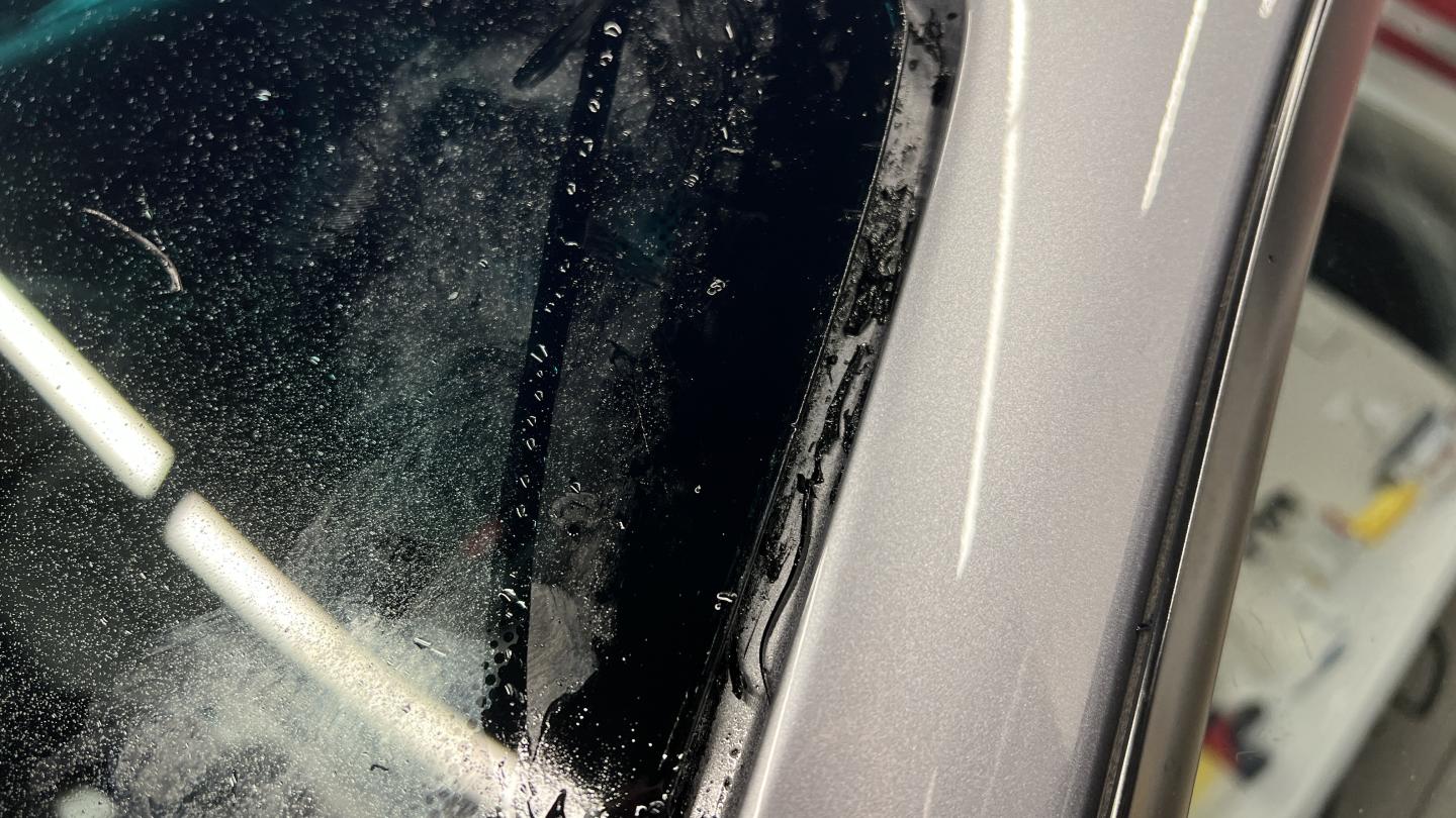

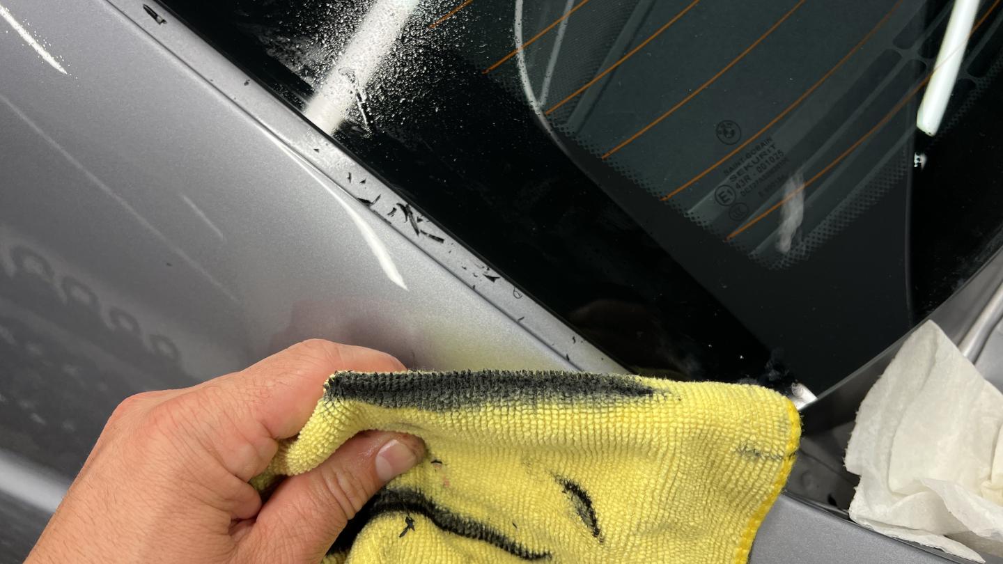

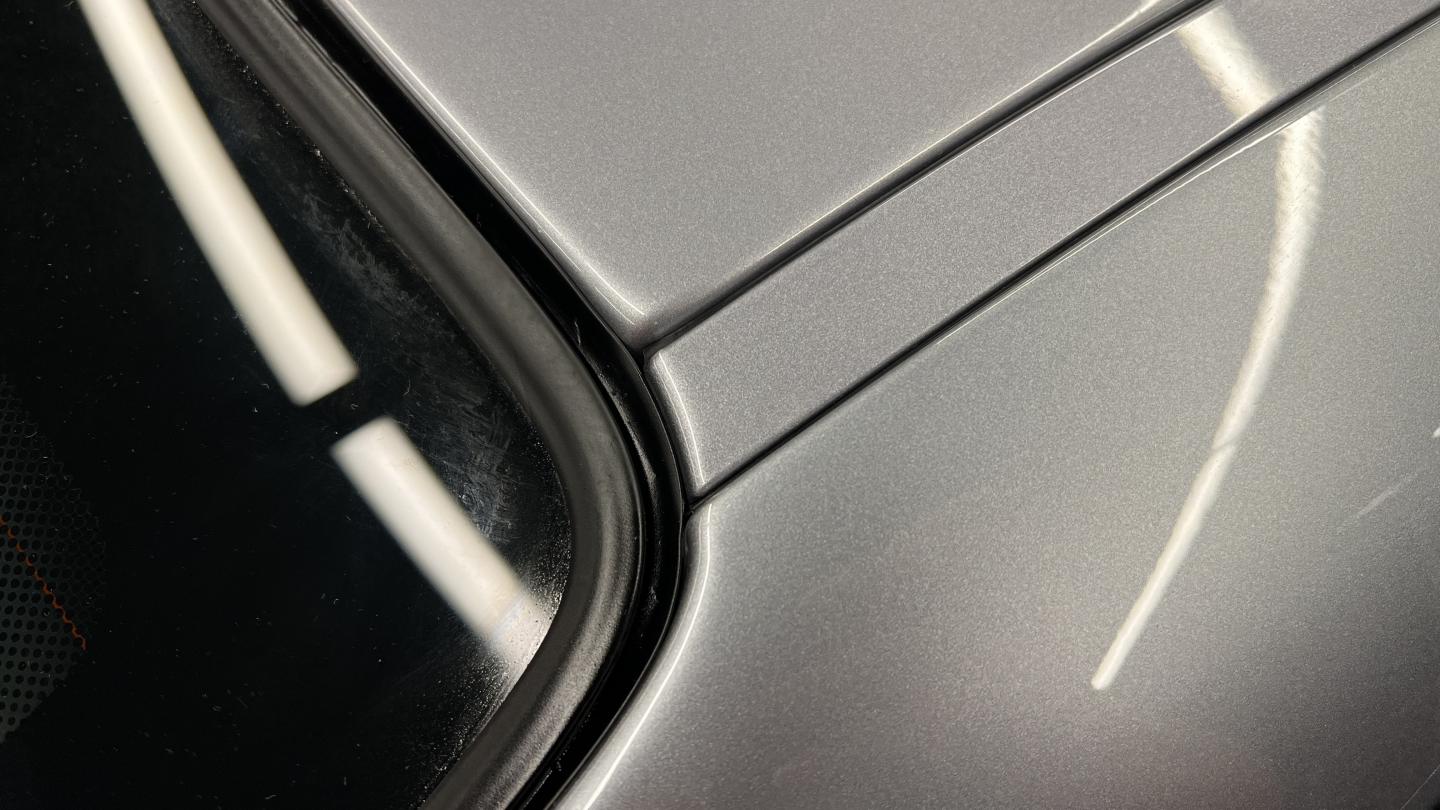

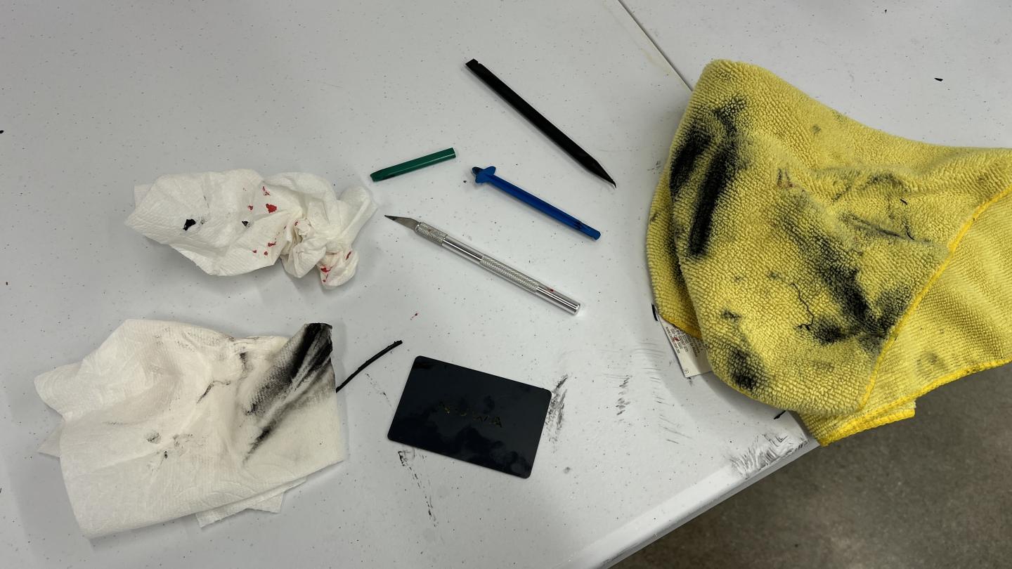

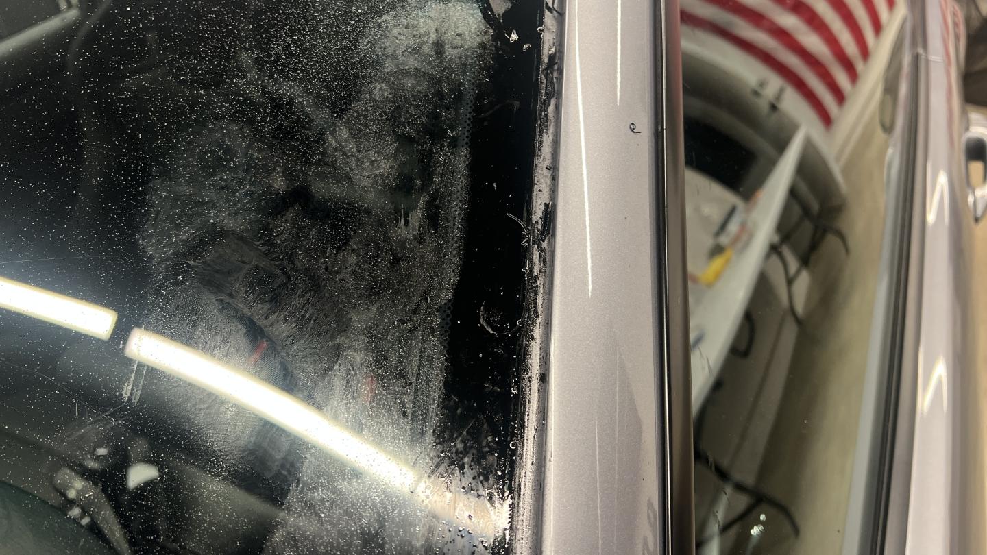

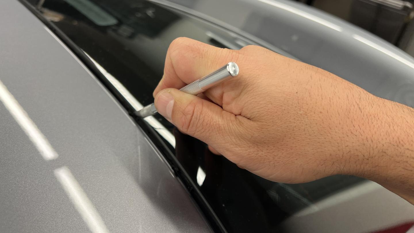

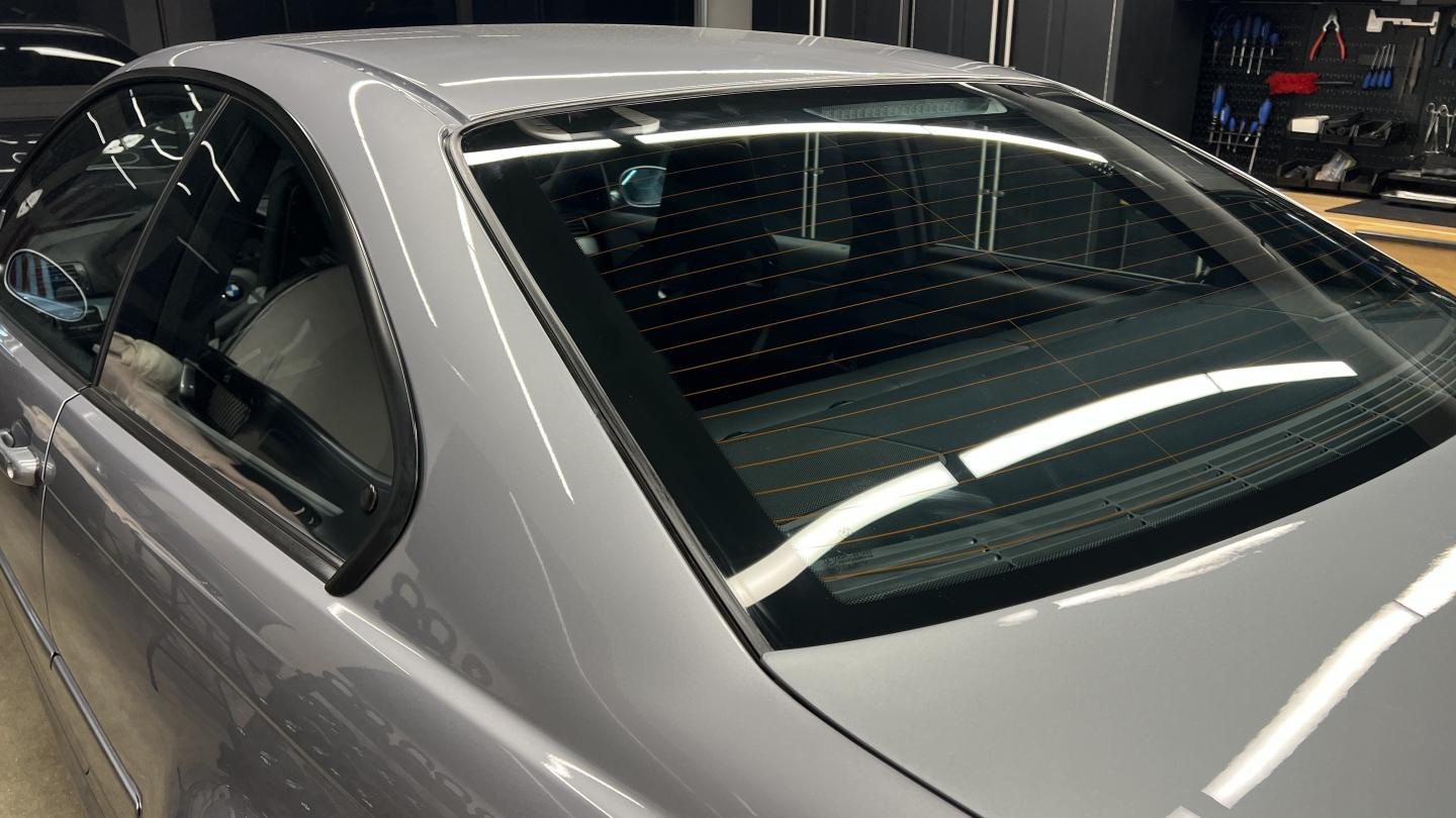

            I then moved on to the rear window seal. I’m not going to lie to you guys, this literally took two hours. What was described by many as a “just press the new one into place” type of job, was an absolute pain in the ass. I’m assuming these seals are installed when the windshield adhesive is still wet. When I tried to install the new seal, it was getting caught up on the old dried silicone adhesive and would not go in properly. This required me to carefully cut the adhesive with an x-acto blade, soak the area in tar/adhesive remover, then use a combination of scraping tools to clear out the channels without damaging anything.
            Click image for larger version  Name:	IMG_5904.jpg Views:	0 Size:	153.7 KB ID:	325190
            Click image for larger version  Name:	IMG_5905.jpg Views:	0 Size:	97.2 KB ID:	325189
            Click image for larger version  Name:	IMG_5906.jpg Views:	0 Size:	306.2 KB ID:	325194
            Click image for larger version  Name:	IMG_5907.jpg Views:	0 Size:	127.5 KB ID:	325193
            Click image for larger version  Name:	IMG_5908.jpg Views:	0 Size:	135.0 KB ID:	325192
            In the process, I sliced my finger open and got melted silicone adhesive all over my workspace and the paint.
            Click image for larger version  Name:	IMG_5909.jpg Views:	0 Size:	135.2 KB ID:	325191
            The seal was finally in! Ignore the streaky look of the seal, I was soaking it in a rubber conditioner/protectant. Passenger side and rear of the car complete! Time to move onto the front end and wrap this project up.
            Click image for larger version  Name:	IMG_5910.jpg Views:	0 Size:	136.7 KB ID:	325195

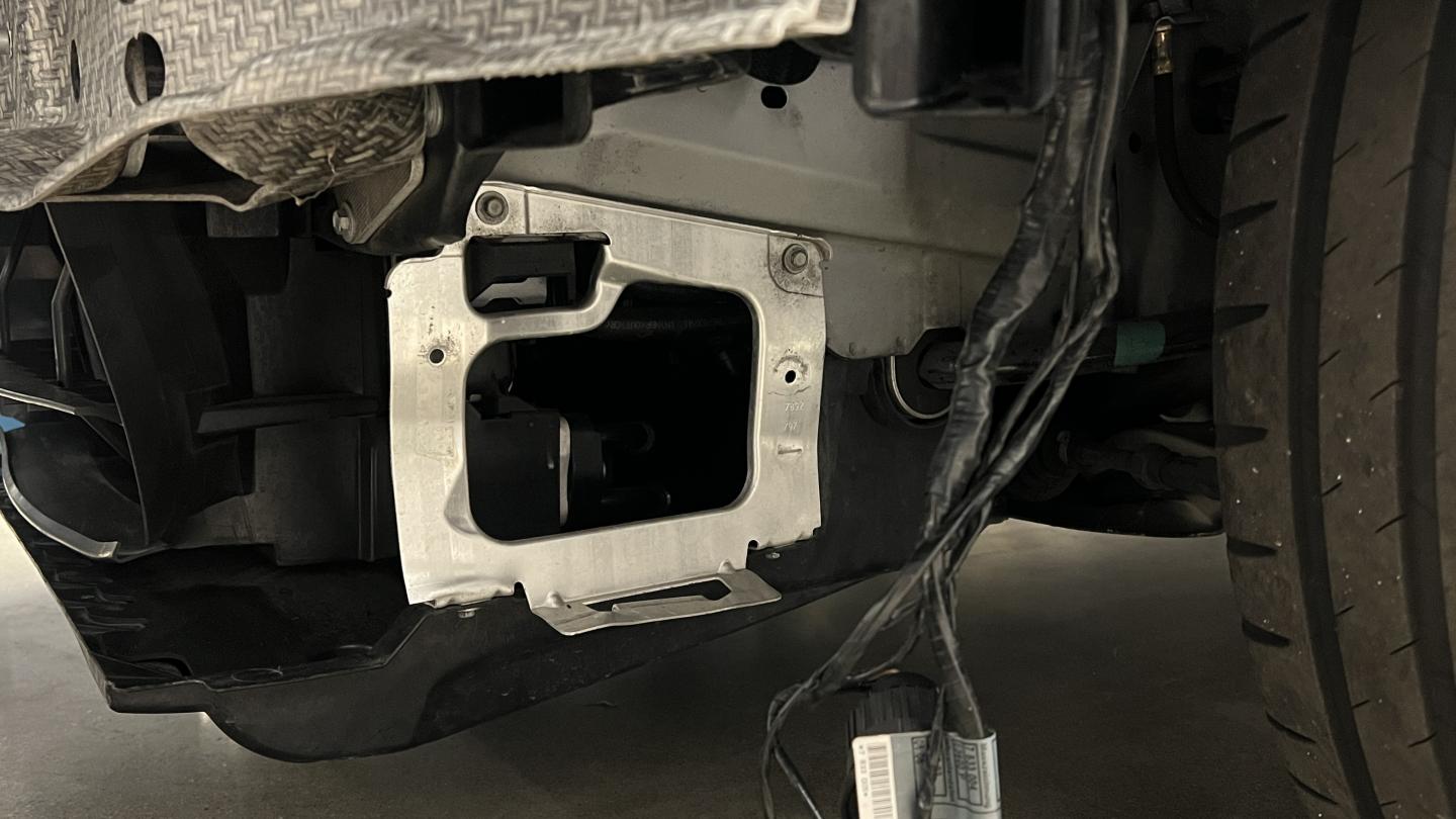

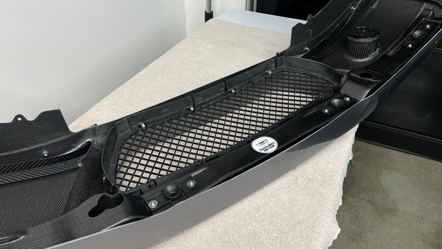

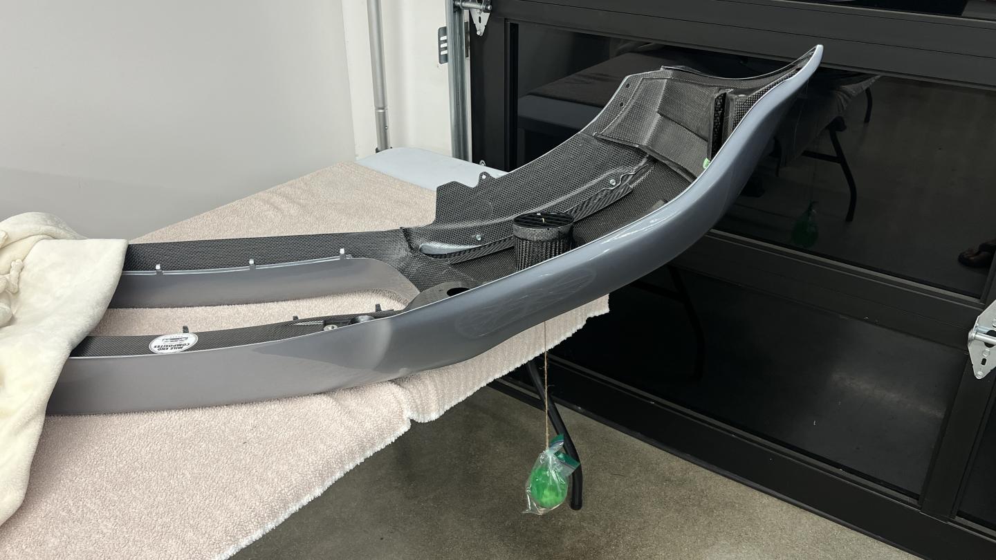

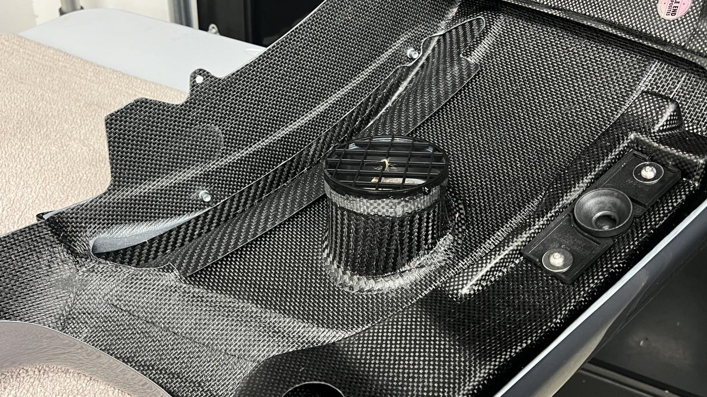

            First up for the front end was the CSL front bumper. Before the bumper could be installed, I had to glue in the intake vent mesh grill. I dropped the mesh grill onto the alignment notch in the bumper, then used one of my kid’s heavy toys tied to some string to keep downward pressure. I got this trick from another member who said he tied a bag of coins, really good trick and it worked great. With the grill in place and being held down, I used some black RTV silicone and put a nice bead all the way around the mesh grill. I then used my finger to smear the bead, similar to how you would caulk a bathroom. I put one extra blob of silicone onto the alignment notch for extra peace of mind.
            Click image for larger version  Name:	IMG_5847.jpg Views:	0 Size:	141.5 KB ID:	325196
            Click image for larger version  Name:	IMG_5849.jpg Views:	0 Size:	380.7 KB ID:	325199

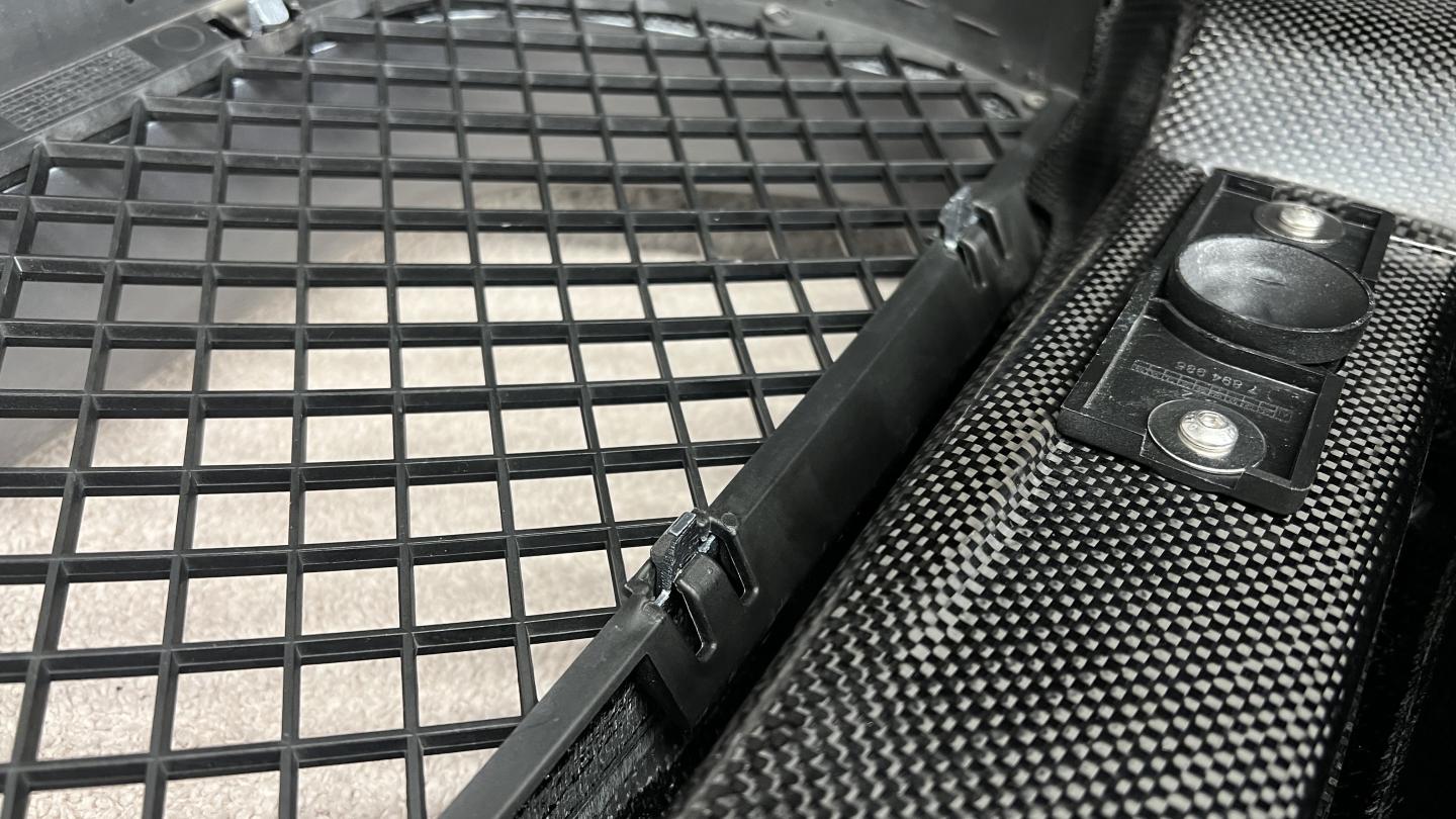

            Next up was the main bumper mesh grill, which was extremely tight and harder to get in than I had anticipated. I think is this because the carbon bumper has almost no flex.
            Click image for larger version  Name:	IMG_5850.jpg Views:	0 Size:	209.0 KB ID:	325198
            Click image for larger version  Name:	IMG_5851.jpg Views:	0 Size:	205.0 KB ID:	325197

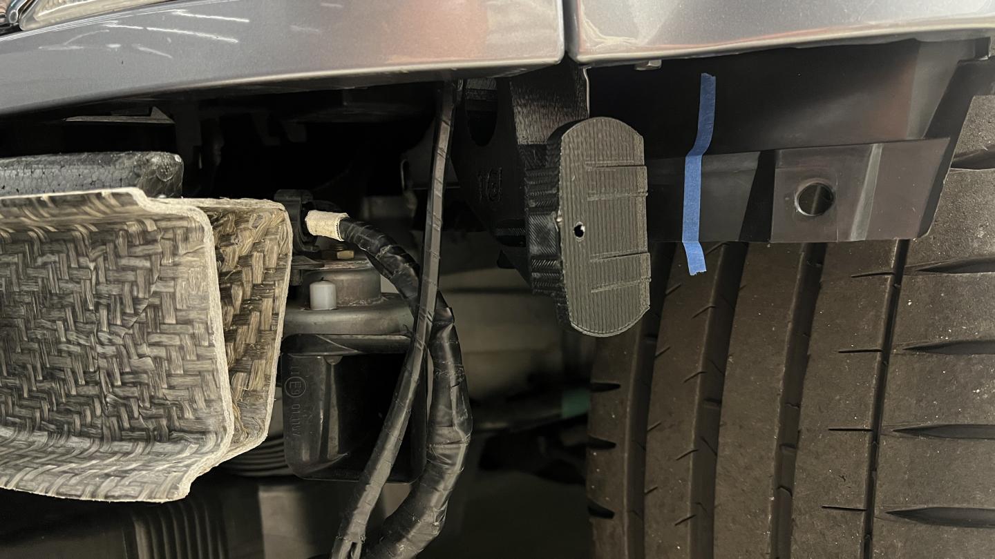

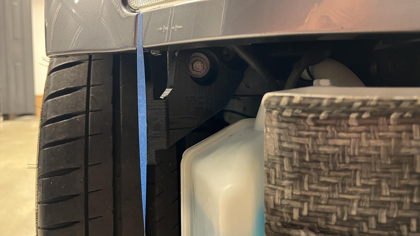

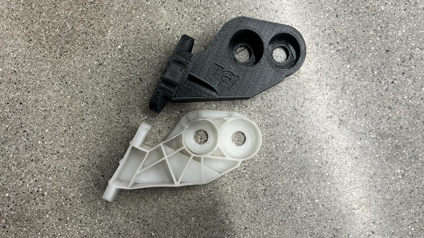

            With the silicone drying, I removed the factory bumper mounts and installed the Trinity graphics mounts. Just like the rear, they are a much beefier design, and have greater adjustability. I knew the alignment on the factory mounts was decent, and I didn’t want to start completely from scratch when I removed them. I hung some tape as a reference point, then removed the factory mounts and installed the new mounts.
            Click image for larger version  Name:	IMG_5893.jpg Views:	0 Size:	101.6 KB ID:	325200
            Click image for larger version  Name:	IMG_5894.jpg Views:	0 Size:	145.3 KB ID:	325201
            Click image for larger version  Name:	IMG_5892.jpg Views:	0 Size:	348.9 KB ID:	325202

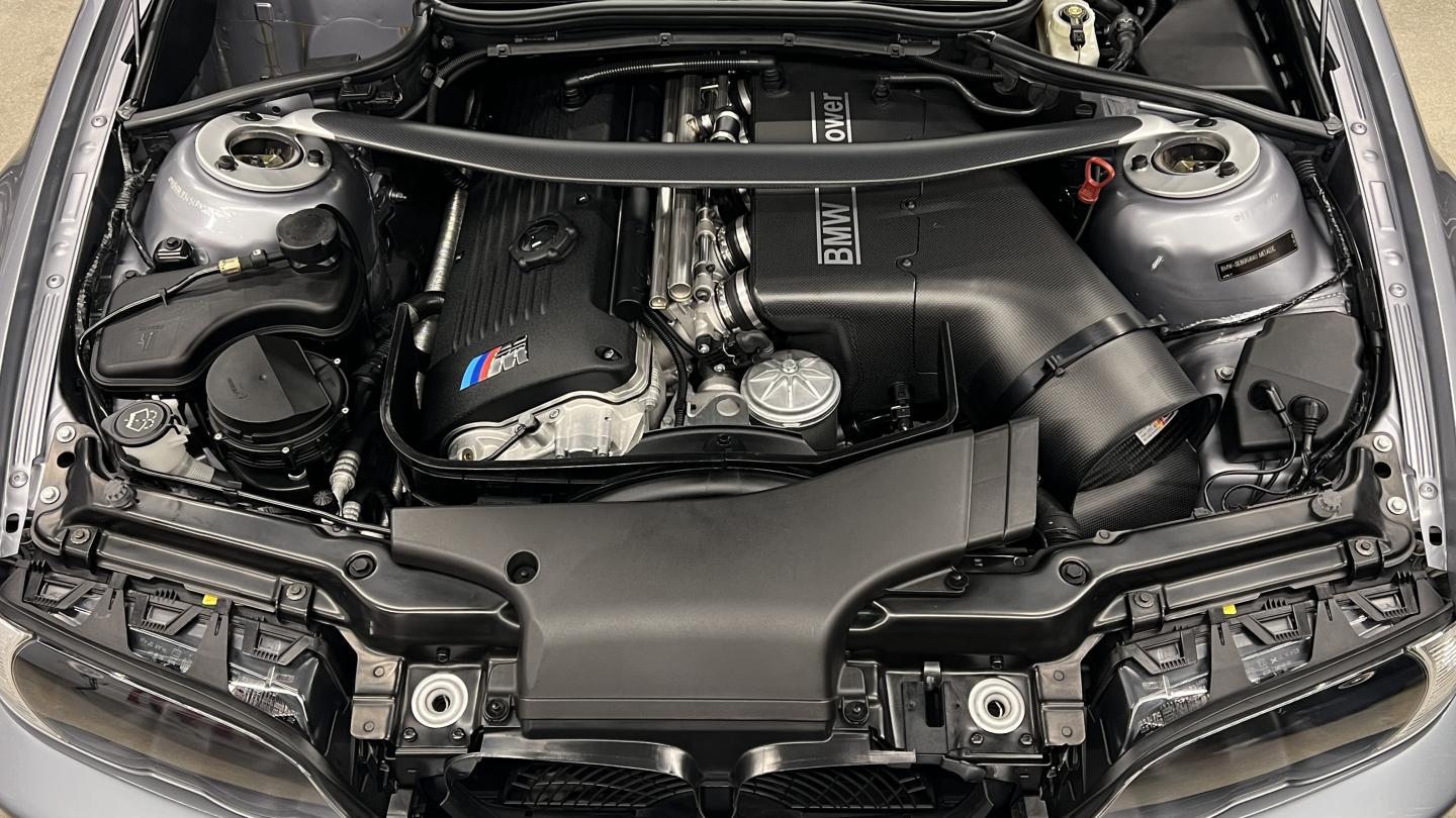

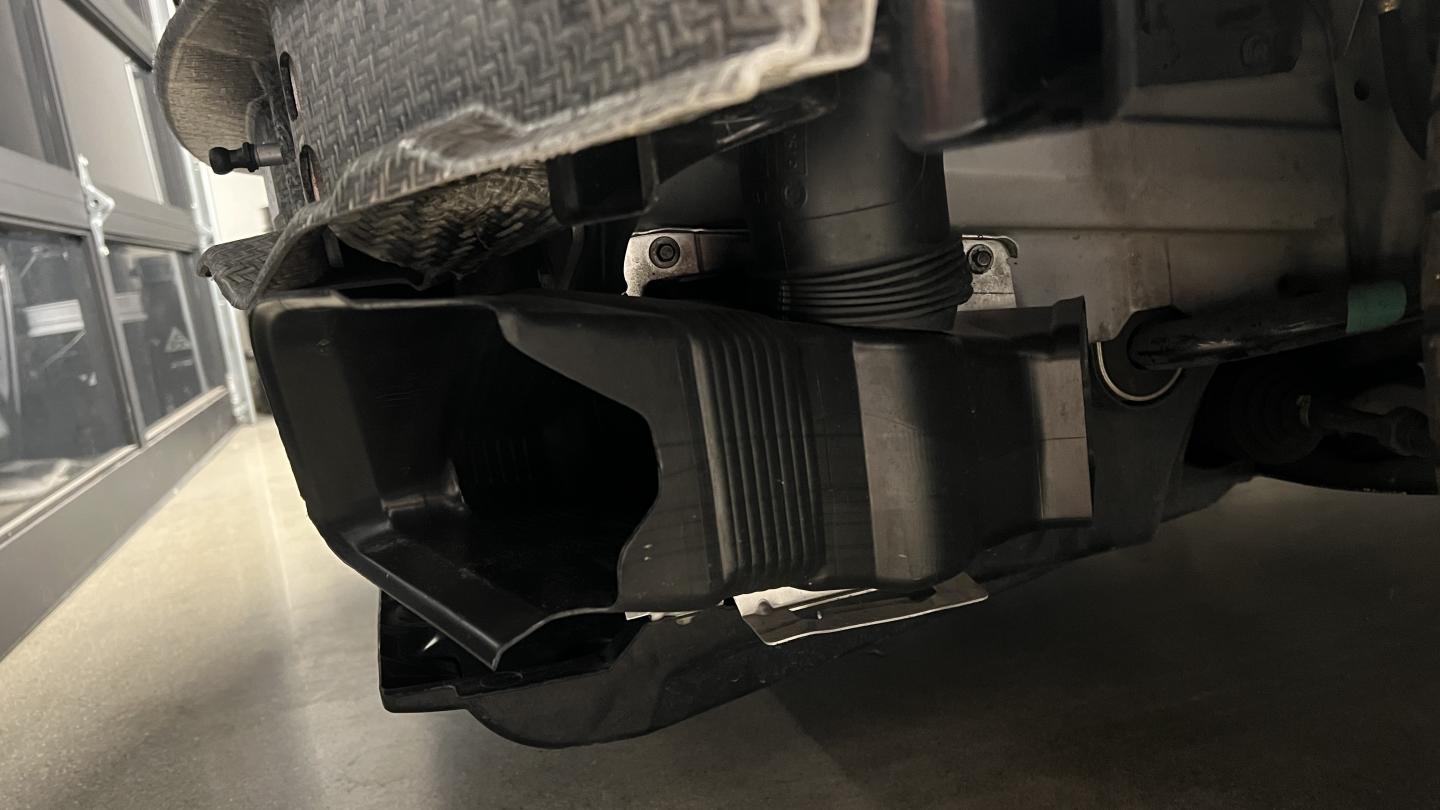

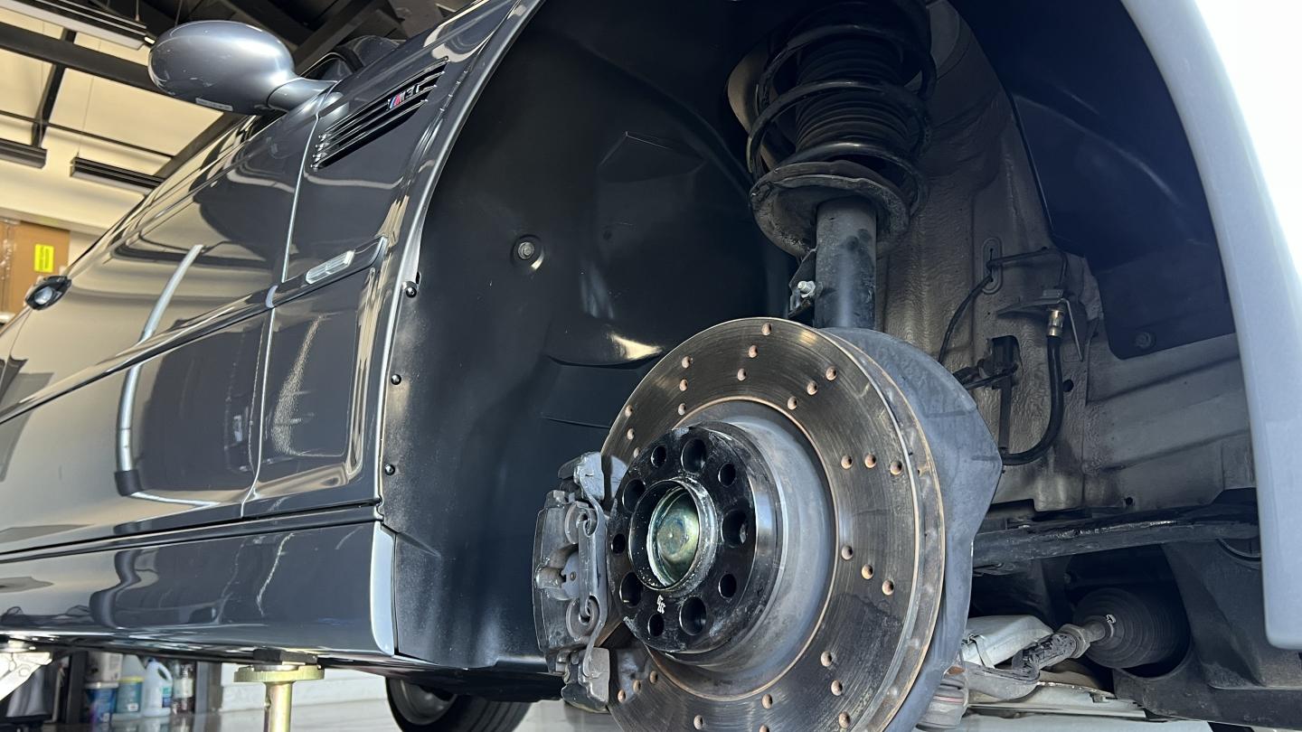

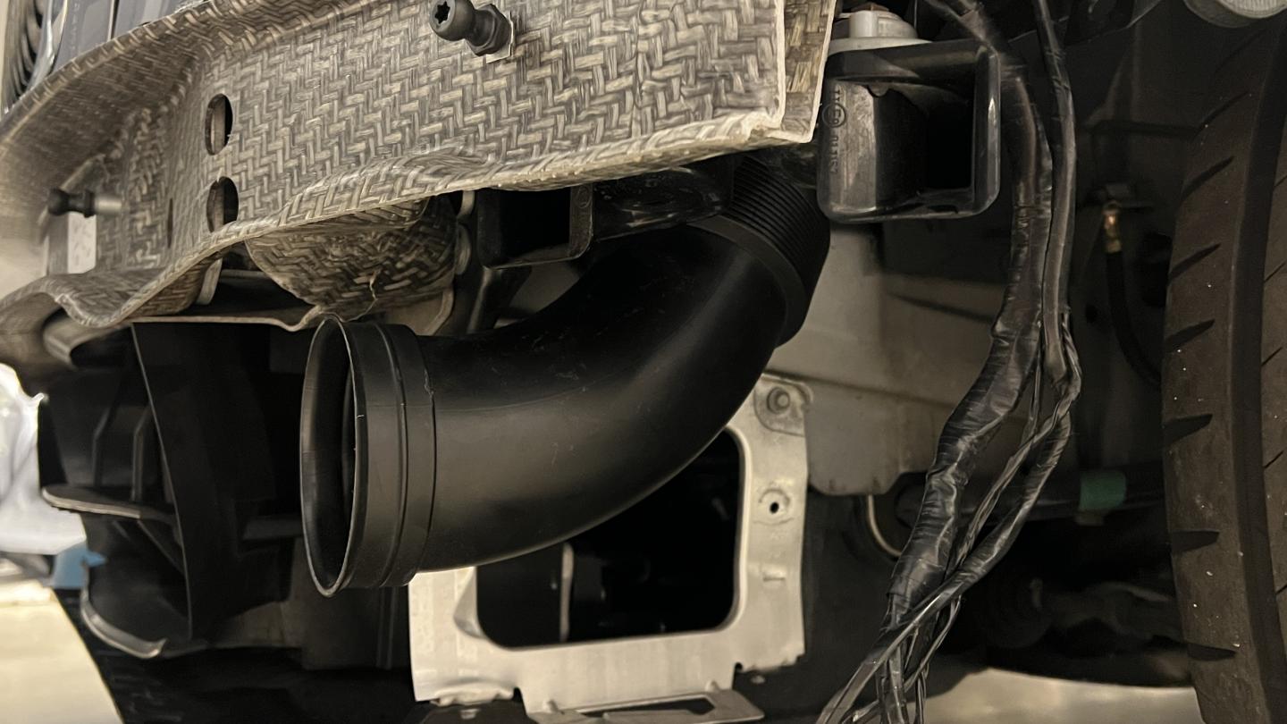

            Next I removed the brake duct bracket, then the brake duct with modified CSL intake tube I made a few months prior. The bracket was reinstalled, then the genuine CSL intake tube was installed
            Click image for larger version  Name:	IMG_5895.jpg Views:	0 Size:	95.4 KB ID:	325204
            Click image for larger version  Name:	IMG_5897.jpg Views:	0 Size:	117.3 KB ID:	325205
            Click image for larger version  Name:	IMG_5899.jpg Views:	0 Size:	128.1 KB ID:	325203
            That's all for this update. The next step is to fit the front bumper, which I will need a second set of hands for.

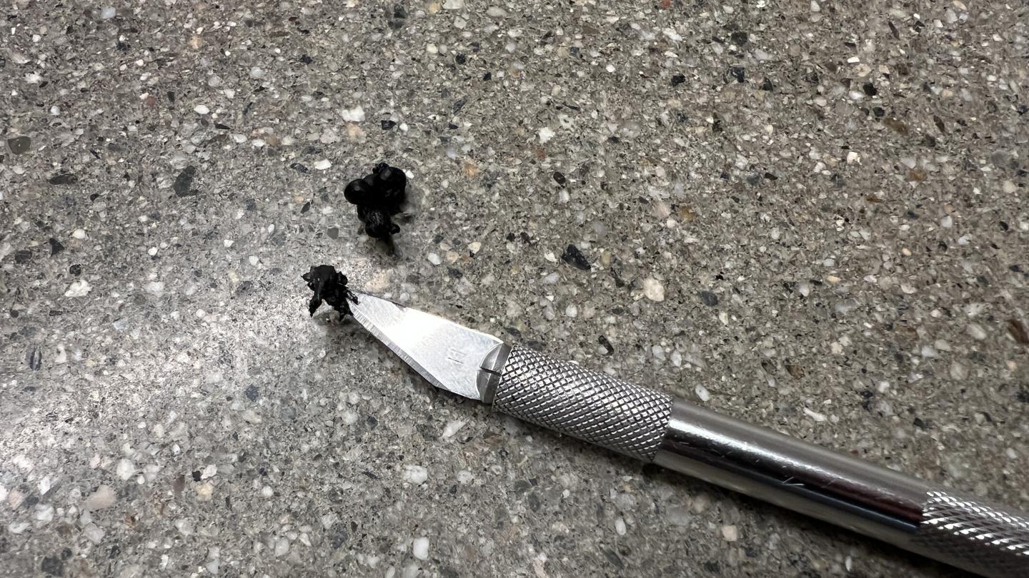

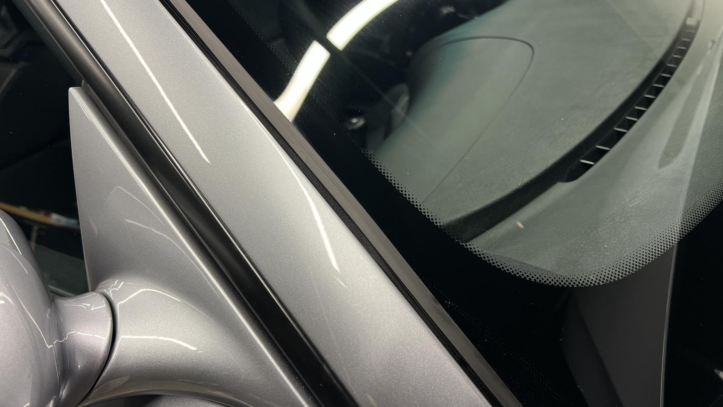

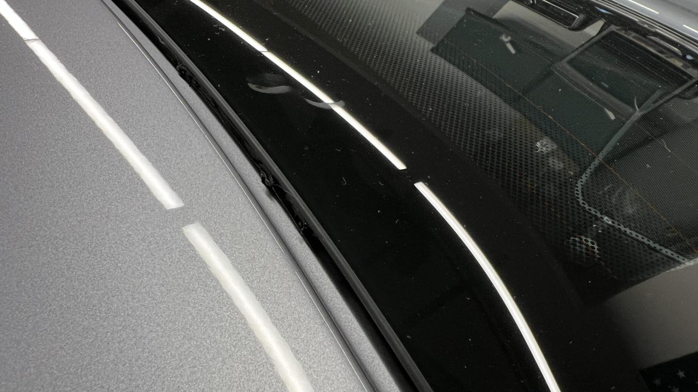

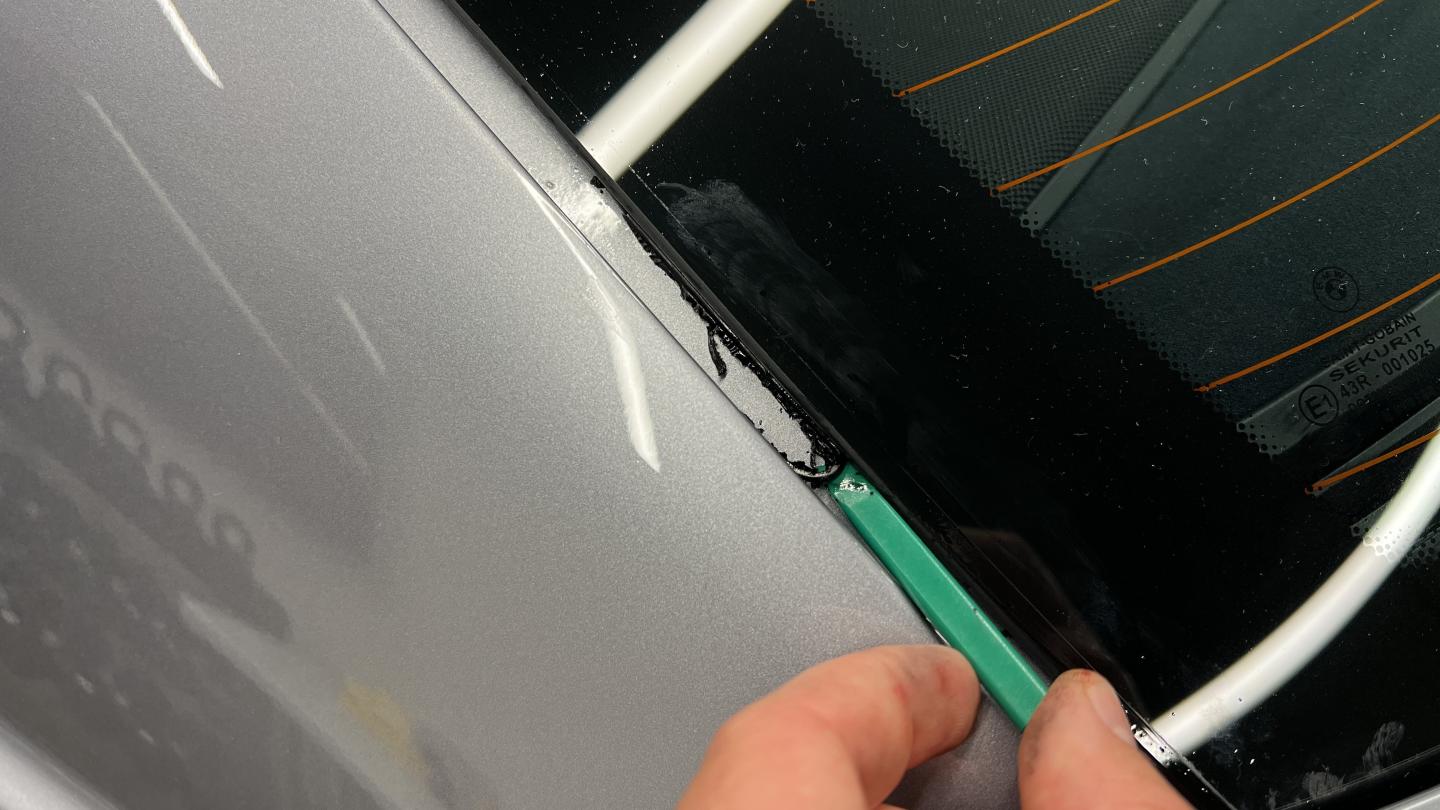

                        After my battle with the rear window seal, I procrastinated on the front. One night when the wife and kids went down, I committed to ending the war. I told myself I wasn’t going back in the house until I got the old silicone adhesive removed, and new windshield seal installed. The removal took an hour, but I got the job done.
                        Click image for larger version  Name:	IMG_5939.jpg Views:	0 Size:	204.9 KB ID:	325986
                        Click image for larger version  Name:	IMG_5941.jpg Views:	0 Size:	214.1 KB ID:	325987

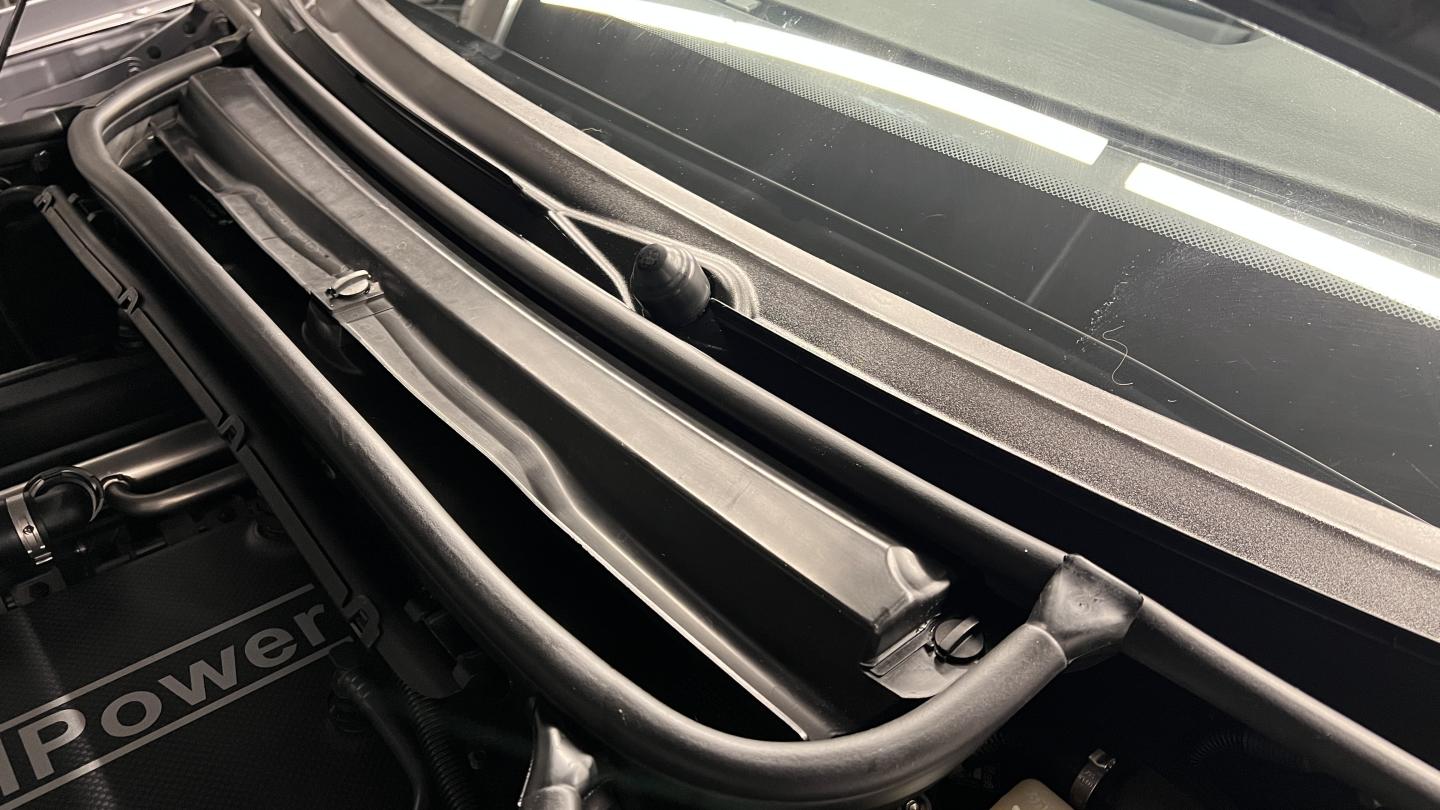

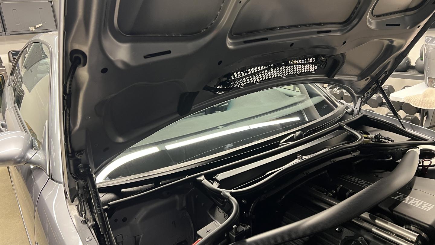

                        Once the seal was in, I could install cabin filter, cover, rubber gaskets, windshield cowl, and wiper delete caps.
                        Click image for larger version  Name:	IMG_5972.jpg Views:	0 Size:	117.7 KB ID:	325988
                        Click image for larger version  Name:	IMG_5978.jpg Views:	0 Size:	158.8 KB ID:	325989
                        Roof rails went in and tucked nicely under the new seals. Click image for larger version  Name:	IMG_5971.jpg Views:	0 Size:	132.9 KB ID:	325990
                        Click image for larger version  Name:	IMG_5974.jpg Views:	0 Size:	150.9 KB ID:	325991

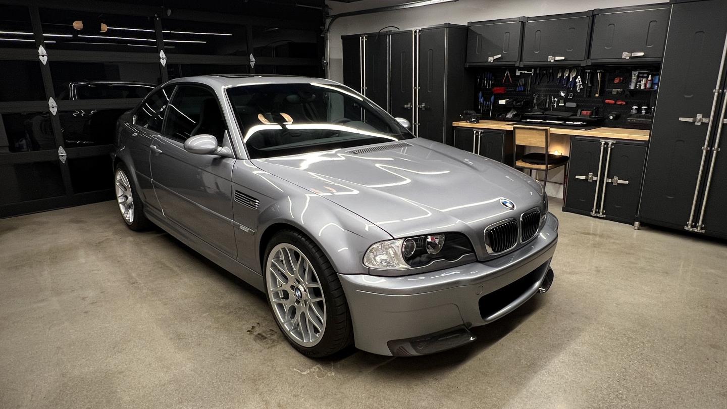

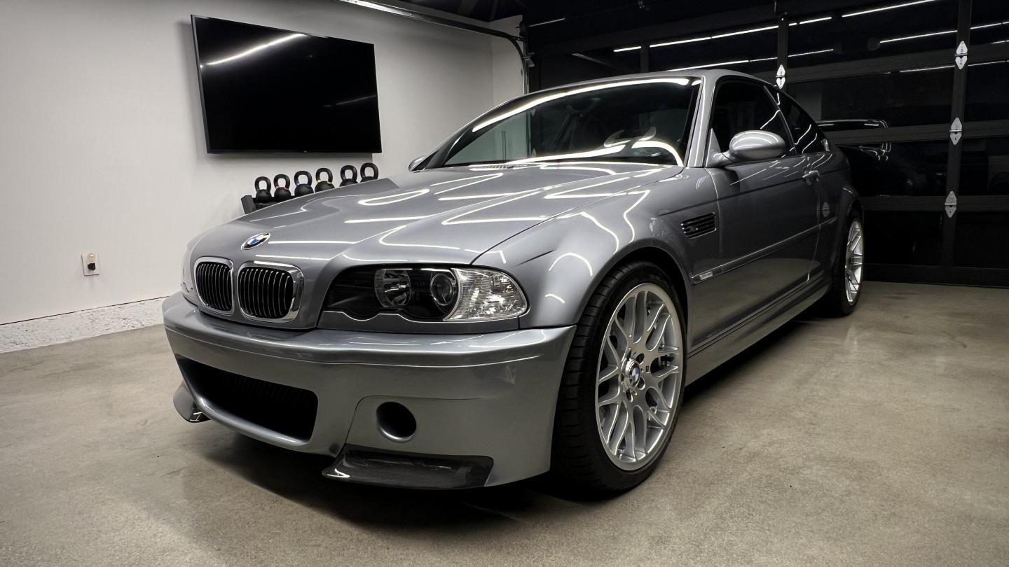

                        I took the car out for a small drive around the block just to settle in the suspension in and listen for any small rattles of potentially loose parts. Afterward, I pulled the car into the garage and took a couple of photos.
                        Click image for larger version  Name:	IMG_6005.jpg Views:	0 Size:	168.5 KB ID:	325997
                        Click image for larger version  Name:	IMG_6056.jpg Views:	0 Size:	135.5 KB ID:	325996

                        Although the exterior portion of this project is still not complete, it’s going to be a while before I post any other significant updates, like the carbon fiber roof which still remains. We have a lot of life and family changes going on at the moment, and it’s getting increasingly difficult to justify spending money on project cars. I will continue to update this thread with photos from meets, scenic drives, and detailing/cleaning, but there probably won’t be any build related photos for a while.

                          Looks great! How does the CSL air duct fit with the Karb snorkel? After scanning a couple cars, I found that the Karb snorkel is positioned differently than the factory flap. Curious to see how that manifests with the OEM duct versus the non-CSL ducts.
