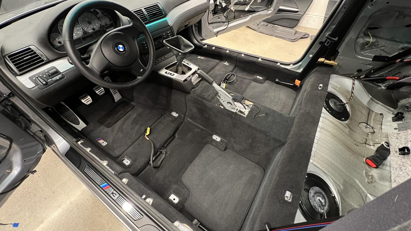

    While doing research for the CSL install, I found no comprehensive DIY for this project. I had to pick through various forums, YouTube videos, and random decade old PDFs to piece together some sort of a tutorial. I decided that I was going to take on a clear and comprehensive DIY that could be used by others in the future. Once it’s finished I will host the PDF on my website and give it to Karbonius so they can provide it to future customers. For now, here’s some info and photos of the install.
    Everything stripped out of the interior.

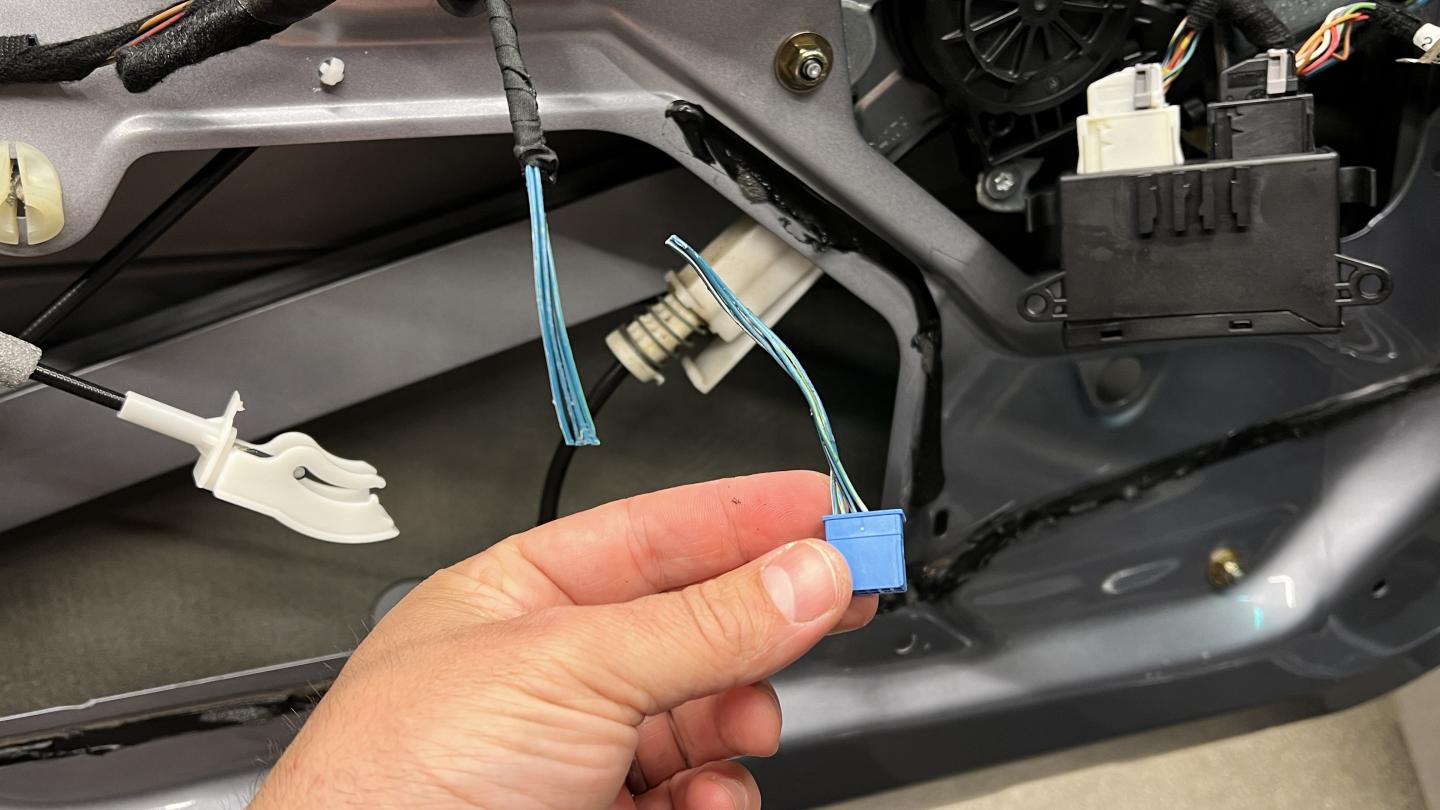

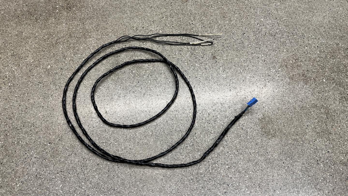

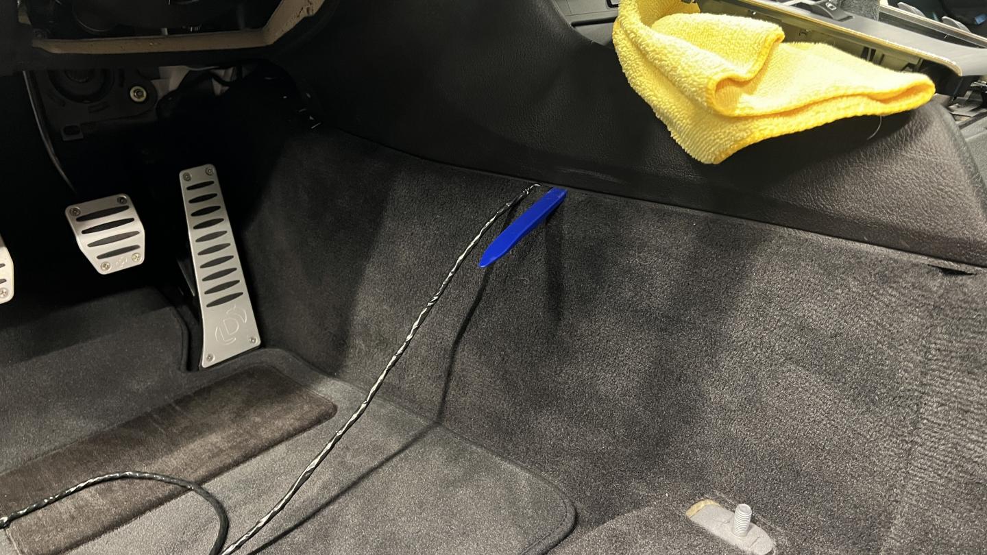

    Mirror adjustment harness was extended. I cut, stripped, soldered, heat shrunk then ran it to its new home under the center console.
    Click image for larger version  Name:	IMG_5064.jpg Views:	0 Size:	115.2 KB ID:	245514
    Click image for larger version  Name:	IMG_5074.jpg Views:	0 Size:	408.4 KB ID:	245517
    Click image for larger version  Name:	IMG_5076.jpg Views:	0 Size:	213.0 KB ID:	245516
    Click image for larger version  Name:	IMG_5078.jpg Views:	0 Size:	158.3 KB ID:	245515

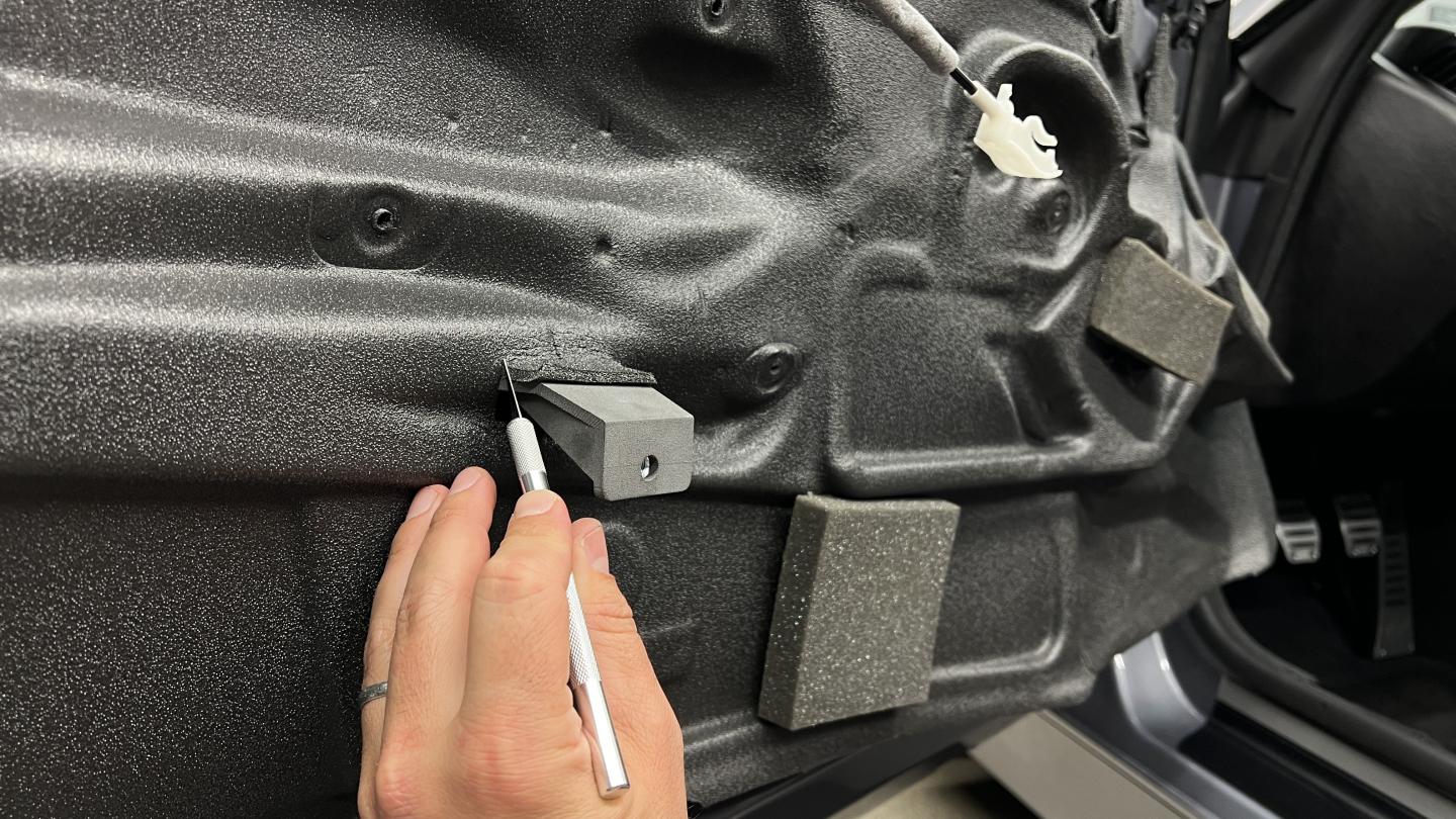

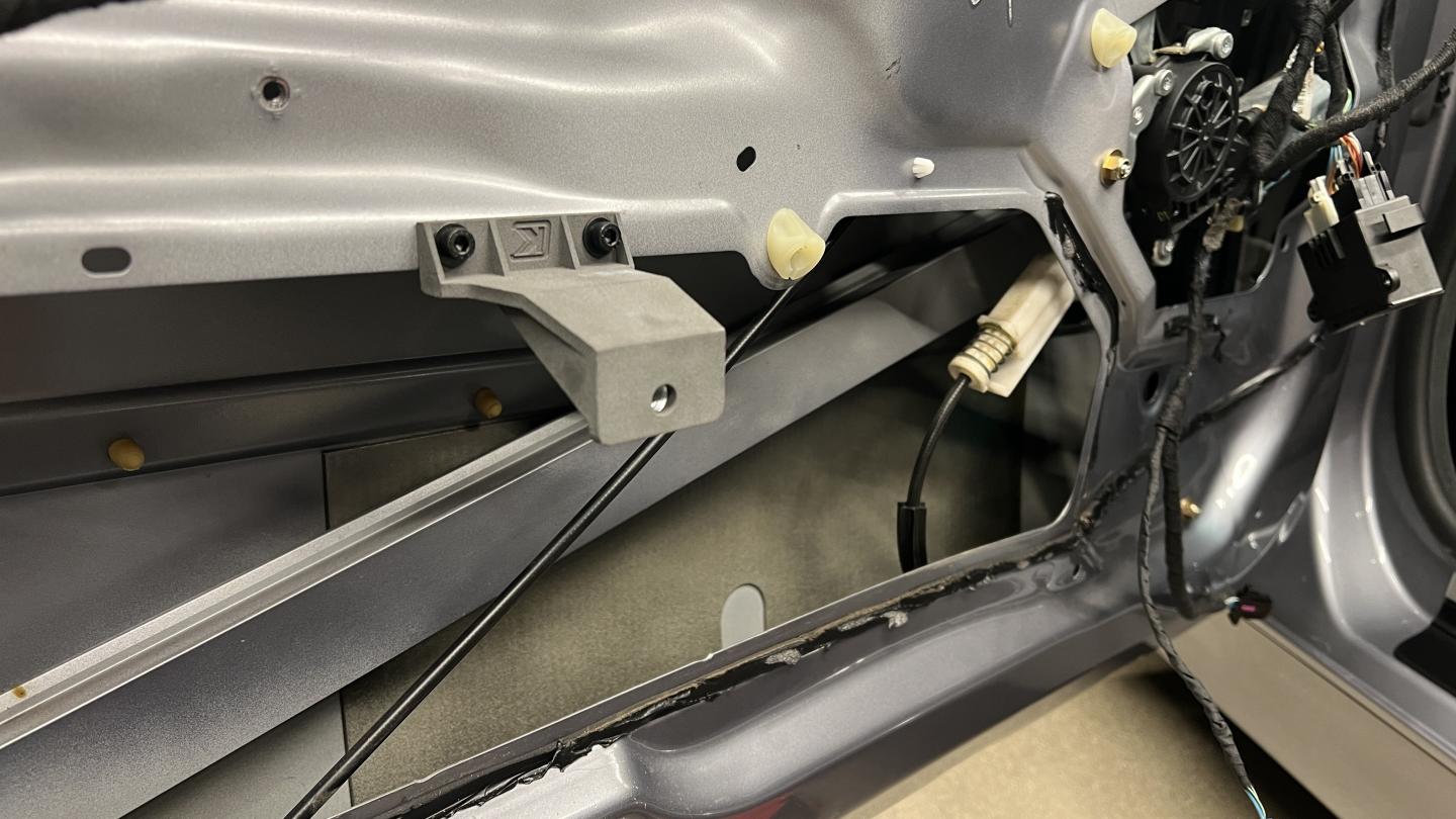

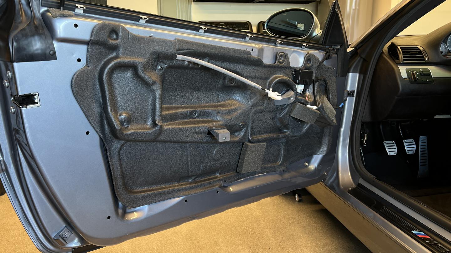

    Door brackets being installed
    Click image for larger version  Name:	IMG_4904.jpg Views:	0 Size:	140.1 KB ID:	245520
    Click image for larger version  Name:	IMG_4906.jpg Views:	0 Size:	149.5 KB ID:	245519
    Click image for larger version  Name:	IMG_4909.jpg Views:	0 Size:	161.8 KB ID:	245518

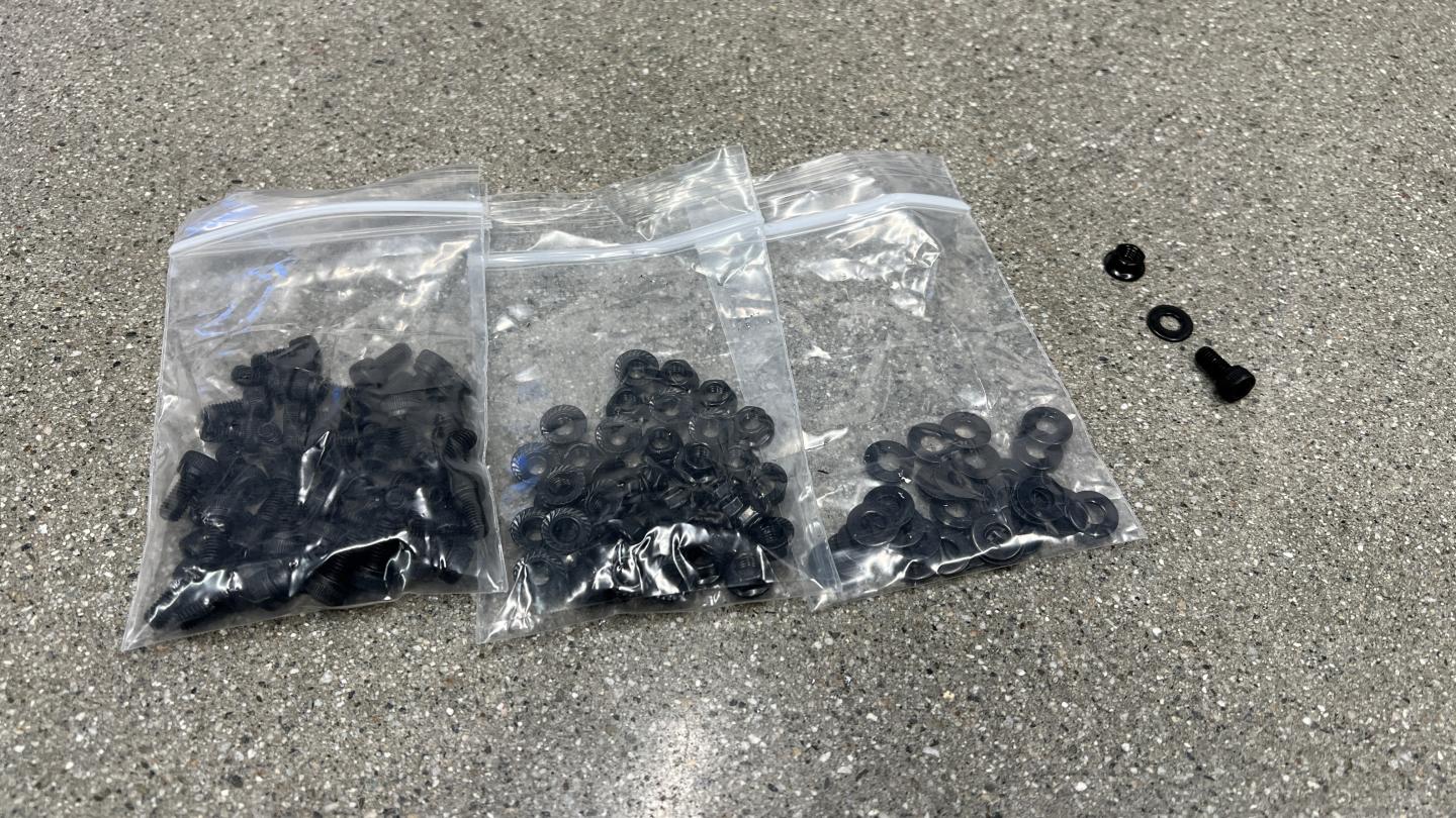

    Here is the hardware I used. If anyone is doing this project and wants the correct hardware, please reach out. I have more than enough and I will send you a set for free.
    Click image for larger version  Name:	IMG_4908.jpg Views:	0 Size:	297.9 KB ID:	245521
    Vapor barrier modified to fit new brackets.
    Click image for larger version  Name:	IMG_5103.jpg Views:	0 Size:	238.6 KB ID:	245524
    Click image for larger version  Name:	IMG_5112.jpg Views:	0 Size:	189.2 KB ID:	245523

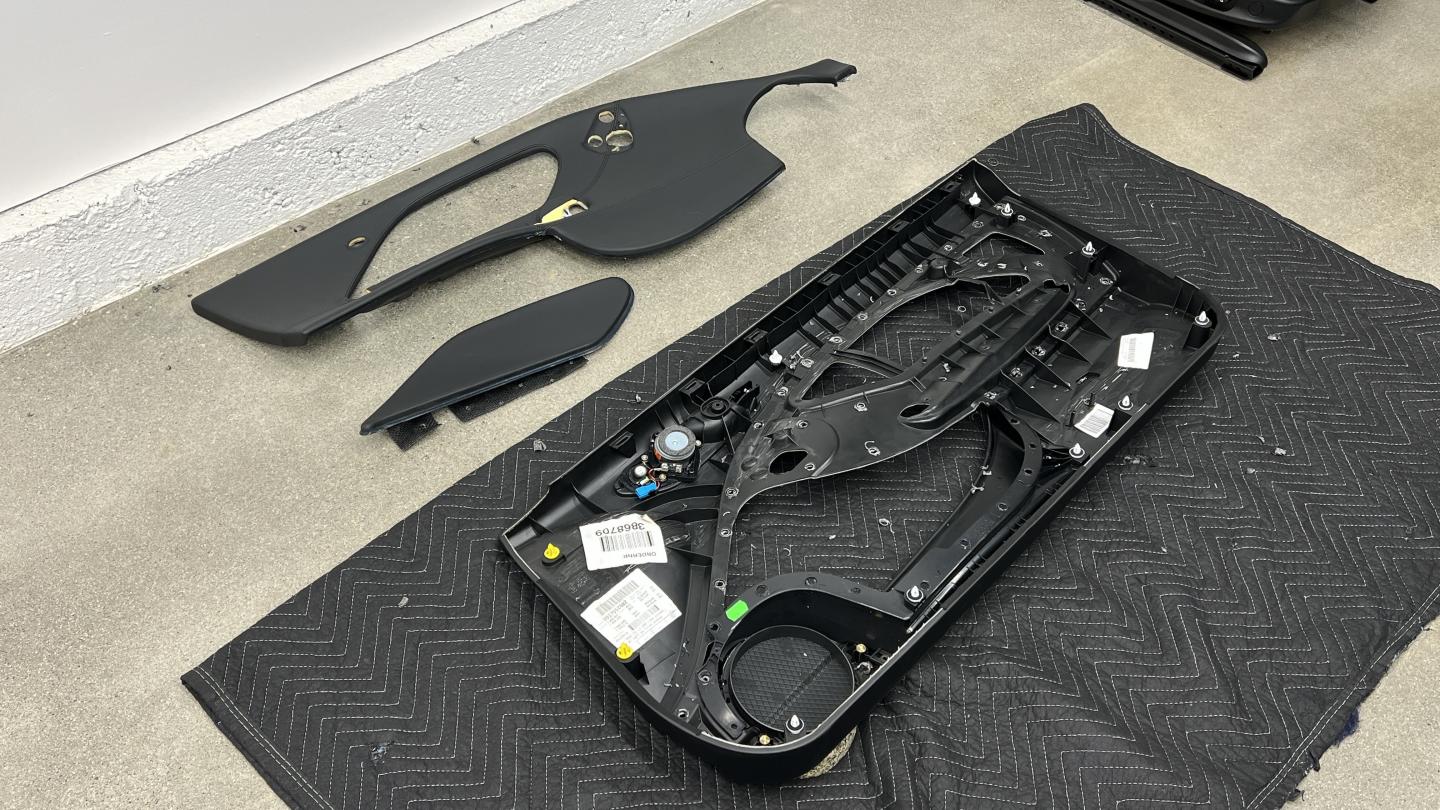

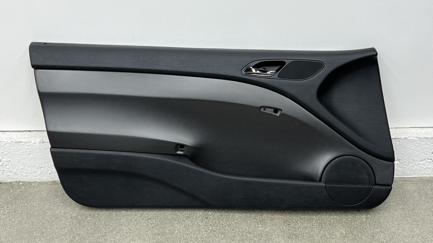

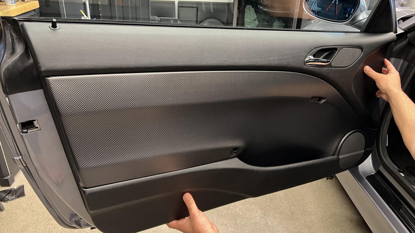

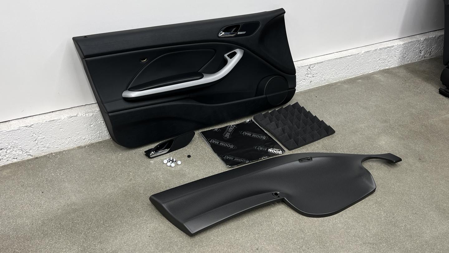

    Onto the door panels. Here is everything laid out for install.
    Click image for larger version  Name:	IMG_4919.jpg Views:	0 Size:	168.7 KB ID:	245525

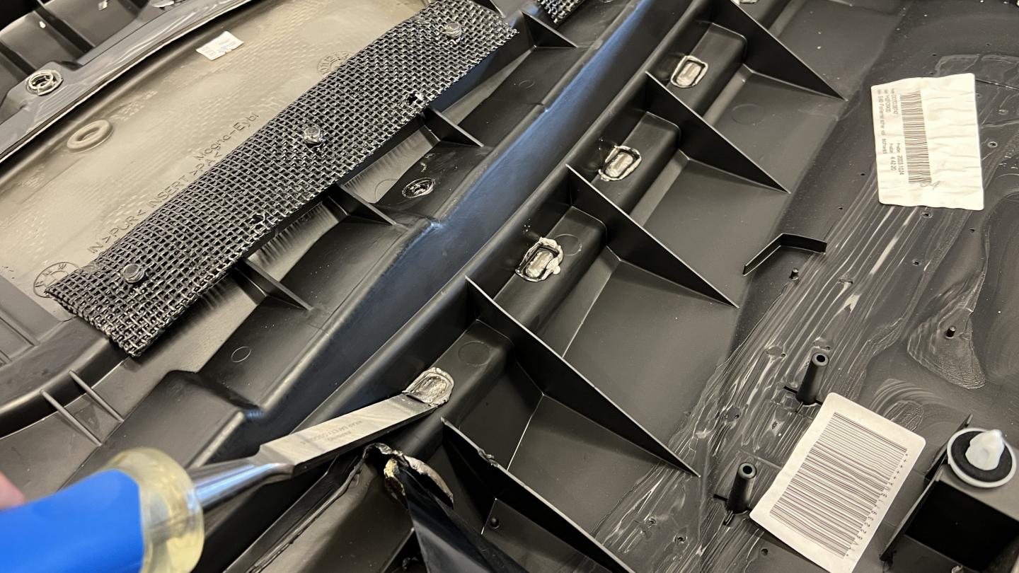

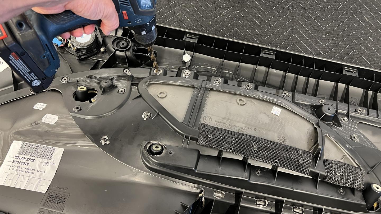

    Photos of the door panel modification and install. I had a lot more photos for you to follow along visually, but I reached the maximum attachment limit for my post and I had to delete them. Here are a few.
    Click image for larger version  Name:	IMG_4924.jpg Views:	0 Size:	235.9 KB ID:	245529
    Click image for larger version  Name:	IMG_4931.jpg Views:	0 Size:	133.0 KB ID:	245527
    Click image for larger version  Name:	IMG_4928.jpg Views:	0 Size:	196.6 KB ID:	245526
    Click image for larger version  Name:	IMG_4932.jpg Views:	0 Size:	248.2 KB ID:	245528

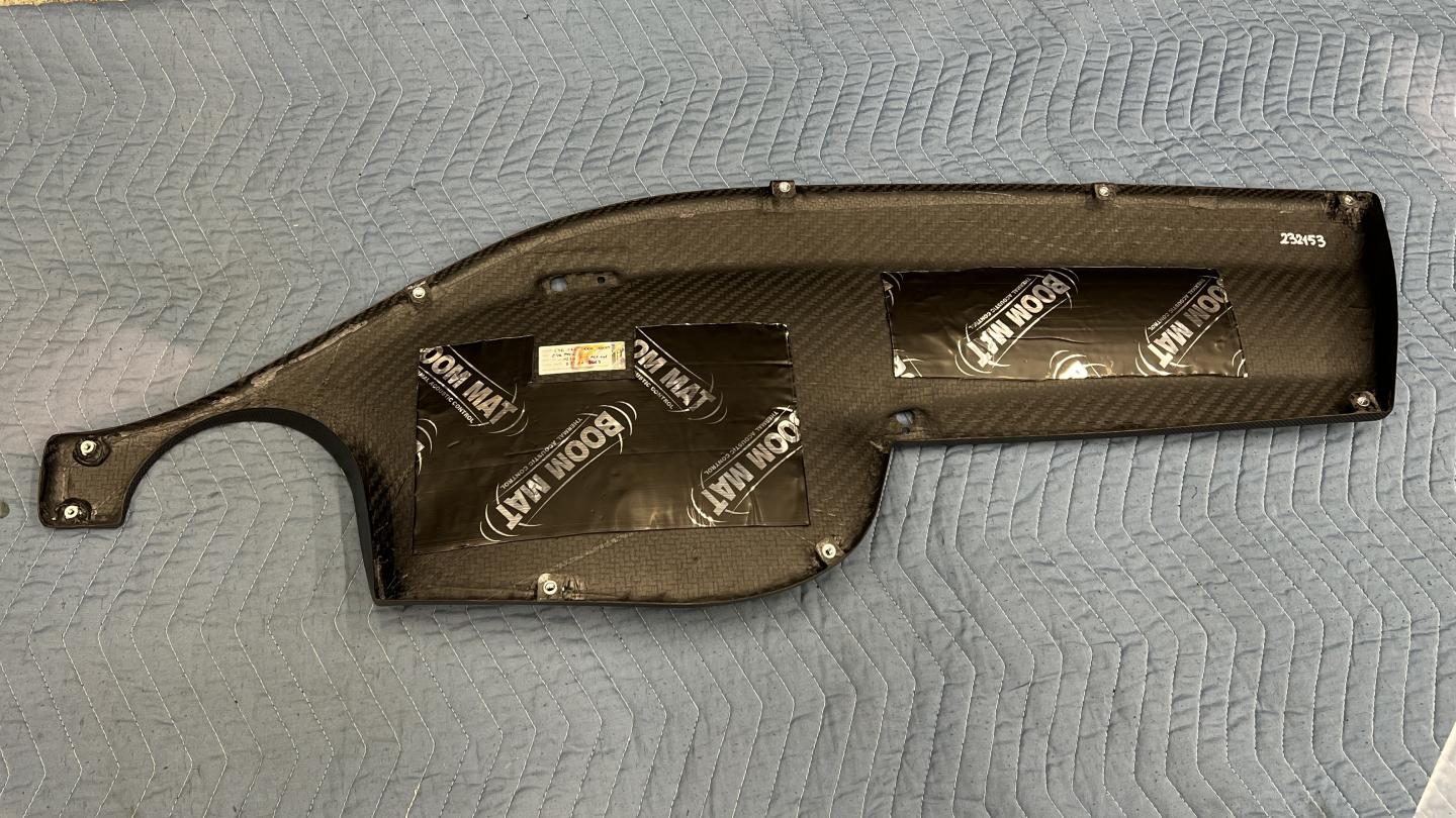

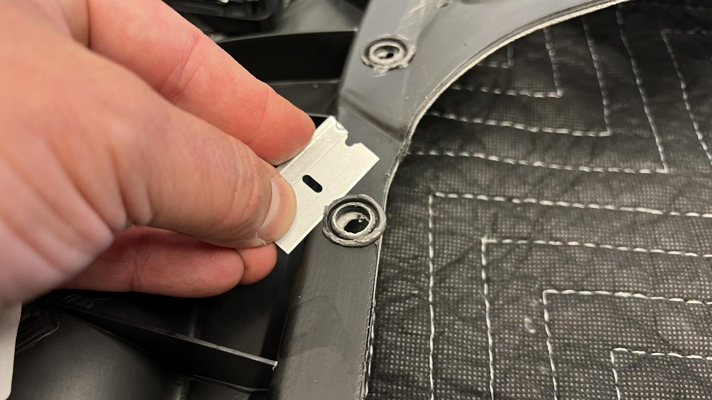

    Prior to installing the new panel, I added a little bit of sound deadening to the back. It added about 7.5oz of weight to the panel. The panel now sounds and feels very solid, yet lightweight at the same time. It is a strange combination that is hard to describe. It’s one of those things that if you knocked on the panel with your knuckle, you’d know right away what failing to describe.
    Click image for larger version  Name:	IMG_4943.jpg Views:	0 Size:	230.4 KB ID:	245530

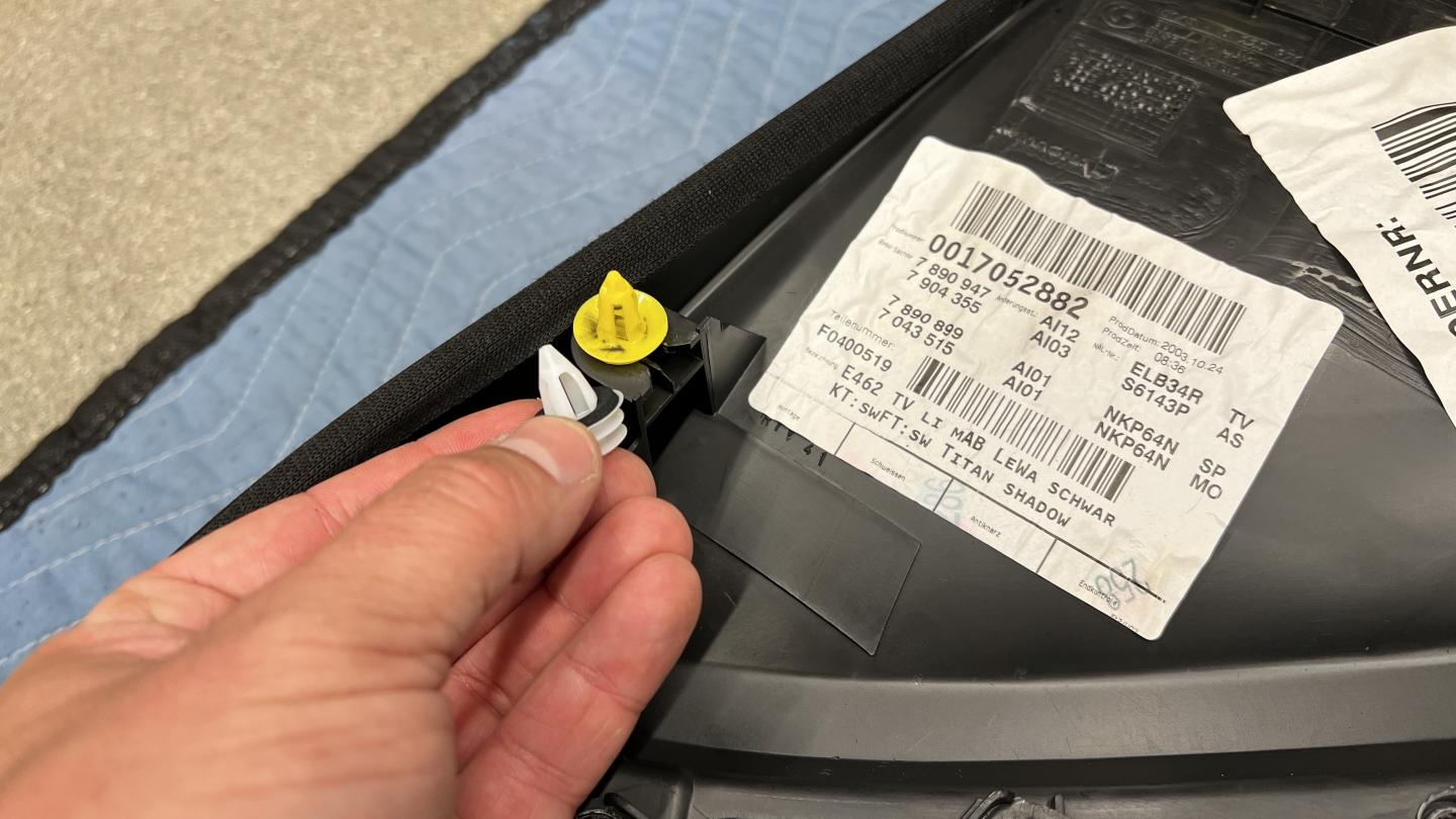

    After the new panel was on, I replaced all of the clips with the version that contains the foam o-ring vapor barrier. They feel more solid and should allow less movement / potential rattling issues as well.
    Click image for larger version  Name:	IMG_4951.jpg Views:	0 Size:	131.7 KB ID:	245531

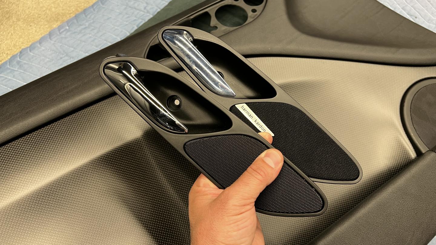

    Door handles were replaced. I specifically chose the non HK versions for a more minimalist look. I never realized how worn the chrome on my door handle was until I held them side by side.
    Click image for larger version  Name:	IMG_4952.jpg Views:	0 Size:	207.3 KB ID:	245532

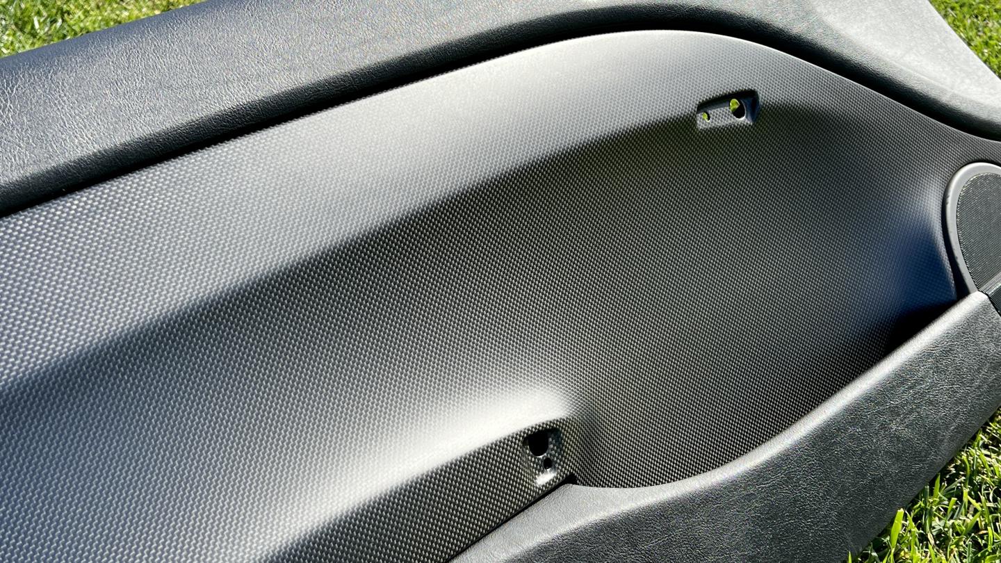

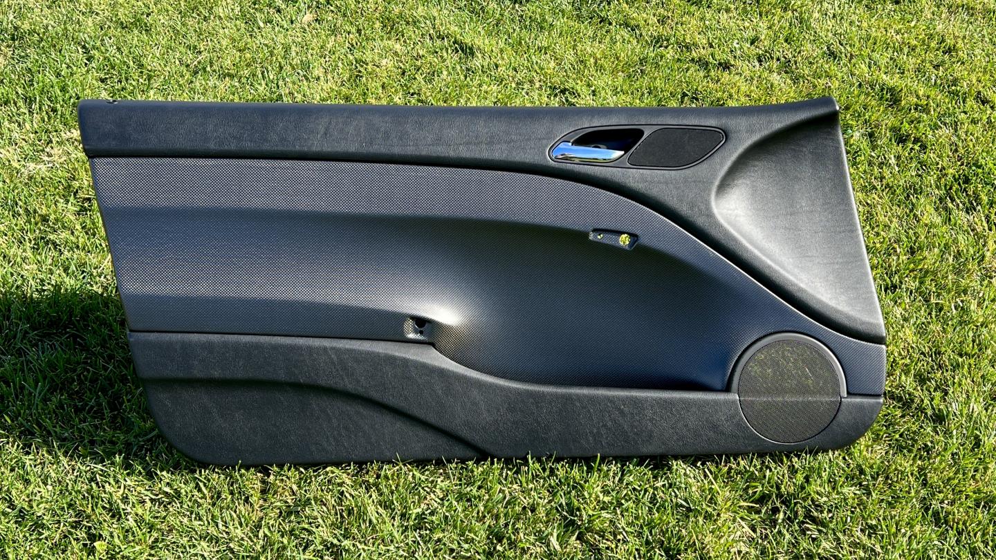

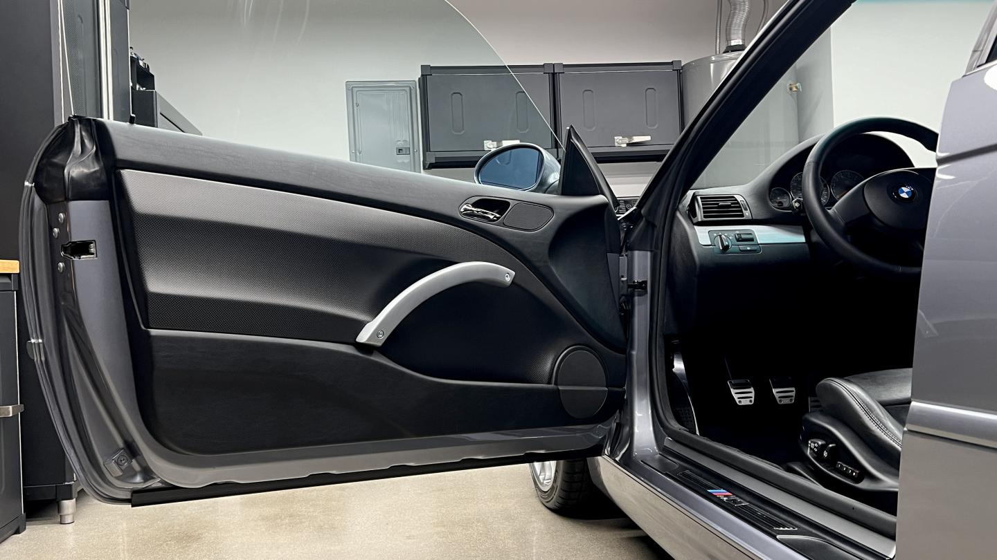

    Here is the freshly modified and restored door panel. Also some shots in the sun so you get a more true look. The process for the rear panels was very similar so I will not be posting that unless someone would like to see something specific.
    Click image for larger version  Name:	IMG_4960.jpg Views:	0 Size:	164.9 KB ID:	245533
    Click image for larger version  Name:	IMG_5083.jpg Views:	0 Size:	402.8 KB ID:	245535
    Click image for larger version  Name:	IMG_5084.jpg Views:	0 Size:	332.9 KB ID:	245534
    Mocked up on the door to verify the bracket location. It was such a relieving and satisfying feeling when the bracket lined up perfectly with the holes in the door panel.
    Click image for larger version  Name:	IMG_4956.jpg Views:	0 Size:	210.1 KB ID:	245536

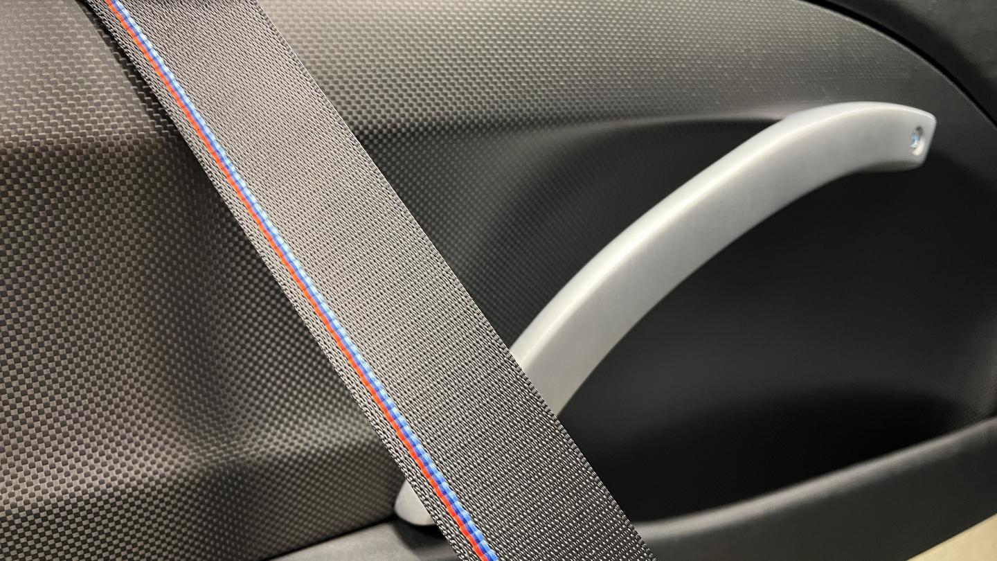

    Everything installed. Turned out exactly how I imagined. I will try to capture some more outdoor beauty shots soon.
    Click image for larger version  Name:	IMG_5121.jpg Views:	0 Size:	141.4 KB ID:	245537
    Click image for larger version  Name:	IMG_5120.jpg Views:	0 Size:	179.9 KB ID:	245539
    Click image for larger version  Name:	IMG_5123.jpg Views:	0 Size:	274.8 KB ID:	245541 Click image for larger version  Name:	IMG_5130.jpg Views:	0 Size:	214.6 KB ID:	245540
    Click image for larger version  Name:	IMG_5132.jpg Views:	0 Size:	155.7 KB ID:	245538

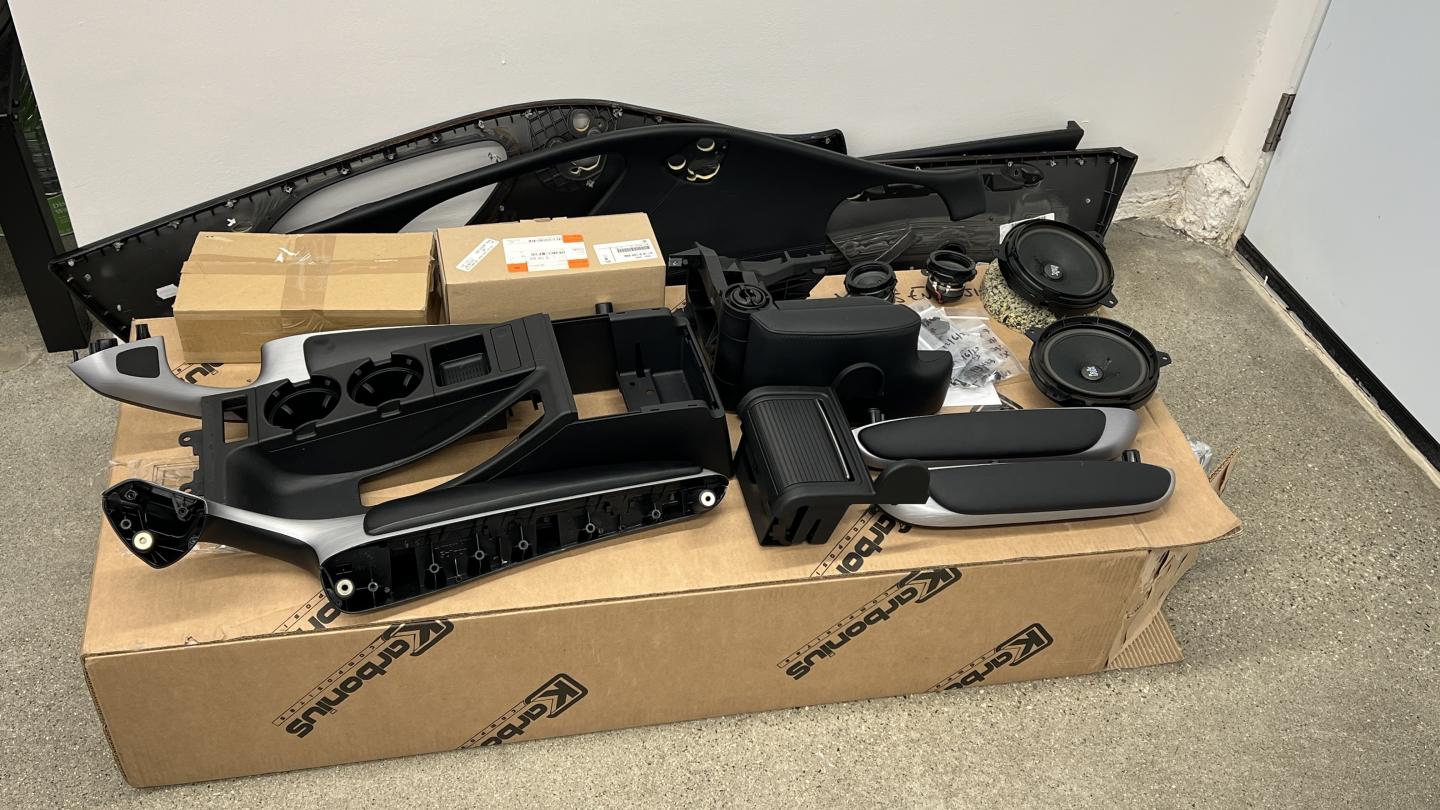

    Here’s everything that was permanently removed.
    Click image for larger version  Name:	IMG_5129.jpg Views:	0 Size:	187.3 KB ID:	245542

          Amazing build!! Can you share the exact details on the hardware used for the CSL door panels?
          2005 E46 ///M3 Interlagos Blue
          BBS - Recaro - JRZ - PFC - Dixis Spirit - Supersprint - Haimus - Vorshlag - RKP - YFCM - Ground Control - DMG Autosport - Diffsonline - Autosolutions - ​Koyo - Mile End Composites - GC
            #65
            Have you driven the car yet and observed any change in cabin noise?
            I haven't driven it yet, but when I do I will listen and report back. To be honest though, I've driven this car so few miles that I'm probably a bad judge of what the baseline noise was. Either way I will let you know.
            Absolutely,
            M5x10mm hex socket head cap bolt LINK
            M5 flat washer LINK
            M5 serrated flanged nut LINK
            If you are preparing to do your install, my comprehensive DIY will be posted within the next few days. It has pretty much every detail you could want.

                  That’s a very fair question. In terms of adding sound deadening on the back of the carbon panel to block/reduce road noise, it probably makes little to no difference.
                  I installed the sound deadening to change the way the panels felt, not to reduce ingress of noises. With the sound deadening on them, they have a lovely solid feeling when you interact with them. Whether you are purposely tapping on the panel, or incidentally knocking your knuckle as you grab the door handle, they just feel sturdy now.
                  As you know, the Karbonius panels are made to such a high standard and are incredibly light. The flip side of that is they have a slightly tinny feeling when you touch them. With the sound deadening, you are literally only adding ounces of weight while dramatically enhancing the feel of them.
                    How much do those parts weigh? And if you are going to toss that into the trash, please PM me!

                      Definitely not going in the trash. They have been packed up and stored away for now.
                      I actually just weighed these and a few other parts for another member. Weights do not include hardware such as screws, bolts, etc. The weights are EACH, not total.
                      • Center Armrest 3lb 13.9oz
                      • HK rear parcel shelf speaker 1lb 14.3oz
                      • HK rear parcel shelf subwoofer 7lb 1.9oz
                      • HK rear door panel speaker 8.3oz
                      • HK front door panel speaker 1lb 13oz
                      • Front Door Airbag 1lb 9.7oz
                      • Font Door Armrest 1lb 13.5oz
                      • Front Door Panel Insert 2lb 14.9oz
                      • Rear Door Armrest 14oz
                      • Rear Door Panel Insert 1lb 8oz
                      • Center console with cupholder, storage tray, ashtray 3lb 6.1oz
                      • Rear parcel shelf latch-restraint hardware 1lb 1.6oz
                      • M Mobility Kit 5lb 11oz
                      • Rear Headrest 1lb 4.1oz

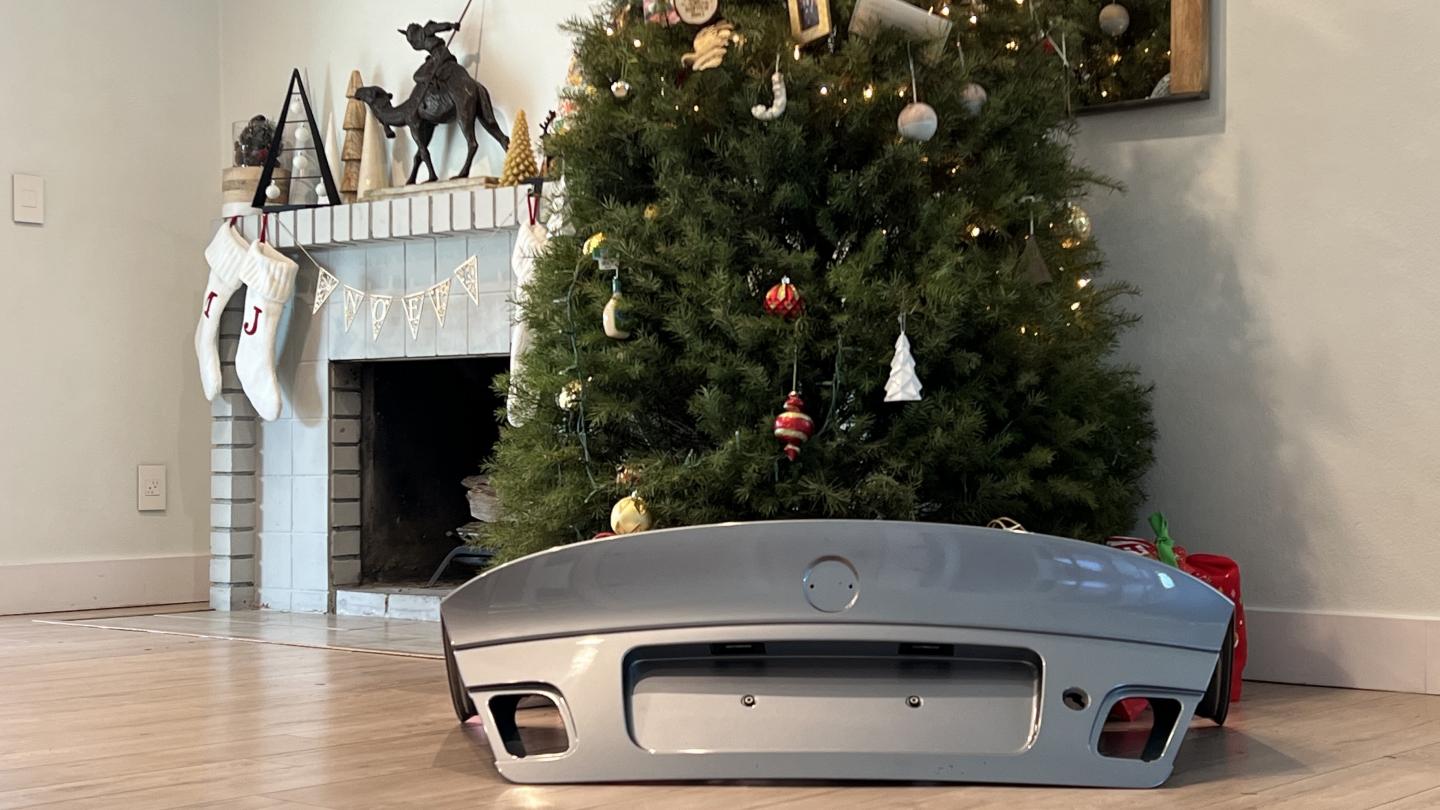

                          Continuing on with the theme of buying parts when you can, not necessarily when you want.
                          Just before Christmas someone posted a reasonably priced (for 2023 market) OE CSL trunk less than 40 minutes away from me. I drove down, confirmed it was a genuine BMW part by inspecting / comparing it to resource images I had saved, then weighing it (yes, I actually brought a bathroom scale).
                          The seller said it had sat in his garage since 2019, and by the looks of it, he was being honest. There was an incredibly thick layer of dust and dirt on it, and the paintwork had a good amount of scratches and chips. I wasn’t concerned with the paint condition, as it was going to get repainted regardless. Most importantly, it was solid, no structural damage, broken corners, modifications, etc.
                          Click image for larger version  Name:	IMG_5403.jpg Views:	0 Size:	370.6 KB ID:	247162
                          Click image for larger version  Name:	IMG_5404.jpg Views:	0 Size:	147.2 KB ID:	247161
                          Click image for larger version  Name:	IMG_5405.jpg Views:	0 Size:	105.6 KB ID:	247160
                          I had no doubt it was the real deal and I picked it up as an unexpected Christmas present to myself. I cleaned it up, took a cheesy photo under the Christmas tree, then packed it right back up for storage.
                          Click image for larger version  Name:	IMG_5410.jpg Views:	0 Size:	138.5 KB ID:	247163
                          Click image for larger version  Name:	IMG_5411.jpg Views:	0 Size:	294.6 KB ID:	247164
                          Although the actual paint and install won’t be happening for a long time, I am already preparing for the install by buying all new hardware, pre fitting accessories, and creating the license plate lights wiring harness. Every part on the trunk will be new. I’ll be documenting the entire process and creating a comprehensive DIY. For now, the trunk will sit in storage while I continue on with the interior.​
