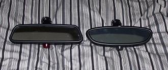

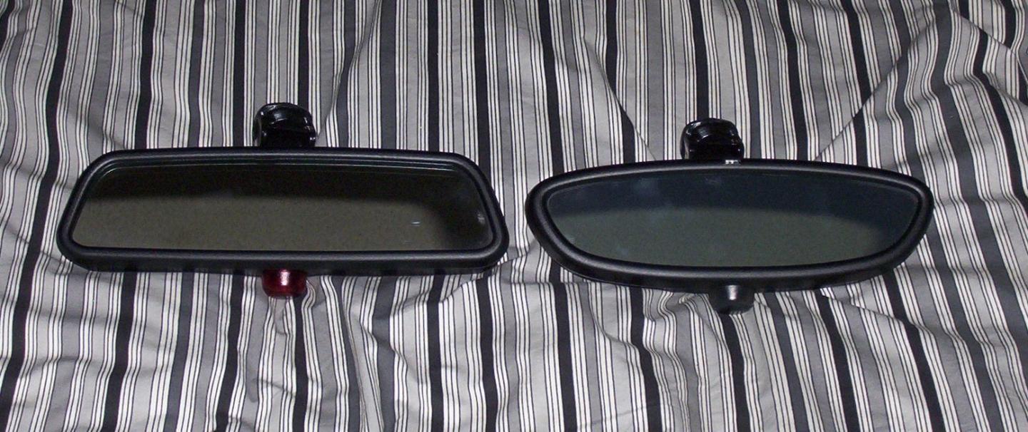

                Yes, I installed one on my car once long ago. I went with the Z4 M manual one. Can’t recall if needed to move the wiring pins to match. Two things I really like was the shape of mirror actually covers the back window better. The other is that the “clown nose” is not red but a much darker smoked. The LED inside it is red though so it blinks the same red.
                I got my original replaced through BMW under original warranty and decided to just put original auto-dimming one back in to go back to M3 oval look.
                Here it is compared to non-M E46 mirror size and stock clown nose.

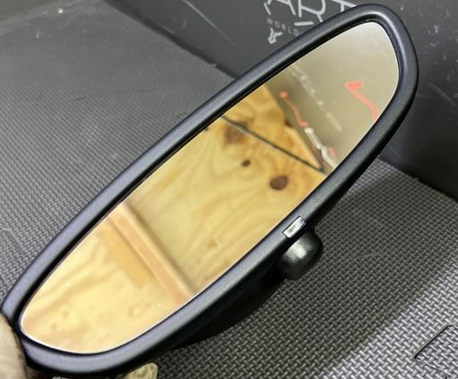

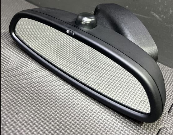

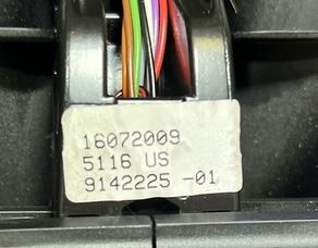

                          Just wanted to update everyone ~ Upon randomly searching E-Bay, I happened to find a later model rear view mirror in good condition from a salvaged M3 with the auto-dim feature for $150.00. Part # shown confirmed fitment corresponded so wouldn't run into any issues. It was an offer I couldn't pass up and so far it's working as advertised. 👍
                              Yeah that’s looks like a Z4M mirror. The way I read your post it kinda sounded like you got an M3 one. In which case for $150 you’d be better off getting your oval M3 one repaired at Sybesma’sElectronics. But yeah this is Z4M with the smoked “clown nose”.
                                The plastic housing on my original mirror cracked & split from age, and I previously repaired the failed mirror with radar mirror years ago. The current one I have now seems to have more of a durable plastic housing and from what I understand BMW used a different vendor on the glass with the later models.
